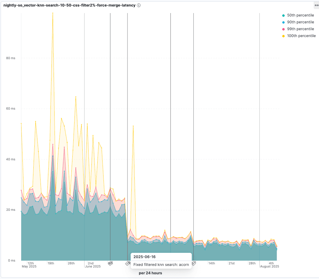

At Elasticsearch, we want to make sure that vector search filtering is efficient. We have a specific benchmark for vector filtering that performs approximate vector searches with different filtering to ensure that vector search keeps retrieving relevant results as fast as possible.
Check the improvements when ACORN-1 was introduced. For tests where only 2% of the vectors pass the filter, query latency is reduced to 55% of the original duration:
