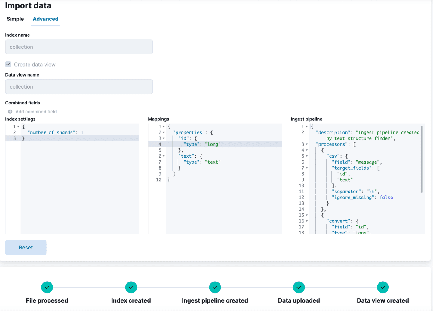

As mentioned in the introduction, we use the MS MARCO Passage Ranking dataset. The dataset is quite big, consisting of over 8 million passages. For our example, we use a subset of it that was used in the testing stage of the 2019 TREC Deep Learning Track. The dataset msmarco-passagetest2019-top1000.tsv used for the re-ranking task contains 200 queries and for each query a list of relevant text passages extracted by a simple IR system. From that dataset, we’ve extracted all unique passages with their ids, and put them into a separate tsv file, totaling 182469 passages. We use this file as our dataset.
We use Kibana's file upload feature to upload this dataset. Kibana file upload allows us to provide custom names for fields, let’s call them id with type long for passages’ ids, and text with type text for passages’ contents. The index name is collection. After the upload, we can see an index named collection with 182469 documents.
Screenshot
