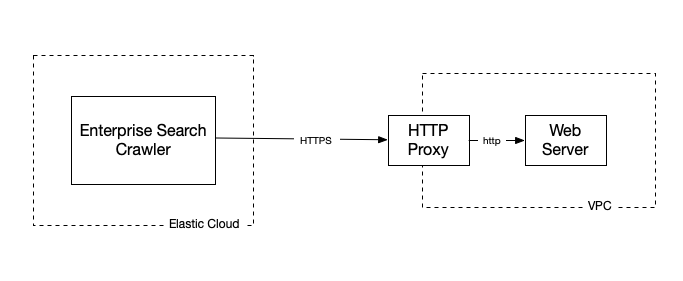

To demonstrate the authenticated proxy server functionality for App Search web crawler, we will use the infrastructure outlined in this schematic diagram:
crawler proxy schematic
This example has all the components needed to understand the use case:
  • A VPC (virtual private network) deployed within Google Cloud
  • The VPC contains two cloud instances: web-server and proxy:
    • The web-server hosts a private website, that is only accessible from within the VPC, using a private domain name: http://marlin-docs.internal.
    • The proxy server has basic HTTP authentication set up with the username proxyuser and password proxypass. It is accessible from the public internet using the host name proxy.example.com and the port number 3128.
  • An Enterprise Search deployment running outside of the VPC, in Elastic Cloud.
    • This deployment has no access to the private network hosting our content.
App Search web crawler supports both HTTP and HTTPS. However, we recommend configuring TLS to protect your content and proxy server credentials.
Refer to your proxy server software documentation for more details on how to set this up.

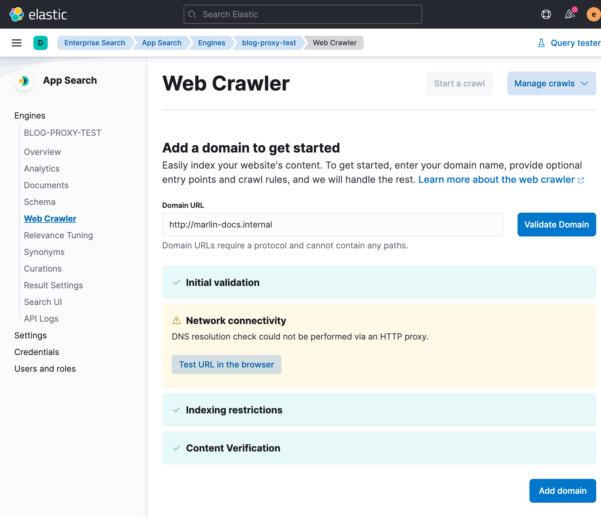

With the configuration complete, we can now test the solution. Create an App Search engine and use the Web Crawler feature to ingest content into the engine:
crawler proxy validation
The validation process for adding a domain to the App Search web crawler configuration will skip a number of networking-related checks, since these do not work through a proxy. If you do not see the warning in the above image, check your deployment configuration to ensure you have configured the proxy correctly.
Our private domain is now added to the configuration. We can start the crawl, and the content should be ingested into the deployment. If there are failures, check your crawler logs and proxy server’s logs for clues about what might be going wrong.
