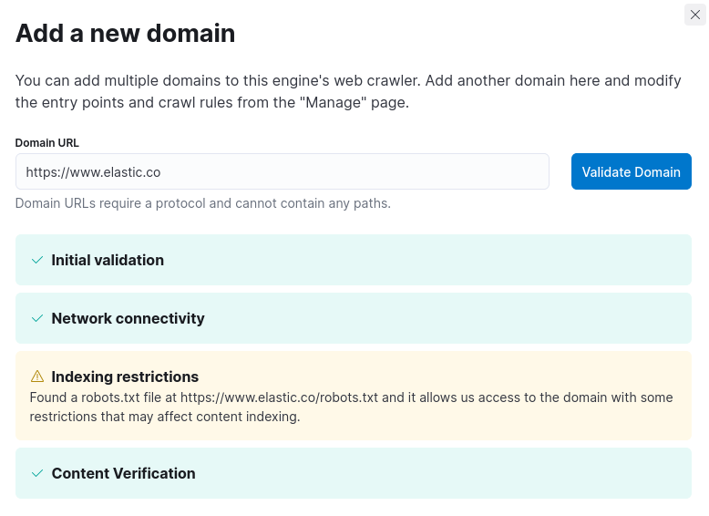

A domain is a website or property you’d like to crawl. You must associate one or more domains to a crawl. See Domain in the web crawler reference for a detailed explanation of a domain.
Manage the domains for a crawl through the web crawler dashboard. From the engine menu, choose Web Crawler.
web crawler navigation
Add your first domain on the getting started screen.
add first domain
From there, you can view, add, manage, and delete domains using the web crawler dashboard.
web crawler dashboard domains

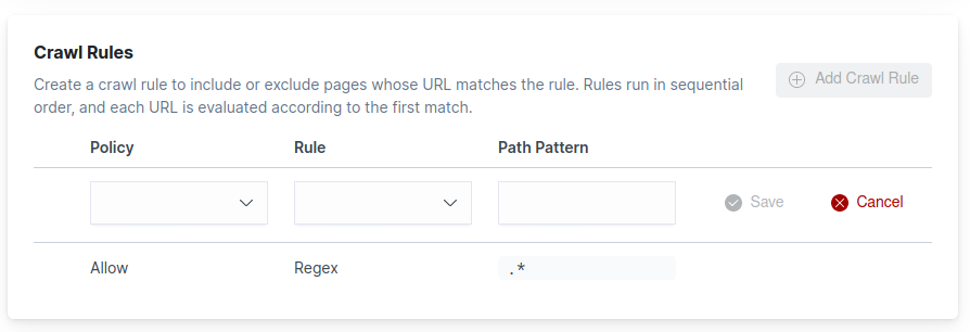

Each domain must also have one or more crawl rules. These rules instruct the crawler which pages to crawl within the domain. See Crawl rule in the web crawler reference for a detailed explanation of a crawl rule.
Manage the crawl rules for a domain through the domain dashboard. From the engine menu, choose Web Crawler. Choose Manage next to the domain you’d like to manage. Then locate the Crawl Rules section of the dashboard.
domains dashboard crawl rules
From here, you can view, add, edit, delete, and re-order crawl rules.
The dashboard adds a default crawl rule to allow all paths. You cannot delete this crawl rule, but you can insert more restrictive rules in front of this rule. See Crawl rule for explanations of crawl rule logic and the effects of crawl rule order.

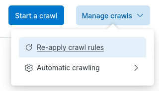

After updating your crawl rules, you can immediately re-apply the updated rules to your existing documents.

Start a crawl from the web crawler or domain dashboard, or using the App Search API.
To use a dashboard, navigate to Web Crawler, then optionally choose a domain to manage. Choose the Start a Crawl button at the top of the dashboard.
start crawl button default

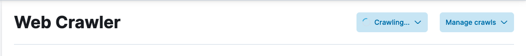

Each engine may have only one active crawl. The start button changes state to reflect a crawl is in progress.
start crawl button crawling

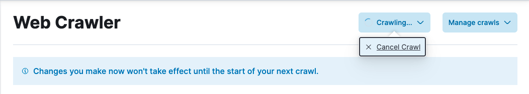

Cancel an active crawl from the web crawler or domain dashboard, or using the App Search API.
To use a dashboard, navigate to Web Crawler, then optionally choose a domain to manage. Expand the Crawling…​ button at the top of the dashboard. Choose Cancel Crawl.
cancel crawl button

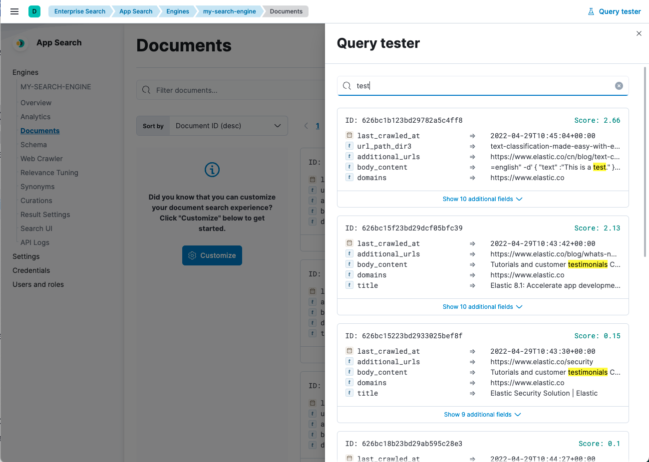

The web crawler extracts the content from each web page, transforming it into a search document. It indexes these documents within the engine associated with the crawl. See Content extraction and indexing for more details on this process, and see Web crawler schema for more details on the structure of each search document.
View the indexed documents using the Documents or Query Tester views within the App Search dashboard, or use the search API.
To find a specific document, wrap the document’s URL in quotes, and use that as your search query. For example: "https://example.com/some/page.html". If the document is present in the engine, it should be a top result (or only result).
To access the documents dashboard, choose Documents from the engine menu.
documents dashboard
To access the query tester, choose Query Tester from the engine menu.
query tester dashboard

Validate one or more domains:
When adding a domain through the web crawler UI, the crawler validates the domain:
validate domain
However, when adding domains through the API, you should validate each domain through the API as well. See Validate a domain.
An invalid domain is a common cause for a crawl with no results. Fix the domain issues and re-crawl.

Disallowed path
The web crawler does not follow links whose paths are disallowed by a domain’s crawl rules or robots.txt directives.
Manage crawl rules and robots.txt files for each domain to ensure paths are allowed.

View indexed documents to confirm missing pages:
Identify which pages are missing from your engine, or focus on specific pages. See View indexed documents for instructions to view all documents and specific documents.
If documents are missing from the engine, look for signs of content discovery issues. See Troubleshoot content discovery.

Re-apply crawl rules
After modifying crawl rules, you can re-apply the updated rules to your existing documents without running a full crawl. The web crawler will remove all existing documents that are no longer allowed by your current crawl rules. This operation is called a process crawl.
Using the web crawler UI, you can re-apply crawl rules for all domains or a specific domain. The only difference in the process is where you initiate the request.
Re-apply crawl rules to all domains:
  1. Navigate to SearchEnterprise SearchApp SearchEnginesengine nameWeb crawler
  2. Choose Manage crawls, then Re-apply crawl rules
    re apply crawl rules
Re-apply crawl rules to a specific domain:
  1. Navigate to SearchEnterprise SearchApp SearchEnginesengine nameWeb crawlerdomain name
  2. Choose Manage crawls, then Re-apply crawl rules:
Alternatively, you can re-apply crawl rules using the web crawler API. See Process crawls.
It is recommended to cancel any active web crawls before opting to re-apply crawl rules. A web crawl that runs concurrently with a process crawl may continue to index fresh documents with out of date configuration; the changes in crawl rule configuration will only apply to documents indexed at the time of the request.

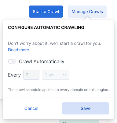

Automatic crawling
Configure the cadence for new crawls to start automatically. New crawls will be skipped if there is an active crawl.
For example, consider a crawl that completes on a Tuesday. If the crawl is configured to run every 7 days, the next crawl would start on the following Tuesday. If the crawl is configured to run every 3 days, then the next crawl would start on Friday.
Scheduling a crawl does not necessarily run the crawl immediately. When the App Search server starts and once ever hour thereafter, App Search checks for and runs any overdue scheduled crawls.
Manage automatic crawling within the web crawler or domain dashboard, or using the App Search API.
To use a dashboard, navigate to Web Crawler, then optionally choose a domain to manage. Choose the Manage Crawls button at the top of the dashboard.
configure automatic crawling
To manage automatic crawling programmatically, refer to the following API references:
