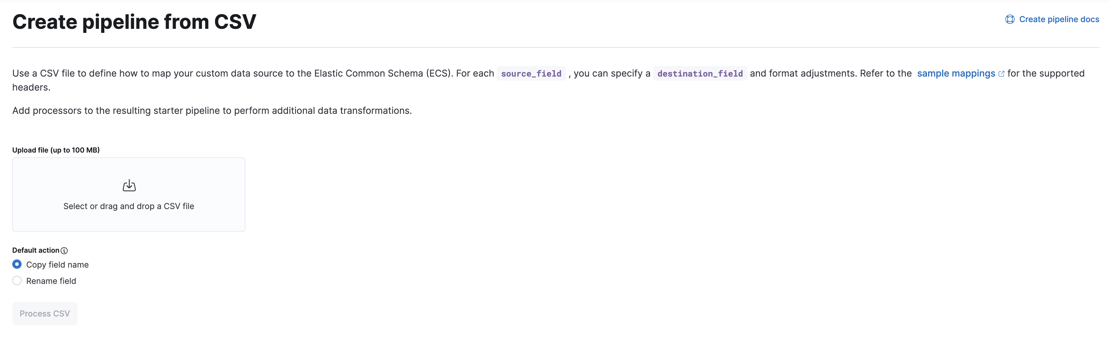

In Kibana, open the main menu and click Stack Management > Ingest Pipelines > Create pipeline > New pipeline from CSV.
- On the Create pipeline from CSV page, upload your CSV file.
Under Default action, select the Copy field name or Rename field option.
For the Copy field name option, Kibana makes a copy of the
source_field
to use as thedestination_field
by default. The final document contains both fields.For the Rename field option, renames the
source_field
to thedestination_field
by default. The final document only contains thedestination_field
.You can override this default using the
copy_action
column of your CSV. -

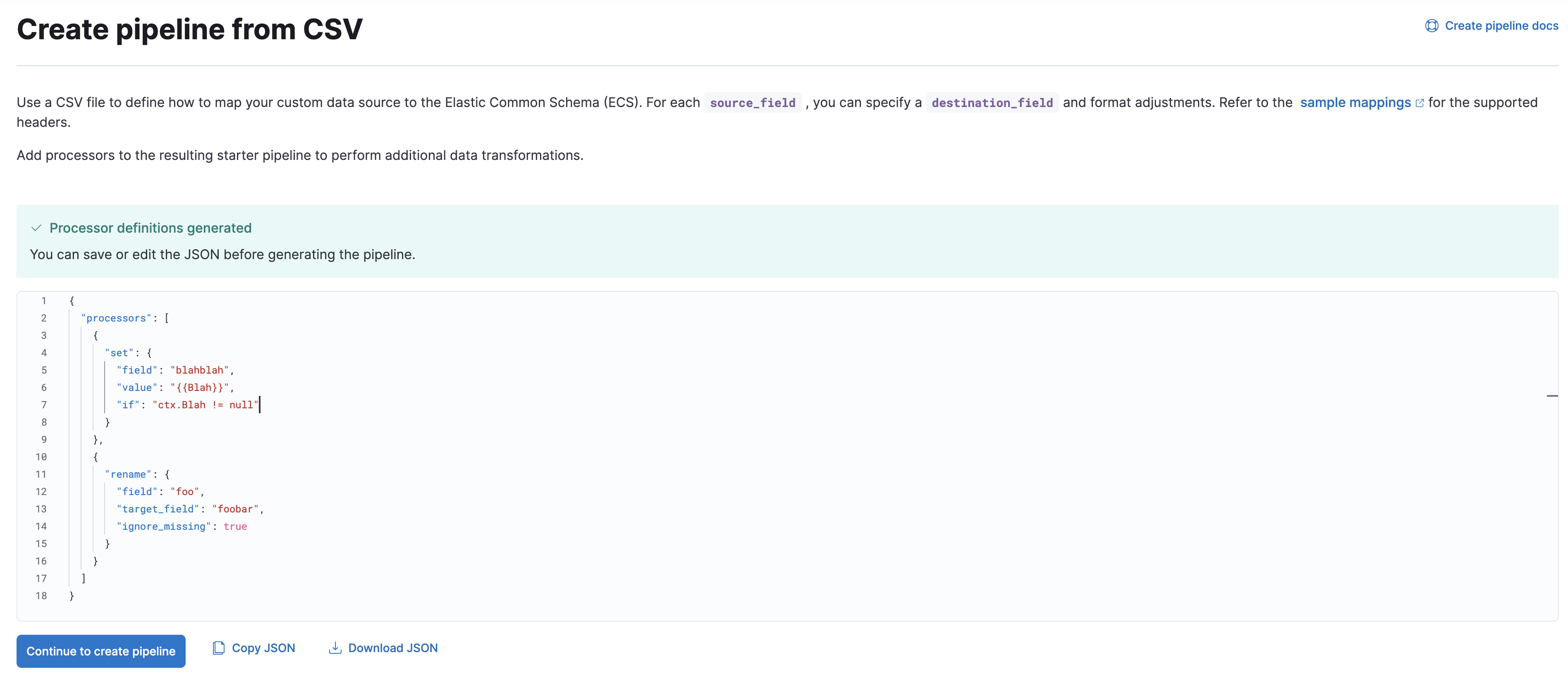

Click Process CSV.
Kibana displays a JSON preview of the ingest pipeline generated from your CSV file.
- To create the pipeline, click Continue to create pipeline.
On the Create pipeline page, you can add additional ingest processors to your pipeline.
When you’re done, click Create pipeline.
