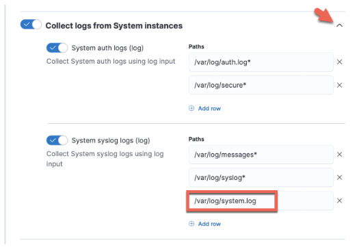

Agent policies and integration settings can be managed using the Kibana UI. For example, the following shows the configuration of logging for the System integration in an Elastic Agent policy:
