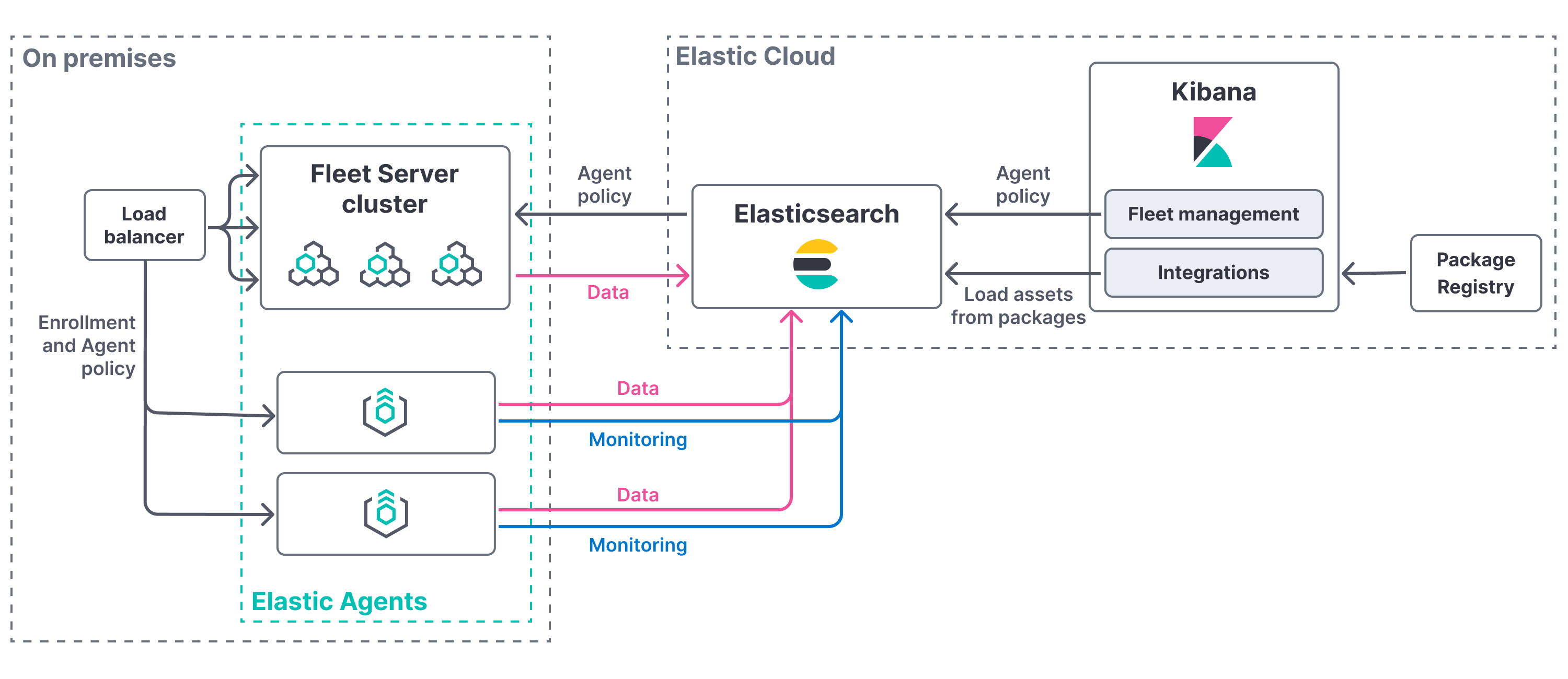

editTo use Fleet for central management, a Fleet Server must be running and accessible to your hosts.
Another approach is to deploy a cluster of Fleet Servers on-premises and connect them back to Elastic Cloud with access to Elasticsearch and Kibana. In this deployment model, you are responsible for high-availability, fault-tolerance, and lifecycle management of Fleet Server.
This approach might be right for you if you would like to limit the control plane traffic out of your data center. For example, you might take this approach if you are a managed service provider or a larger enterprise that segregates its networks.

To deploy a self-managed Fleet Server on-premises to work with a hosted Elasticsearch Service, you need to:
- Satisfy all compatibility requirements and prerequisites
- Create a Fleet Server policy
- Add Fleet Server by installing an Elastic Agent and enrolling it in an agent policy containing the Fleet Server integration
