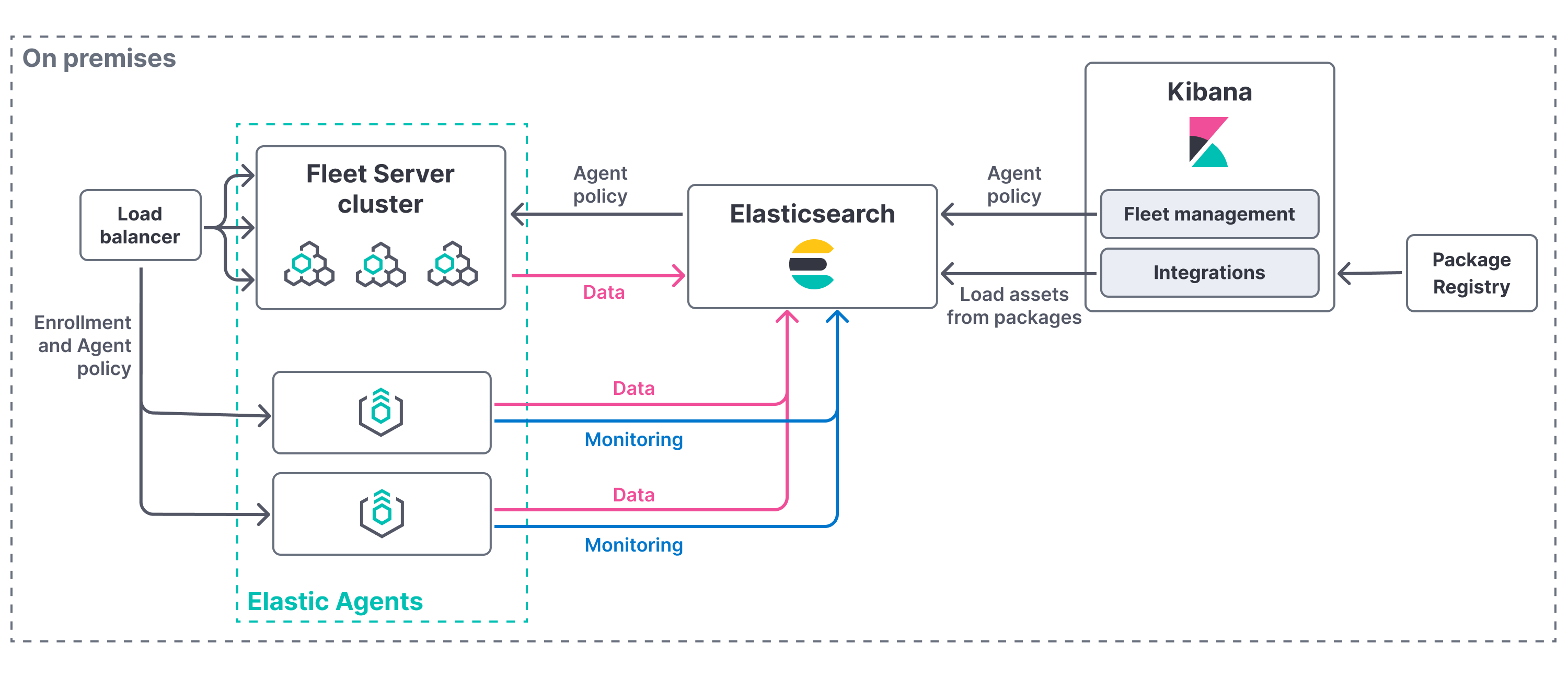

You can deploy Fleet Server on-premises and manage it yourself. In this deployment model, you are responsible for high-availability, fault-tolerance, and lifecycle management of Fleet Server.
This approach might be right for you if you would like to limit the control plane traffic out of your data center or have requirements for fully air-gapped operations. For example, you might take this approach if you need to satisfy data governance requirements or you want agents to only have access to a private segmented network.
This approach might not be right for you if you don’t want to manage the life cycle of your Elastic environment and instead would like that to be handled by Elastic.
When using this approach, it’s recommended that you provision multiple instances of the Fleet Server and use a load balancer to better scale the deployment. You also have the option to use your organization’s certificate to establish a secure connection from Fleet Server to Elasticsearch.

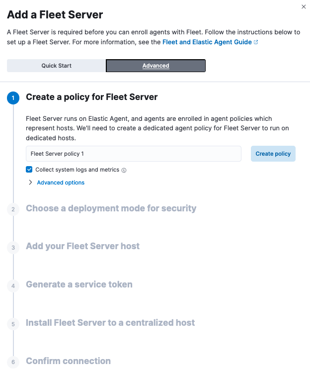

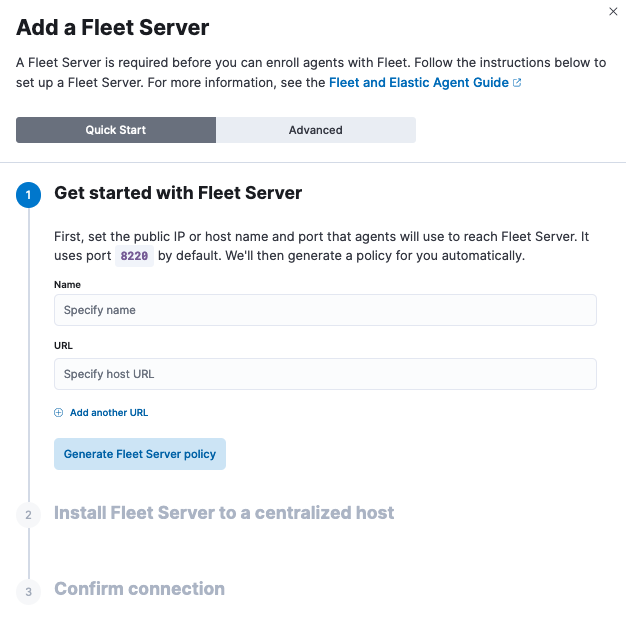

This opens in-product instructions to add a Fleet Server using one of two options: Quick Start or Advanced.
Use Quick Start if you want Fleet to generate a Fleet Server policy and enrollment token for you. The Fleet Server policy will include a Fleet Server integration plus a system integration for monitoring Elastic Agent. This option generates self-signed certificates and is not recommended for production use cases.
Use Advanced if you want to either:
- Use your own Fleet Server policy. Fleet Server policies manage and configure the Elastic Agent running on Fleet Server hosts to launch a Fleet Server process. You can create a new Fleet Server policy or select an existing one. Alternatively you can create a Fleet Server policy without using the UI, and then select the policy here.
Use your own TLS certificates. TLS certificates encrypt traffic between Elastic Agents and Fleet Server. To learn how to generate certs, refer to Configure SSL/TLS for self-managed Fleet Servers.

Step through the in-product instructions to configure and install Fleet Server.

When using the Advanced option, it’s recommended to generate a unique service
token for each Fleet Server. For other ways to generate service tokens, refer to
elasticsearch-service-tokens
