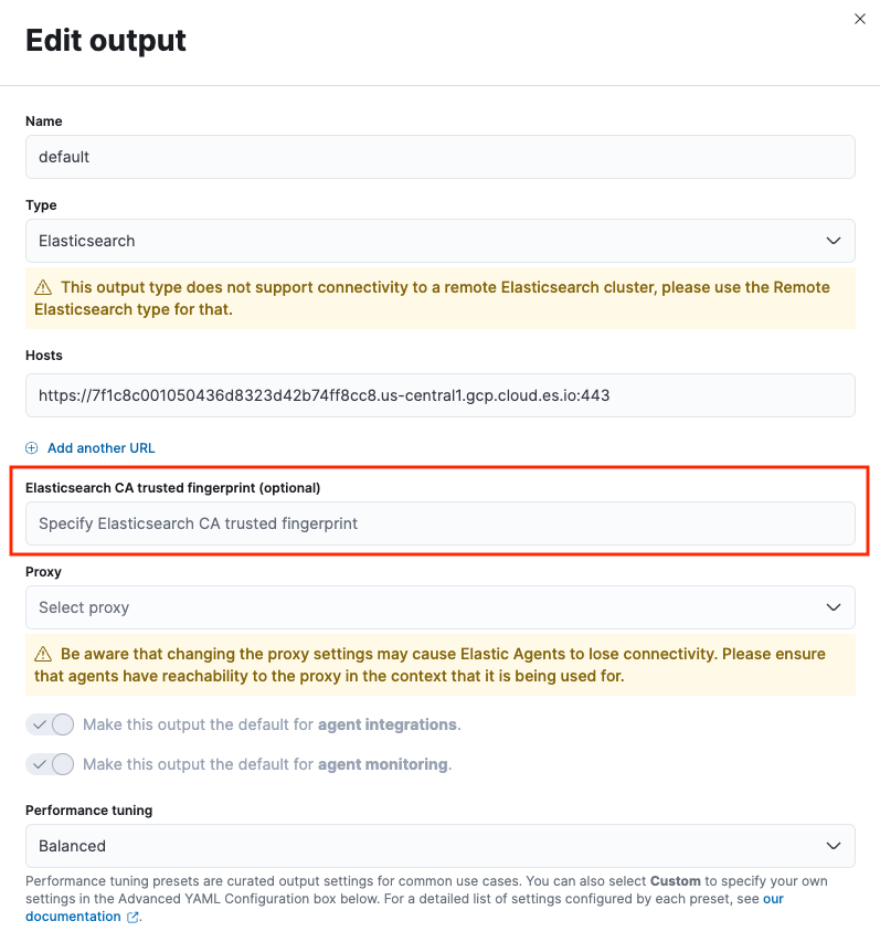

To rotate a CA certificate on Elasticsearch for connections from Elastic Agent:
  1. In Fleet open the Settings tab.
  2. In the Outputs section, click the edit button for the Elasticsearch output that requires a certificate rotation.
  3. In the Elasticsearch CA trusted fingerprint field, add the new trusted fingerprint to use. This is the SHA-256 fingerprint (hash) of the certificate authority used to self-sign Elasticsearch certificates. This fingerprint will be used to verify self-signed certificates presented by Elasticsearch.
    If this certificate is present in the chain during the handshake, it will be added to the certificate_authorities list and the handshake will continue normally.
    Screen capture of the Edit Output UI: Elasticsearch CA trusted fingerprint
