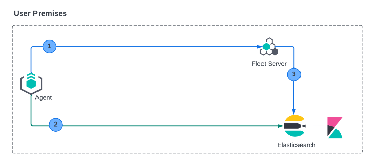

On-premise deployments
Diagram of mutual TLS on premise deployment model
Refer to the steps in Configure SSL/TLS for self-managed Fleet Servers. To configure mutual TLS, include the following additional parameters when you install Elastic Agent and Fleet Server.

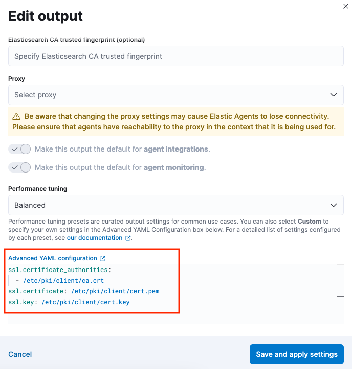

Fleet settings:
In Kibana, navigate to Fleet, open the Settings tab, and choose the Output that you’d like to configure. In the Advanced YAML configuration, add the following settings:
ssl.certificate_authorities
List of CA certificates that are trusted when Fleet Server connects to Elastic Agent
ssl.certificate
This certificate will be passed down to all the agents that have this output configured in their policy. This certificate is used by the agent when establishing mTLS to the output.
You may either apply the full certificate, in which case all the agents get the same certificate OR alternatively point to a local directory on the agent where the certificate resides, if the certificates are to be unique per agent.
ssl.key
This certificate key will be passed down to all the agents that have this output configured in their policy. The certificate key is used to decrypt the SSL certificate.
Note the following when you specify these SSL settings:
  • The certificate authority, certificate, and certificate key need to be specified as a path to a local file. You cannot specify a directory.
  • You can define multiple CAs or paths to CAs.
  • Only one certificate and certificate key can be defined.
In the Advanced YAML configuration these settings should be added in the following format:
ssl.certificate_authorities:
  - /path/to/ca
ssl.certificate: /path/to/cert
ssl.key: /path/to/cert_key
OR
  - /path/to/ca
Screen capture of output advanced yaml settings

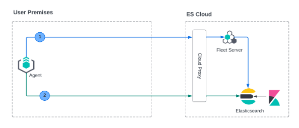

Fleet Server on Elastic Cloud
In this deployment model, all traffic ingress into Elastic Cloud has its TLS connection terminated at the Elastic Cloud boundary. Since this termination is not handled on a per-tenant basis, a client-specific certificate can NOT be used at this point.
Diagram of mutual TLS on cloud deployment model
We currently don’t support mTLS in this deployment model. An alternate deployment model is shown below where you can deploy your own secure proxy where TLS connections are terminated.

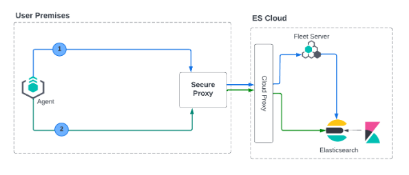

Fleet Server on Elastic Cloud using a proxy
In this scenario, where you have access to the proxy, you can configure mTLS between the agent and your proxy.
Diagram of mutual TLS on cloud deployment model with a proxy

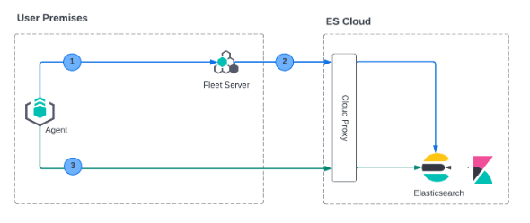

Fleet Server on-premise and Hosted Elasticsearch Service
In some scenarios you may want to deploy Fleet Server on your own premises. In this case, you’re able to provide your own certificates and certificate authority to enable mTLS between Fleet Server and Elastic Agent.
However, as with the Fleet Server on Elastic Cloud use case, the data plane TLS connections terminate at the Elastic Cloud boundary. Elastic Cloud is not a multi-tenanted service and therefore can’t provide per-user certificates.
Diagram of mutual TLS with Fleet Server on premise and hosted Elasticsearch Service deployment model

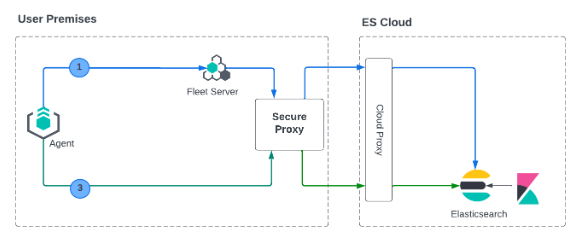

Similar to the Fleet Server on Elastic Cloud use case, a secure proxy can be placed in such an environment to terminate the TLS connections and satisfy the mTLS requirements.
Diagram of mutual TLS with Fleet Server on premise and hosted Elasticsearch Service deployment model with a proxy
