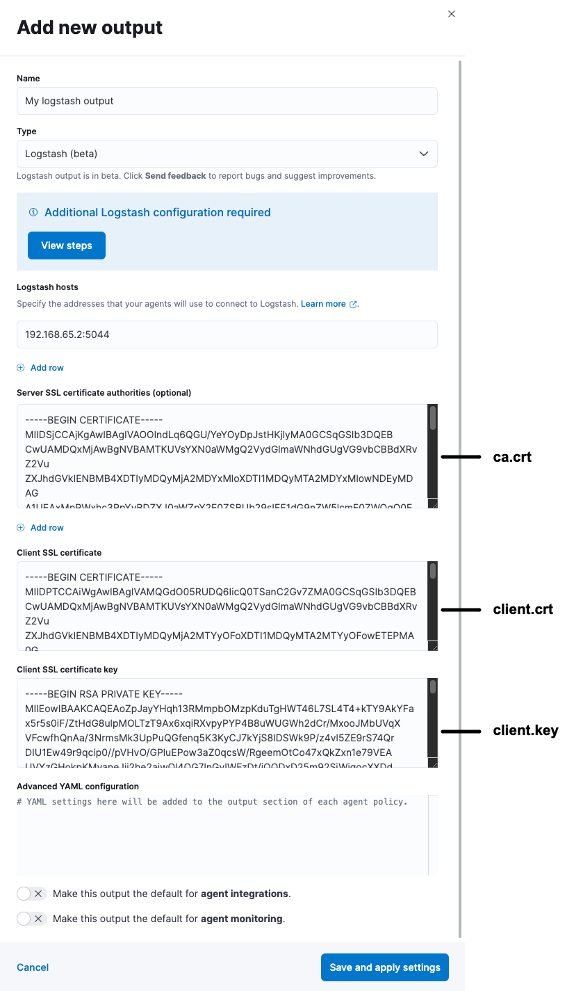

Add a Logstash output to Fleet
This section describes how to add a Logstash output and configure SSL settings in Fleet. If you’re running Elastic Agent standalone, refer to the Logstash output configuration docs.
  1. In Kibana, go to Fleet > Settings.
  2. Under Outputs, click Add output. If you’ve been following the Logstash steps in Fleet, you might already be on this page.
  3. Specify a name for the output.
  4. For Type, select Logstash.
  5. Under Logstash hosts, specify the host and port your agents will use to connect to Logstash. Use the format host:port.
  6. In the Server SSL certificate authorities field, paste in the entire contents of the ca.crt file you generated earlier.
  7. In the Client SSL certificate field, paste in the entire contents of the client.crt file you generated earlier.
  8. In the Client SSL certificate key field, paste in the entire contents of the client.key file you generated earlier.
Screen capture of a folder called `logstash` that contains two files: logstash.crt and logstash.key
When you’re done, save and apply the settings.

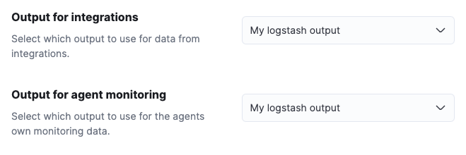

Select the Logstash output in an agent policy
Logstash is now listening for events from Elastic Agent, but events are not streaming into Elasticsearch yet. You need to select the Logstash output in an agent policy. You can edit an existing policy or create a new one:
  1. In Kibana, go to Fleet > Agent policies and either create a new agent policy or click an existing policy to edit it:
    • To change the output settings in a new policy, click Create agent policy and expand Advanced options.
    • To change the output settings in an existing policy, click the policy to edit it, then click Settings.
  2. Set Output for integrations and (optionally) Output for agent monitoring to use the Logstash output you created earlier. You might need to scroll down to see these options
    Screen capture showing the Logstash output policy selected in an agent policy
  3. Save your changes.
Any Elastic Agents enrolled in the agent policy will begin sending data to Elasticsearch via Logstash. If you don’t have any installed Elastic Agents enrolled in the agent policy, do that now.
