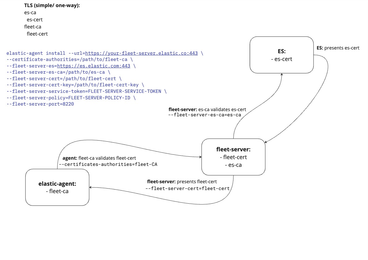

Simple one-way TLS connection
The following elastic-agent install command configures a Fleet Server with the required certificates and certificate authorities to enable one-way TLS connections between the components involved:
elastic-agent install --url=https://your-fleet-server.elastic.co:443 \
--certificate-authorities=/path/to/fleet-ca \
--fleet-server-es=https://es.elastic.com:443 \
--fleet-server-es-ca=/path/to/es-ca \
--fleet-server-cert=/path/to/fleet-cert \
--fleet-server-cert-key=/path/to/fleet-cert-key \
--fleet-server-service-token=FLEET-SERVER-SERVICE-TOKEN \
--fleet-server-policy=FLEET-SERVER-POLICY-ID \
--fleet-server-port=8220

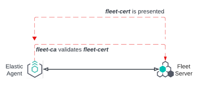

Elastic Agent is configured with fleet-ca as the certificate authority that it needs to validate certificates from Fleet Server.
During the TLS connection setup, Fleet Server presents its certificate fleet-cert to the agent and the agent (as a client) uses fleet-ca to validate the presented certificate.
Diagram of one-way TLS connection between Fleet Server and Elastic Agent

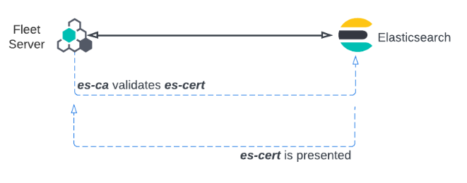

Fleet Server also establishes a secure connection to an Elasticsearch cluster. In this case, Fleet Server is configured with the certificate authority from the Elasticsearch es-ca. Elasticsearch presents its certificate, es-cert, and Fleet Server validates the presented certificate using the certificate authority es-ca.
Diagram of one-way TLS connection between Fleet Server and Elasticsearch
Relationship between components in a one-way TLS connection
Diagram of one-way TLS connection between components

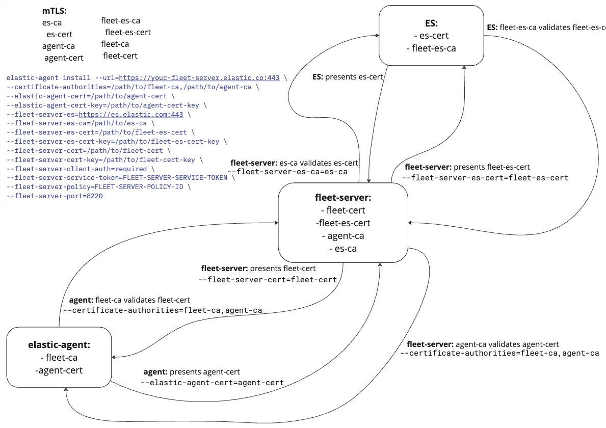

Mutual TLS connection
The following elastic-agent install command configures a Fleet Server with the required certificates and certificate authorities to enable mutual TLS connections between the components involved:
--certificate-authorities=/path/to/fleet-ca,/path/to/agent-ca \
--elastic-agent-cert=/path/to/agent-cert \
--elastic-agent-cert-key=/path/to/agent-cert-key \
--fleet-server-es-cert=/path/to/fleet-es-cert \
--fleet-server-es-cert-key=/path/to/fleet-es-cert-key \
--fleet-server-client-auth=required \

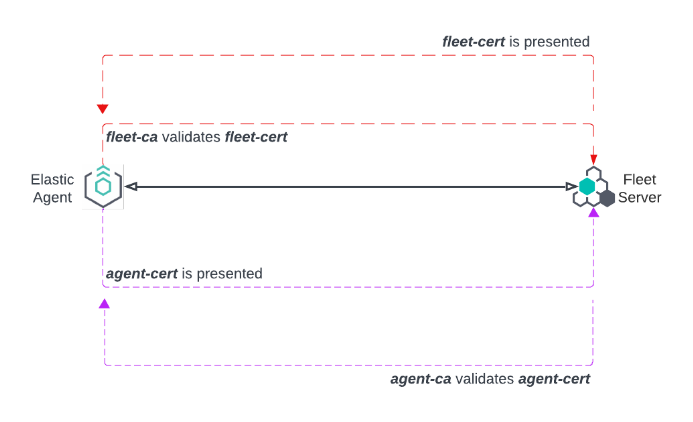

As with the one-way TLS example, Elastic Agent is configured with fleet-ca as the certificate authority that it needs to validate certificates from the Fleet Server. Fleet Server presents its certificate fleet-cert to the agent and the agent (as a client) uses fleet-ca to validate the presented certificate.
To establish a mutual TLS connection, the agent presents its certificate, agent-cert, and Fleet Server validates this certificate using the agent-ca that it has stored in memory.
Diagram of mutual TLS connection between Fleet Server and Elastic Agent

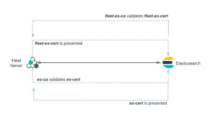

Fleet Server can also establish a mutual TLS connection to the Elasticsearch cluster. In this case, Fleet Server is configured with the certificate authority from the Elasticsearch es-ca and uses this to validate the certificate es-cert presented to it by Elasticsearch.
Diagram of mutual TLS connection between Fleet Server and Elasticsearch

Relationship between components in a mutual TLS connection
Diagram of mutual TLS connection between components
