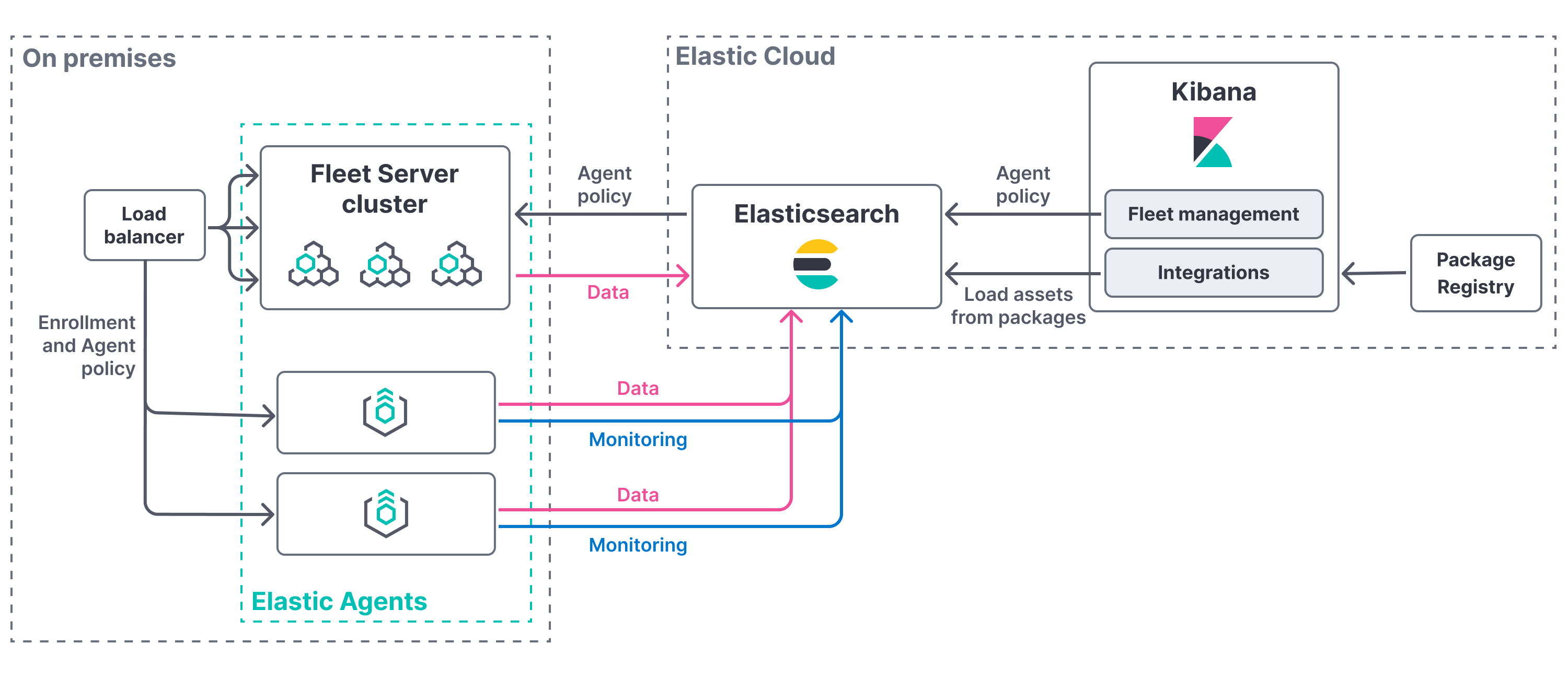

To use Fleet for central management, a Fleet Server must be running and accessible to your hosts. Deploying Fleet Server on-premises to work with a hosted Elasticsearch Service is one of several approaches to setting up Fleet Server.
Fleet Server on-premise and Elasticsearch on Cloud deployment model
To deploy a self-managed Fleet Server on-premises to work with a hosted Elasticsearch Service, you need to:

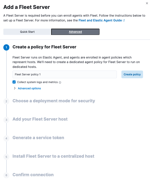

  1. In Kibana, go to ManagementFleet
  2. Click the Agents tab.
  3. Click Add Fleet Server.
  4. This will open in-product instructions for adding a Fleet Server using one of two options. Choose Advanced.
    In-product instructions for adding a Fleet Server in advanced mode
  5. Follow the in-product instructions to add a Fleet Server.
    1. Select the agent policy that you created for this deployment.
    2. Choose Production as your deployment mode.
      Production mode is the fully secured mode where TLS certificates ensure a secure communication between Fleet Server and Elasticsearch.
    3. Open the Fleet Server Hosts dropdown and select Add new Fleet Server Hosts. Specify one or more host URLs your Elastic Agents will use to connect to Fleet Server. For example, https://192.0.2.1:8220, where 192.0.2.1 is the host IP where you will install Fleet Server.
    4. A Service Token is required so the Fleet Server can write data to the connected Elasticsearch instance. Click Generate service token and copy the generated token.
    5. Copy the installation instructions provided in Kibana, which include some of the known deployment parameters.
    6. Replace the value of the --certificate-authorities parameter with your CA certificate.
  6. If installation is successful, a confirmation indicates that Fleet Server is set up and connected.

For on-premises deployments, you can dedicate a policy to all the agents in the network boundary and configure that policy to include a specific Fleet Server (or a cluster of Fleet Servers).
Read more in Add a Fleet Server to a policy.
