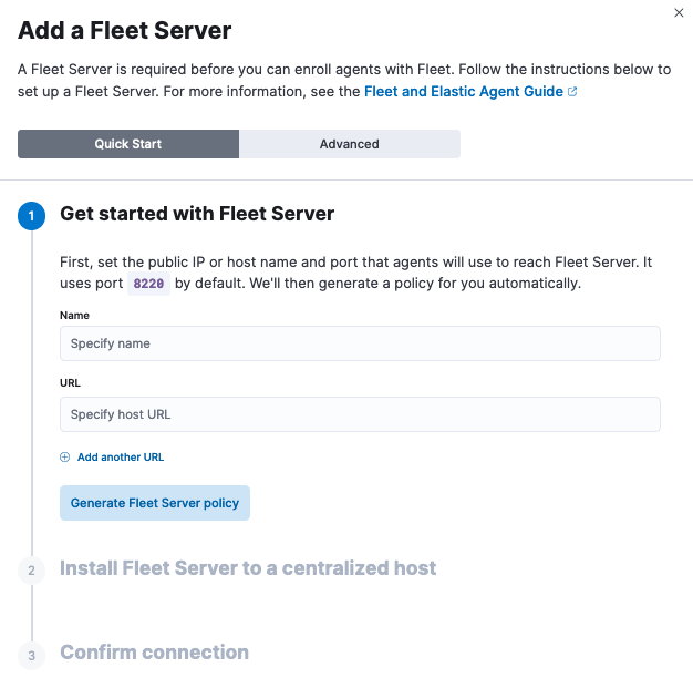

  4. This opens in-product instructions to add a Fleet Server using one of two options: Quick Start or Advanced.
    • Use Quick Start if you want Fleet to generate a Fleet Server policy and enrollment token for you. The Fleet Server policy will include a Fleet Server integration plus a system integration for monitoring Elastic Agent. This option generates self-signed certificates and is not recommended for production use cases.
      In-product instructions for adding a Fleet Server in quick start mode
