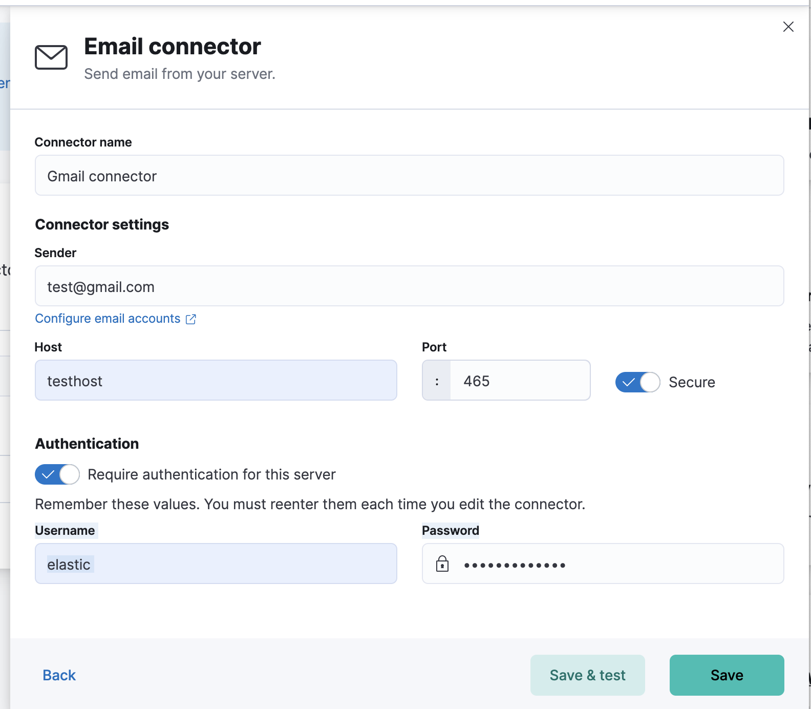

Define email connector properties.
Email connector

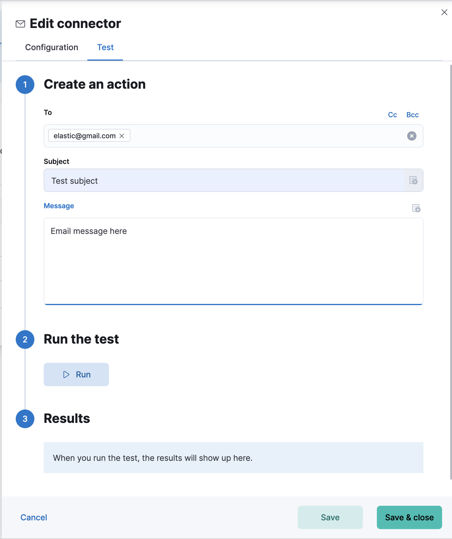

Test email action parameters.
Email params test

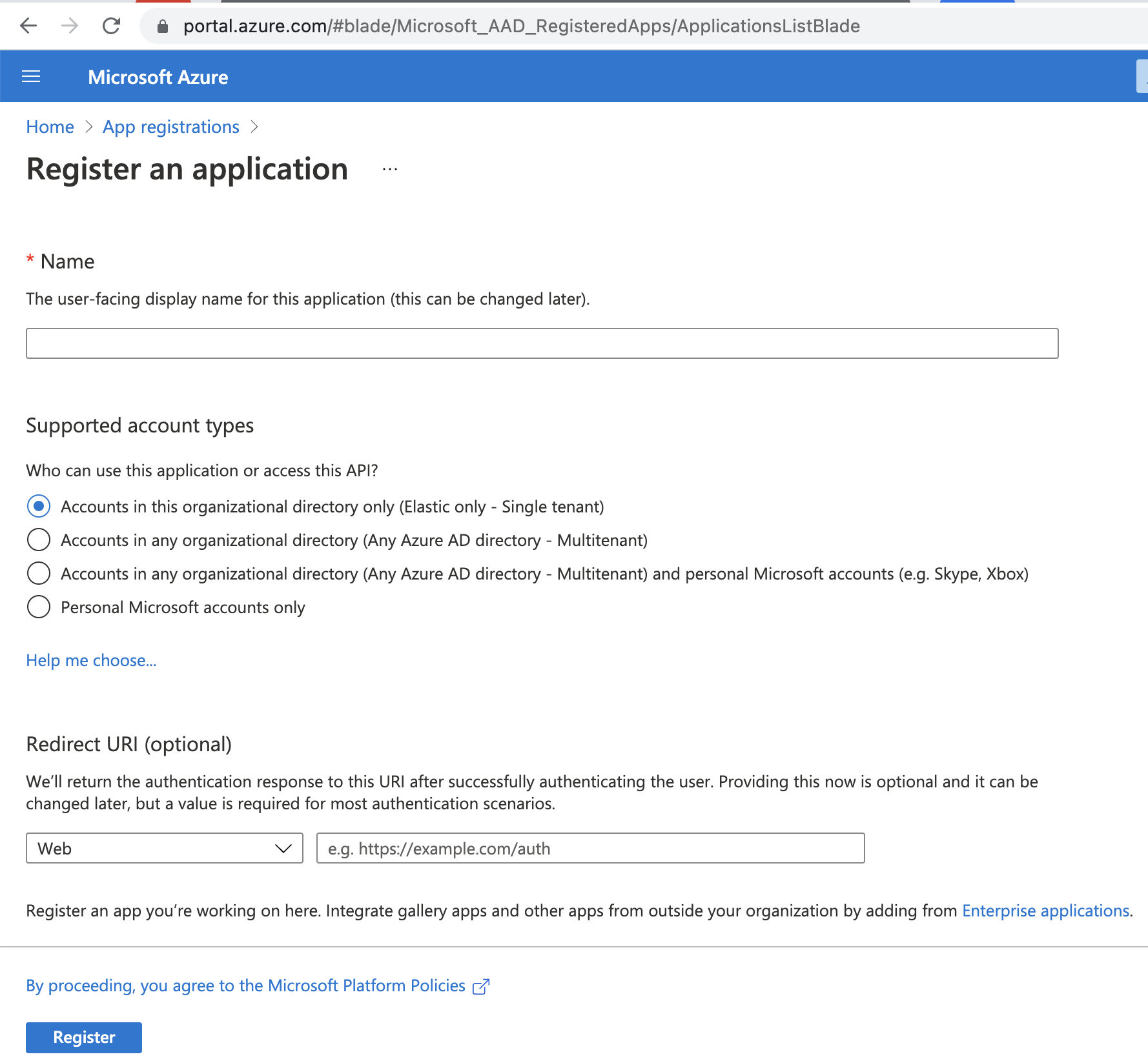

Before you create an email connector for Microsoft Exchange, you must create and register the client integration application on the Azure portal:
Register client application for MS Exchange

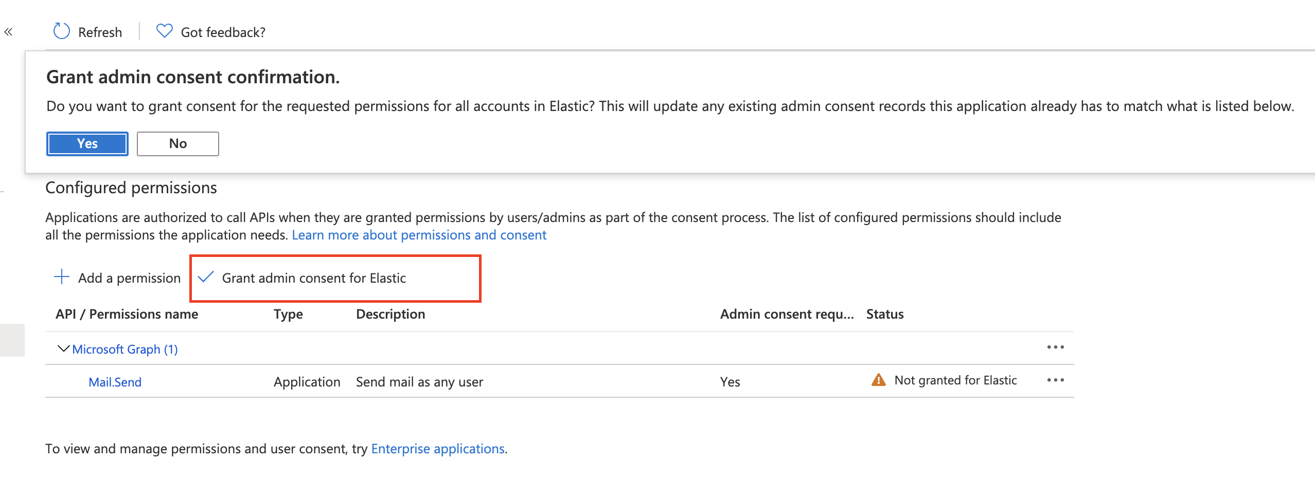

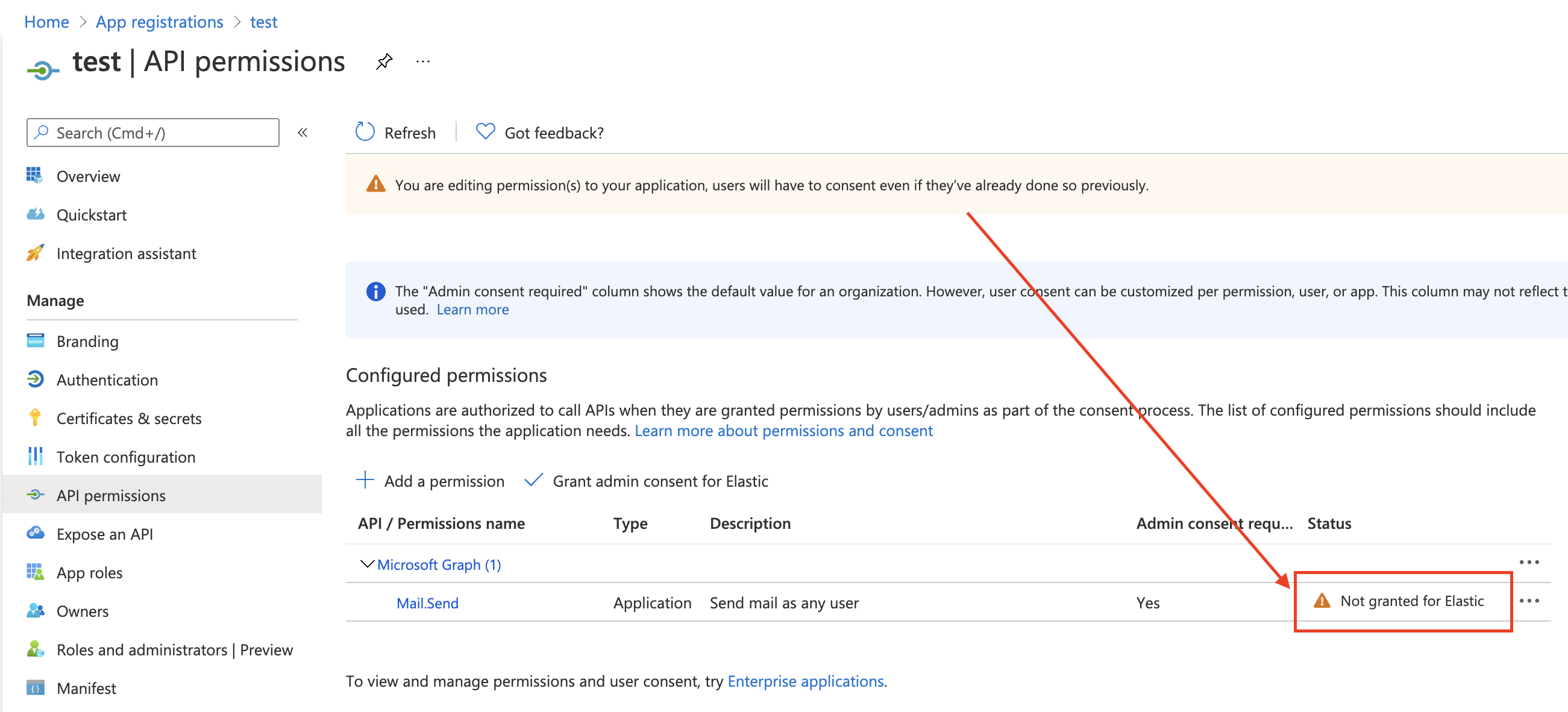

Add the "Mail.Send" permission for Microsoft Graph. The permission appears in the list with the status "Not granted for <your Azure active directory>":
MS Exchange "Mail.Send" not granted

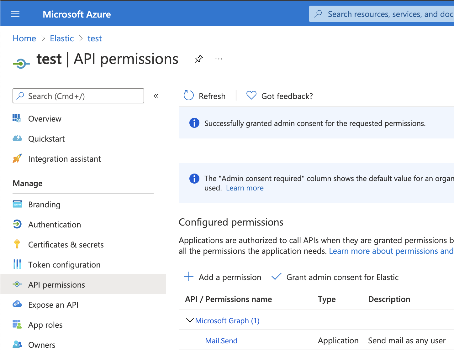

Click Grant admin consent for <your Azure active directory>.

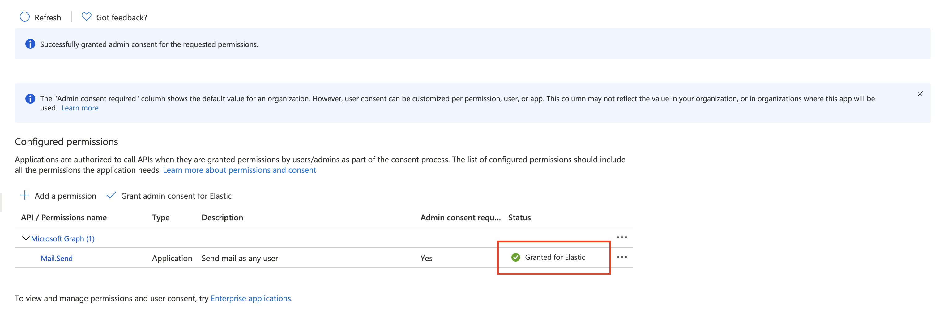

MS Exchange grant confirmation
Confirm that the status for the "Mail.Send" permission is now granted.

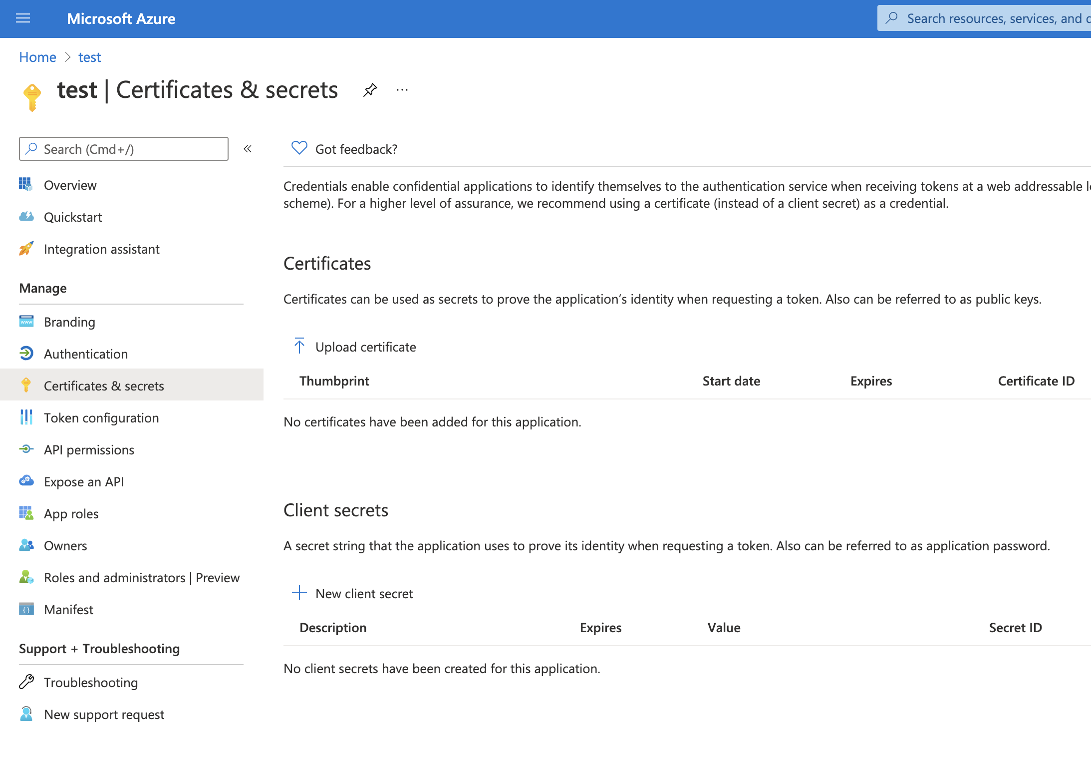

To configure the Client secret , open Manage > Certificates & secrets.
MS Exchange secrets configuration
Add a new client secret, then copy the value and put it to the proper field in the Microsoft Exchange email connector.

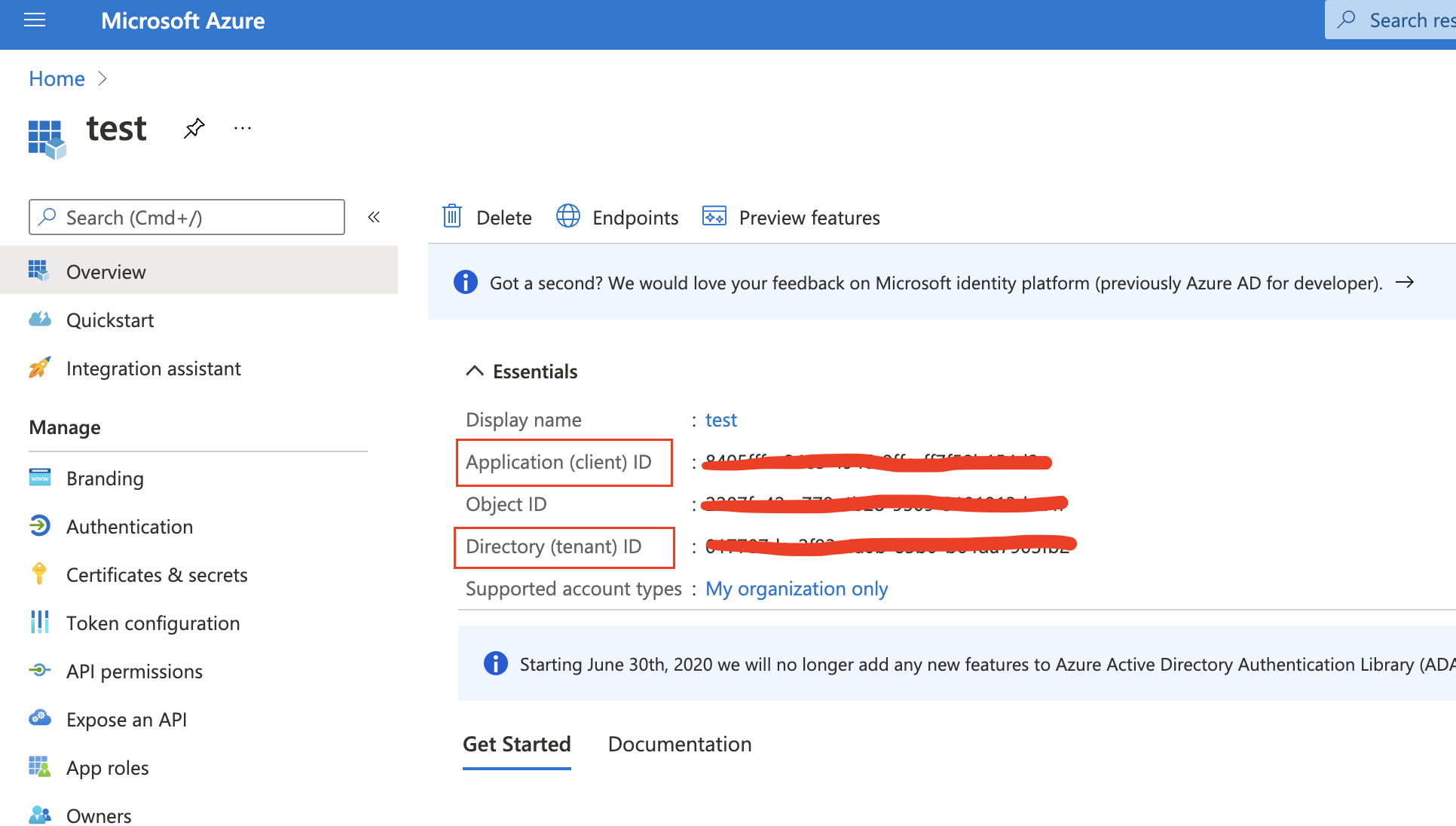

Configure Microsoft Exchange Client ID and Tenant ID
To find the application Client ID, open the Overview page.
MS Exchange Client ID and Tenant ID configuration
Copy and paste this values to the proper fields in the Microsoft Exchange email connector.
