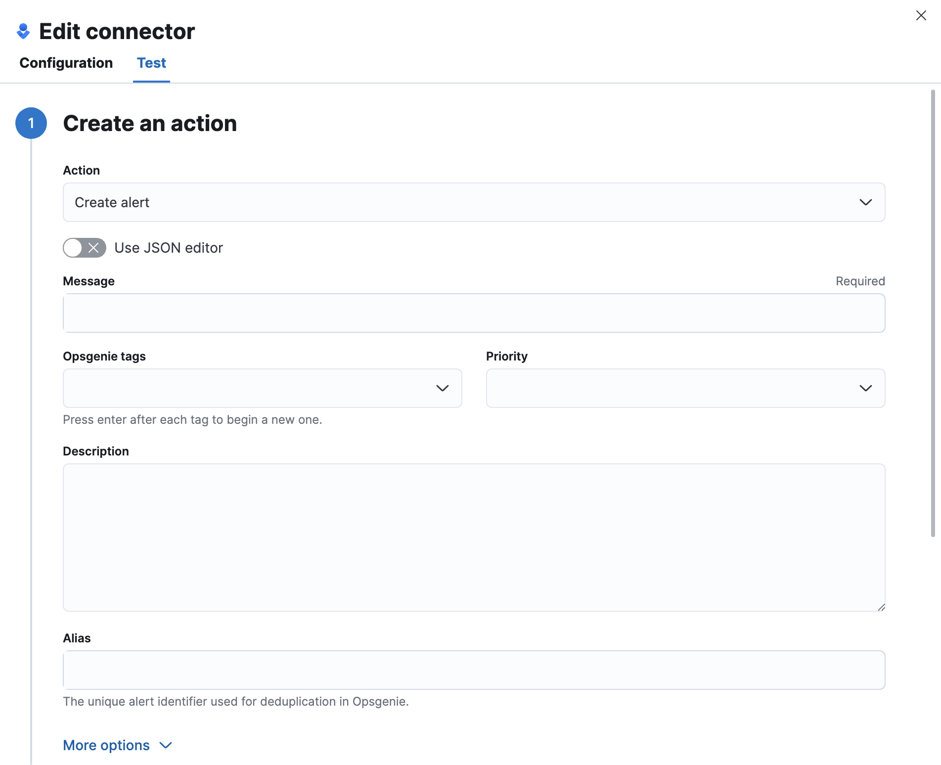

Create alert action
When you create a rule that uses an Opsgenie connector, its actions (with the exception of recovery actions) create Opsgenie alerts. You can test this type of action when you create or edit your connector:
Opsgenie create alert action test
You can configure the create alert action through the form view or using a JSON editor.
Form view
The create alert action form has the following configuration properties.
Message
The message for the alert (required).
Opsgenie tags
The tags for the alert (optional).
Priority
The priority level for the alert.
Description
A description that provides detailed information about the alert (optional).
Alias
The alert identifier, which is used for alert deduplication in Opsgenie. For more information, refer to the Opsgenie documentation (optional).
Entity
The domain of the alert (optional).
Source
The source of the alert (optional).
User
The display name of the owner (optional).
Note
Additional information for the alert (optional).

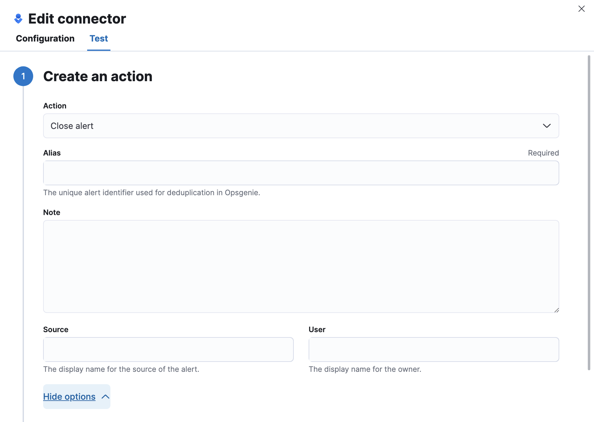

Close alert action
When you create a rule that uses an Opsgenie connector, its recovery actions close Opsgenie alerts. You can test this type of action when you create or edit your connector:
Opsgenie close alert action test
The close alert action has the following configuration properties.
Alias
The alert identifier, which is used for alert deduplication in Opsgenie (required). The alias must match the value used when creating the alert. For more information, refer to the Opsgenie documentation.
Note
Source
The display name of the source (optional).
User

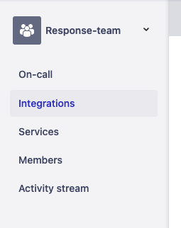

If you’re using a free trial, go to the Teams dashboard and select the appropriate team.
Opsgenie teams dashboard
Select the Integrations menu item, then select Add integration.

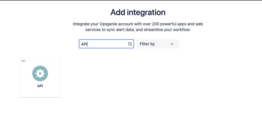

Search for API and select the API integration.
Opsgenie API integration

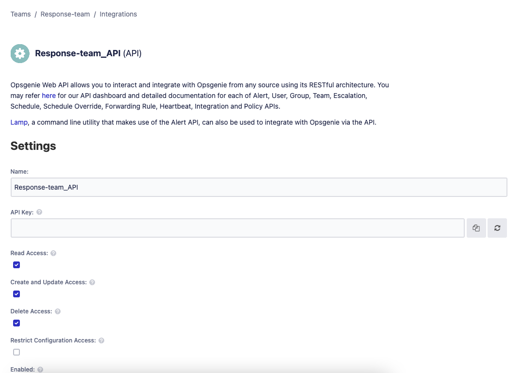

Configure the integration and ensure you record the API Key. This key will be used to populate the API Key field when creating the Kibana Opsgenie connector. Click Save Integration after you finish configuring the integration.
Opsgenie save integration
