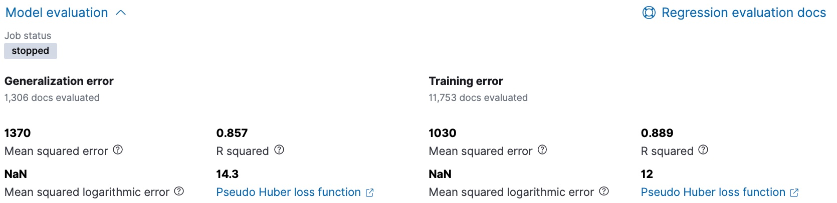

6. Evaluate the result
editUsing the data frame analytics features to gain insights from a data set is an iterative process. After you defined the problem you want to solve, and chose the analytics type that can help you to do so, you need to produce a high-quality data set and create the appropriate data frame analytics job. You might need to experiment with different configurations, parameters, and ways to transform data before you arrive at a result that satisfies your use case. A valuable companion to this process is the evaluate data frame analytics API, which enables you to evaluate the data frame analytics performance. It helps you understand error distributions and identifies the points where the data frame analytics model performs well or less trustworthily.
To evaluate the analysis with this API, you need to annotate your index that contains the results of the analysis with a field that marks each document with the ground truth. The evaluate data frame analytics API evaluates the performance of the data frame analytics against this manually provided ground truth.
You can measure how well the model has performed on your training data by using
the regression
evaluation type of the
evaluate data frame analytics API. The
mean squared error (MSE) value that the evaluation
provides you on the training data set is the training error. Training and
evaluating the model iteratively means finding the combination of model
parameters that produces the lowest possible training error.
Another crucial measurement is how well your model performs on unseen data. To assess how well the trained model will perform on data it has never seen before, you must set aside a proportion of the training set for testing (testing data). Once the model is trained, you can let it predict the value of the data points it has never seen before and compare the prediction to the actual value. This test provides an estimate of a quantity known as the model generalization error.
The regression evaluation type offers the following metrics to evaluate the model performance:
- Mean squared error (MSE)
- Mean squared logarithmic error (MSLE)
- Pseudo-Huber loss
- R-squared (R2)
Mean squared error
editMSE is the average squared sum of the difference between the true value and the predicted value. (Avg (predicted value-actual value)2).
editMSLE is a variation of mean squared error. It can be used for cases when the target values are positive and distributed with a long tail such as data on prices or population. Consult the Loss functions for regression analyses page to learn more about loss functions.
Pseudo-Huber loss
editPseudo-Huber loss metric
behaves as mean absolute error (MAE) for errors larger than a predefined value
(defaults to 1
) and as mean squared error (MSE) for errors smaller than the
predefined value. This loss function uses the delta
parameter to define the
transition point between MAE and MSE. Consult the
R-squared
editR-squared (R2) represents the goodness of fit and measures how much of the variation in the data the predictions are able to explain. The value of R2 are less than or equal to 1, where 1 indicates that the predictions and true values are equal. A value of 0 is obtained when all the predictions are set to the mean of the true values. A value of 0.5 for R2 would indicate that the predictions are 1 - 0.5(1/2) (about 30%) closer to true values than their mean.

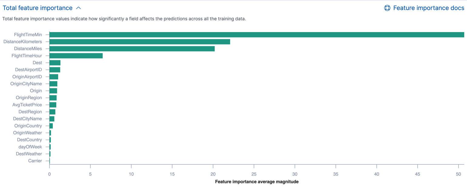

Feature importance
editFeature importance provides further information about the results of an analysis and helps to interpret the results in a more subtle way. If you want to learn more about feature importance, click here.

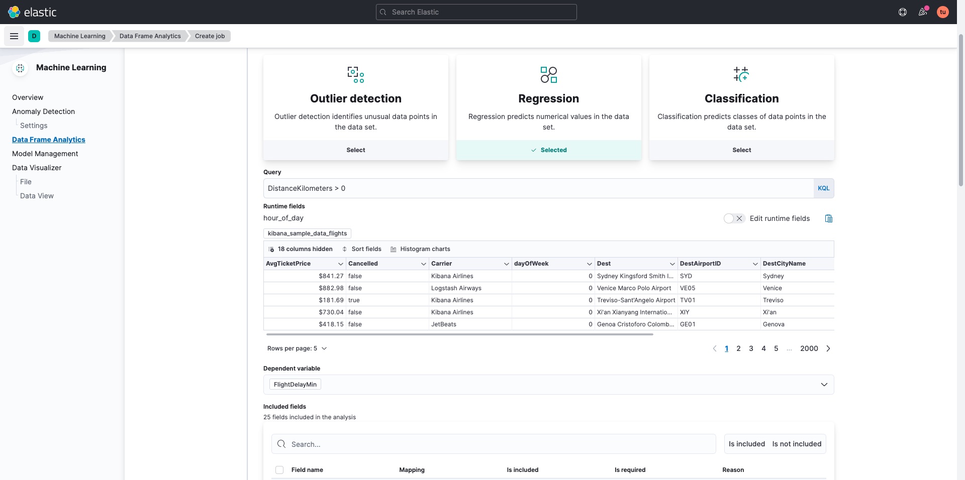

editTo predict the number of minutes delayed for each flight:
- Verify that your environment is set up properly to use machine learning features. The Elastic Stack security features require a user that has authority to create and manage data frame analytics jobs. See Setup and security.
Create a data frame analytics job.
You can use the wizard on the Machine Learning > Data Frame Analytics tab in Kibana or the create data frame analytics jobs API.
Choose
kibana_sample_data_flights
as the source index. -
Choose
regression
as the job type. - Optionally improve the quality of the analysis by adding a query that removes erroneous data. In this case, we omit flights with a distance of 0 kilometers or less.
Choose
FlightDelayMin
as the dependent variable, which is the field that we want to predict. -
Add
Cancelled
,FlightDelay
, andFlightDelayType
to the list of excluded fields. These fields will be excluded from the analysis. It is recommended to exclude fields that either contain erroneous data or describe thedependent_variable

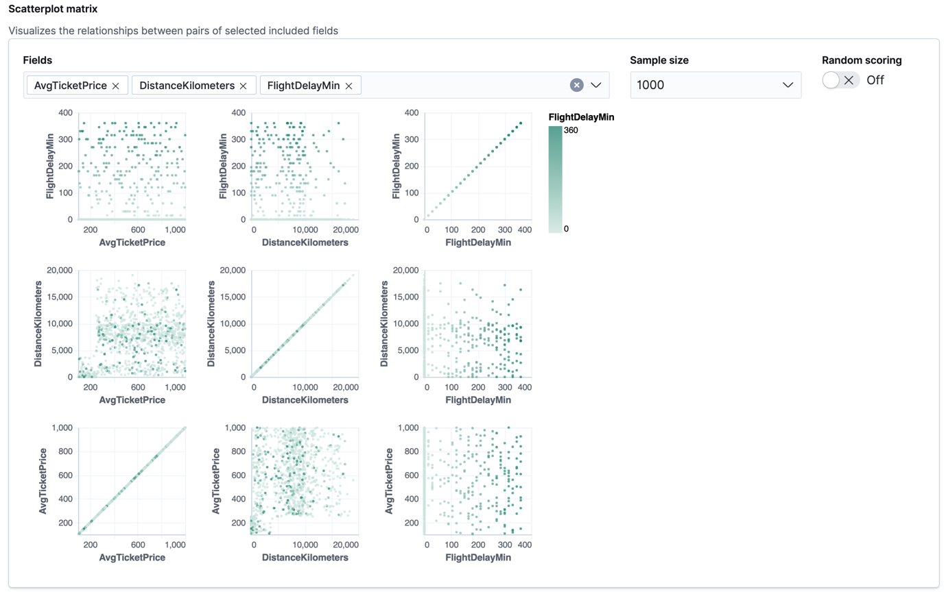

.The wizard includes a scatterplot matrix, which enables you to explore the relationships between the numeric fields. The color of each point is affected by the value of the dependent variable for that document, as shown in the legend. You can use this matrix to help you decide which fields to include or exclude from the analysis.
If you want these charts to represent data from a larger sample size or from a randomized selection of documents, you can change the default behavior. However, a larger sample size might slow down the performance of the matrix and a randomized selection might put more load on the cluster due to the more intensive query.
Choose a training percent of
90
which means it randomly selects 90% of the source data for training. - If you want to experiment with feature importance, specify a value in the advanced configuration options. In this example, we choose to return a maximum of 5 feature importance values per document. This option affects the speed of the analysis, so by default it is disabled.
- Use a model memory limit of at least 50 MB. If the job requires more than this amount of memory, it fails to start. If the available memory on the node is limited, this setting makes it possible to prevent job execution.
Add a job ID (such as
model-flight-delay-regression
) and optionally a job description. -
Add the name of the destination index that will contain the results of the analysis. In Kibana, the index name matches the job ID by default. It will contain a copy of the source index data where each document is annotated with the results. If the index does not exist, it will be created automatically.

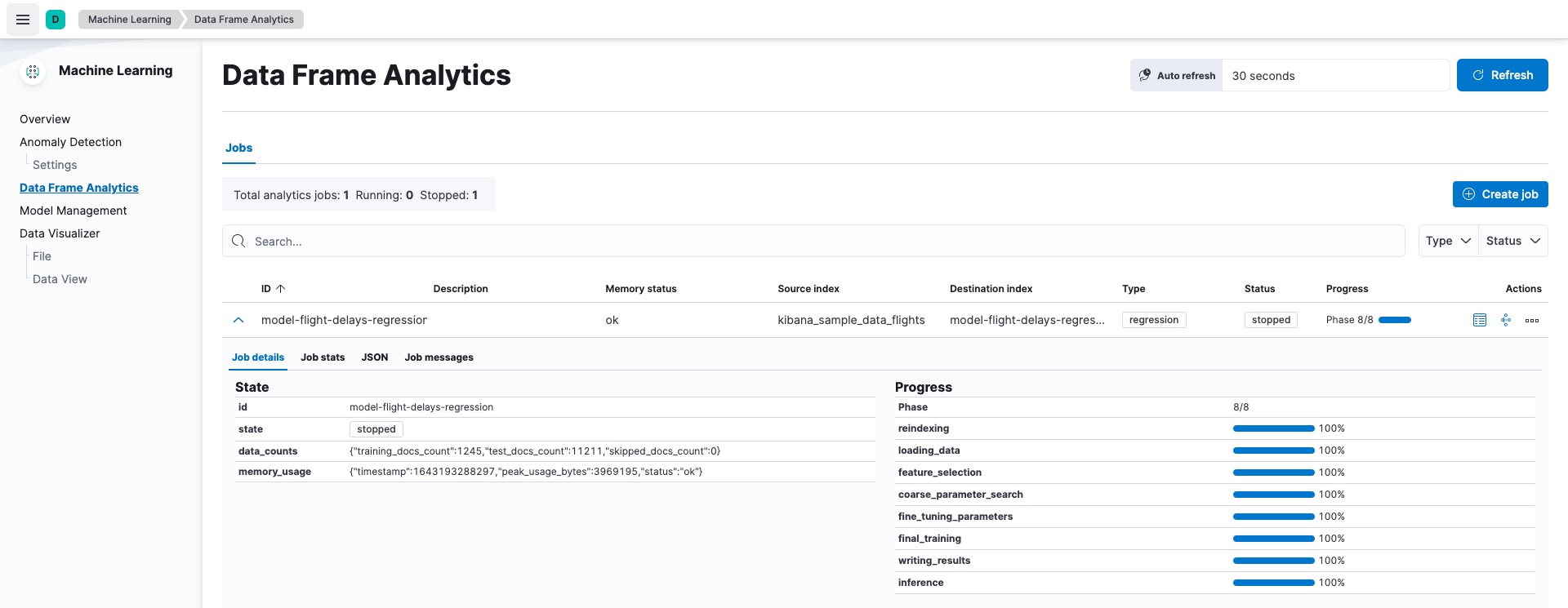

API example
POST _ml/data_frame/analytics/model-flight-delays-regression/_start
Check the job stats to follow the progress in Kibana or use the get data frame analytics jobs statistics API.
When the job stops, the results are ready to view and evaluate. To learn more about the job phases, see How data frame analytics jobs work.

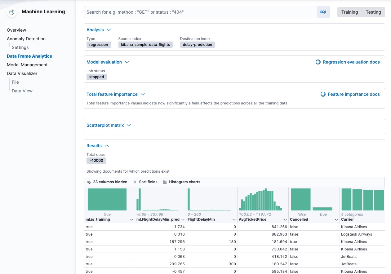

Viewing regression results
editNow you have a new index that contains a copy of your source data with predictions for your dependent variable.
When you view the results in Kibana, it shows the contents of the destination index in a tabular format. It also provides information about the analysis details, model evaluation metrics, total feature importance values, and a scatterplot matrix. Let’s start by looking at the results table:
In this example, the table shows a column for the dependent variable (FlightDelayMin
which contains the ground truth values that we are trying to predict. It also
shows a column for the prediction values (ml.FlightDelayMin_prediction
) and a
column that indicates whether the document was used in the training set
(ml.is_training
). You can filter the table to show only testing or training
data and you can select which fields are shown in the table. You can also enable
histogram charts to get a better understanding of the distribution of values in
your data.

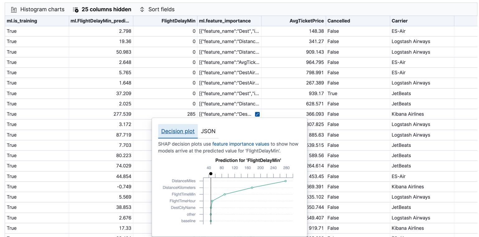

If you chose to calculate feature importance, the destination index also contains
ml.feature_importance
objects. Every field that is included in the
regression analysis (known as a feature of the data point) is assigned a feature importance
value. This value has both a magnitude and a direction (positive or negative),
which indicates how each field affects a particular prediction. Only the most
significant values (in this case, the top 5) are stored in the index. However,
the trained model metadata also contains the average magnitude of the feature importance
values for each field across all the training data. You can view this
summarized information in Kibana:
You can also see the feature importance values for each individual prediction in the form of a decision plot:
The decision path starts at a baseline, which is the average of the predictions for all the data points in the training data set. From there, the feature importance values are added to the decision path until it arrives at its final prediction. The features with the most significant positive or negative impact appear at the top. Thus in this example, the features related to the flight distance had the most significant influence on this particular predicted flight delay. This type of information can help you to understand how models arrive at their predictions. It can also indicate which aspects of your data set are most influential or least useful when you are training and tuning your model.
If you do not use Kibana, you can see summarized feature importance values by using the get trained model API and the individual values by searching the destination index.
API example
GET _ml/inference/model-flight-delays-regression*?include=total_feature_importance,feature_importance_baseline
The snippet below shows an example of the total feature importance details in the trained model metadata:
{ "count" : 1, "trained_model_configs" : [ { "model_id" : "model-flight-delays-regression-1601312043770", ... "metadata" : { ... "feature_importance_baseline" : { "baseline" : 47.43643652716527 }, "total_feature_importance" : [ { "feature_name" : "dayOfWeek", "importance" : { "mean_magnitude" : 0.38674590521018903, "min" : -9.42823116446923, "max" : 8.707461689065173 } }, { "feature_name" : "OriginWeather", "importance" : { "mean_magnitude" : 0.18548393012368913, "min" : -9.079576266629092, "max" : 5.142479101907649 } ...
The baseline for the feature importance decision path. It is the average of the prediction values across all the training data. |
The average of the absolute feature importance values for the |
The minimum feature importance value across all the training data for this field. |
The maximum feature importance value across all the training data for this field. |
To see the top feature importance values for each prediction, search the destination index. For example:
GET model-flight-delays-regression/_search
The snippet below shows a part of a document with the annotated results:
... "DestCountry" : "CH", "DestRegion" : "CH-ZH", "OriginAirportID" : "VIE", "DestCityName" : "Zurich", "ml": { "FlightDelayMin_prediction": 277.5392150878906, "feature_importance": [ { "feature_name": "DestCityName", "importance": 0.6285966753441136 }, { "feature_name": "DistanceKilometers", "importance": 84.4982943868267 }, { "feature_name": "DistanceMiles", "importance": 103.90011847132116 }, { "feature_name": "FlightTimeHour", "importance": 3.7119156097309345 }, { "feature_name": "FlightTimeMin", "importance": 38.700587425831365 } ], "is_training": true } ...
Lastly, Kibana provides a scatterplot matrix in the results. It has the same functionality as the matrix that you saw in the job wizard. Its purpose is to likewise help you visualize and explore the relationships between the numeric fields and the dependent variable in your data.
Evaluating regression results
editThough you can look at individual results and compare the predicted value
) to the actual value (FlightDelayMins
), you
typically need to evaluate the success of the regression model as a whole.
Kibana provides training error metrics, which represent how well the model performed on the training data set. It also provides generalization error metrics, which represent how well the model performed on testing data.
A mean squared error (MSE) of zero means that the models predicts the dependent variable with perfect accuracy. This is the ideal, but is typically not possible. Likewise, an R-squared value of 1 indicates that all of the variance in the dependent variable can be explained by the feature variables. Typically, you compare the MSE and R-squared values from multiple regression models to find the best balance or fit for your data.
For more information about the interpreting the evaluation metrics, see 6. Evaluate the result.
You can alternatively generate these metrics with the data frame analytics evaluate API.

POST _ml/data_frame/_evaluate { "index": "model-flight-delays-regression", "query": { "bool": { "filter": [{ "term": { "ml.is_training": true } }] } }, "evaluation": { "regression": { "actual_field": "FlightDelayMin", "predicted_field": "ml.FlightDelayMin_prediction", "metrics": { "r_squared": {}, "mse": {}, "msle": {}, "huber": {} } } } }
Calculates the training error by evaluating only the training data. |
The field that contains the actual (ground truth) value. |
The field that contains the predicted value. |
The API returns a response like this:
{ "regression" : { "huber" : { "value" : 30.216037330465102 }, "mse" : { "value" : 2847.2211476422967 }, "msle" : { "value" : "NaN" }, "r_squared" : { "value" : 0.6956530017255125 } } }
Next, we calculate the generalization error:
POST _ml/data_frame/_evaluate { "index": "model-flight-delays-regression", "query": { "bool": { "filter": [{ "term": { "ml.is_training": false } }] } }, "evaluation": { "regression": { "actual_field": "FlightDelayMin", "predicted_field": "ml.FlightDelayMin_prediction", "metrics": { "r_squared": {}, "mse": {}, "msle": {}, "huber": {} } } } }
