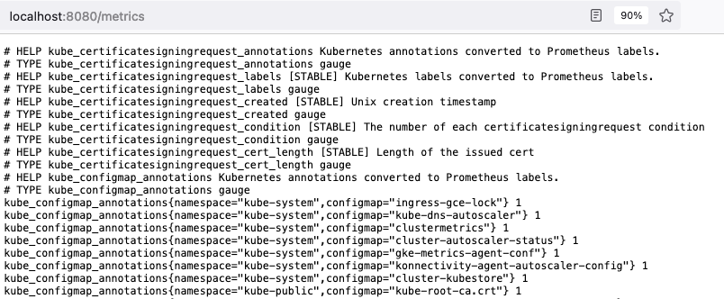

  7. Now, open up a web browser to address localhost:8080/metrics. If things are working properly, you will see a flow of metrics data from your cluster.
    KSM metrics data

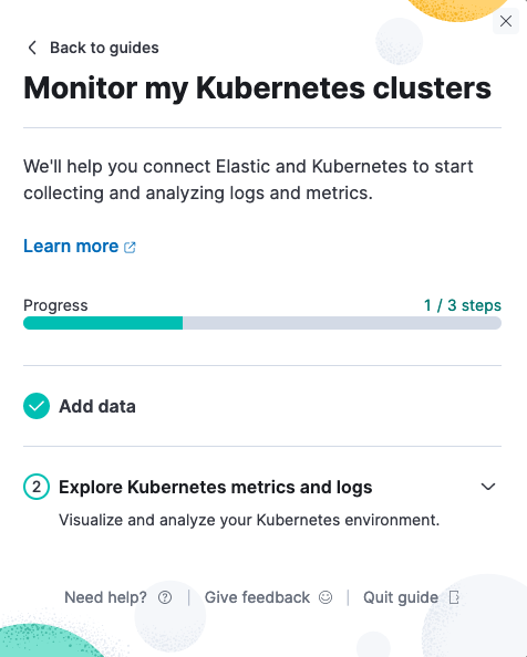

  1. Choose the Monitor Kubernetes clusters card. The guide opens on the first step.
    Observe my Kubernetes infrastructure - Step 1

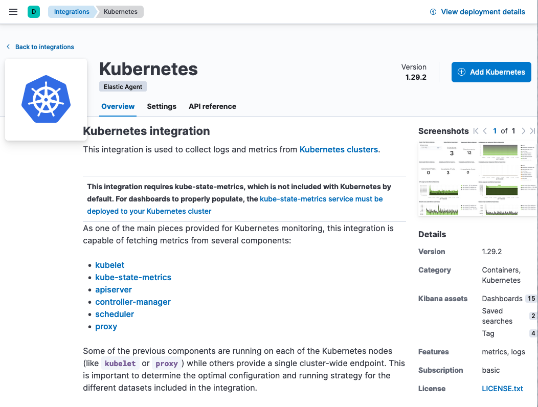

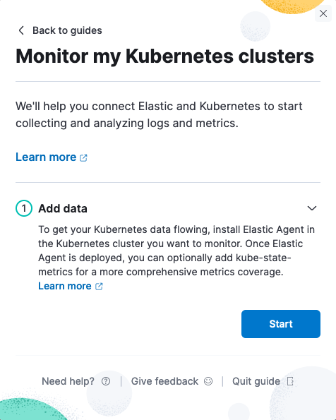

  2. In the guide, on the Add data tab, select Start. The Elastic Kubernetes integration page opens.
  3. Select Add Kubernetes, and you’re ready to add your first integration.

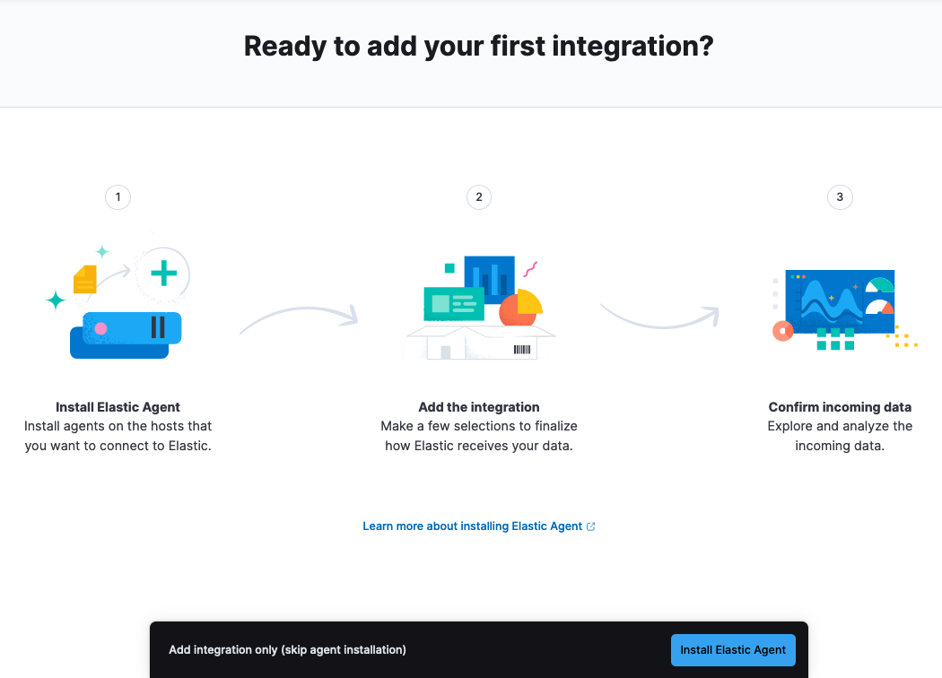

  1. On the Ready to add your first integration? page, select Install Elastic Agent.
  2. Follow the steps in the guide to configure and enroll Elastic Agent in Fleet:

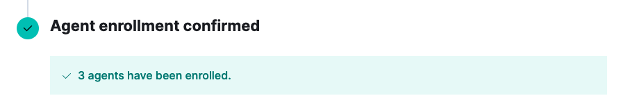

  3. In the integration setup guide, wait for confirmation that Elastic Agent is enrolled in Fleet. This can take a few minutes.
    Agent enrollment confirmed

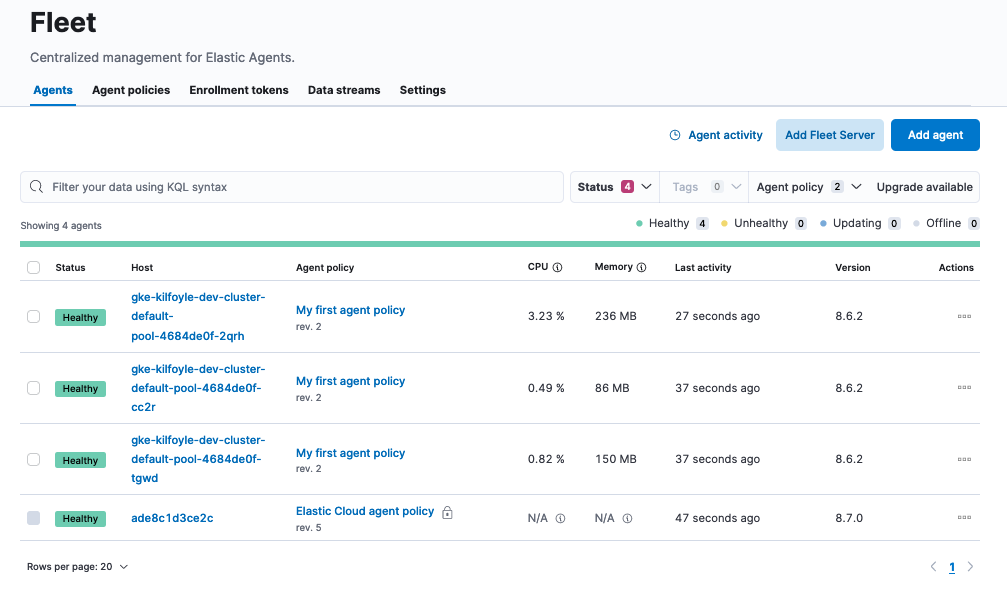

    You can also view the status of your Elastic Agents at any time by navigating in Kibana to the Fleet page. Our test Kubernetes cluster has three nodes, so three Elastic Agents are configured.
    Fleet page showing enrolled Elastic Agents

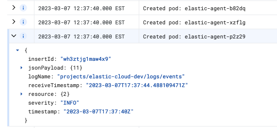

    Your Kubernetes cluster logs should also show that the Elastic Agent pods were created successfully. Filter by elastic-agent to see just the applicable logs:
    Cluster logs showing three Elastic Agent pods were created

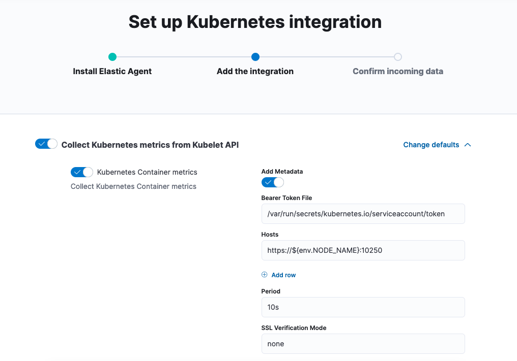

  2. Choose the type of metrics and logs that you want to monitor. If you like, you can leave all of the defaults for now and adjust these settings later to suit your needs.
    Configure the integration

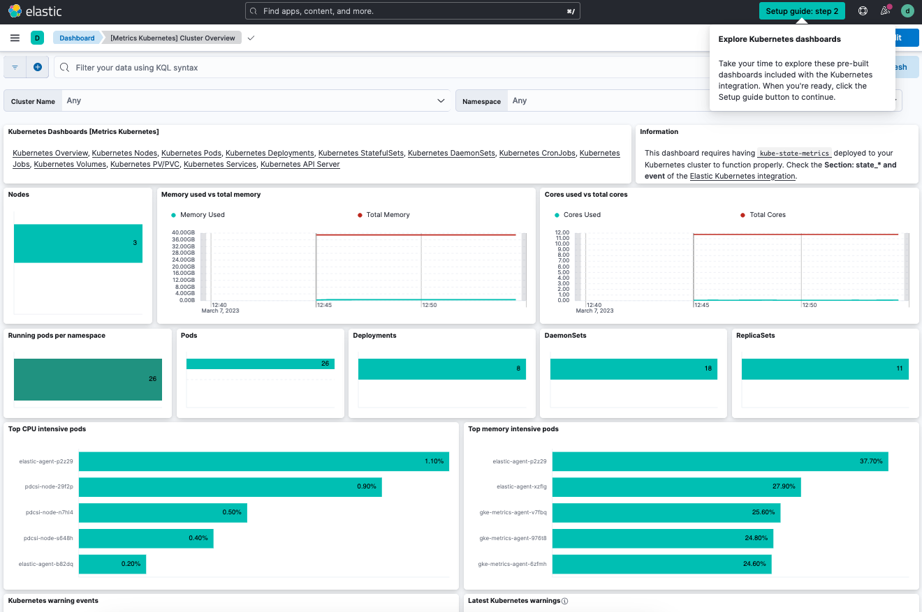

  2. In the guide, on the Explore Kubernetes metrics and logs tab, select Start. The Kibana [Metrics Kubernetes] Cluster Overview dashboard opens.
    Metrics Kubernetes Cluster Overview dashboard
    You can use the dashboard filters to drill down to a specific cluster or namespace. You can also filter the time period for the metrics to any range, either absolute or relative to the current time.

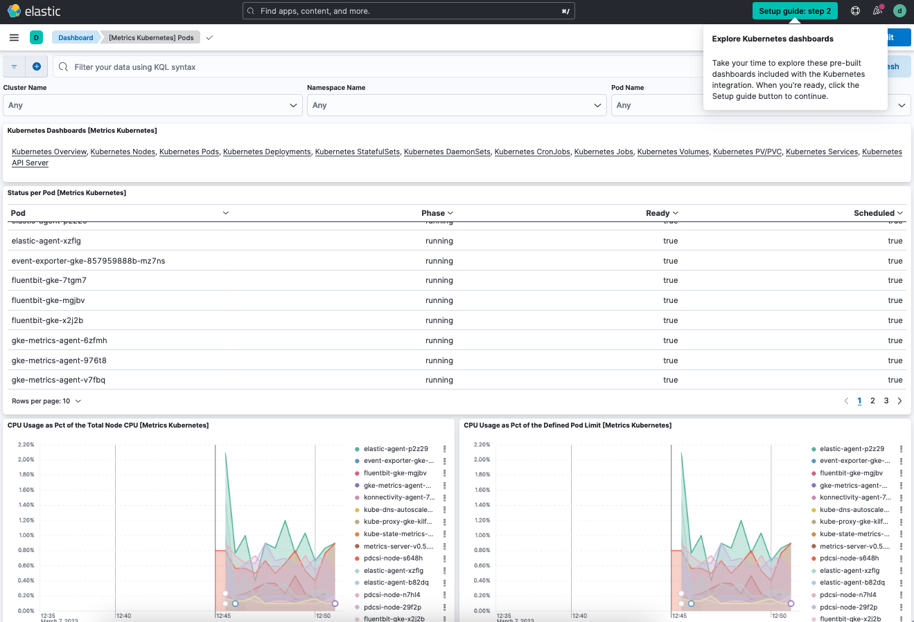

    For example, on the Kubernetes Pods dashboard, the default visualizations capture the pods status, CPU usage, memory usage, and network traffic:
    Metrics Kubernetes Pods dashboard

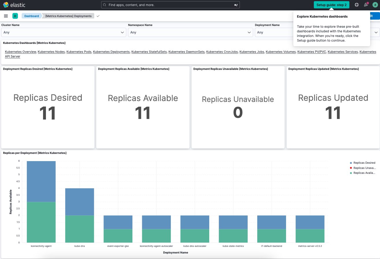

    On the Kubernetes Deployments dashboard, you can view all deployments and replicas: desired, available, unavailable, and updated.
    Metrics Kubernetes Deployments dashboard

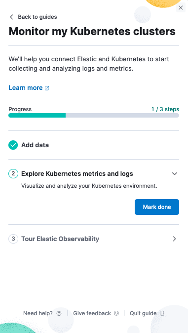

  4. On the Elastic banner, select Setup guide: step 2. The guide opens on the second step.
  5. Since you’ve now tried out a few Kibana dashboards, select Mark done.
