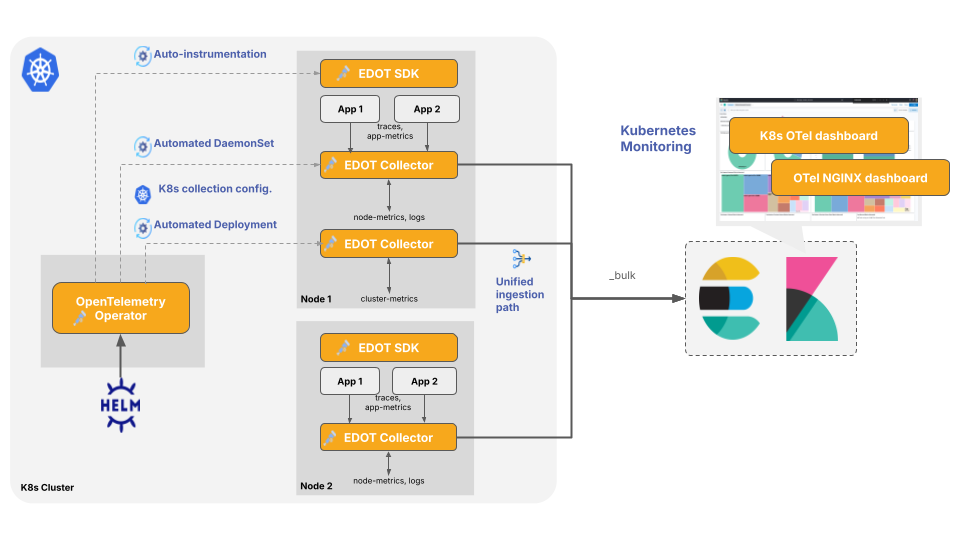

Elastic recently released its Elastic Distributions of OpenTelemetry (EDOT) which have been developed to enhance the capabilities of standard OpenTelemetry distributions and improve existing OpenTelemetry support from Elastic. EDOT helps Elastic deliver its new Unified OpenTelemetry Experience. SRE’s are no longer burdened with a set of tedious steps instrumenting and ingesting OTel data into Observability. SREs get a simple and frictionless way to instrument the OTel collector, and applications, and ingest all the OTel data into Elastic. The components of this experience include: (detailed in the overview blog)
  • Elastic Distributions for OpenTelemetry (EDOT)
  • Elastic’s configuration for the OpenTelemetry Operator providing:
    • OTel Lifecycle management for the OTel collector and SDKs
    • Auto instrumentation of apps, which most developers will not instrument
  • Pre-packaged receivers, processors, exporters, and configuration for the OTel Kubernetes Collector
  • Out-of-the-box OTel-based K8S dashboards for metrics and logs
  • Discovered inventory views for services, hosts, and containers
  • Direct OTel ingest into Elasticsearch (by passing APM) - all your data (logs, metrics, and traces) is now stored in Elastic’s Search AI Lake

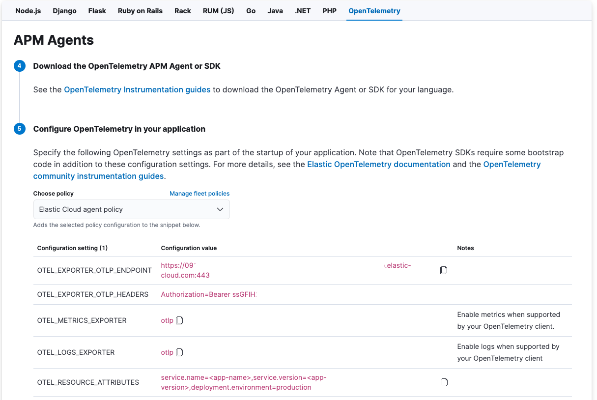

To find the authentication, you can find it in the integrations section of Elastic. More information is also available in the documentation.

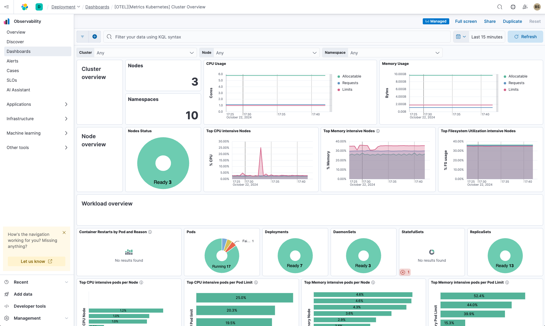

Kubernetes metrics:
Using an out-of-the-box dashboard, you can see node metrics, overall cluster metrics, and status across pods, deployments, etc.

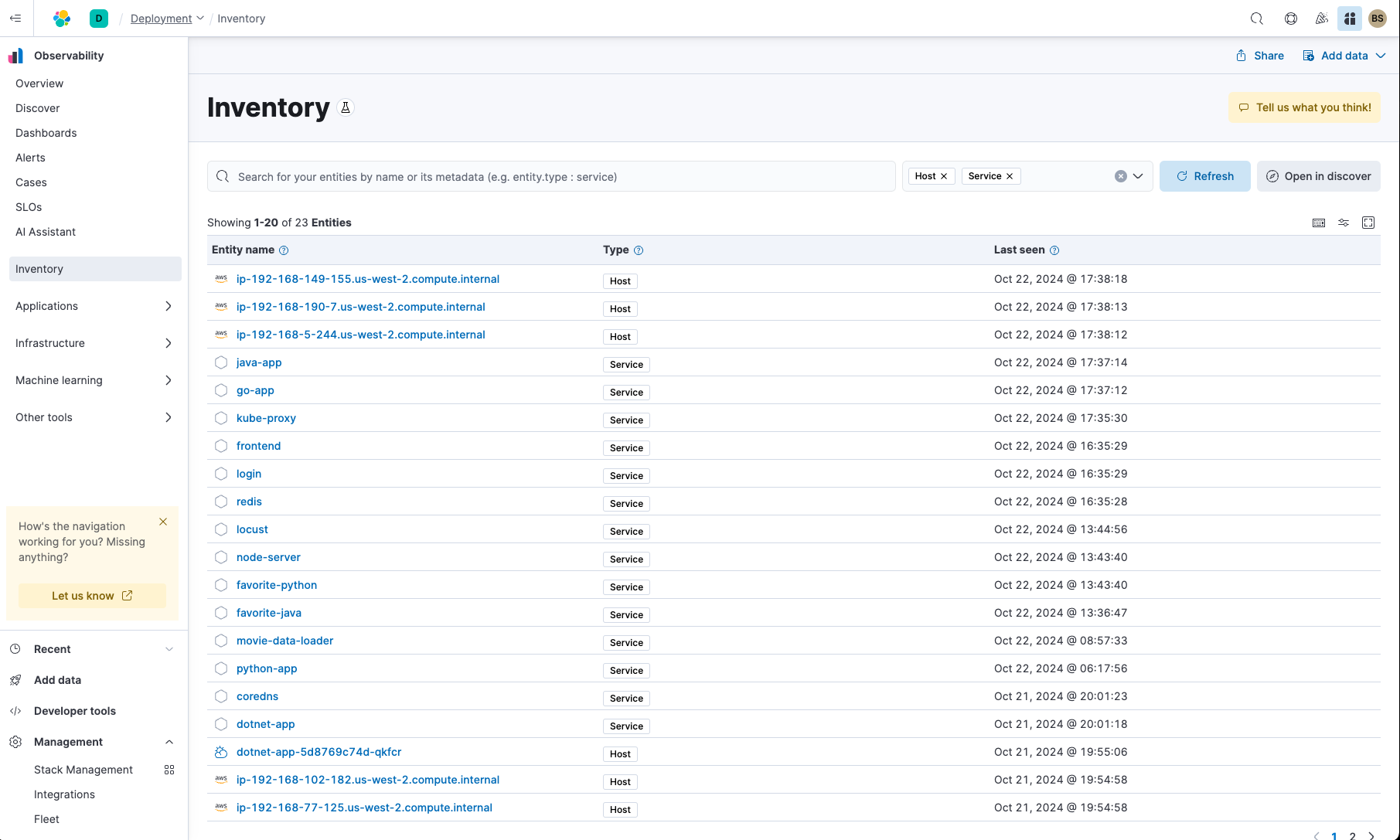

Discovered Inventory for Hosts, services, and containers:
This can be found at Observability->Inventory on the UI

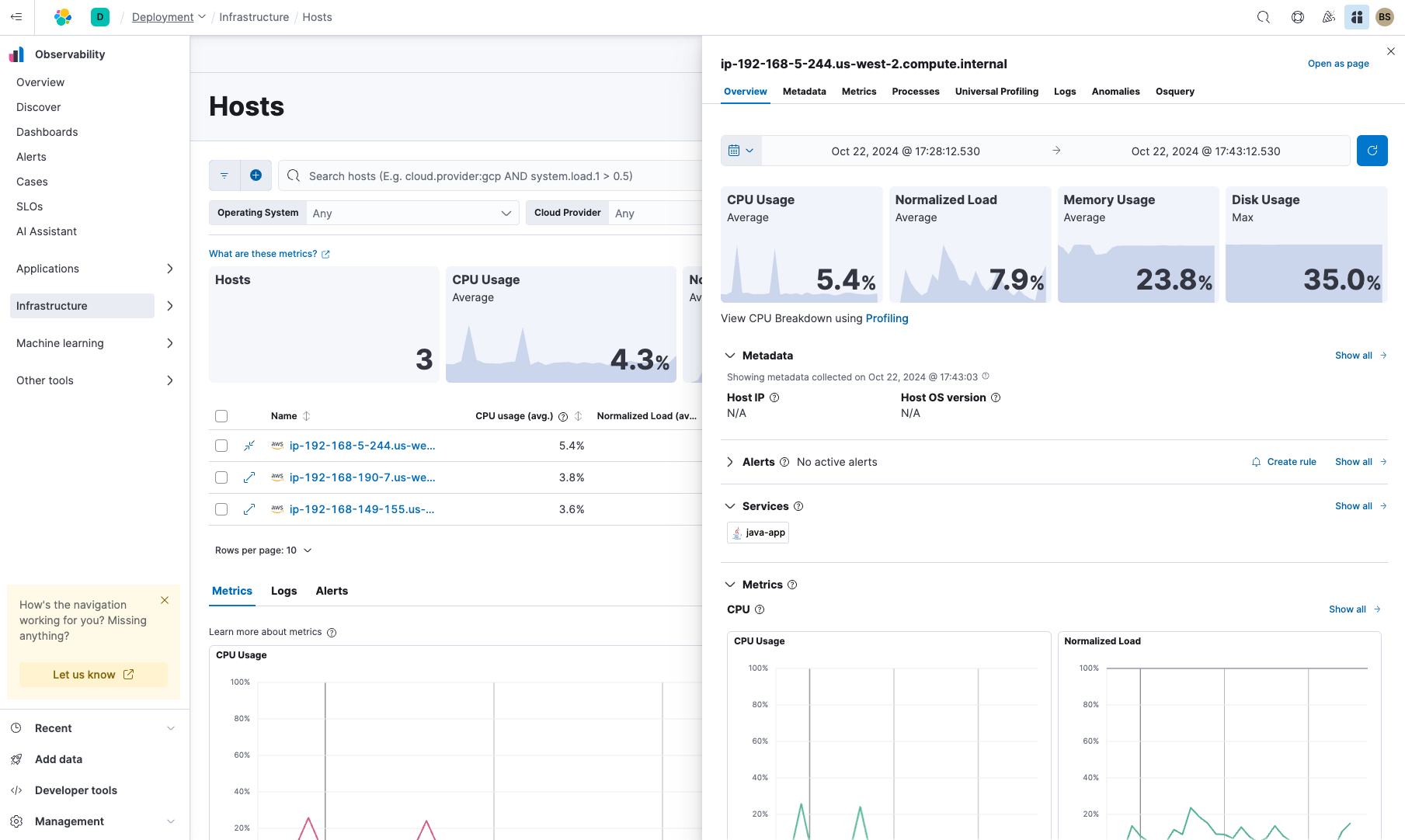

Detailed metrics, logs, and processor info on hosts:
This can be found at Observability->Infrastructure->Hosts

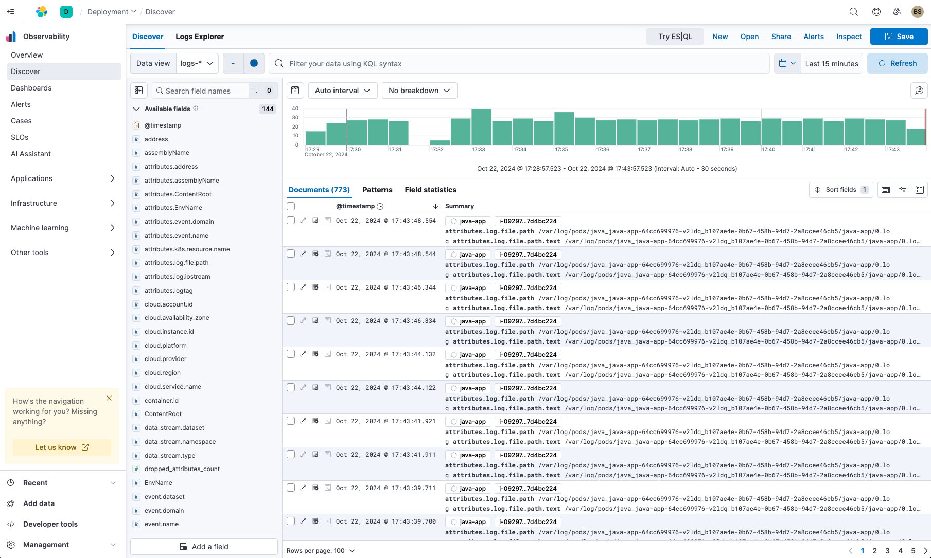

K8S and application logs in Elastic’s New Discover (called Explorer)
This can be found on Observability->Discover

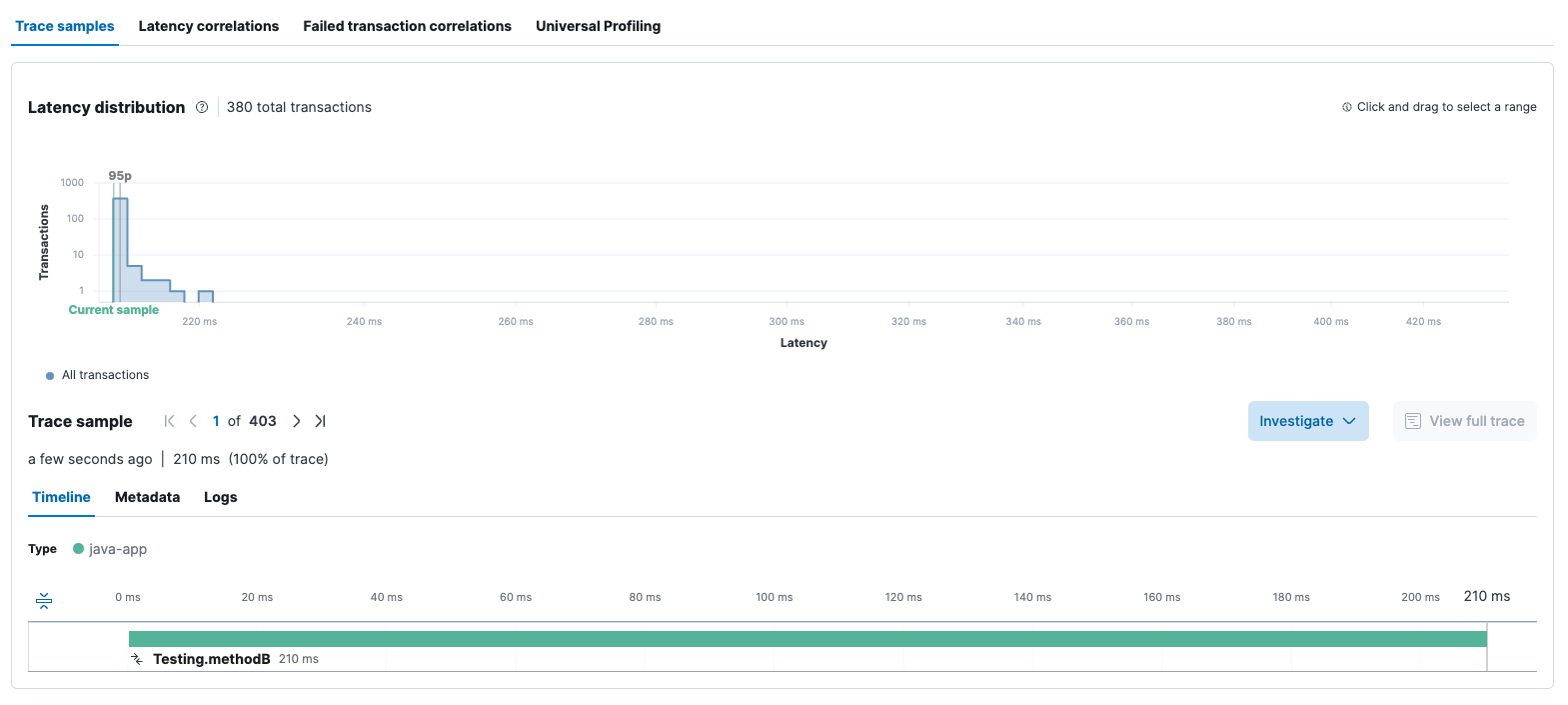

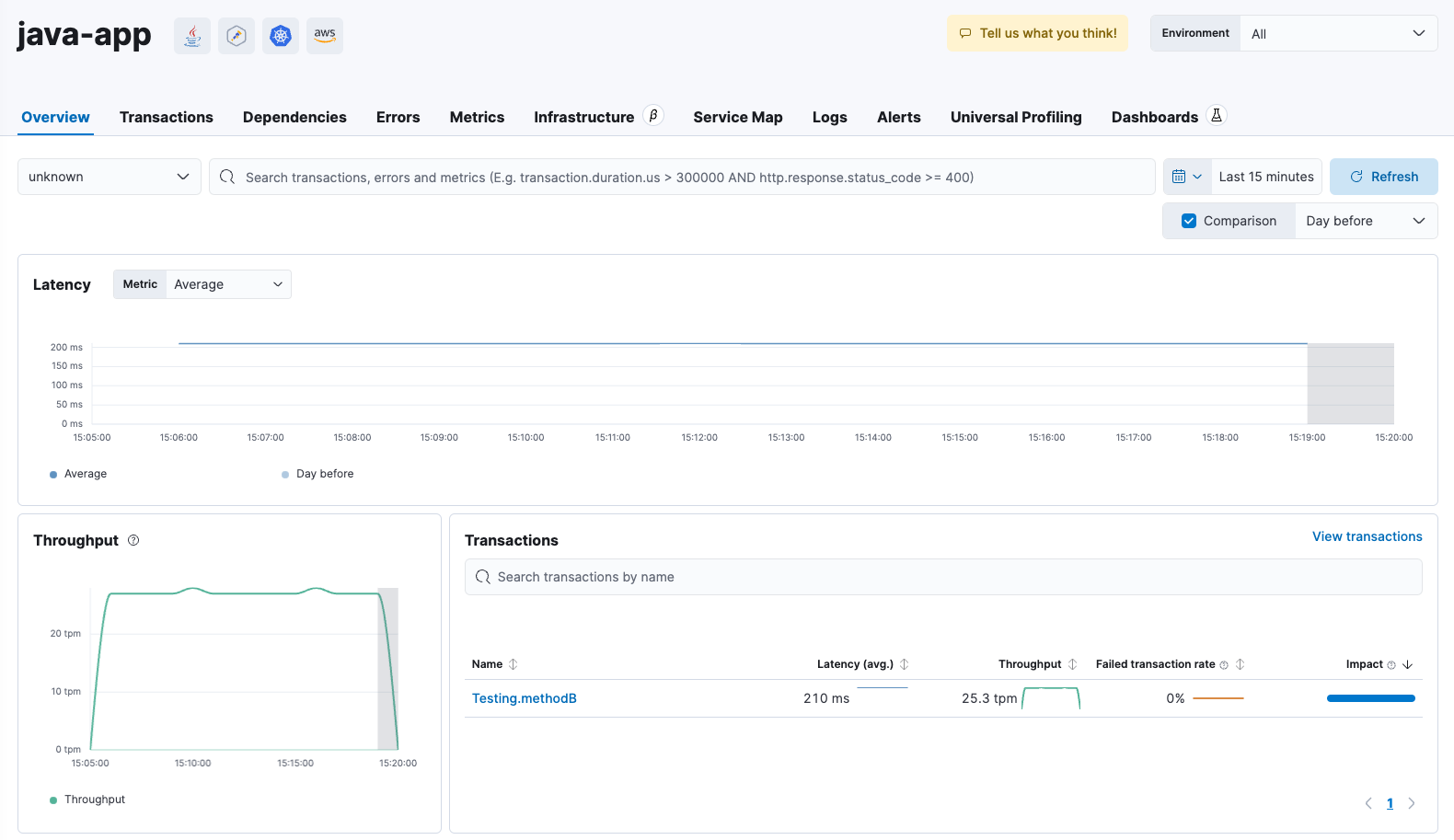

Application Service views (logs, metrics, and traces):
This can be found on Observability->Application
Then select the service and drill down into different aspects.
Above we are showing how traces are shown using Native OTel data.

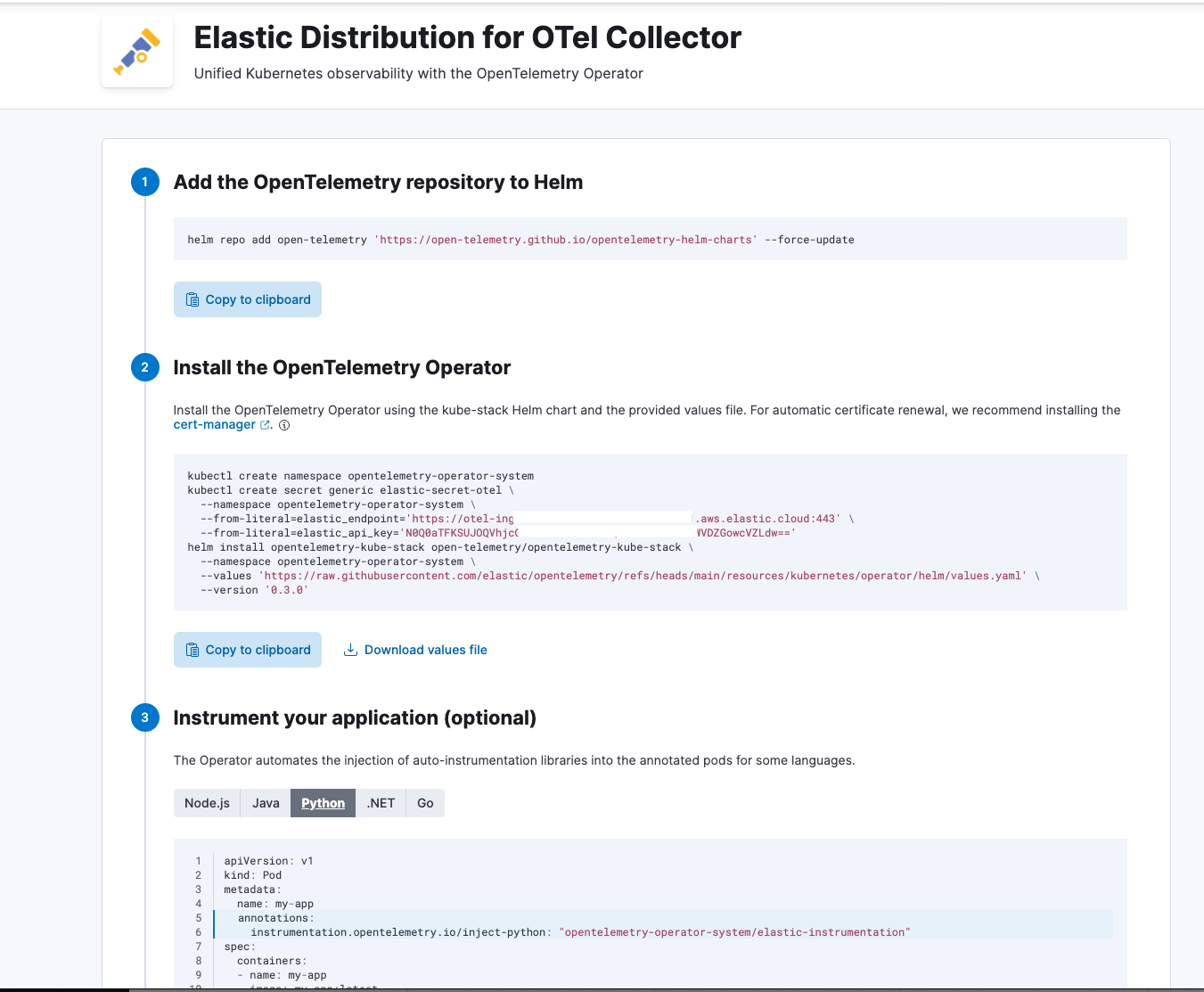

Step 0. Follow the commands listed in the UI
Under Add data->Kubernetes->Kubernetes Monitoring with EDOT
You will find the following instructions, which we will follow here.
Step 1. Install the EDOT config for the OpenTelemetry Operator
Run the following commands. Please make sure that you have already authenticated in your K8s Cluster and this is where you will run the helm commands provided below.
# Install helm repo needed
helm repo add open-telemetry https://open-telemetry.github.io/opentelemetry-helm-charts --force-update
# Install needed secrets. Provide the Elasticsearch Endpoint URL and API key you have noted in previous steps
kubectl create ns opentelemetry-operator-system
kubectl create -n opentelemetry-operator-system secret generic elastic-secret-otel \
    --from-literal=elastic_endpoint='YOUR_ELASTICSEARCH_ENDPOINT' \
    --from-literal=elastic_api_key='YOUR_ELASTICSEARCH_API_KEY'
# Install the EDOT Operator
helm install opentelemetry-kube-stack open-telemetry/opentelemetry-kube-stack --namespace opentelemetry-operator-system --create-namespace --values https://raw.githubusercontent.com/elastic/opentelemetry/refs/heads/main/resources/kubernetes/operator/helm/values.yaml --version 0.3.0
The values.yaml file configuration can be found here.
Step 1b: Ensure OTel data is arriving in Elastic
The simplest way to check is to go to Menu > Dashboards > [OTEL][Metrics Kubernetes] Cluster Overview, and ensure you see the following dashboard being populated

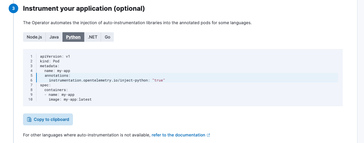

Step 2: Annotate the application with auto-instrumentation
For this example, we’re only going to annotate one service, the favorite-java service in the Elastiflix application
Use the following commands to initiate auto-instrumentation:
#Annotate Java namespace
kubectl annotate namespace java instrumentation.opentelemetry.io/inject-java="opentelemetry-operator-system/elastic-instrumentation"
#Restart the java-app to get the new annotation
kubectl rollout restart deployment java-app -n java
You can also modify the yaml for your pod with the annotation
metadata:
 annotations:
   instrumentation.opentelemetry.io/inject-python: "true"
These instructions are provided in the UI:
Check out the service data in Elastic APM
Once the OTel data is in Elastic, you can see:
