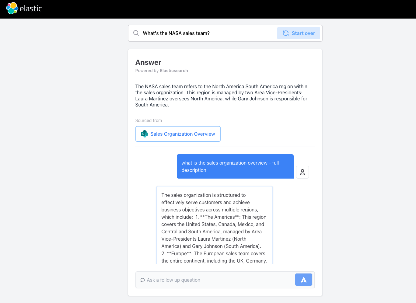

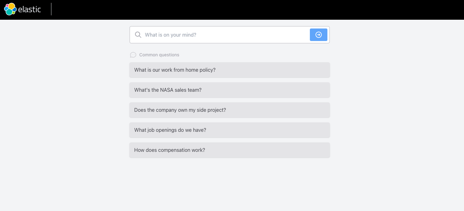

The first item that you will need to get up and running is the ChatBotApp, and once up you should see the following:
As you select some of the questions you will set a response based on the index that was created in Elasticsearch when the app initializes. Additionally there will be queries that are made to LLMs.

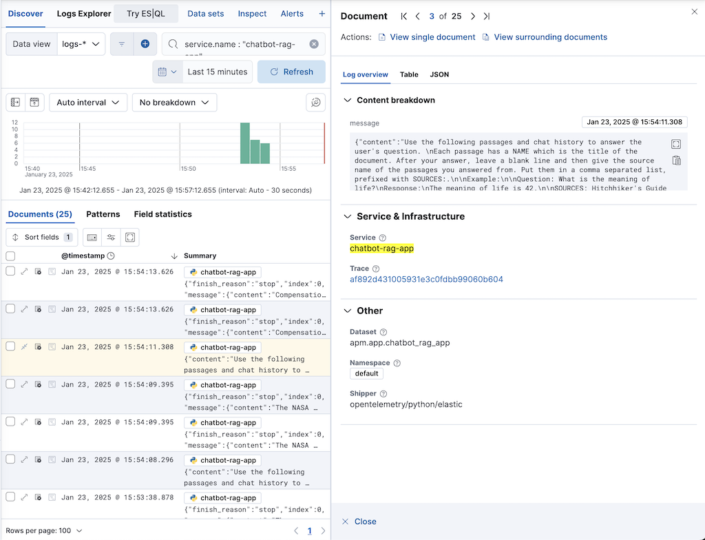

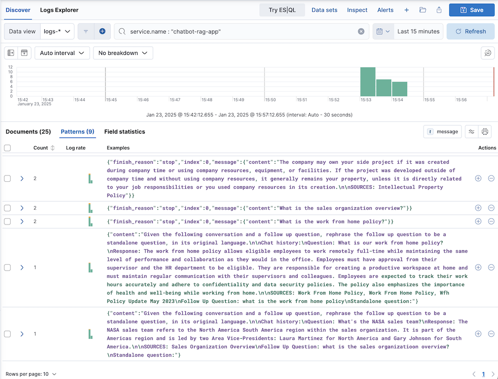

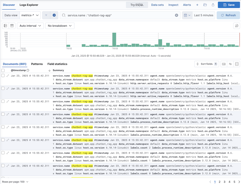

Logs:
In Discover you will see logs from the Chatbotapp, and be able to analyze the application logs, any specific log patterns, which saves you time in analysis.

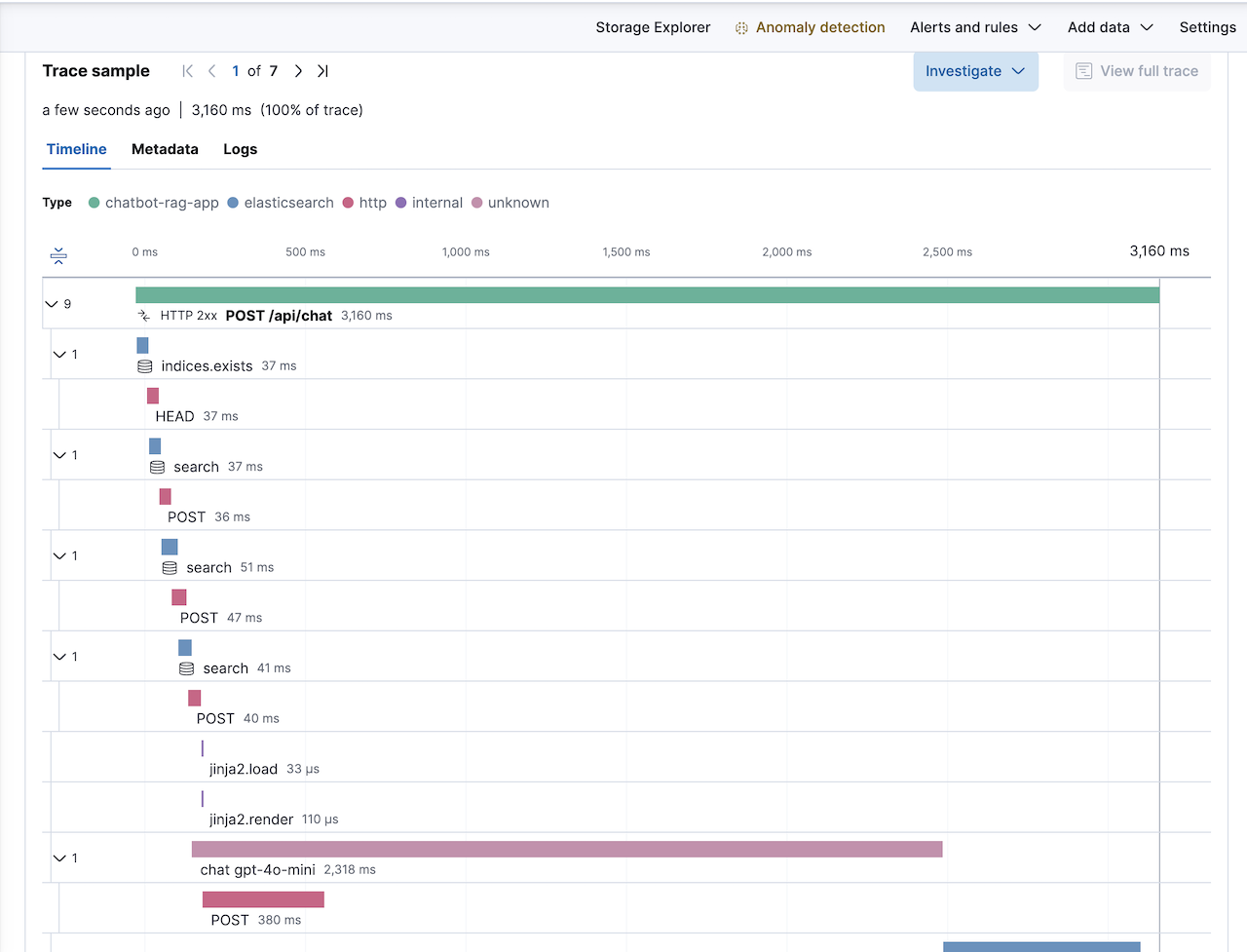

Traces:
In Elastic Observability APM, you can also see tha chatbot details, which include transactions, dependencies, logs, errors, etc.
When you look at traces, you will be able to see the chatbot interactions in the trace.
  1. You will see the end to end http call
  2. Individual calls to elasticsearch
  3. Specific calls such as invoke actions, and calls to the LLM
You can also get individual details of the traces, and look at related logs, and metrics related to that trace,

In addition to logs, and traces, any instrumented metrics will also get ingested into Elastic.

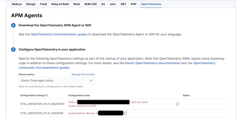

You can find these in the Elastic Cloud under
integrations->APM
Envs for sending the OTel instrumentation you will need the following:
OTEL_EXPORTER_OTLP_ENDPOINT="https://123456789.apm.us-west-2.aws.cloud.es.io:443"
OTEL_EXPORTER_OTLP_HEADERS="Authorization=Bearer%20xxxxx"
