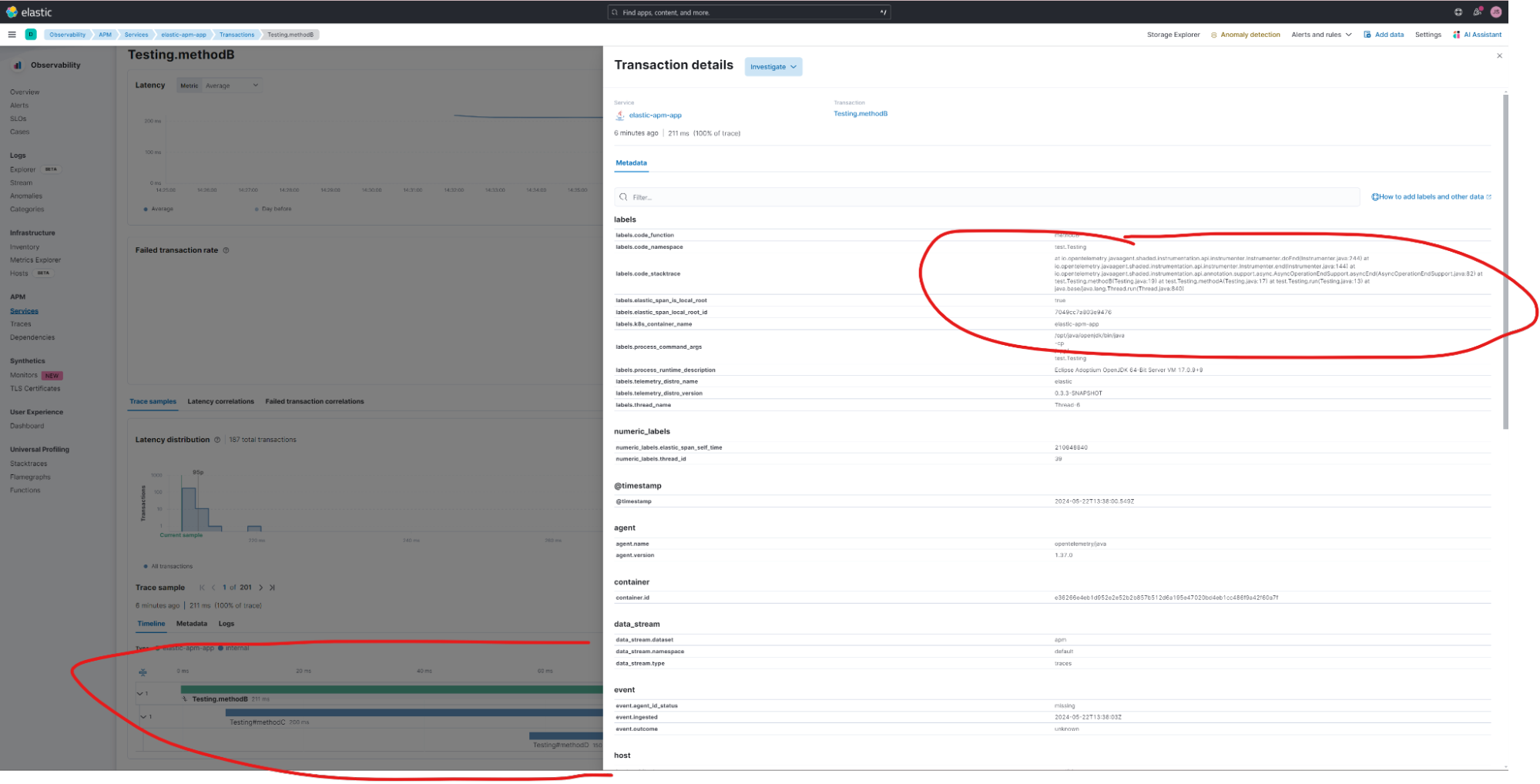

I’ve included environment for switching on several features in the agent, including
  1. ELASTIC_APM_PROFILING_INFERRED_SPANS_ENABLED to switch on the inferred spans implementation feature described in this blog
  2. Span stack traces are automatically captured if the span takes more than ELASTIC_OTEL_SPAN_STACK_TRACE_MIN_DURATION (default would be 5ms)
Adding in the annotation ...
metadata:
  annotations:
    instrumentation.opentelemetry.io/inject-java: "elastic-otel"
... to the pod yaml gets the application traced, and displayed in the Elastic APM UI, including the inferred child spans and stack traces
The additions from the features mentioned above are circled in red - inferred spans (for methodC and methodD) bottom left, and the stack trace top right. (Note that the pod included the
OTEL_INSTRUMENTATION_METHODS_INCLUDE
environment variable set to
"test.Testing[methodB]"
so that traces from methodB are shown; for pod configuration see the "Trying it" section in part 1)

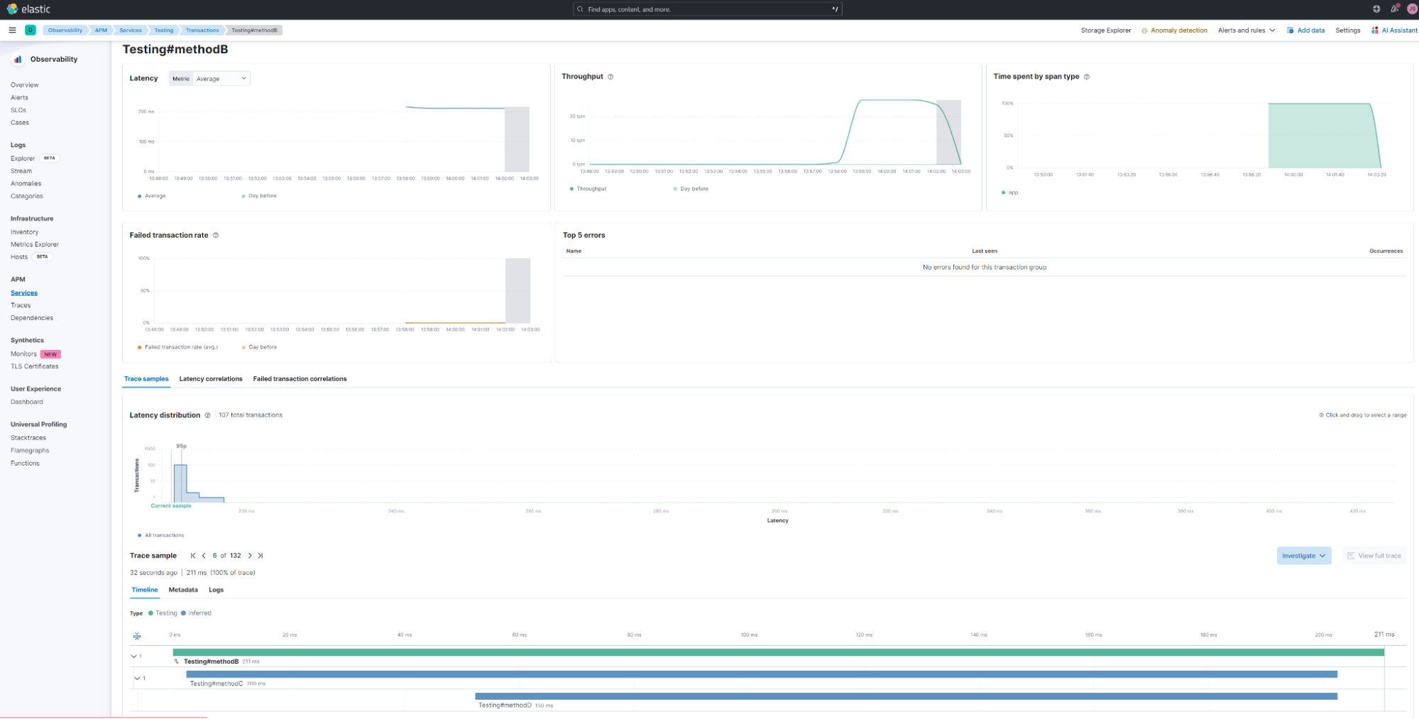

metadata:
  annotations:
     instrumentation.opentelemetry.io/inject-java: "elastic-apm"
ELASTIC_APM_TRACE_METHODS
"test.Testing#methodB"
