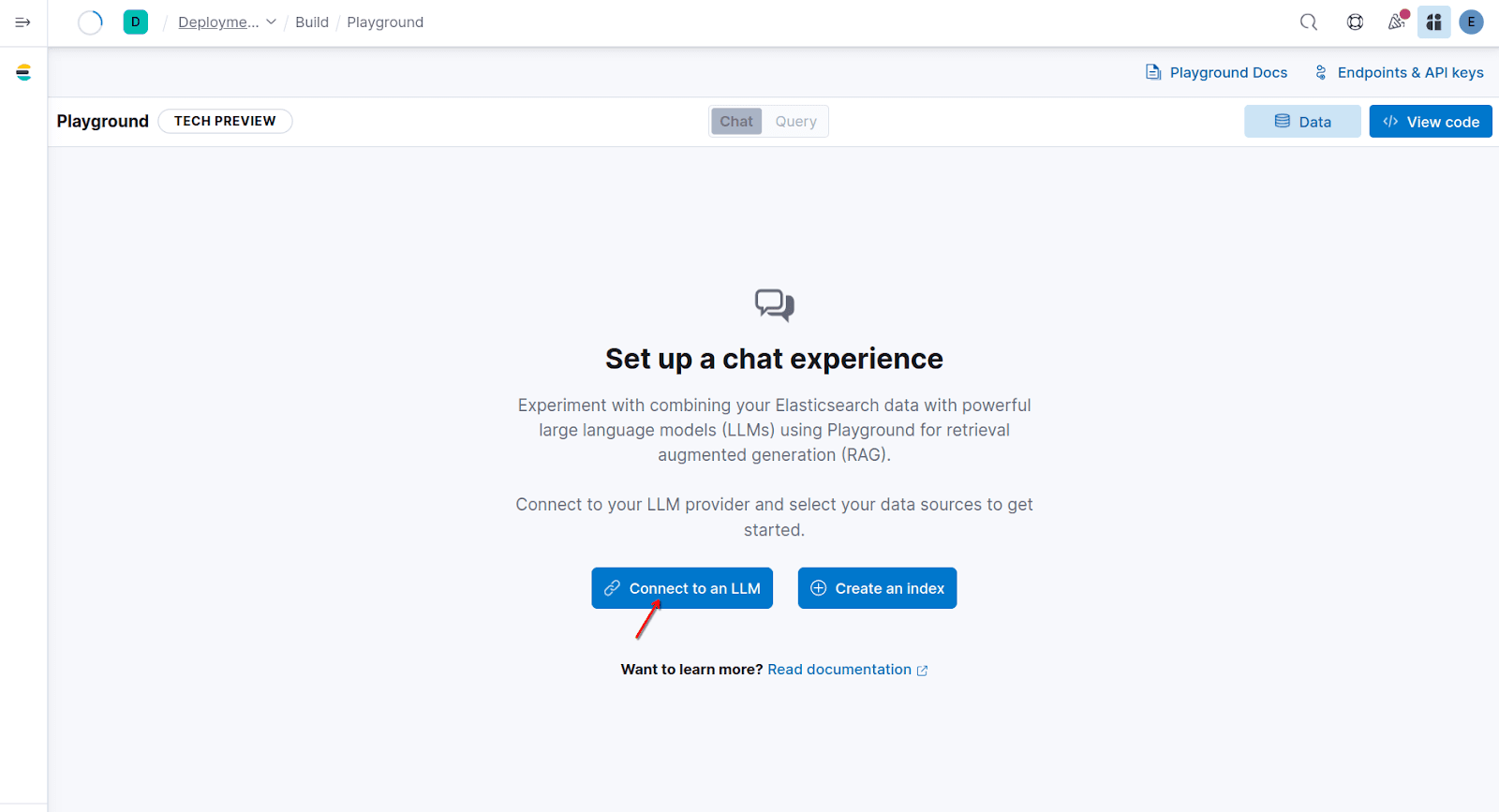

We first need to create a connector that uses the public URL we've just created. In Kibana, go to Search>Playground and then click on "Connect to an LLM".
This action will reveal a menu on the left side of the Kibana interface. There, click on "OpenAI".

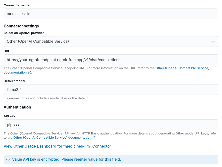

We can now start configuring the OpenAI connector.

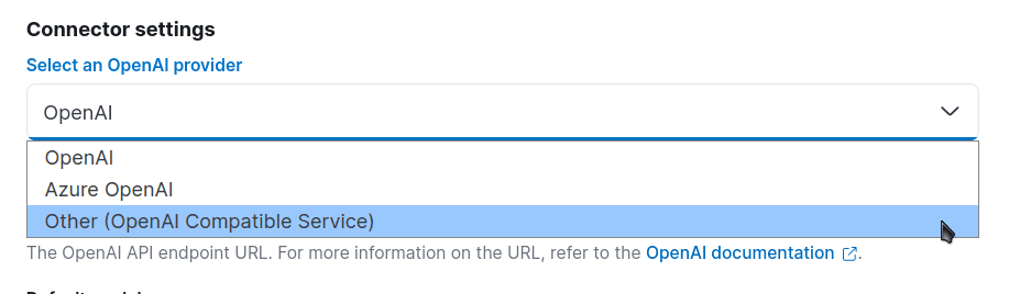

Go to "Connector settings" and for the OpenAI provider, select "Other (OpenAI Compatible Service)":
Now, let's configure the other fields. For this example, we'll name our model "medicines-llm". In the URL field, use the one generated by ngrok (/v1/chat/completions). On the "Default model" field, select "llama3.2". We won't use an API Key so just put any random text to proceed:

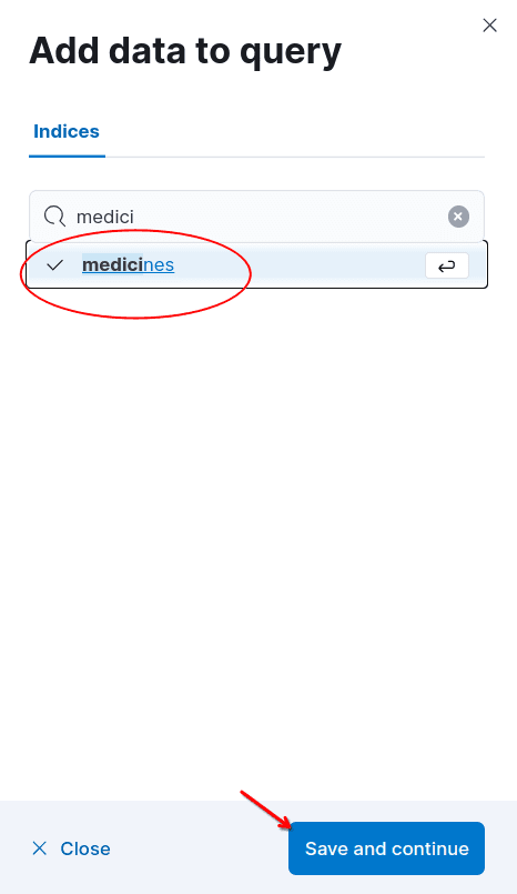

Click on "Save" and add the index medicines by clicking on "Add data sources":

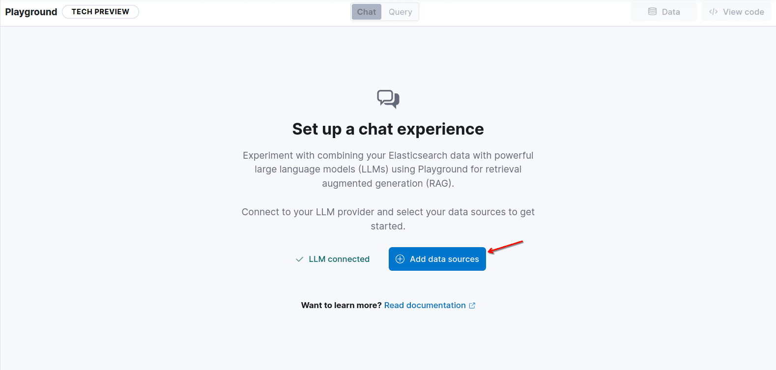

Great! We now have access to Playground using the LLM we're running locally as RAG engine.

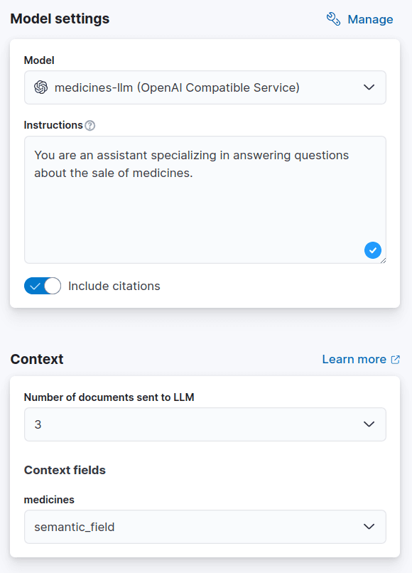

Before testing it, let's add more specific instructions to the agent and up the number of documents sent to the model to 10, so that the answer has the most possible documents available. The context field will be semantic_field, which includes the name and description of the drugs, thanks to the copy_to property.
Now let's ask the question: Can I buy Clonazepam without a prescription? and see what happens:
As expected, we got the correct answer.
