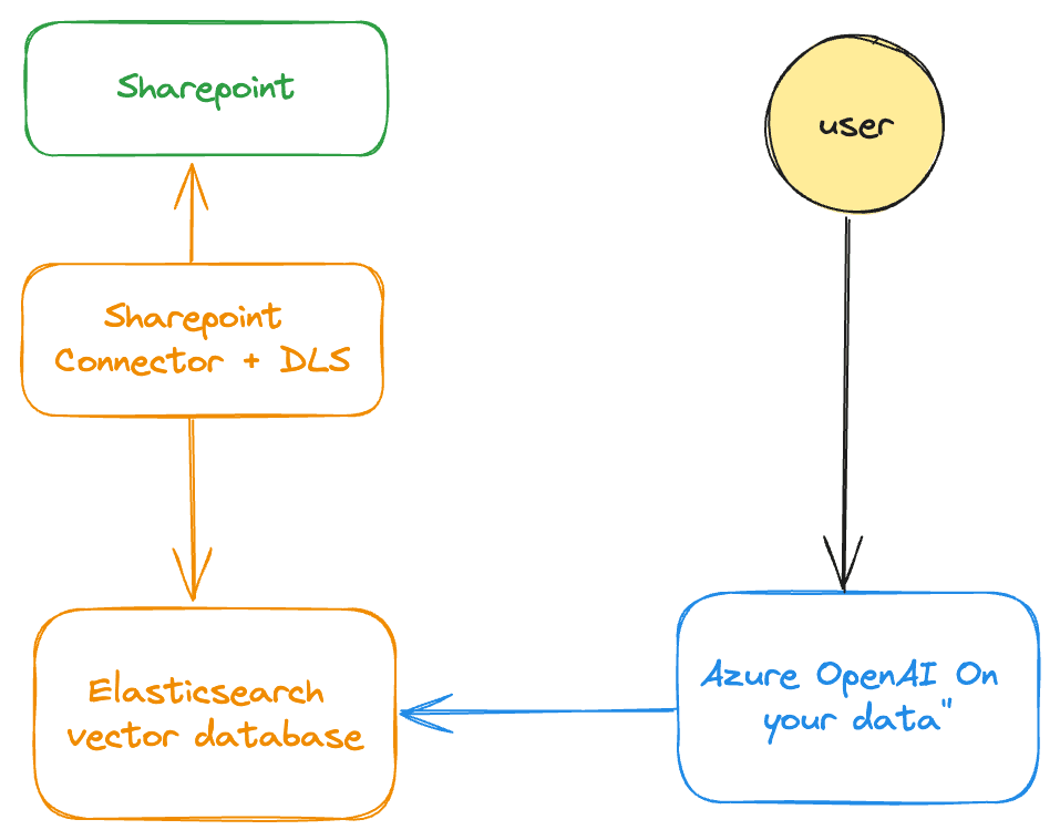

Federated SharePoint searches with Azure OpenAI Service On your data
Using Azure OpenAI Service on your data with Elastic as vector database.
In this article, we are going to explore the Azure OpenAI service "On Your Data", using Elasticsearch as the data source. We will use the Elastic Sharepoint Online Native connector to index our Sharepoint documents and keep them on sync.
Let's imagine we have a Sharepoint site that has information about the company and employees, and we want to chat with it using a custom application. Designing and developing that architecture would usually take some time. You would have to take care of the ingestion, then set up a search engine, and then configure a RAG system that reads from the data source and passes the information to a LLM to answer the question. Luckily we can use Elastic and Azure to make this faster!

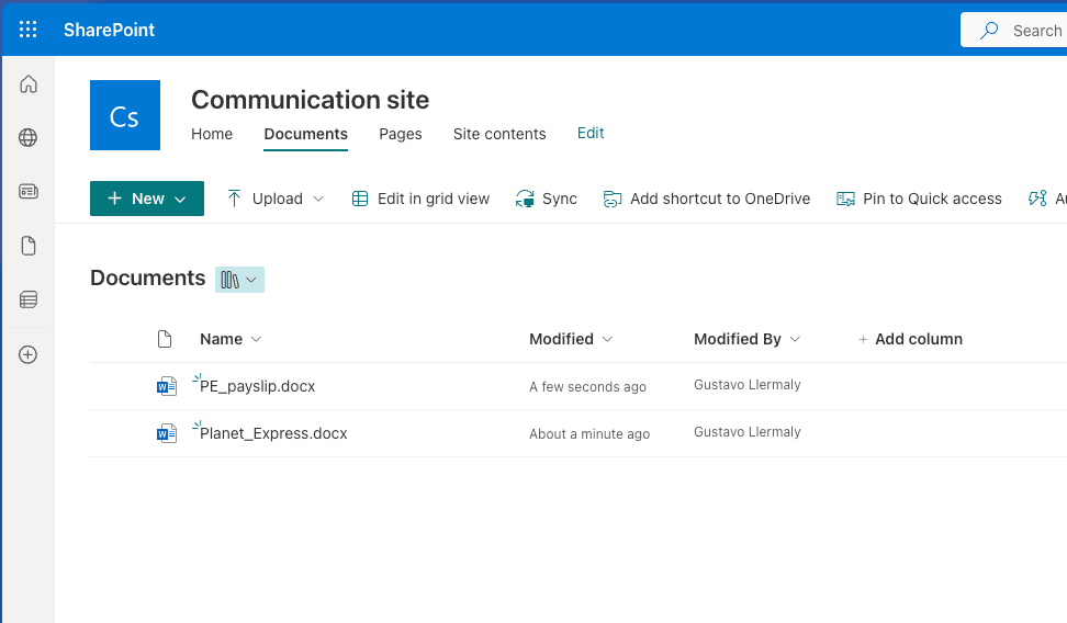

We will create a Sharepoint Site with the following documents:

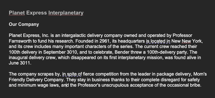

Planet_Express.docx
This file contains information about the Planet Express company which is intended to be public.

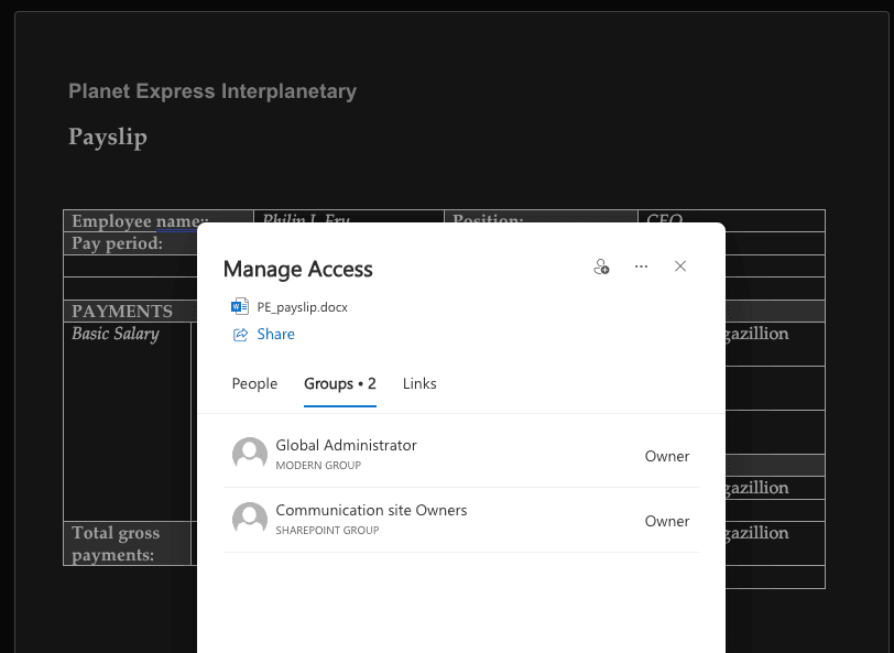

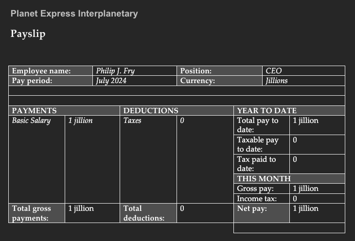

PE_Payslip.docx
This one contains the Planet Express Payslip, specifically the CEO salary. This is some information we don't want everybody to have access to.

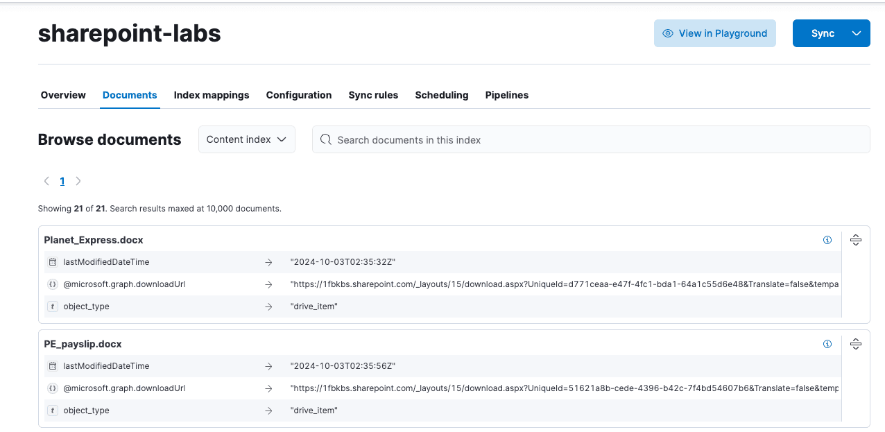

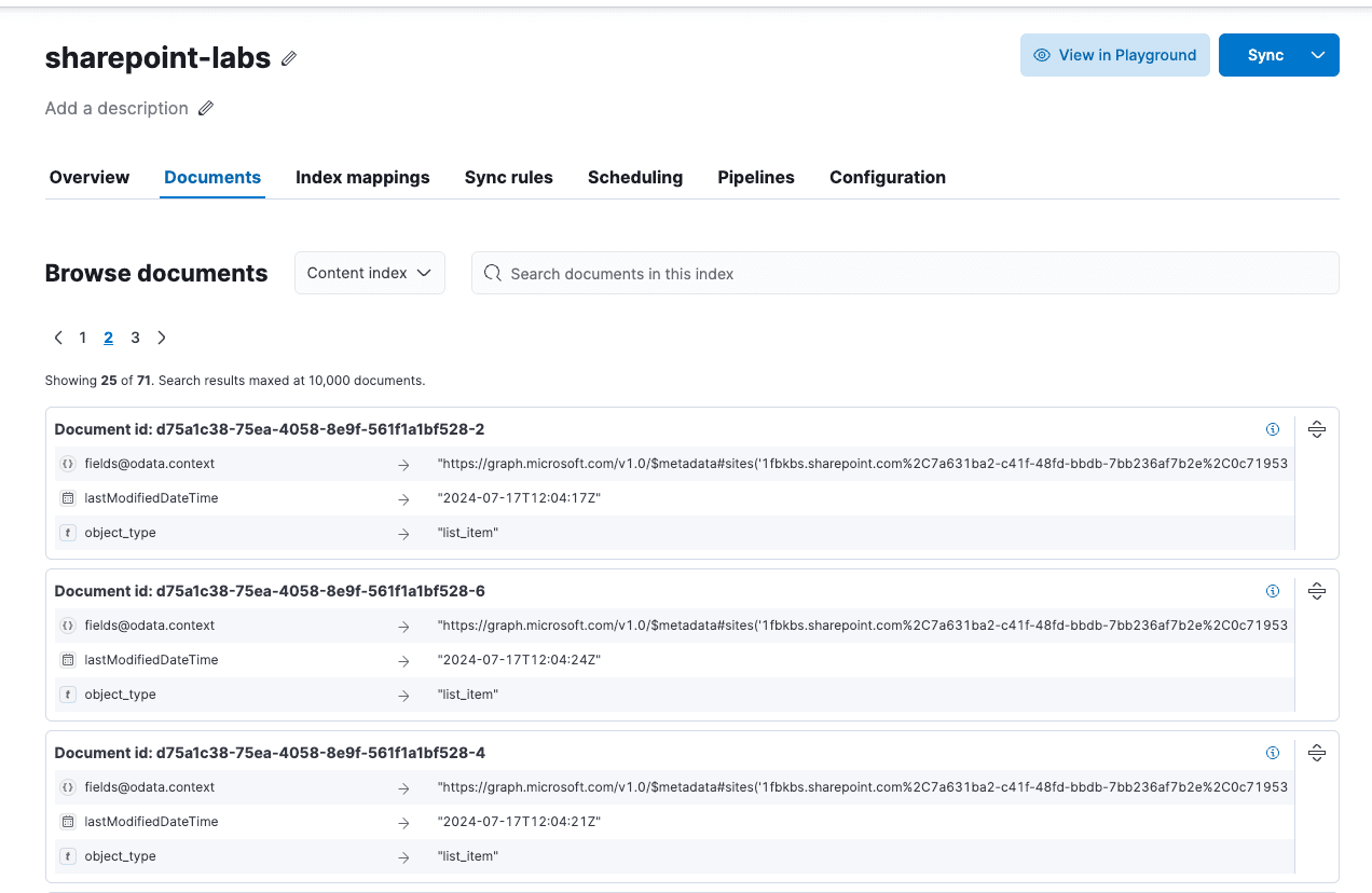

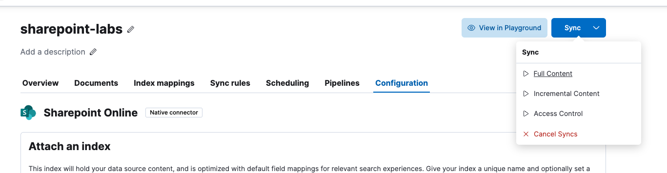

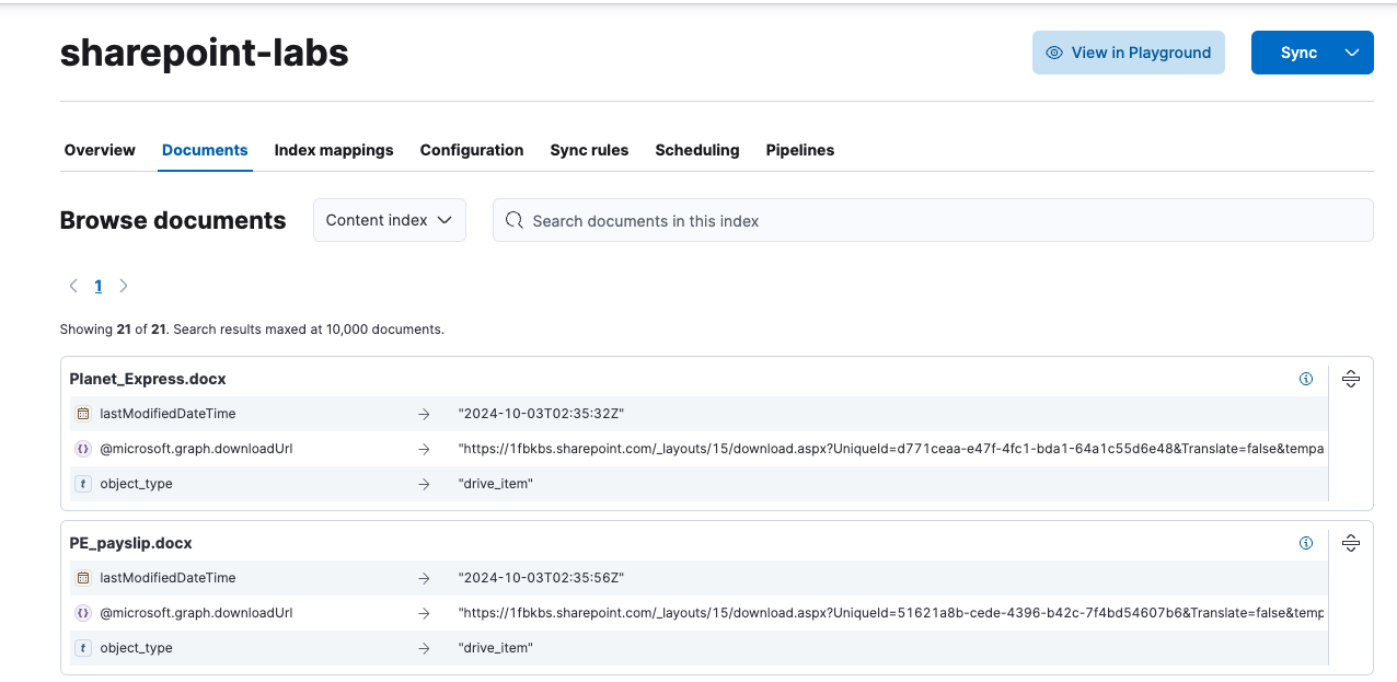

After configuring the connector index we can run a sync to start indexing the documents:
If everything went OK, you should start seeing your documents in the Documents tab:

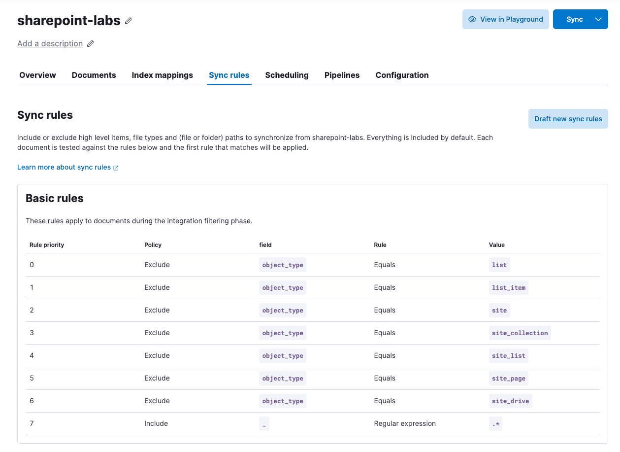

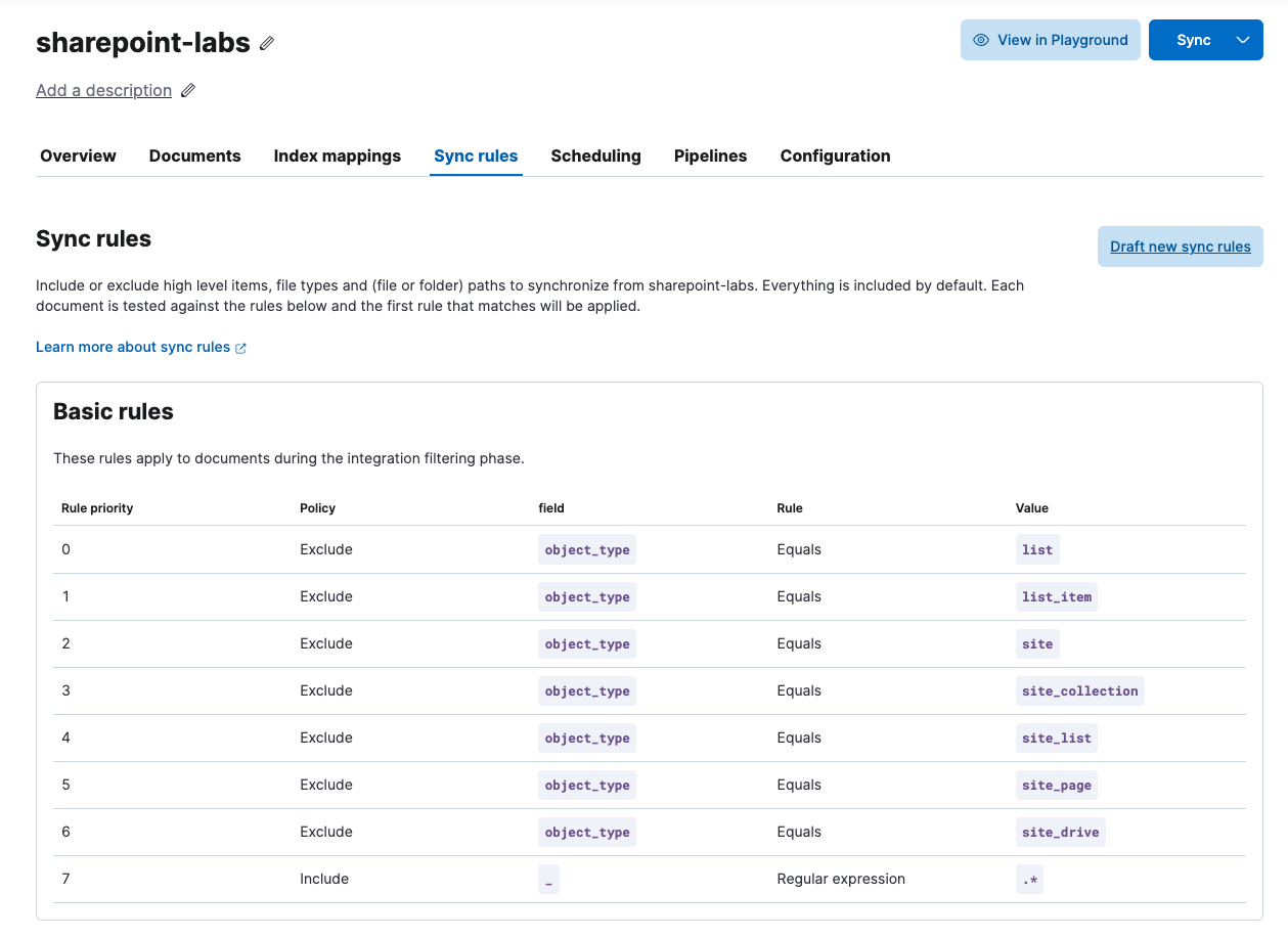

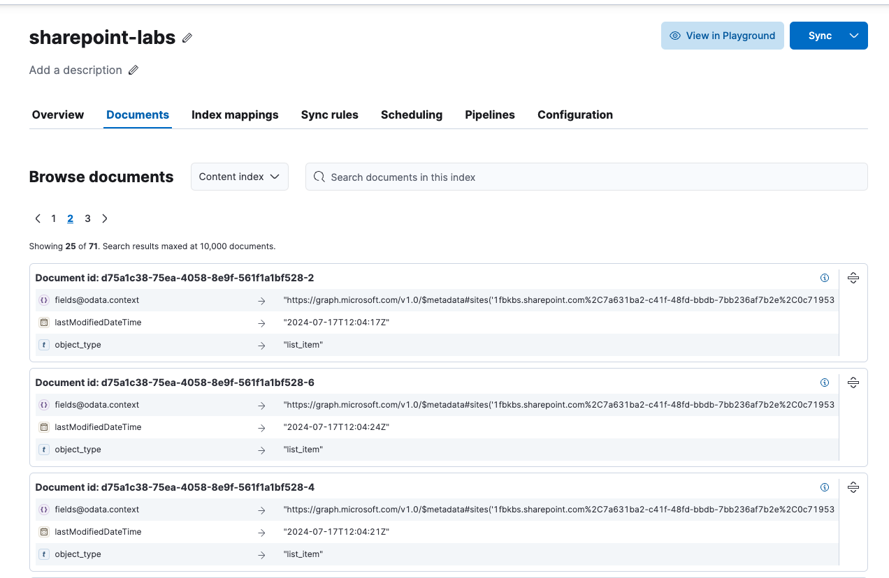

By default, the connector will ingest different document types like lists, list items, and sites. For this article, we are only interested in documents so let's apply a filter in the connector for that purpose.
This filter will exclude lists and collection-related documents. You have to run a full content sync to apply the filter.

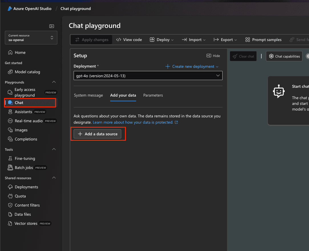

Setting up Azure OpenAI service

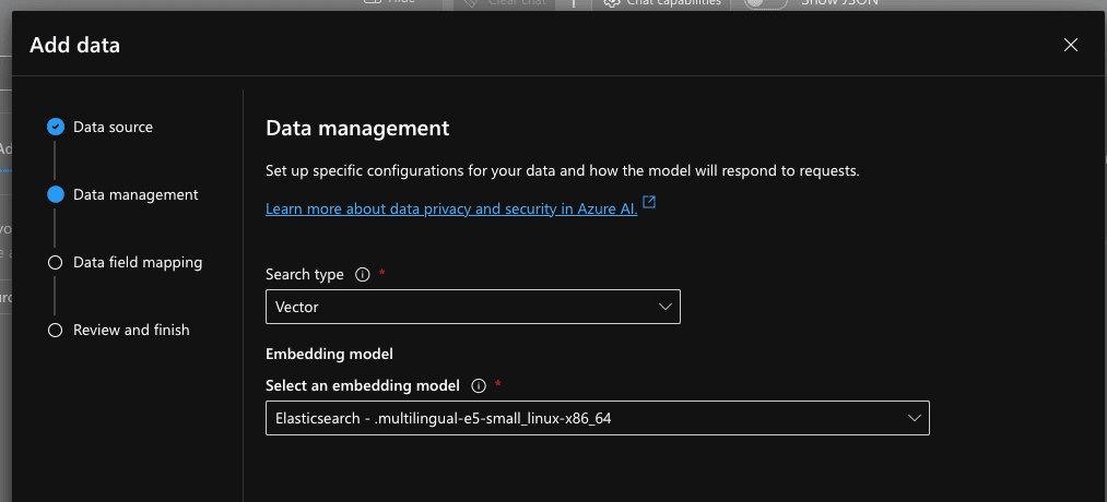

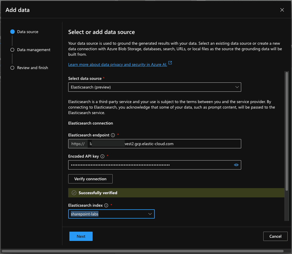

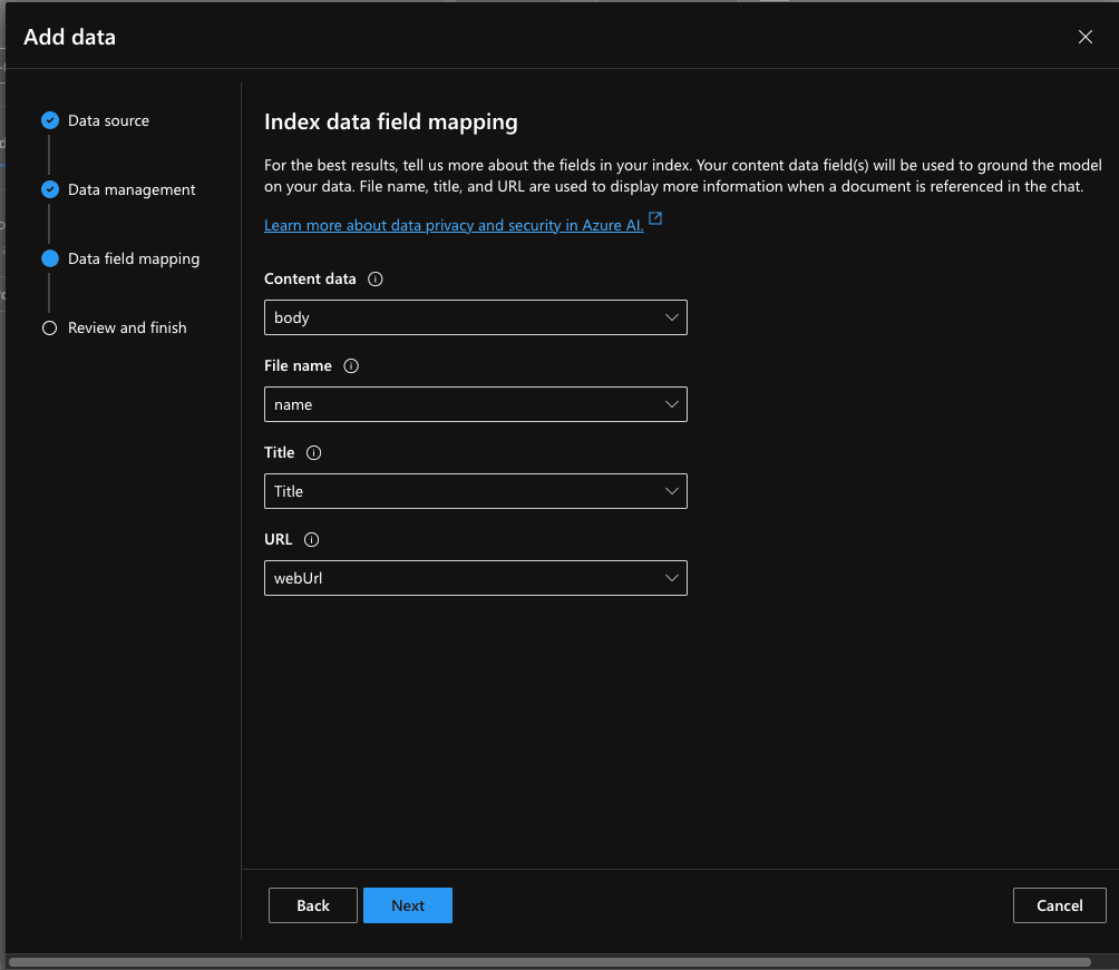

The easiest set up is to go to Azure AI Studio, and adding Elasticsearch as a Chat data source:

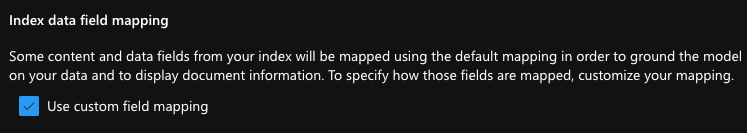

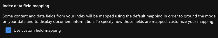

Select the customize mappings checkbox to align with the connector settings

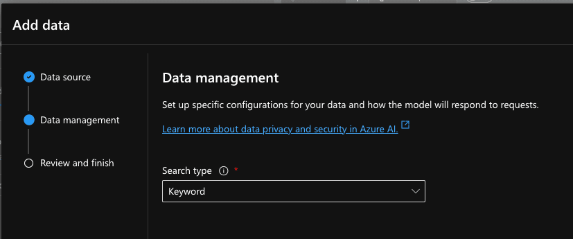

We can select between Keyword or Vector let's start with Keyword.

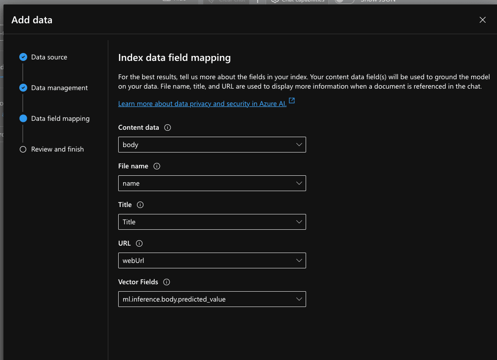

Now we can align the mappings from the connector with the fields Azure will use for the queries.

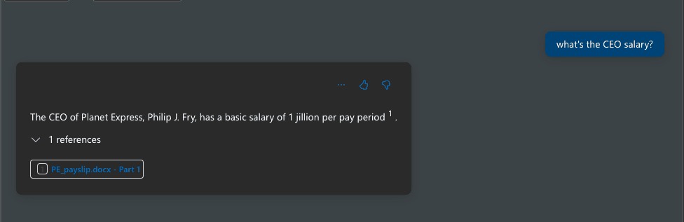

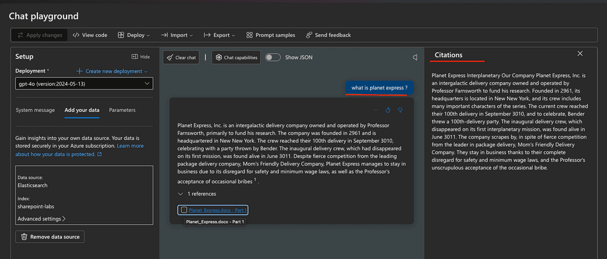

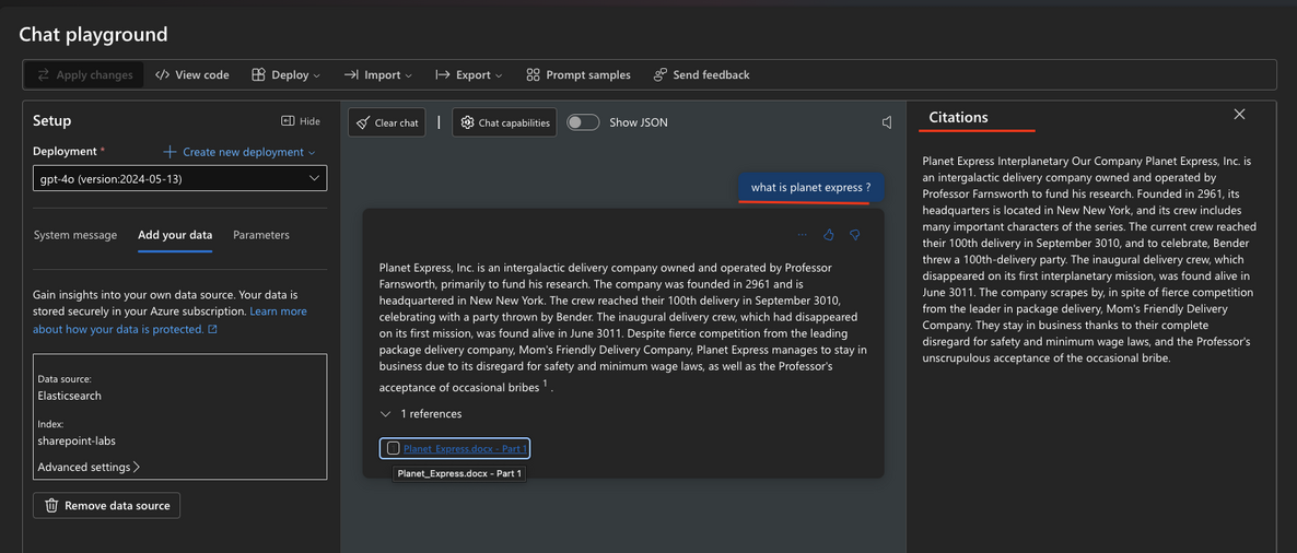

We can start asking questions to our documents! Let's start asking about Planet Express:

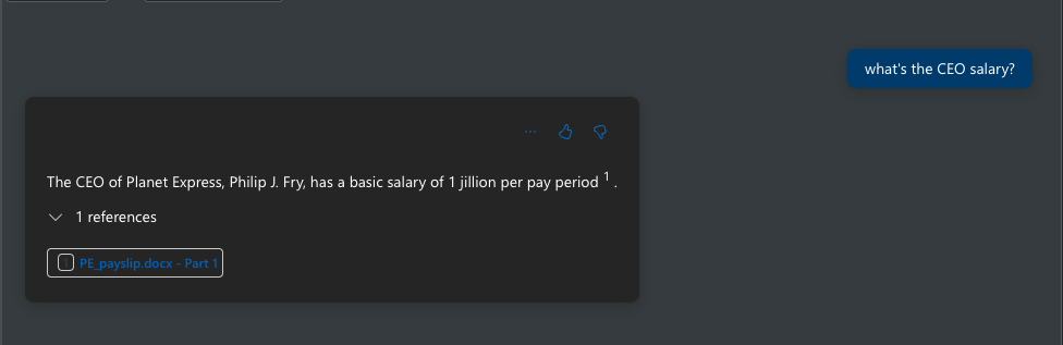

What if we ask about the CEO salary?
We may don't want to make this information public.
Let's fix that!

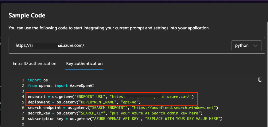

  • Define the following variables: AzureOpenAIEndpoint, ChatCompletionsDeploymentName, SearchEndpoint, IndexName, Key.
To find AzureOpenAIEndpoint, ChatCompletionsDeploymentName you can click the View Code tab in the chat:
Copy the endpoint and deployment values from here.
SearchEndpoint, IndexName, Key , are the Elasticsearch URL, index name and API Key.

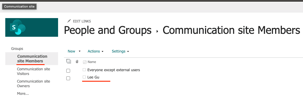

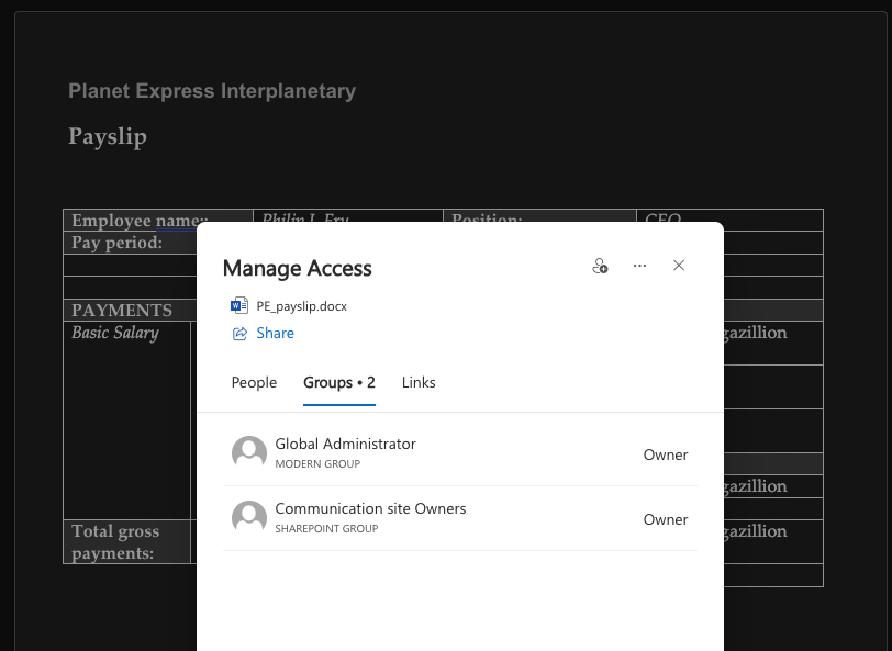

Document Level Security (DLS)
How can we protect the documents? Elastic provides the tools to mirror the Sharepoint security permissions, so depending on who is asking, we can retrieve or not retrieve a document based on the permissions they have on Sharepoint to answer the question. We will use document level security (DLS) for this purpose.
In fact, the Payslip information is not shared with the site members and it's only available for site owners and administrators:

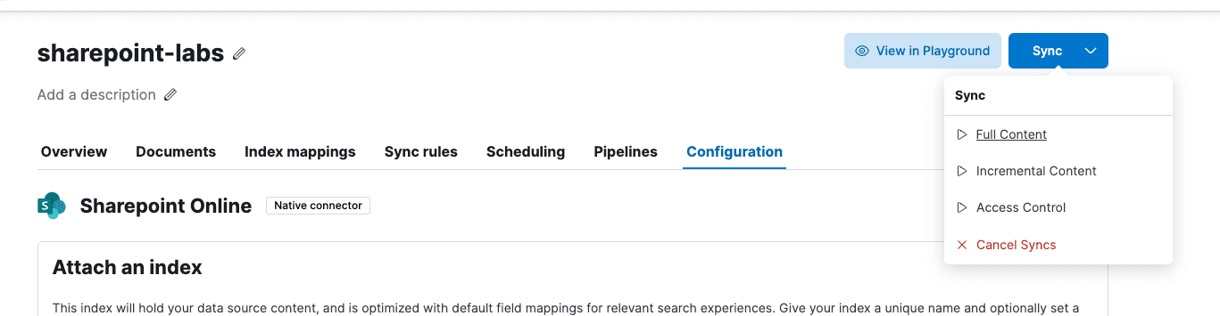

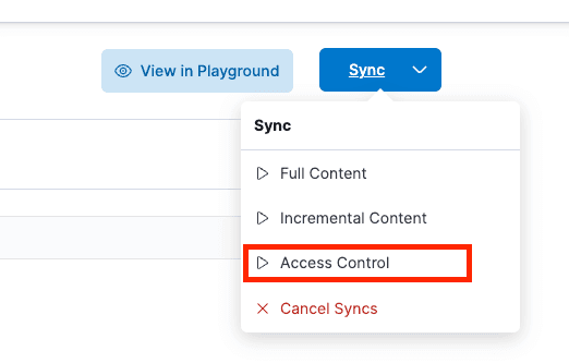

Let's start by running an Access Control Sync in the connector to populate the security index:
Now we can expect the security index to gather the permissions for each document/user.

This user is a Site Member, so it's perfect to test permissions.

  "role": "user",
  "content": "What is Planet Express?"
Answer:
"Planet Express, Inc. is an intergalactic delivery company owned and operated by Professor Farnsworth to fund his research. Founded in 2961, its headquarters is located in New New York. The company has a crew that includes many important characters from the series it is featured in. Despite fierce competition from the leading package delivery company, Mom's Friendly Delivery Company, Planet Express manages to stay in business by disregarding safety and minimum wage laws and occasionally accepting bribes..."
We stored our documents as vectors too, so we can leverage the Azure Vector query type. You can select the query type to Vector in the UI:
As you can see, it will automatically detect the model from Elasticsearch.
It will also detect the vector field automatically.You must fill the rest of the fields for citations.
Or use the SDK this way:
token_provider = get_bearer_token_provider(
    DefaultAzureCredential(), "https://cognitiveservices.azure.com/.default")
client = AzureOpenAI(
    azure_endpoint=endpoint,
    azure_ad_token_provider=token_provider,
    api_version="2024-02-15-preview",
completion = client.chat.completions.create(
    model=deployment,
    messages=[
            "role": "user",
            "content": "What is Planet Express?",
    extra_body={
        "data_sources": [
                "type": "elasticsearch",
                "parameters": {
                    "endpoint": search_endpoint,
                    "index_name": index_name,
                    "authentication": {
                        "type": "encoded_api_key",
                        "encoded_api_key": key
                "query_type": "vector",
                "embedding_dependency": {
                  "type": "model_id",
                  "model_id": ".multilingual-e5-small_linux-x86_64"
                "fields_mapping": {
                    "content_fields_separator": "\n",
                    "content_fields": [
                        "body"
                    "filepath_field": "name",
                    "title_field": "Title",
                    "url_field": "webUrl",
                    "vector_fields": [
                        "ml.inference.body.predicted_value"
print(completion.model_dump_json(indent=2))
