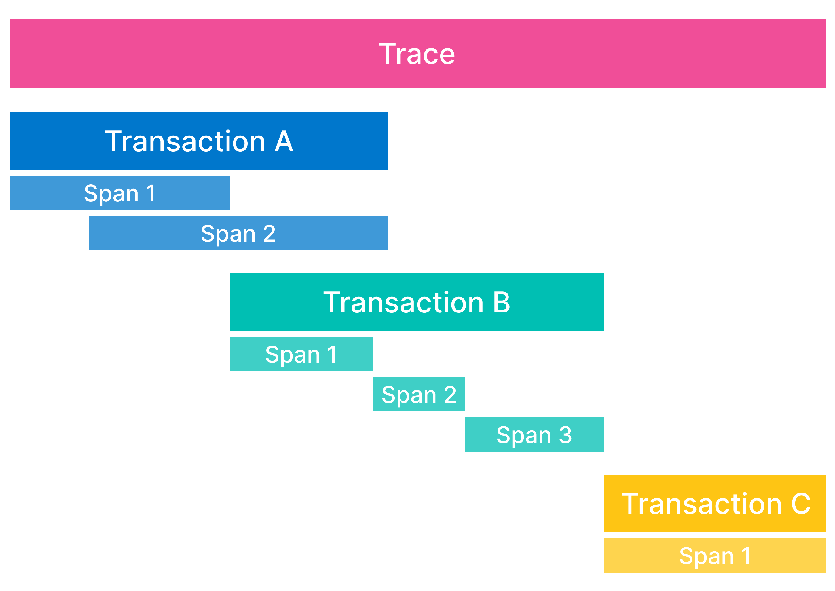

  • Traces: A trace is a group of transactions and spans with a common root. Each trace tracks the entirety of a single request. When a trace travels through multiple services, it is known as a distributed trace.
Diagram illustrating the relationship between spans
