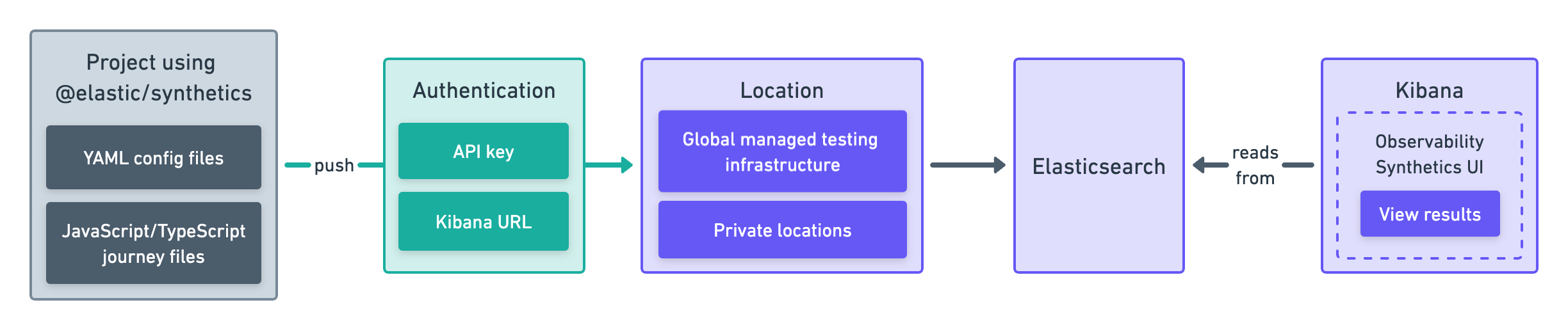

A Synthetics project is the most powerful and sophisticated way to configure synthetic monitors. A Synthetics project lets you define your infrastructure as code, more commonly known as IaaC or Git-ops. With monitors created and managed in Synthetics projects, you organize your YAML configuration and JavaScript- or TypeScript-defined monitors on the filesystem, use Git for version control, and deploy via a CLI tool, usually executed on a CI/CD platform.
Diagram showing which pieces of software are used to configure monitors
This is one of two approaches you can use to set up a synthetic monitor.

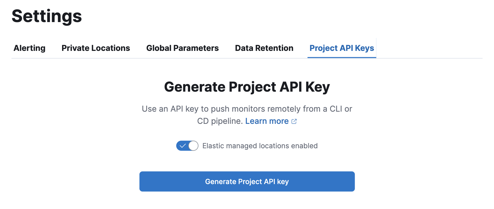

  1. To generate an API key:
    1. Go to Synthetics in your Observability project.
    2. Click Settings.
    3. Switch to the Project API Keys tab.
    4. Click Generate Project API key.
      Important
      To generate a Project API key, you must be logged in as a user with Editor access.
To use an API key to push to Elastic’s global managed testing infrastructure, the Elastic managed locations enabled toggle must be on when generating the API key. If the Elastic managed locations enabled toggle is disabled, an administrator has restricted access to Elastic’s global managed testing infrastructure.
    2. Click Settings.
      Important
  1. Set the SYNTHETICS_API_KEY environment variable in your terminal. You will most likely want to set this permanently. This is done differently in Powershell and Bash.
