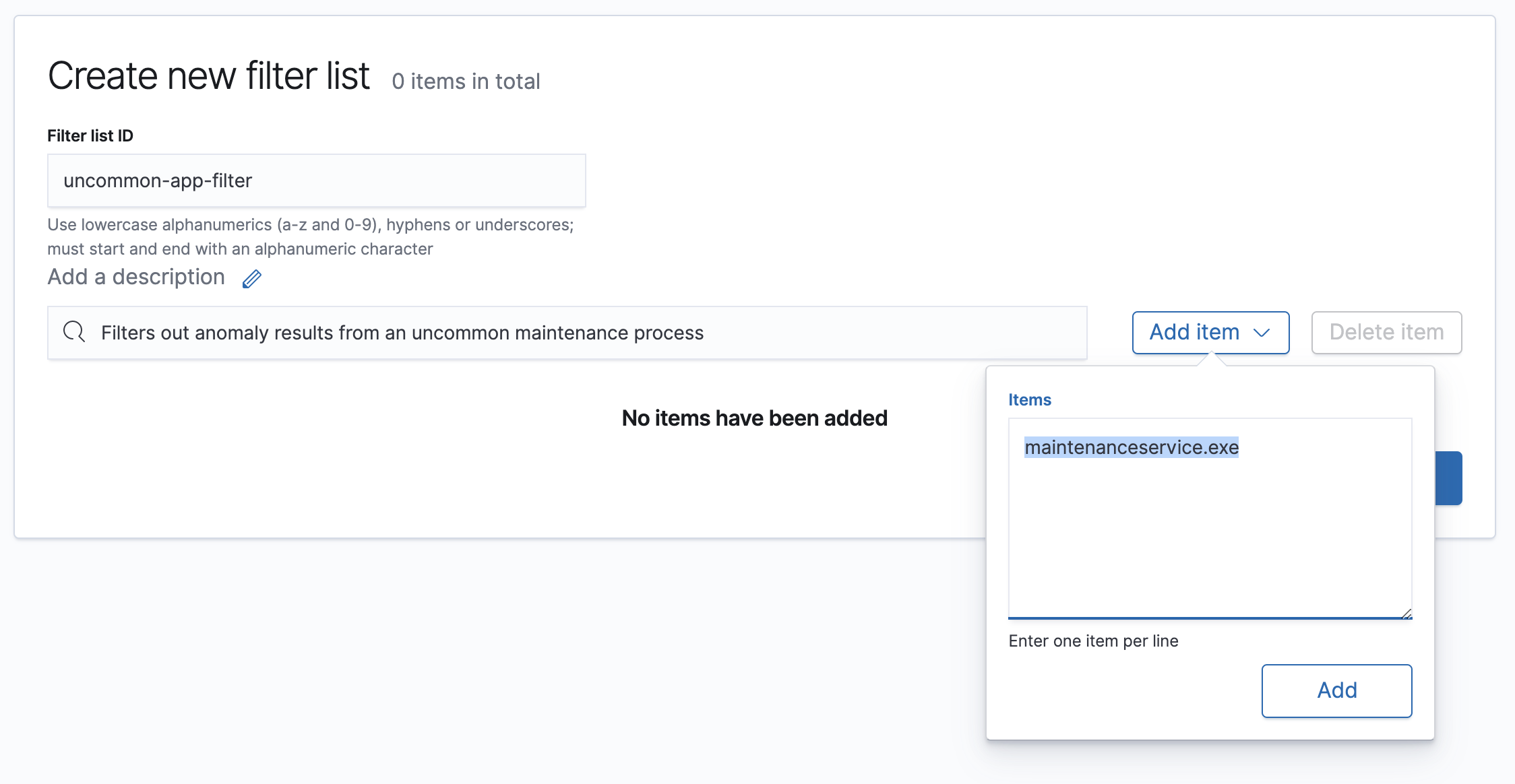

  3. Click Filter Lists and then New.
    The Create new filter list pane is displayed.
  4. Enter a filter list ID.
  5. Enter a description for the filter list (optional).
  6. Click Add item.
  7. In the Items textbox, enter the name of the process for which you want to filter out anomaly results (maintenanceservice.exe in our example).
    filter add item
  8. Click Add and then Save.
    The new filter appears in the Filter List and can be added to relevant jobs.

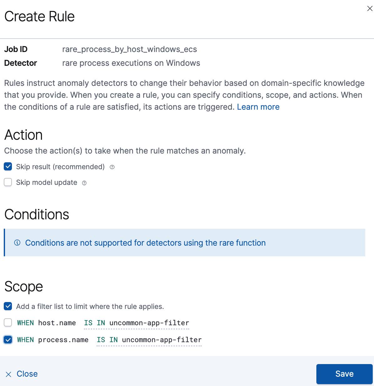

  1. Find Machine Learning in the navigation menu.
  2. Under Anomaly Detection, select Anomaly Explorer.
  3. Navigate to the job results for which the filter is required. If the job results are not listed, click Edit job selection and select the relevant job.
  4. In the actions column, click the gear icon and then select Configure rules.
    The Create Rule window is displayed.
    rule scope
  5. Select:
    1. Add a filter list to limit where the rule applies.
    2. The WHEN statement for the relevant detector (process.name in our example).
    3. The IS IN statement.
    4. The filter you created as part of the Create a filter list procedure.
      Tip
      For more information, see Customizing detectors with custom rules.
  6. Click Save.
Note
Changes to rules only affect new results. All anomalies found by the job before the filter was added are still displayed.

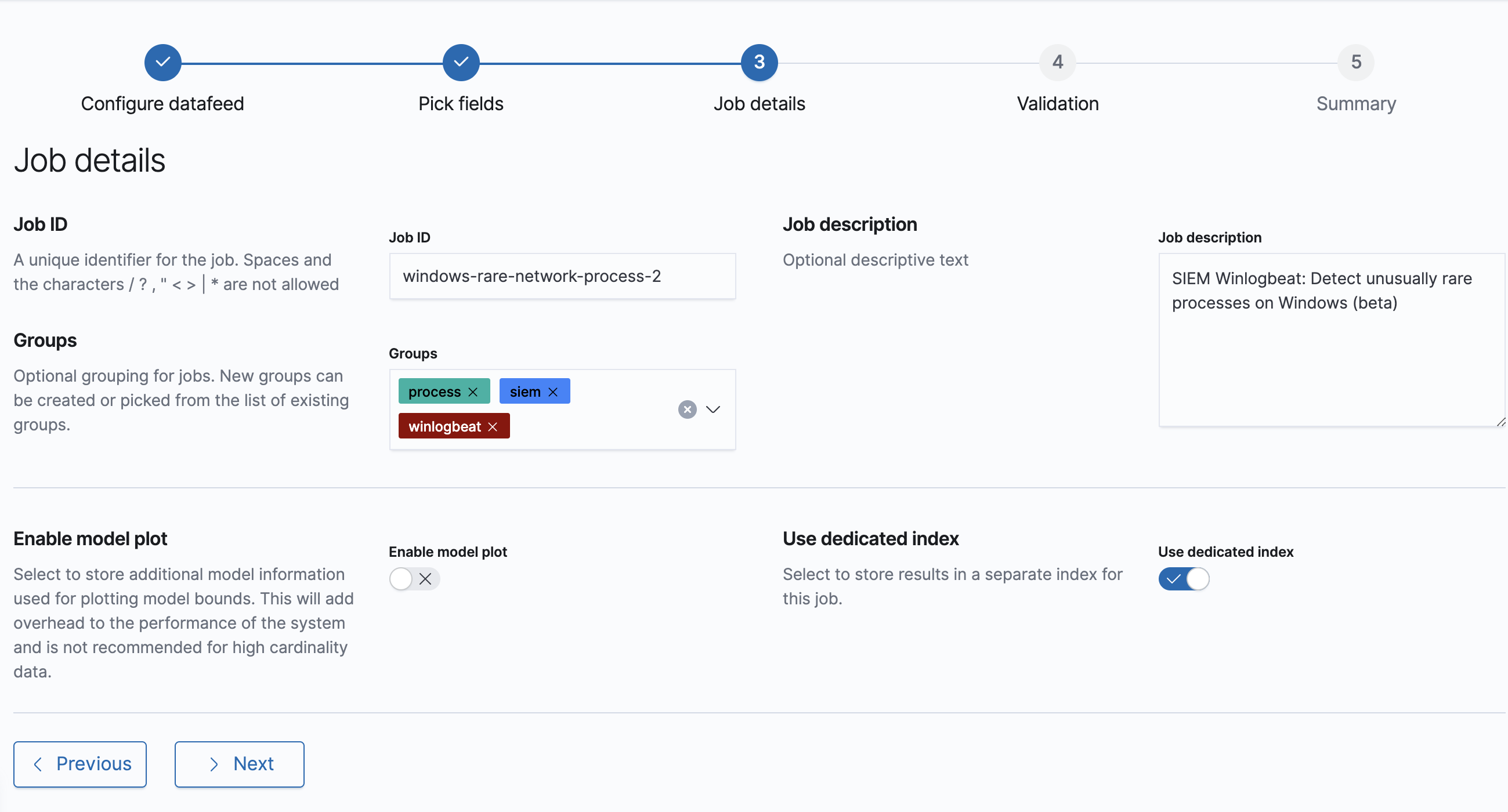

  7. Click Next until the Job details page is displayed.
  8. Enter a Job ID for the cloned job that indicates it is an iteration of the original one. For example, append a number or a username to the original job name, such as windows-rare-network-process-2.
    cloned job details
  9. Click Next and check the job validates without errors. You can ignore warnings about multiple influencers.

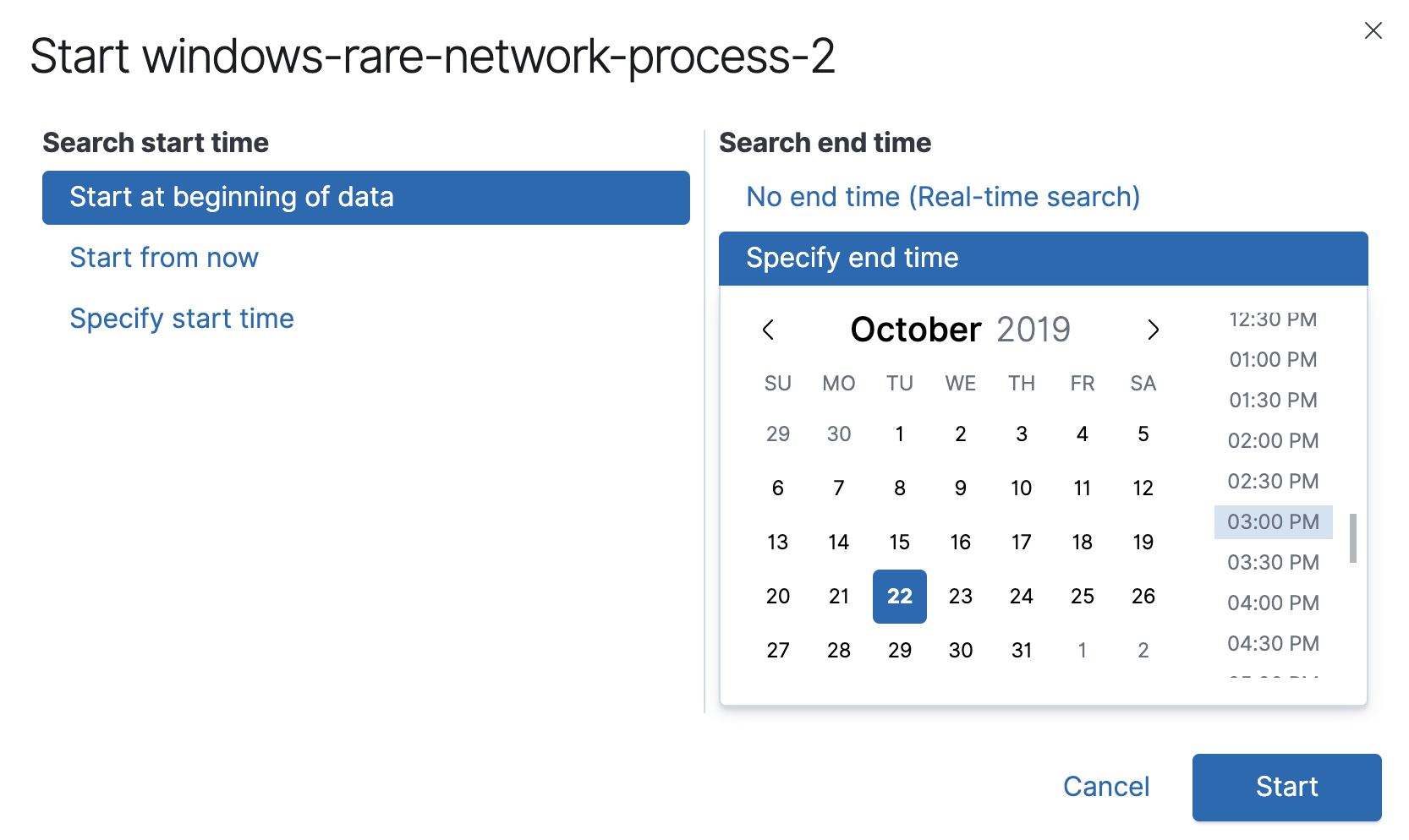

    The Start <job name> window is displayed.
    start job window
  11. Select the point of time from which the job will analyze anomalies.
  12. Click Start.
    After a while, results will start to appear on the Anomaly Explorer page.

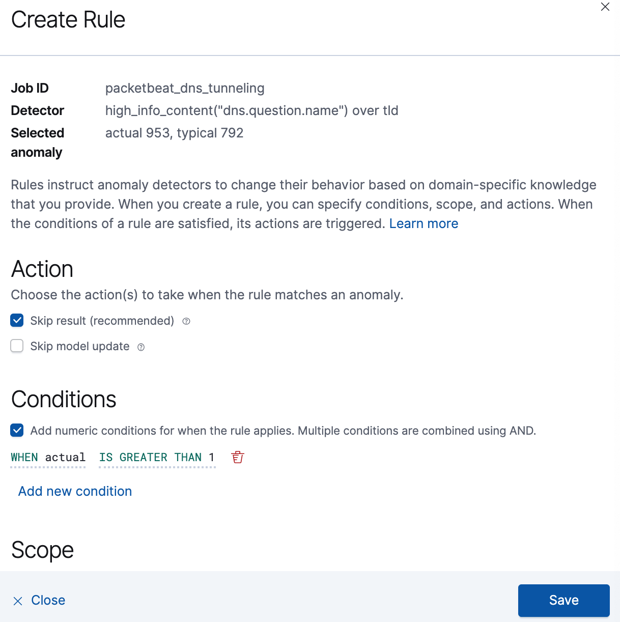

Certain jobs use a high-count function to look for unusual spikes in process events. For some processes, a burst of activity is a normal, such as automation and housekeeping jobs running on server fleets. However, sometimes a high-delta event count is unlikely to be the result of routine behavior. In these cases, you can define a minimum threshold for when a high-event count is considered an anomaly.
Depending on your anomaly detection results, you may want to set a minimum event count threshold for the packetbeat_dns_tunneling job:
  3. Navigate to the job results for the packetbeat_dns_tunneling job. If the job results are not listed, click Edit job selection and select packetbeat_dns_tunneling.
    ml rule threshold
  5. Select Add numeric conditions for when the rule applies and the following when statement:
    WHEN actual IS GREATER THAN <X>
    Where <X> is the threshold above which anomalies are detected.
  6. Click Save.
