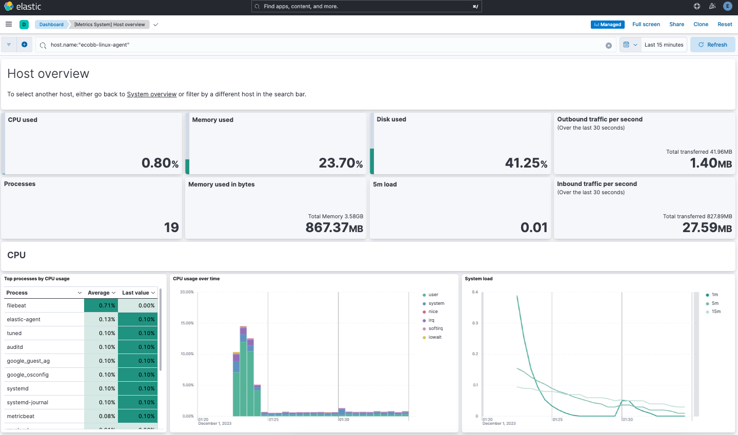

View your system metrics data:
- Open the Kibana menu and return to Analytics → Dashboard.
In the query field, search for
Metrics System
Select the
[Metrics System] Host overview
link. The Kibana Dashboard opens with visualizations of host metrics including CPU usage, memory usage, running processes, and more.
