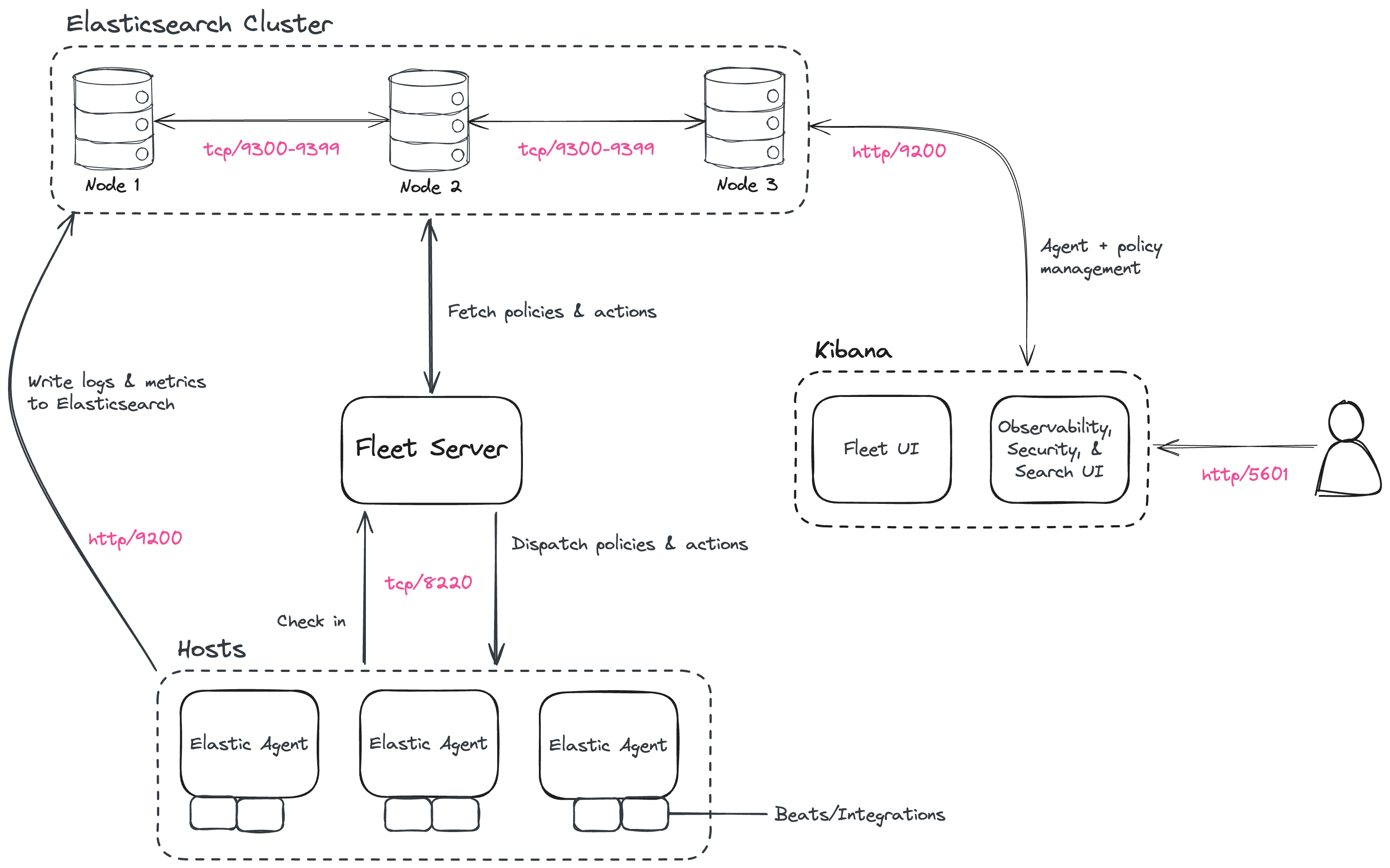

Elastic Stack overview
Before starting, take a moment to familiarize yourself with the Elastic Stack components.
Image showing the relationships between stack components
To learn more about the Elastic Stack and how each of these components are related, refer to An overview of the Elastic Stack.

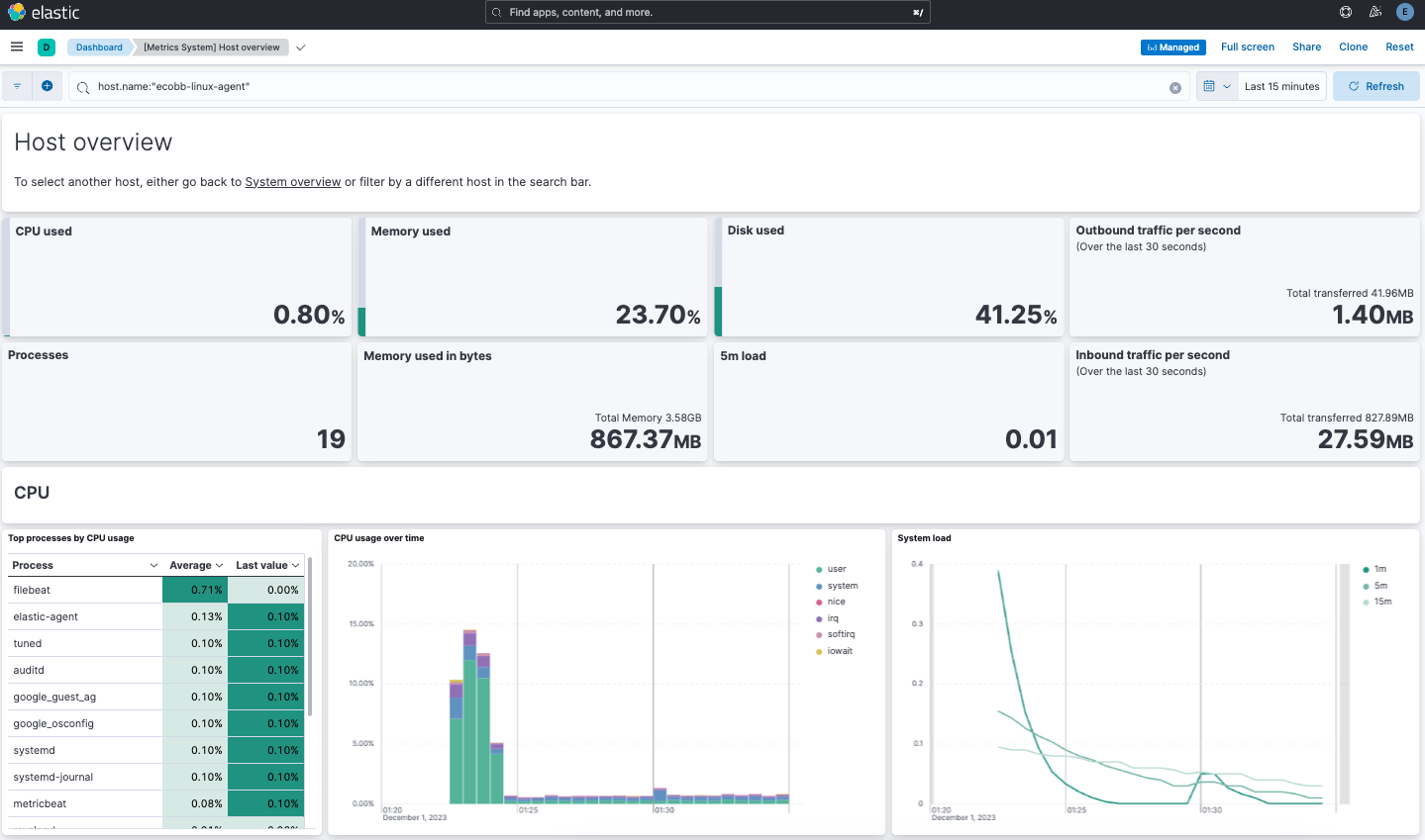

View your system metrics data:
  1. Open the Kibana menu and return to Analytics → Dashboard.
  2. In the query field, search for Metrics System.
  3. Select the [Metrics System] Host overview link. The Kibana Dashboard opens with visualizations of host metrics including CPU usage, memory usage, running processes, and others.
    The System metrics host overview showing CPU usage, memory usage, and other visualizations
