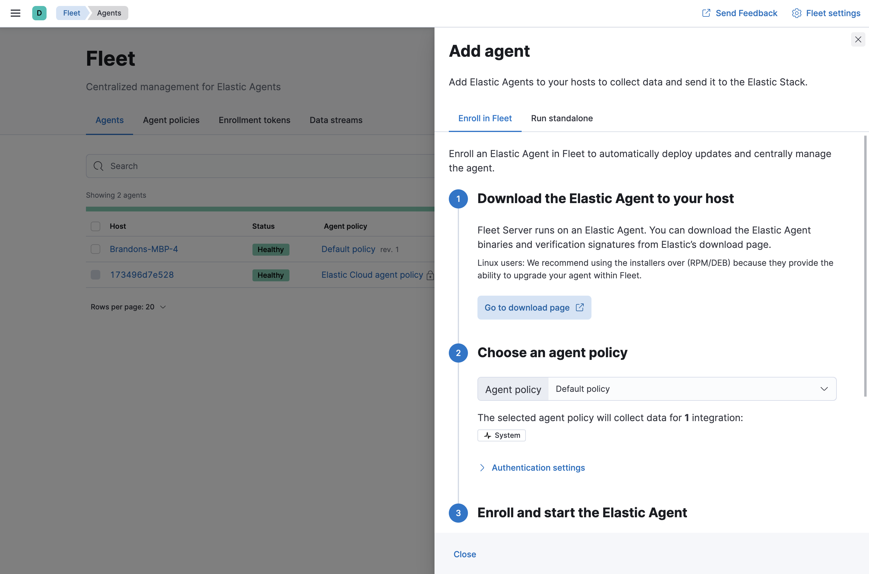

- On the Agents tab in Fleet, click Add agent.
Under Enroll in Fleet, follow the in-product installation steps (skip the download step if you’ve already done it).
See the download page for other installation options.
Notes:
- Use the default agent policy to get started quickly. This policy includes a system integration for collecting logs and metrics from the host system. You can change the policy later.

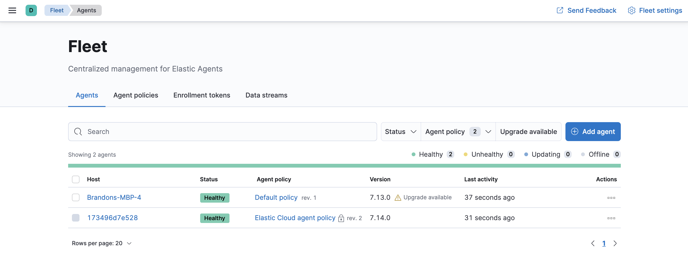

To confirm that Elastic Agent is installed and running, go to the Agents tab in Fleet. Notice that the Default policy is assigned to the agent.
If the status hangs at Enrolling, make sure the elastic-agent
process
is running.
