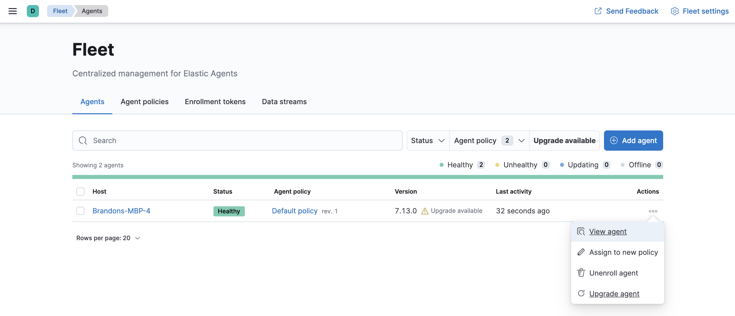

- In Fleet, select Agents.
- Under Agents, click Upgrade available to see a list of agents that you can upgrade.
To upgrade a single agent, choose Upgrade agent from the Actions menu next to the agent you want to upgrade.
The Upgrade agent option is grayed out when an upgrade is unavailable, or the Kibana version is lower than the agent version.

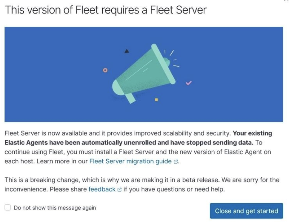

- Log in to Kibana and go to Management > Fleet, and click the Agents tab.
The following message is displayed. Please note that your Elastic Agents have now been unenrolled and have stopped sending data.
Select Do not show this message again, and then click Close and get started.

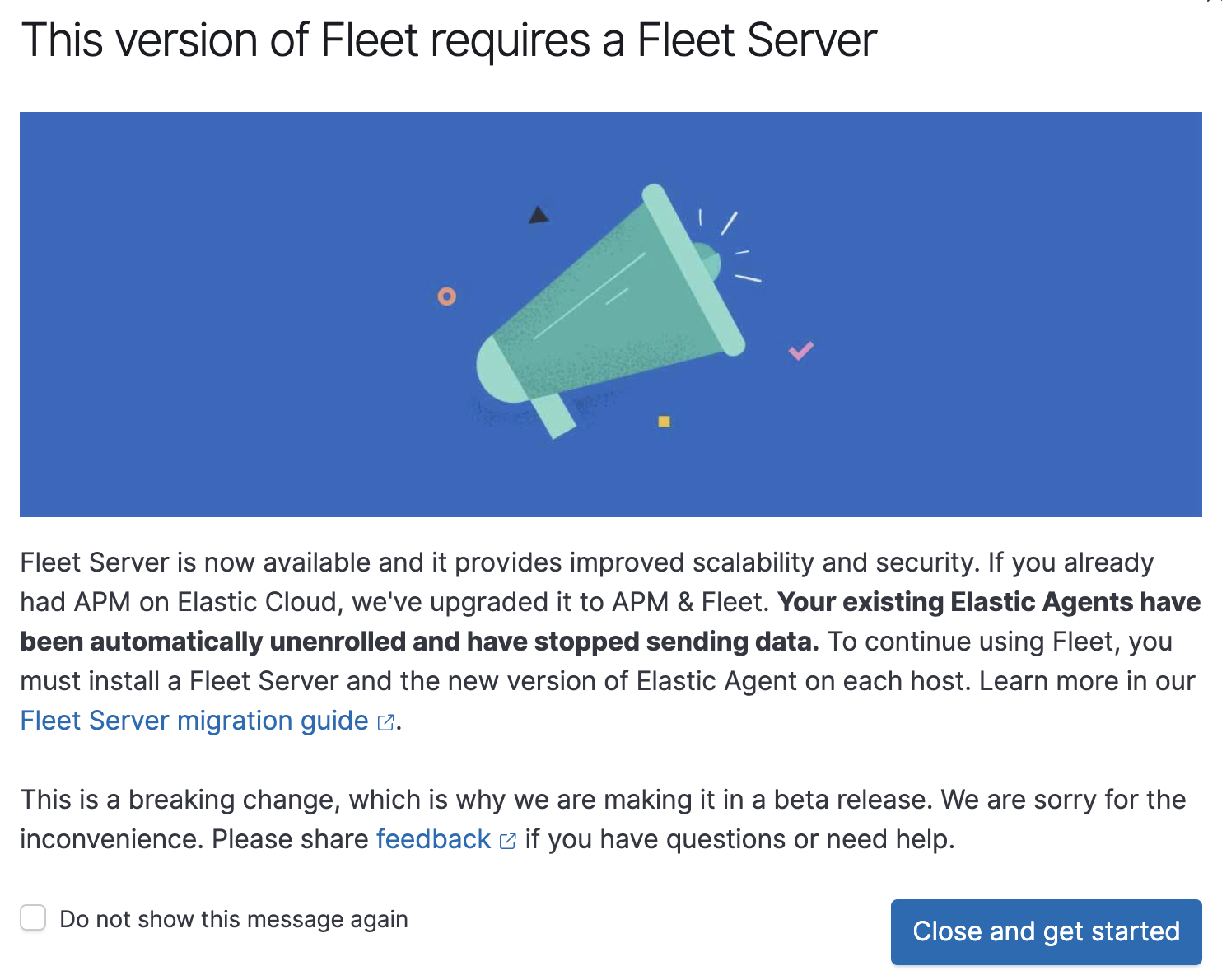

If your previous deployment did not include an APM node, you are prompted to enable APM & Fleet, required for using Fleet Server.
Click Edit deployment and add an APM & Fleet node to your deployment.
