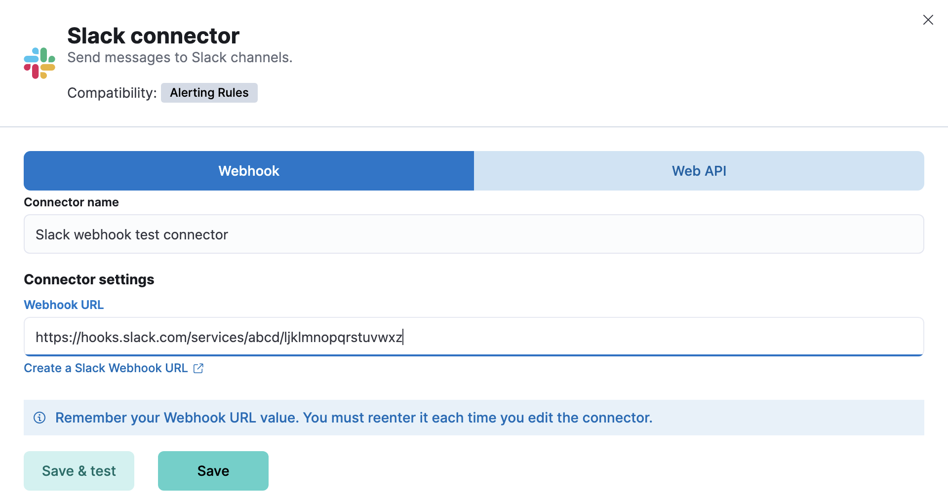

editThe Slack connector uses incoming webhooks or an API method to send Slack messages.
Create connectors in Kibana
editYou can create connectors in Stack Management > Connectors or as needed when you’re creating a rule. You can choose to use a webhook URL that’s specific to a single channel. For example:

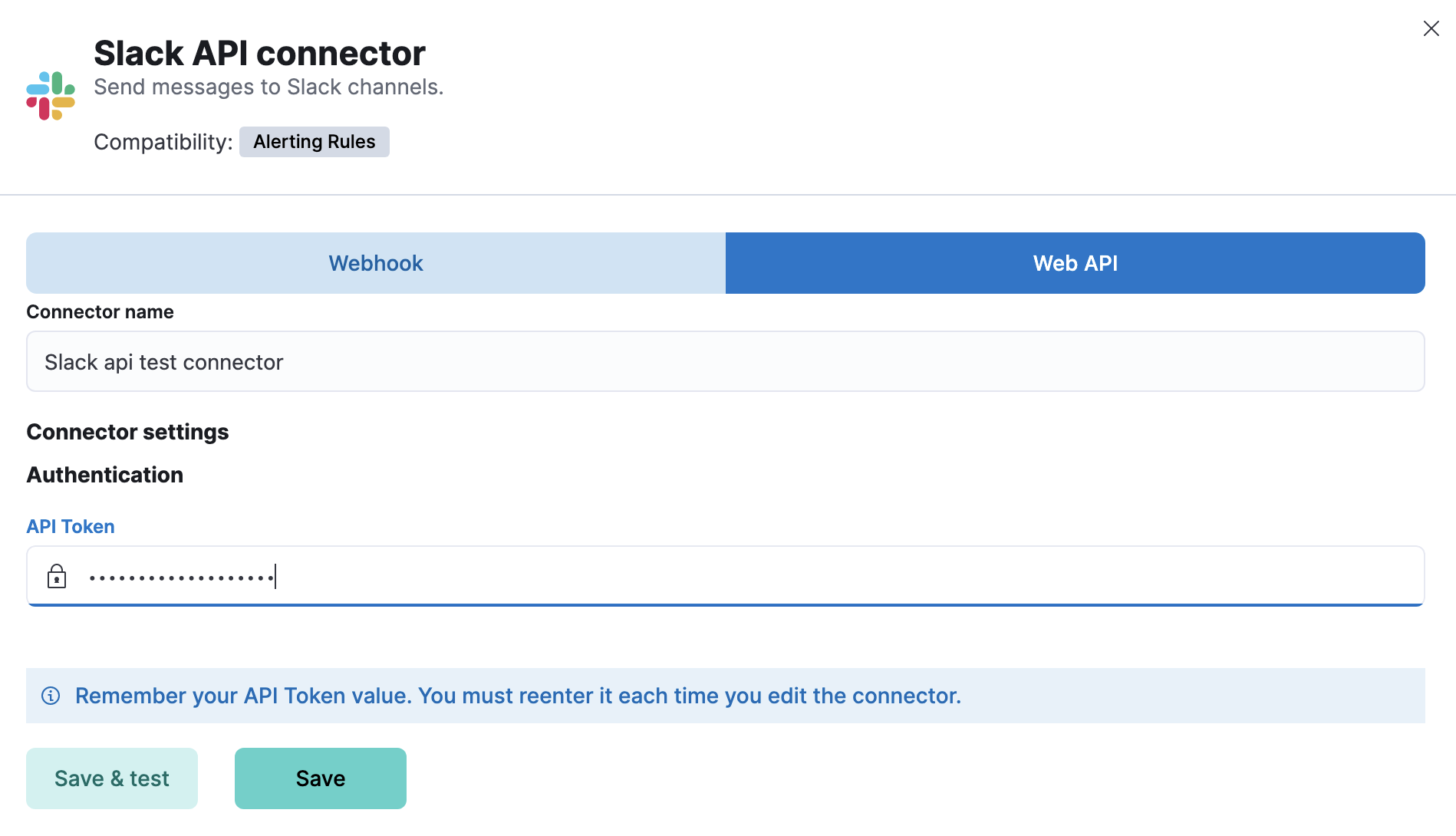

Alternatively, you can create a connector that supports multiple channels. For example:
If you use the latter method, you choose your channel when you create a rule action. Thus a connector can be used in multiple rules and actions to communicate with different channels.

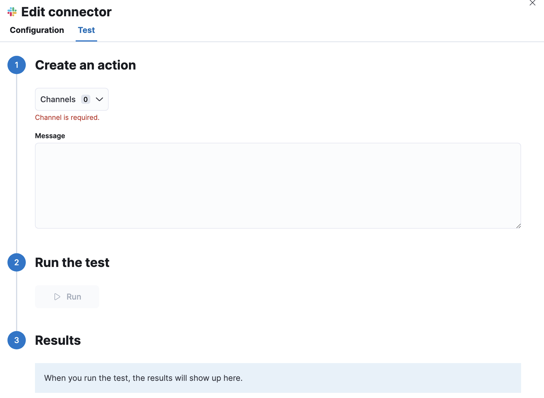

Test connectors
editYou can test connectors with the run connector API or as you’re creating or editing the connector in Kibana. For example:
Slack actions have the following properties:
- Channels
- One or more channels that your Slack app has access to. This option is available only in the web API type of connector.
- Message
- The Slack message text, which cannot contain Markdown, images, or other advanced formatting.
