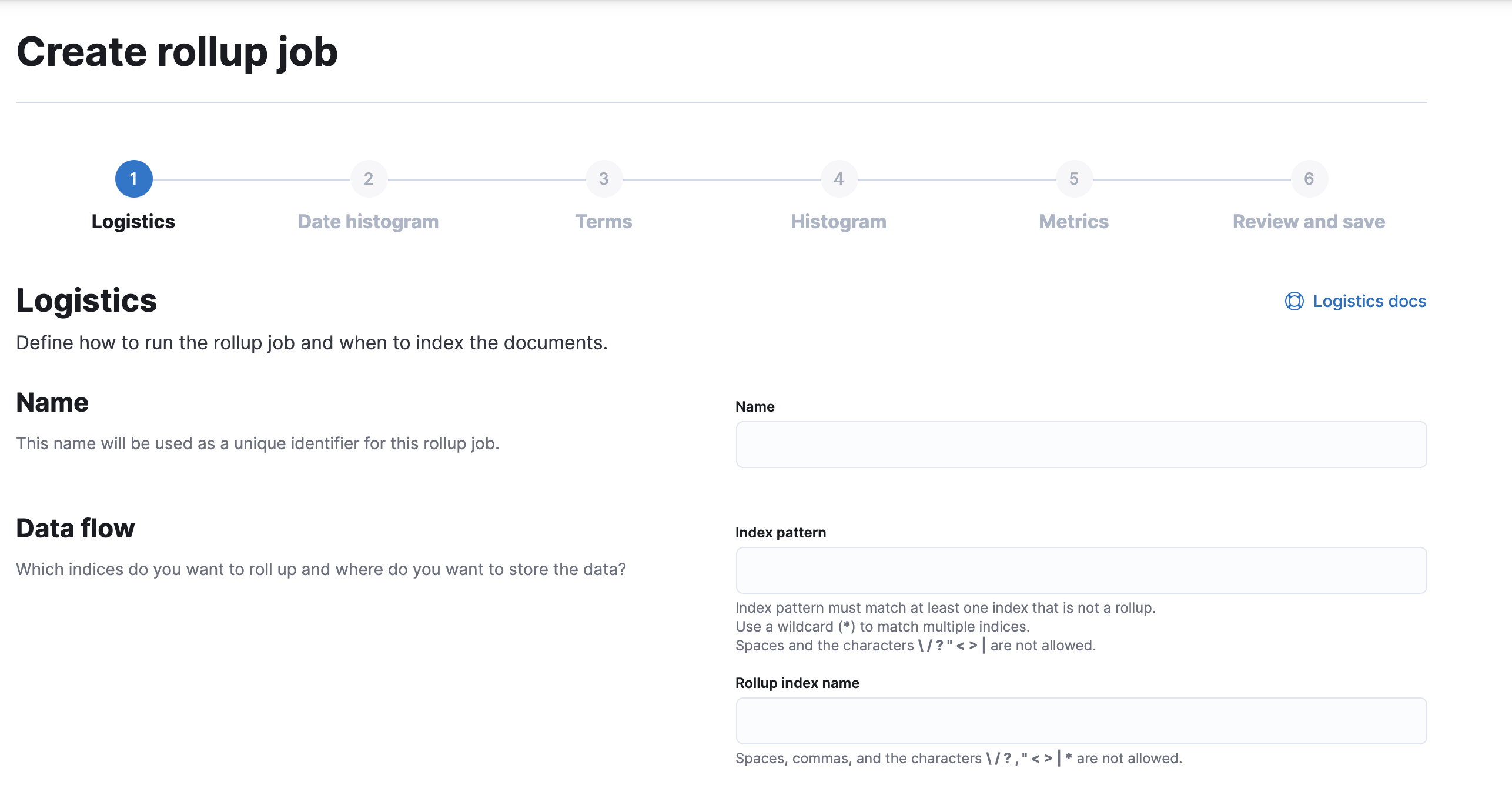

editKibana makes it easy for you to create a rollup job by walking you through the process. You fill in the name, data flow, and how often you want to roll up the data. Then you define a date histogram aggregation for the rollup job and optionally define terms, histogram, and metrics aggregations.
When defining the index pattern, you must enter a name that is different than
the output rollup index. Otherwise, the job will attempt to capture the data in
the rollup index. For example, if your index pattern is metricbeat-*
, you can
name your rollup index rollup-metricbeat
, but not metricbeat-rollup

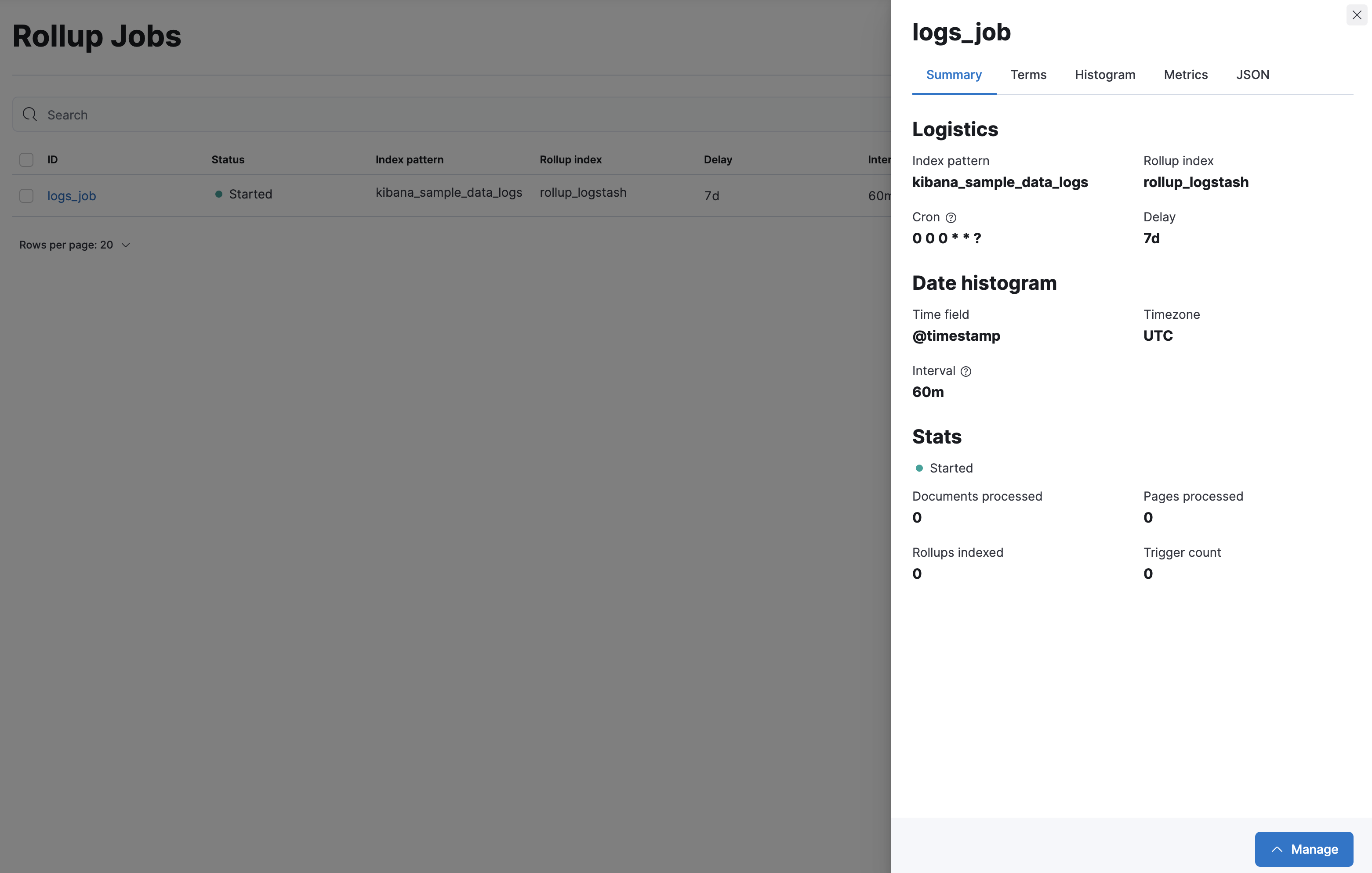

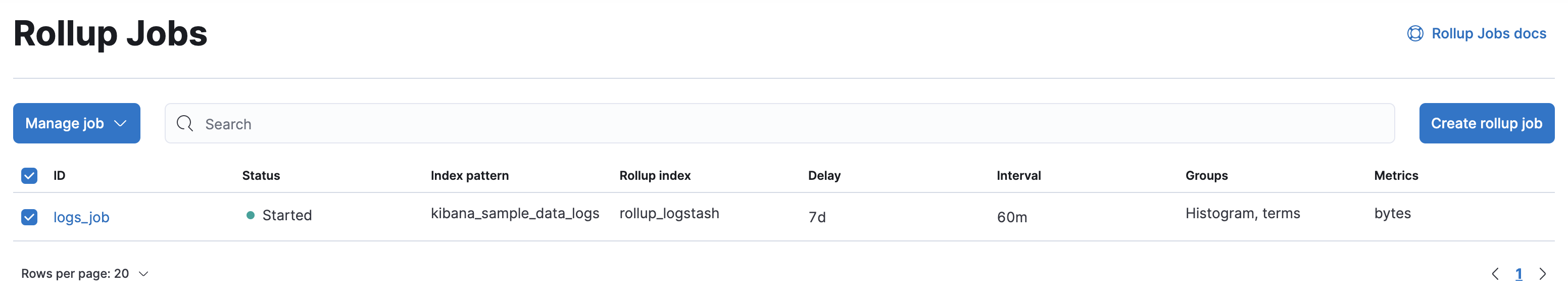

editOnce you’ve saved a rollup job, you’ll see it the Rollup Jobs overview page, where you can drill down for further investigation. The Manage menu enables you to start, stop, and delete the rollup job. You must first stop a rollup job before deleting it.
You can’t change a rollup job after you’ve created it. To select additional fields or redefine terms, you must delete the existing job, and then create a new one with the updated specifications. Be sure to use a different name for the new rollup job—reusing the same name can lead to problems with mismatched job configurations. Refer to rollup job configuration.

Create the rollup job
editAs you walk through the Create rollup job UI, enter the data:
Field | Value |
Name |
Index pattern |
Rollup index name |
Frequency |
Every minute |
Page size |
1000 |
Latency buffer |
7d |
Date field |
@timestamp |
Time bucket size |
60m |
Time zone |
UTC |
Terms |
geo.src, machine.os.keyword |
Histogram |
bytes, memory |
Histogram interval |
1000 |
Metrics |
bytes (average) |
On the Review and save page, click Start job now and Save.
The terms, histogram, and metrics fields reflect the key information to retain in the rolled up data: where visitors are from (geo.src), what operating system they are using (machine.os.keyword), and how much data is being sent (bytes).

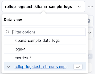

- Open the main menu, then click Stack Management > Data Views.
- Click Create data view, and select Rollup data view from the dropdown.
Enter rollup_logstash,kibana_sample_logs as your Data View and
@timestamp
as the Time Filter field name.The notation for a combination data view with both raw and rolled up data is
rollup_logstash,kibana_sample_data_logs
. In this data view,rollup_logstash
matches the rollup index andkibana_sample_data_logs
matches the raw data. - Open the main menu, click Dashboard, then Create dashboard.
- Set the time filter to Last 90 days.
- On the dashboard, click Create visualization.
Choose
as your source to see both the raw and rolled up data. - Select Bar vertical stacked in the chart type dropdown.

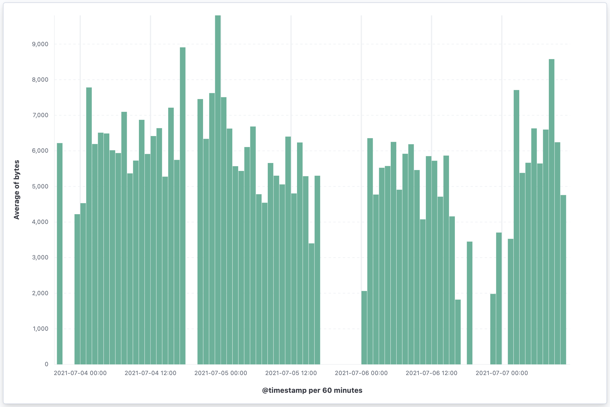

Add the
@timestamp
field to the Horizontal axis. -
Add the
bytes
field to the Vertical axis, defaulting to anAverage of bytes
.Kibana creates a vertical bar chart of your data. Select a section of the chart to zoom in.
