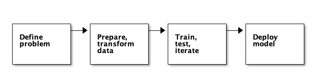

editElastic supervised learning enables you to train a machine learning model based on training examples that you provide. You can then use your model to make predictions on new data. This page summarizes the end-to-end workflow for training, evaluating and deploying a model. It gives a high-level overview of the steps required to identify and implement a solution using supervised learning.
The workflow for supervised learning consists of the following stages:
These are iterative stages, meaning that after evaluating each step, you might need to make adjustments before you move further.
