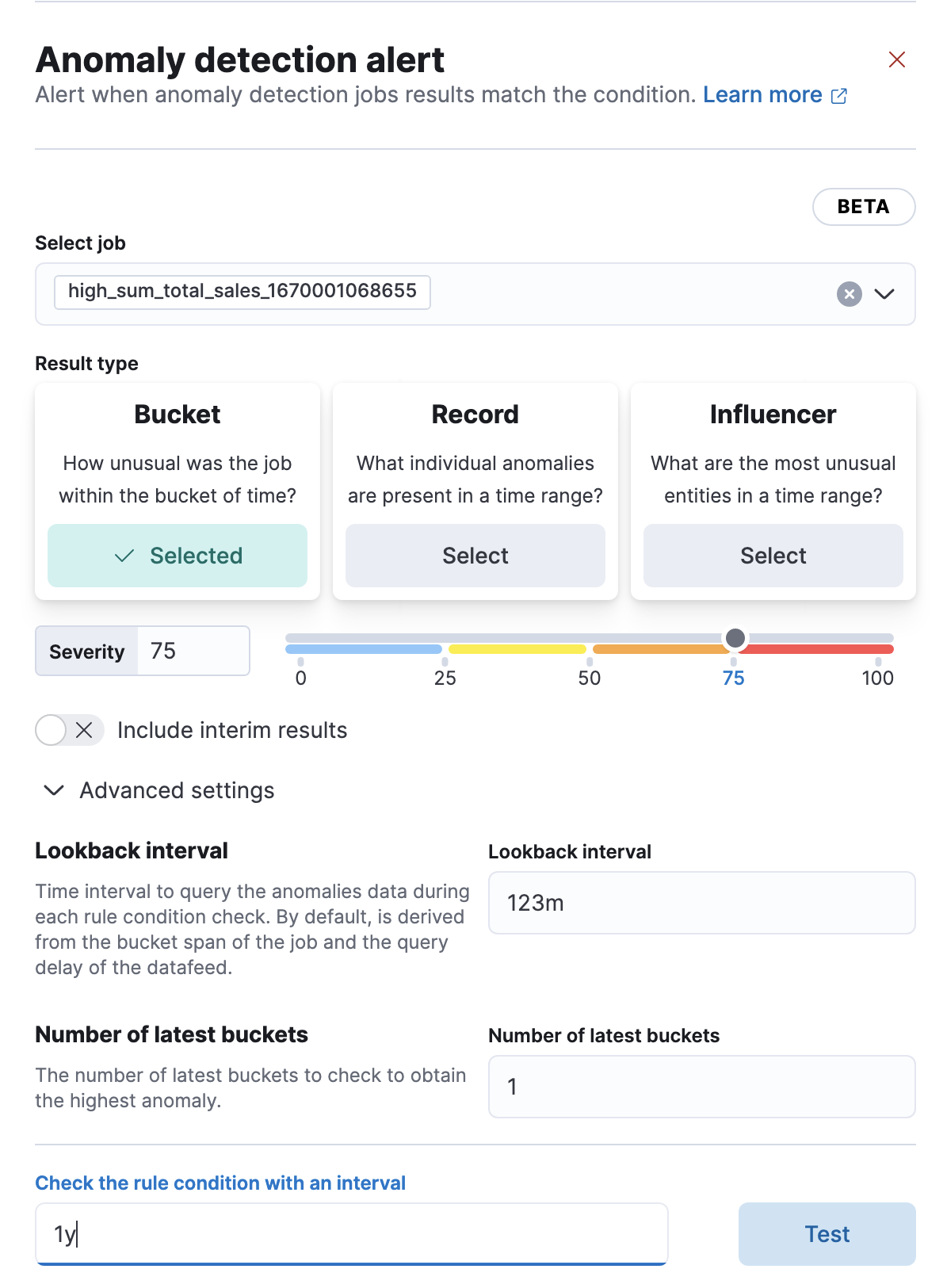

Anomaly detection alert
When you create an anomaly detection alert rule, you must select the job that the rule applies to.
You must also select a type of machine learning result. In particular, you can create rules based on bucket, record, or influencer results.
Selecting result type, severity, and test interval
For each rule, you can configure the anomaly_score that triggers the action. The anomaly_score indicates the significance of a given anomaly compared to previous anomalies. The default severity threshold is 75 which means every anomaly with an anomaly_score of 75 or higher triggers the associated action.
You can select whether you want to include interim results. Interim results are created by the anomaly detection job before a bucket is finalized. These results might disappear after the bucket is fully processed. Include interim results if you want to be notified earlier about a potential anomaly even if it might be a false positive. If you want to get notified only about anomalies of fully processed buckets, do not include interim results.
You can also configure advanced settings. Lookback interval sets an interval that is used to query previous anomalies during each condition check. Its value is derived from the bucket span of the job and the query delay of the datafeed by default. It is not recommended to set the lookback interval lower than the default value as it might result in missed anomalies. Number of latest buckets sets how many buckets to check to obtain the highest anomaly from all the anomalies that are found during the Lookback interval. An alert is created based on the anomaly with the highest anomaly score from the most anomalous bucket.
You can also test the configured conditions against your existing data and check the sample results by providing a valid interval for your data. The generated preview contains the number of potentially created alerts during the relative time range you defined.
As the last step in the rule creation process, define the actions that occur when the conditions are met.

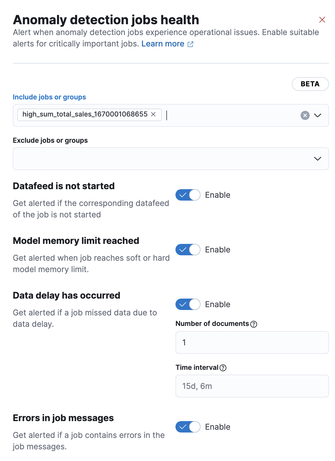

Anomaly detection jobs health
When you create an anomaly detection jobs health rule, you must select the job or group that the rule applies to. If you assign more jobs to the group, they are included the next time the rule conditions are checked.
You can also use a special character (*) to apply the rule to all your jobs. Jobs created after the rule are automatically included. You can exclude jobs that are not critically important by using the Exclude field.
Enable the health check types that you want to apply. All checks are enabled by default. At least one check needs to be enabled to create the rule. The following health checks are available:
Datafeed is not started
Notifies if the corresponding datafeed of the job is not started but the job is in an opened state. The notification message recommends the necessary actions to solve the error.
Model memory limit reached
Notifies if the model memory status of the job reaches the soft or hard model memory limit. Optimize your job by following these guidelines or consider amending the model memory limit.
Data delay has occurred
Notifies when the job missed some data. You can define the threshold for the amount of missing documents you get alerted on by setting Number of documents. You can control the lookback interval for checking delayed data with Time interval. Refer to the Handling delayed data page to see what to do about delayed data.
Errors in job messages
Notifies when the job messages contain error messages. Review the notification; it contains the error messages, the corresponding job IDs and recommendations on how to fix the issue. This check looks for job errors that occur after the rule is created; it does not look at historic behavior.
Selecting health checkers

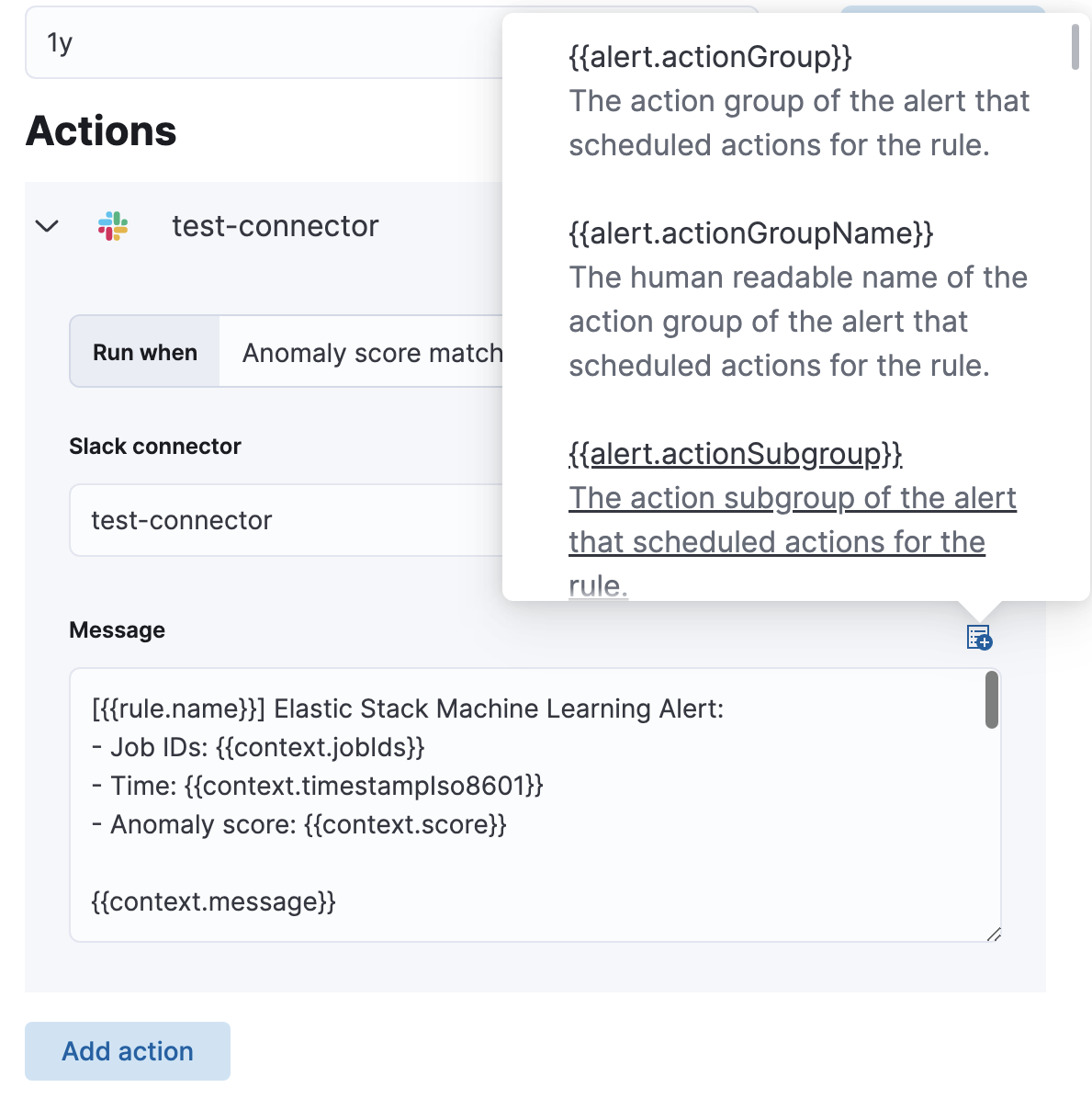

Your rule can use connectors, which are Kibana services or supported third-party integrations that run actions when the rule conditions are met or when the alert is recovered. For details about creating connectors, refer to Connectors.
For example, you can use a Slack connector to send a message to a channel. Or you can use an index connector that writes an JSON object to a specific index. It’s also possible to customize the notification messages. There is a set of variables that you can include in the message depending on the rule type; refer to Action variables.
Customizing your message
