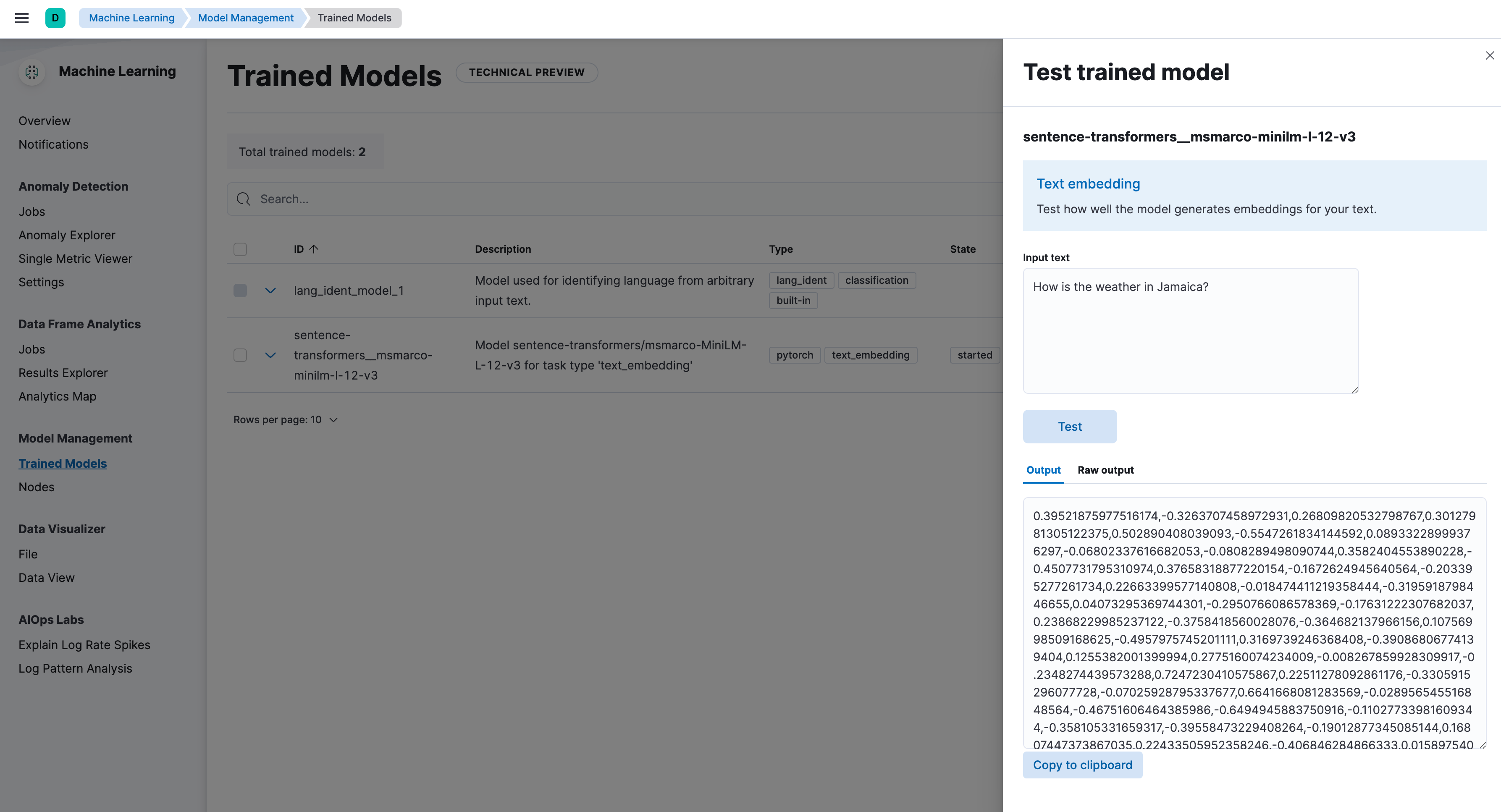

Test the text embedding model
Deployed models can be evaluated in Kibana under Machine Learning > Trained Models by selecting the Test model action for the respective model.
Test trained model UI

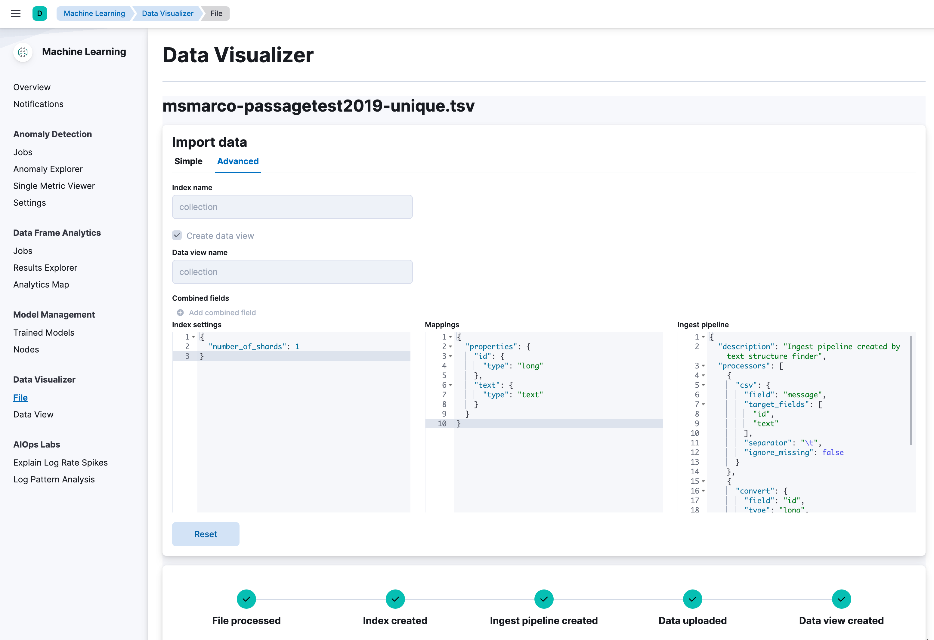

Load data
In this step, you load the data that you later use in an ingest pipeline to get the embeddings.
The data set msmarco-passagetest2019-top1000 is a subset of the MS MARCO Passage Ranking data set used in the testing stage of the 2019 TREC Deep Learning Track. It contains 200 queries and for each query a list of relevant text passages extracted by a simple information retrieval (IR) system. From that data set, all unique passages with their IDs have been extracted and put into a tsv file, totaling 182469 passages. In the following, this file is used as the example data set.
Upload the file by using the Data Visualizer. Name the first column id and the second one text. The index name is collection. After the upload is done, you can see an index named collection with 182469 documents.
Importing the data

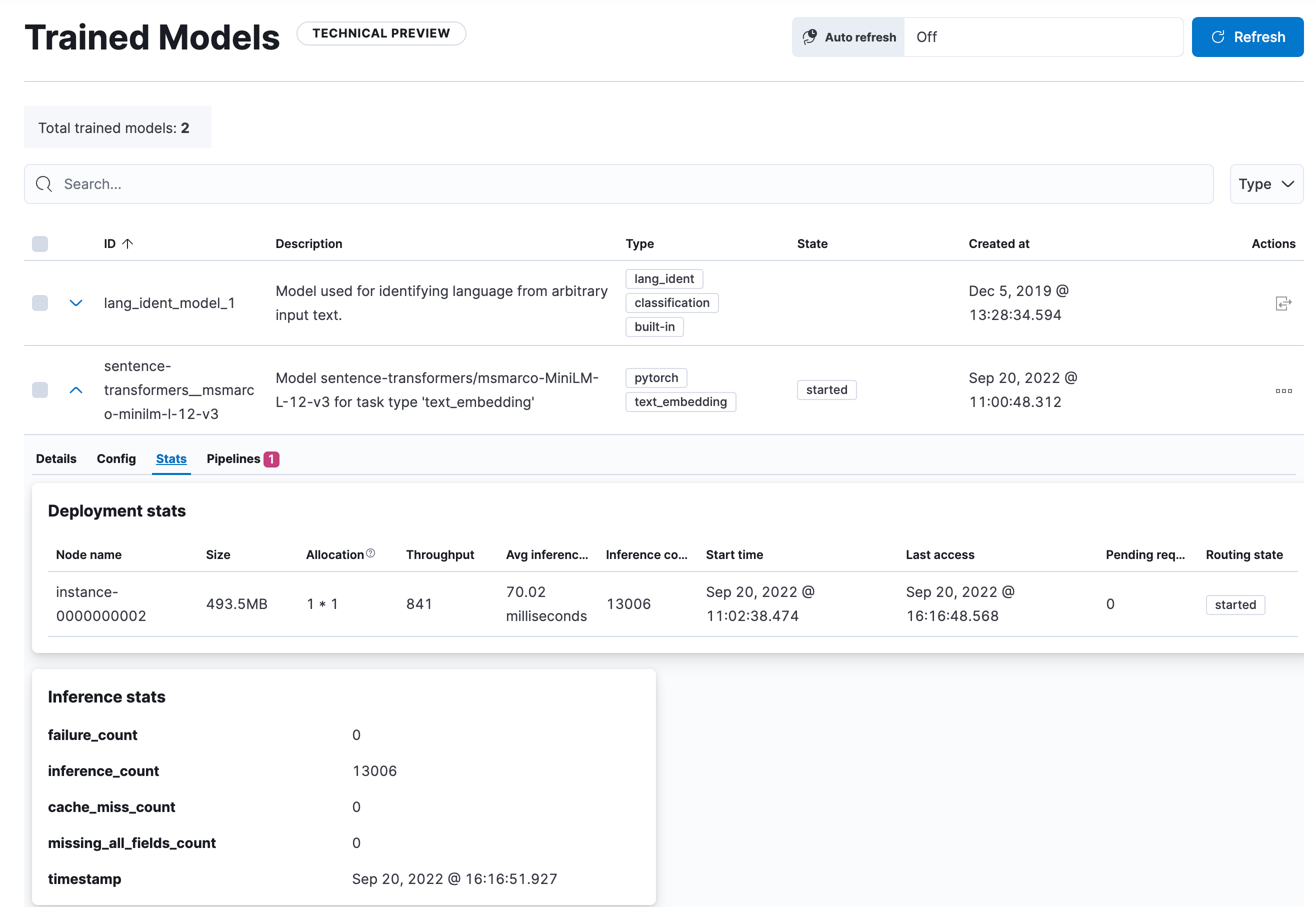

You can also open the model stat UI to follow the progress.
Model status UI
After the reindexing is finished, the documents in the new index contain the inference results – the vector embeddings.
