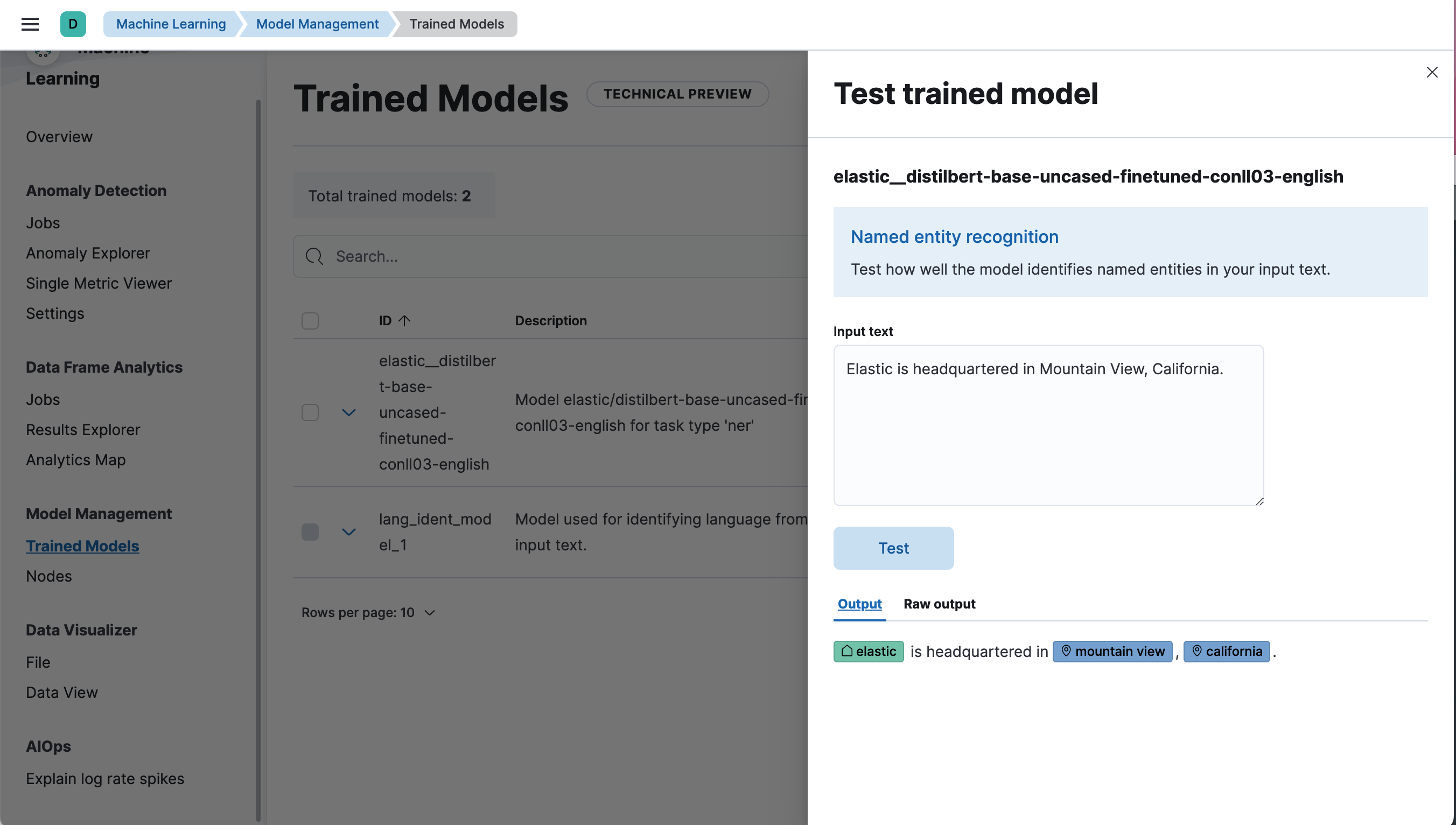

Deployed models can be evaluated in Kibana under Machine Learning > Trained Models by selecting the Test model action for the respective model.
Test trained model UI

You can also evaluate your models by using the _infer API. In the following request, text_field is the field name where the model expects to find the input, as defined in the model configuration. By default, if the model was uploaded via Eland, the input field is text_field.
POST _ml/trained_models/elastic__distilbert-base-uncased-finetuned-conll03-english/_infer
  "docs": [
      "text_field": "Elastic is headquartered in Mountain View, California."
The API returns a response similar to the following:
  "inference_results": [
      "predicted_value": "[Elastic](ORG&Elastic) is headquartered in [Mountain View](LOC&Mountain+View), [California](LOC&California).",
      "entities": [
          "entity": "elastic",
          "class_name": "ORG",
          "class_probability": 0.9958921231805256,
          "start_pos": 0,
          "end_pos": 7
          "entity": "mountain view",
          "class_name": "LOC",
          "class_probability": 0.9844731508992688,
          "start_pos": 28,
          "end_pos": 41
          "entity": "california",
          "class_probability": 0.9972361009811214,
          "start_pos": 43,
          "end_pos": 53
Using the example text "Elastic is headquartered in Mountain View, California.", the model finds three entities: an organization "Elastic", and two locations "Mountain View" and "California".

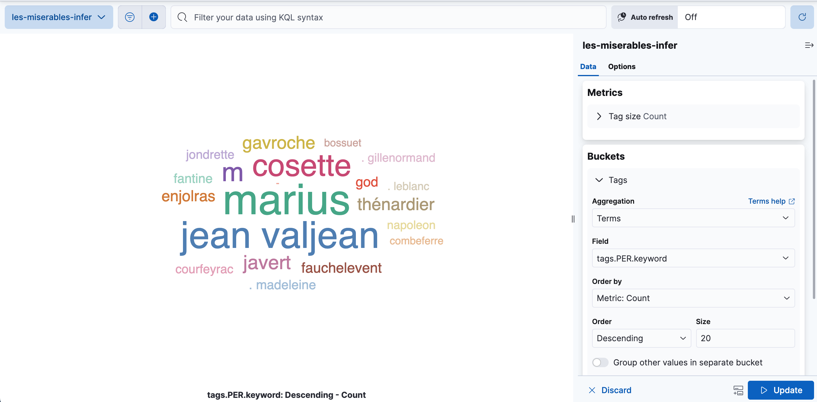

Visualize results
You can create a tag cloud to visualize your data processed by the inference pipeline. A tag cloud is a visualization that scales words by the frequency at which they occur. It is a handy tool for viewing the entities found in the data.
In Kibana, open Stack management > Data views, and create a new data view from the les-miserables-infer index pattern.
Open Dashboard and create a new dashboard. Select the Aggregation based-type > Tag cloud visualization. Choose the new data view as the source.
Add a new bucket with a term aggregation, select the tags.PER.keyword field, and increase the size to 20.
Optionally, adjust the time selector to cover the data points in the data view if you selected a time field when creating it.
Update and save the visualization.
Tag cloud created from Les Misérables
