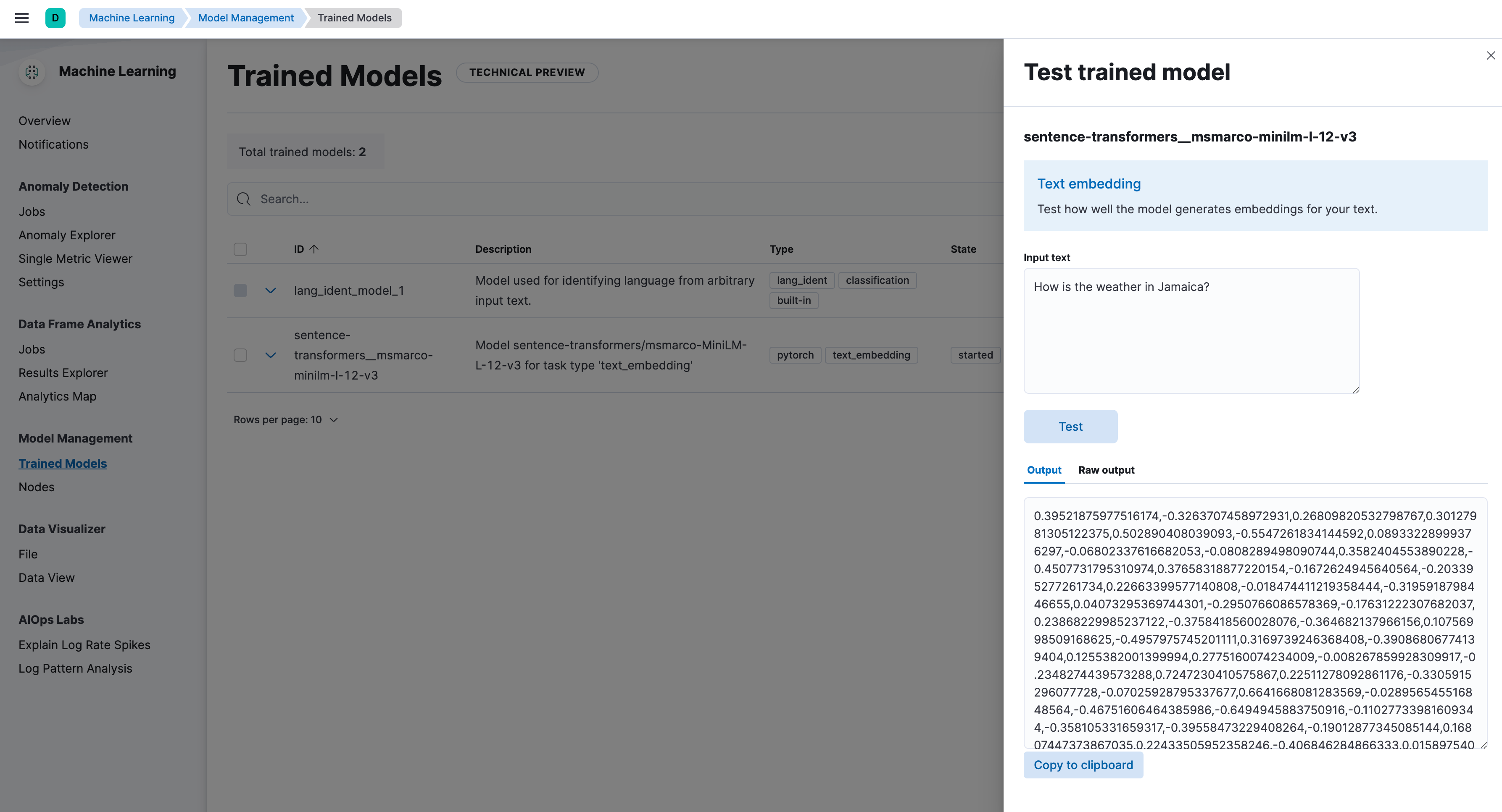

Test the text embedding model
editDeployed models can be evaluated in Kibana under Machine Learning > Trained Models by selecting the Test model action for the respective model.

The API returns a response similar to the following:
{ "inference_results": [ { "predicted_value": [ 0.39521875977516174, -0.3263707458972931, 0.26809820532798767, 0.30127981305122375, 0.502890408039093, ... ] } ] }
The result is the predicted dense vector transformed from the example text.

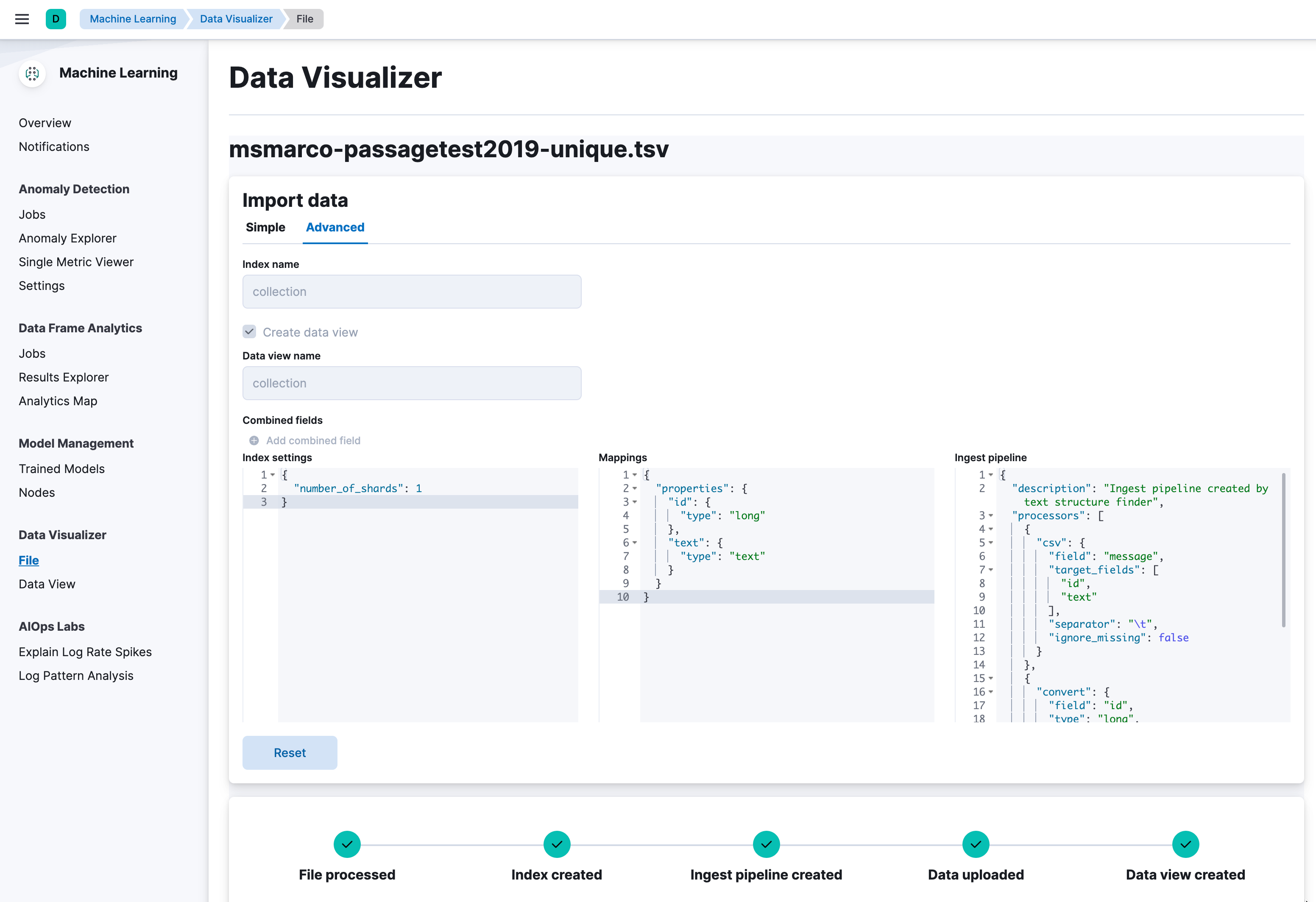

Upload the file by using the
Data Visualizer.
Name the first column id
and the second one text
. The index name is
collection
. After the upload is done, you can see an index named collection
with 182469 documents.
