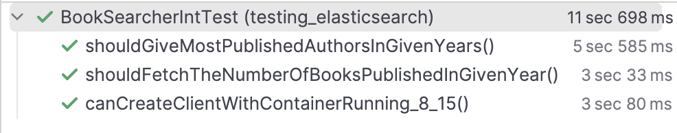

Let's start with the current integration test suite. It functions as intended, but with only three tests, it takes five and a half minutes — roughly 90 seconds per test — when you run time ./mvnw test '-Dtest=*IntTest*'. Please note your results may vary depending on your hardware, internet speed, etc.

This simple change reduced the overall testing time to around 3 minutes and 40 seconds, or roughly 73 seconds per test. While this is a nice improvement, we can push further.

It's also worth noting that in the demo project (branch data-init), which currently has only three integration tests, roughly half of the total duration is spent on container startup. After the initial warm-up, individual tests take about 3 seconds each. Consequently, adding three more tests won't double the overall time to another 30 seconds, but will only increase it by roughly 9-10 seconds. The test execution times, including data initialization, can be observed in the IDE:

Overall, we significantly reduced the test suite's duration — from 5.5 minutes to around 30 seconds — lowering costs and speeding up the feedback loop.
