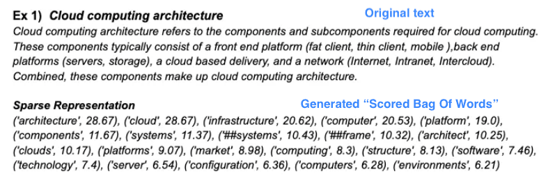

How does the Elastic Learned Sparse Encoder work?
When the Elastic Learned Sparse Encoder is applied on a raw text (such as a log message), it generates a data structure. The structure’s keys represent terms found in the raw text, as well as their synonyms. In a process called term expansion , the model adds and removes terms and synonyms to the data based on their relevance to the raw text, from a static vocabulary of 30K fixed terms. This is similar to vector embedding in a way that an auxiliary data structure (or multiple structures) is created and stored in a field, which then can be used for just-in-time semantic matching within a query.
Each term also has an associated score, which captures its contextual importance within the raw text. We call this data structure a (scored) bag of words or BOW.
Example BOW
Notice how the input text’s words are captured, stemmed, their synonyms are added, and finally scored. Also note that the “scored bag of words” structure is just a map of [word => score]. You will see how this is generated for our syslogs later on.
At query time, behind the scenes the input query string goes through the same inference process as the raw log text we did at ingestion time, in order to generate a BOW. Then this BOW is matched against the BOWs of the raw log text in the index, similarly to a k-nearest neighbor search with embedded vectors. The final rank score of the search results is the result of a formula that takes into account the scores from matching words from the BOWs of the query and the raw log text.

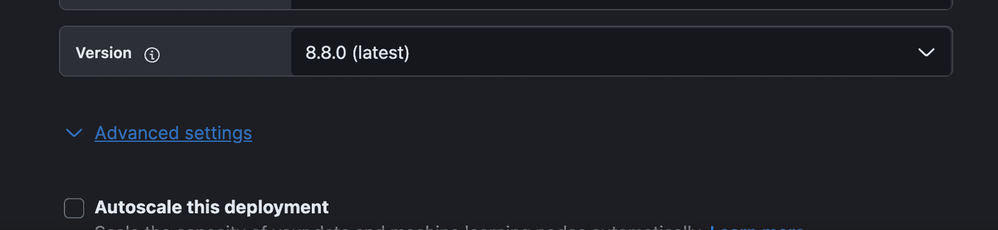

Step 0: Create an account on Elastic Cloud
A couple of notes before continuing:

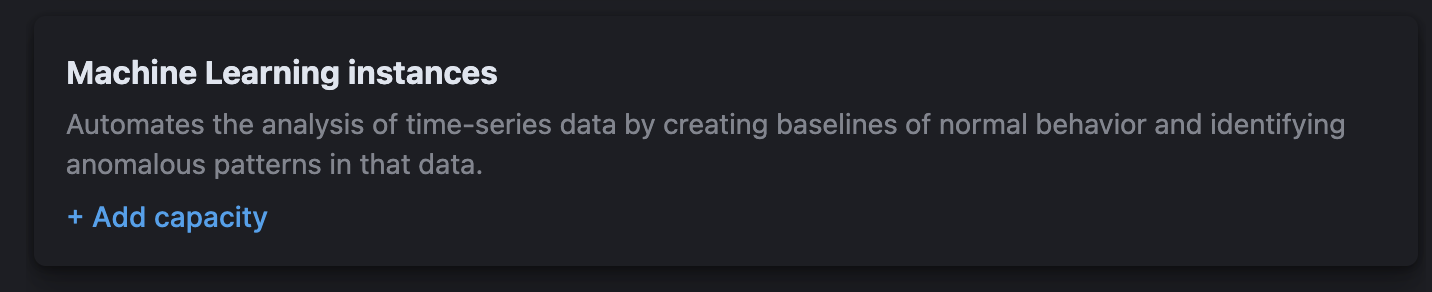

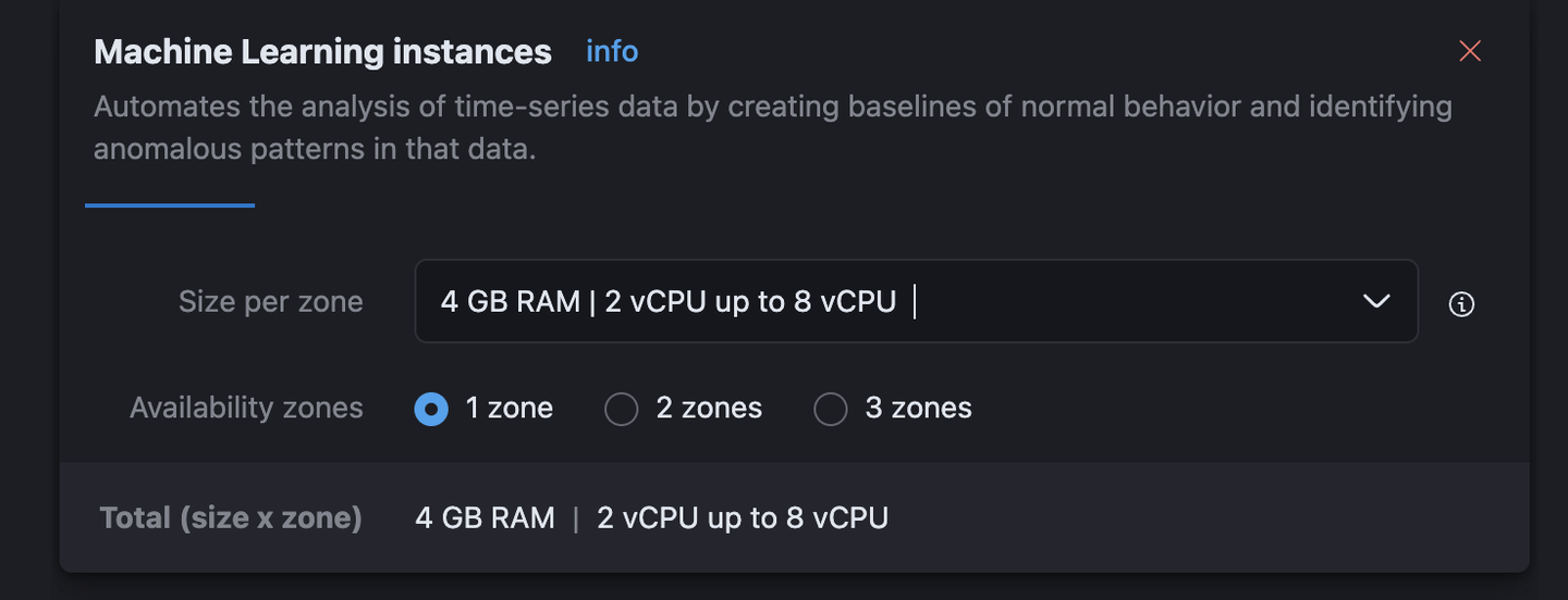

1. Make sure you click on “Advanced Options” (shown below) and add a machine learning node with at least 4GB of RAM for this blog when you create an Elastic Cloud instance.
2. Be sure to follow the “Add System” integration steps when you follow the instructions below.
With those notes in mind, Follow the instructions to get started on Elastic Cloud.

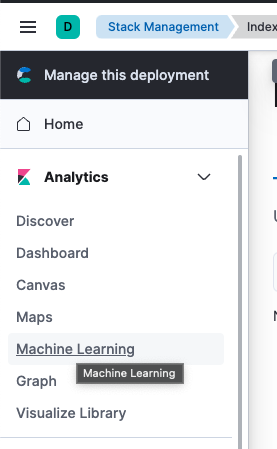

Go to Analytics -> Machine Learning:
Click on Model Management -> Trained Models:

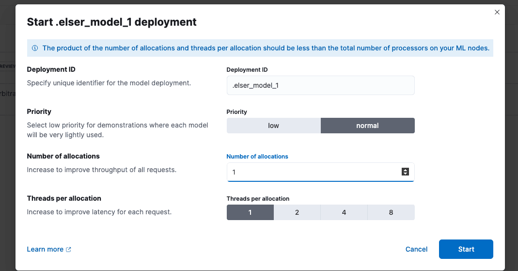

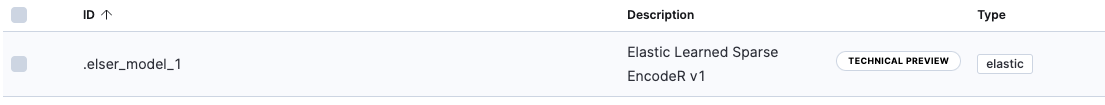

Choose the Elastic Learned Sparse EncodeR v1 and click the download button at the far right.
Once it is downloaded, we need to start it up.
For the purposes of this blog, the default settings are fine.

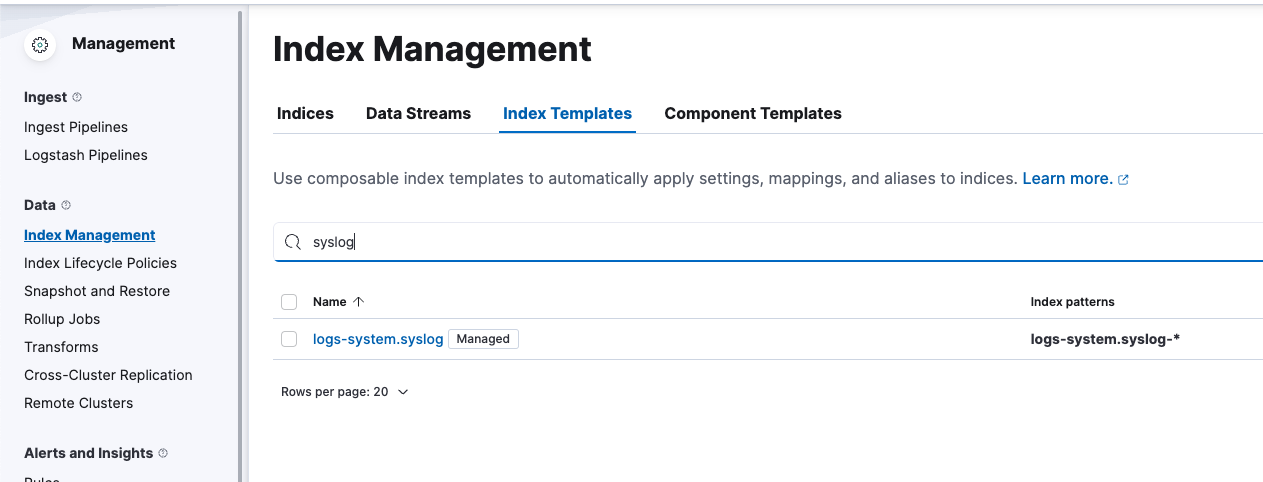

Next, go to Index Management -> Index Templates. We are going to modify the “syslog” index as shown below:
Click on the index name, select Manage in the bottom right, and then select Edit.

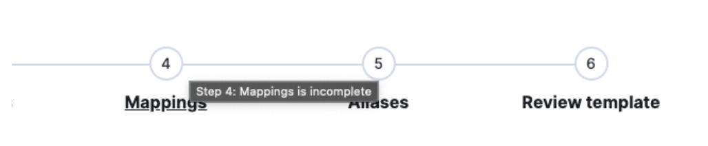

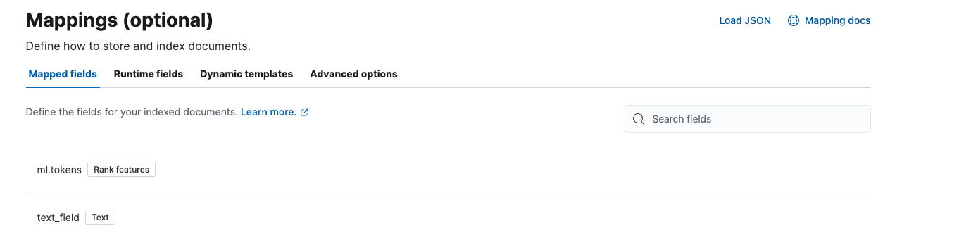

Skip to step 4: “Mappings.”
And add the following mappings: ml.tokens and text_field.
Click Next and save.

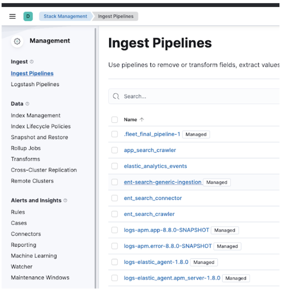

First, head over to Ingest Pipelines:
Create a new ingest pipeline called “logs-system.syslog@custom” This is a special name that is called from the main syslog ingest pipeline and is present in all the “Managed” pipelines so you can add custom ingest steps.

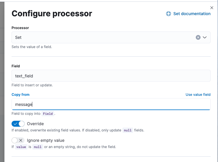

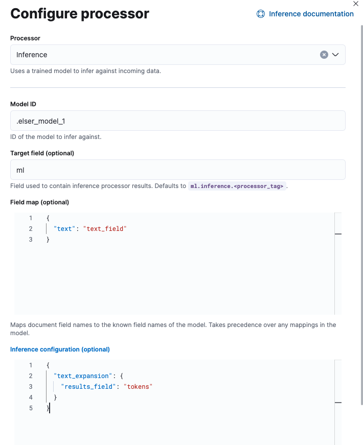

Now let's add two processors to this ingest pipeline:
  1. The first processor will set the text_field with the log message field, which has the log data we want to search for by using the Set processor and Copy from from operation as shown below.
  1. The second processor to add in is the "inference" processor that will generate the tokens we need for semantic search. Set that up in the following way.
Field map:
 "text": "text_field"
Inference configuration:
 "text_expansion": {
   "results_field": "tokens"
Once done, click Create pipeline.

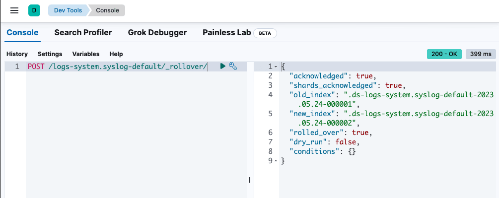

Step 4: Rollover the index
To force the index to rollover and use the new index template we created, head over to Dev Tools and execute the following POST:
POST /logs-system.syslog-default/_rollover/

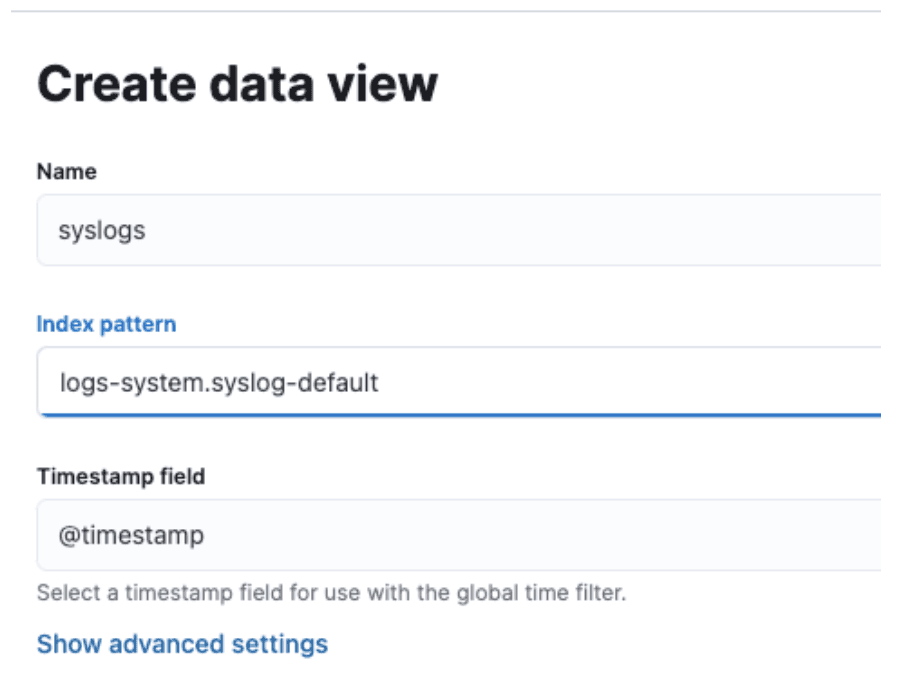

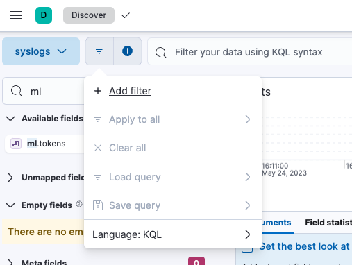

Now, go to Discover and create a new data view that just shows the syslogs:

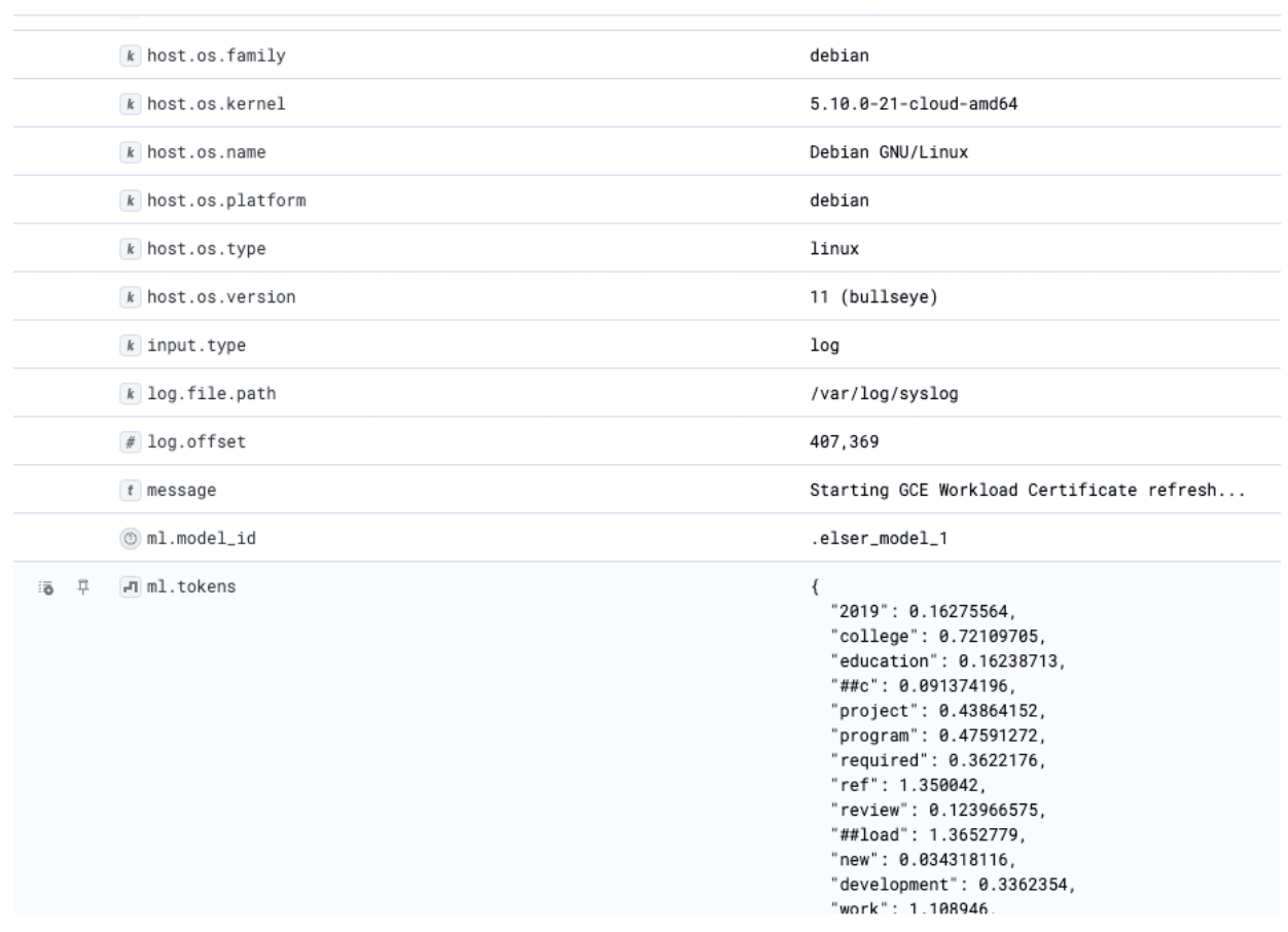

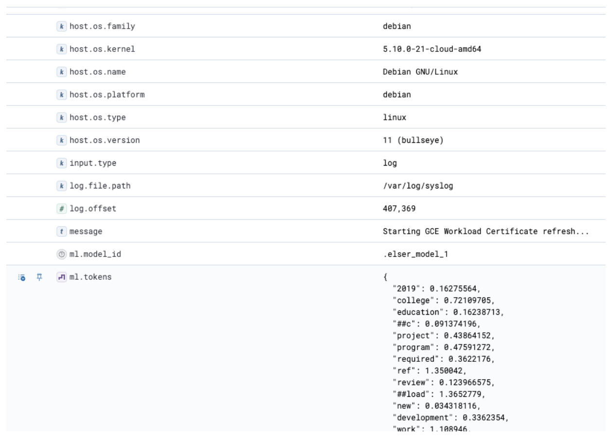

You might have to wait a bit for some data to populate here. Once there is data, you should see the ML Tokens field populated like so:
This is the magic of the Elastic Sparse Learned Encoder The tokens you can see here power how it is able to understand the semantic meaning from the log lines and enable you to find logs that have similar meaning to your search parameter.
Now we can run a semantic search. Change the language box below from KQL to Lucene.
Enter the following into the search box. Here the text expansion query uses the natural language processing model to convert the query text into a list of token-weight pairs, which are then used in a query against the rank features field we defined above.

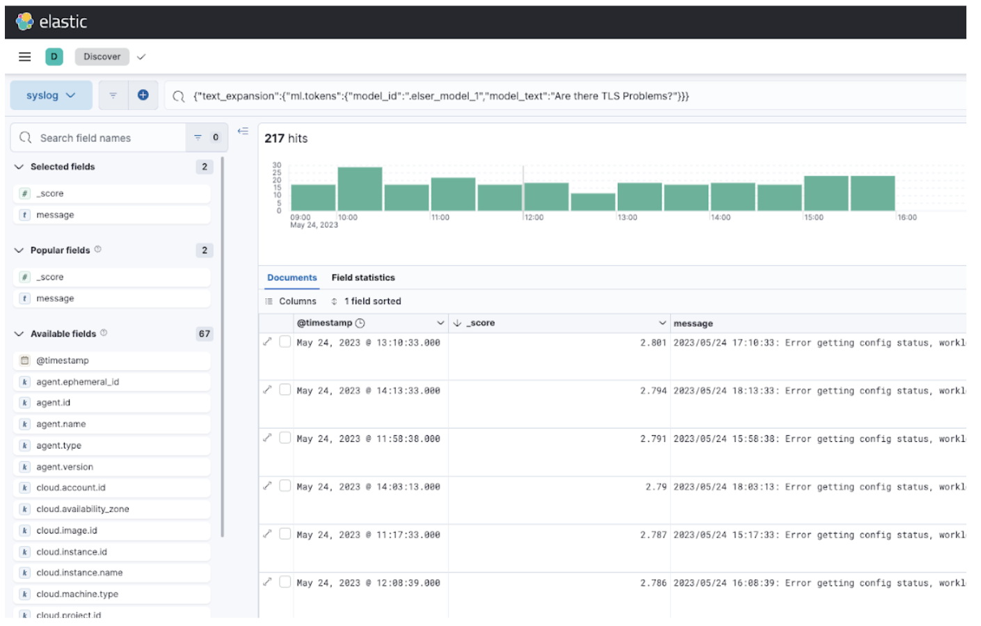

{"text_expansion":{"ml.tokens":{"model_id":".elser_model_1","model_text":"Are there any TLS warnings?"}}}
Congratulations! You just did a semantic search with Elastic.

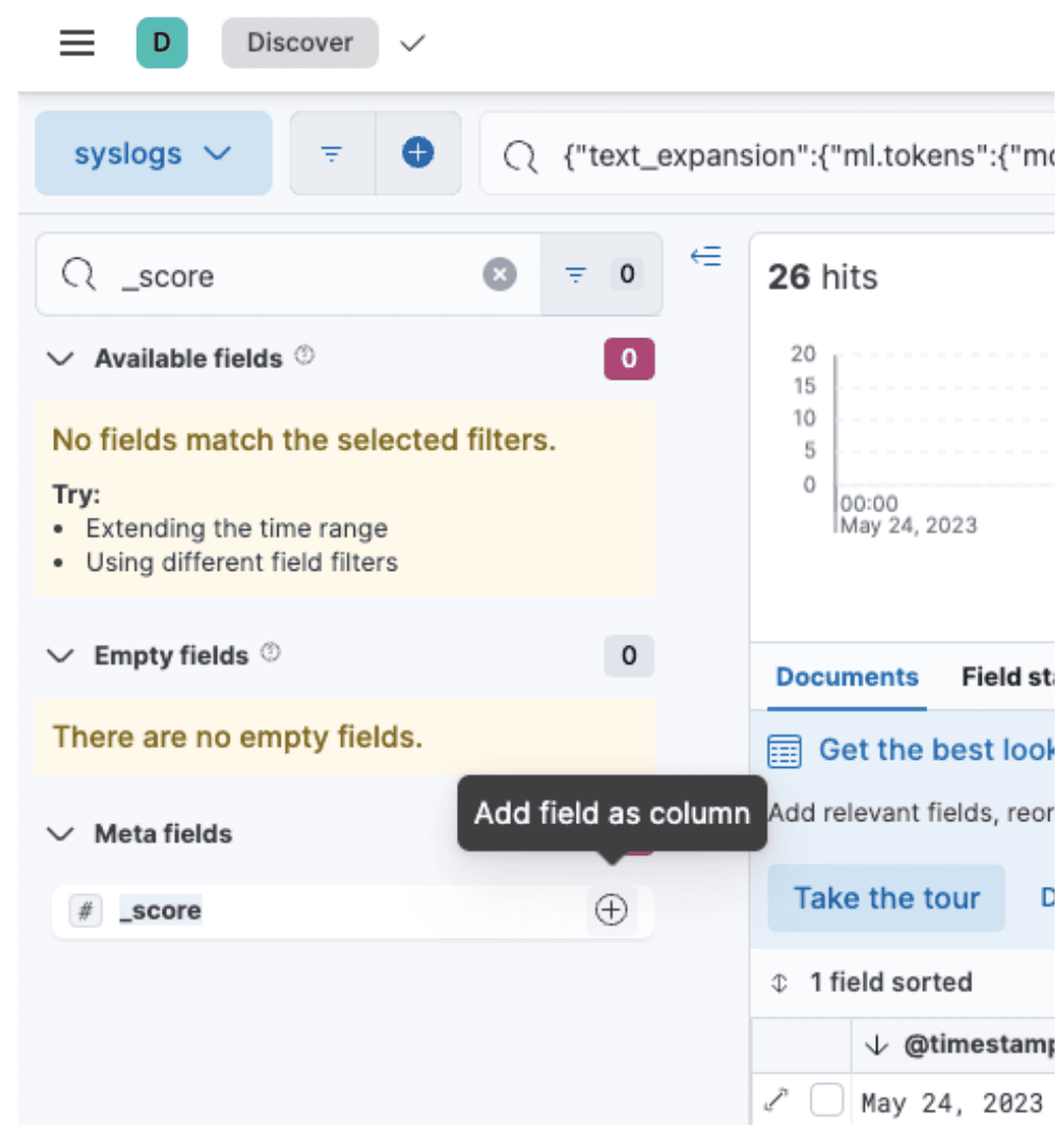

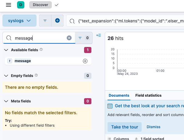

Now there is one more thing to do here: we need to sort the results so that we see the top ranked search results. Add the _score field as shown below.
And the “message” field.
Now we can sort this by High to Low, which gives us an indication of what was a strong match (similar to how search results are ranked on Google):

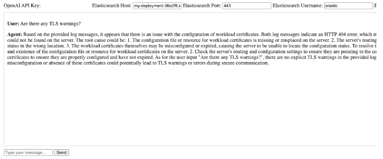

ChatGPT responds:
The error message you're seeing seems to suggest that there might be an issue related to Transport Layer Security (TLS) certificates. The HTTP 404 error indicates that the requested resource cannot be found.
This error could be due to various reasons:
  • Incorrect or incomplete configuration: The error suggests that workload certificates may not be configured. If your service requires TLS certificates to communicate securely, but these have not been properly set up, this could cause the issue. You should review your configuration to make sure TLS is correctly set up
  • Wrong path: The system might not be able to find the certificates because they're not located at the specified path in your configuration. You need to ensure that the path to the certificate files is correct.
  • Permission issues: There could be issues with file or directory permissions that are preventing your system from accessing the certificate files. You should ensure that the relevant user or service has the necessary permissions to access these files.
  • Server or service is not available: The HTTP 404 error could indicate that the server or service you're trying to reach is not currently available or doesn't exist. You need to check if the server is running and that the endpoint is correct. Now if you didn’t want to do this yourself, I have created an application that does all of this over here, in this GitHub repository. When you run it, you get this nice graphical user interface:

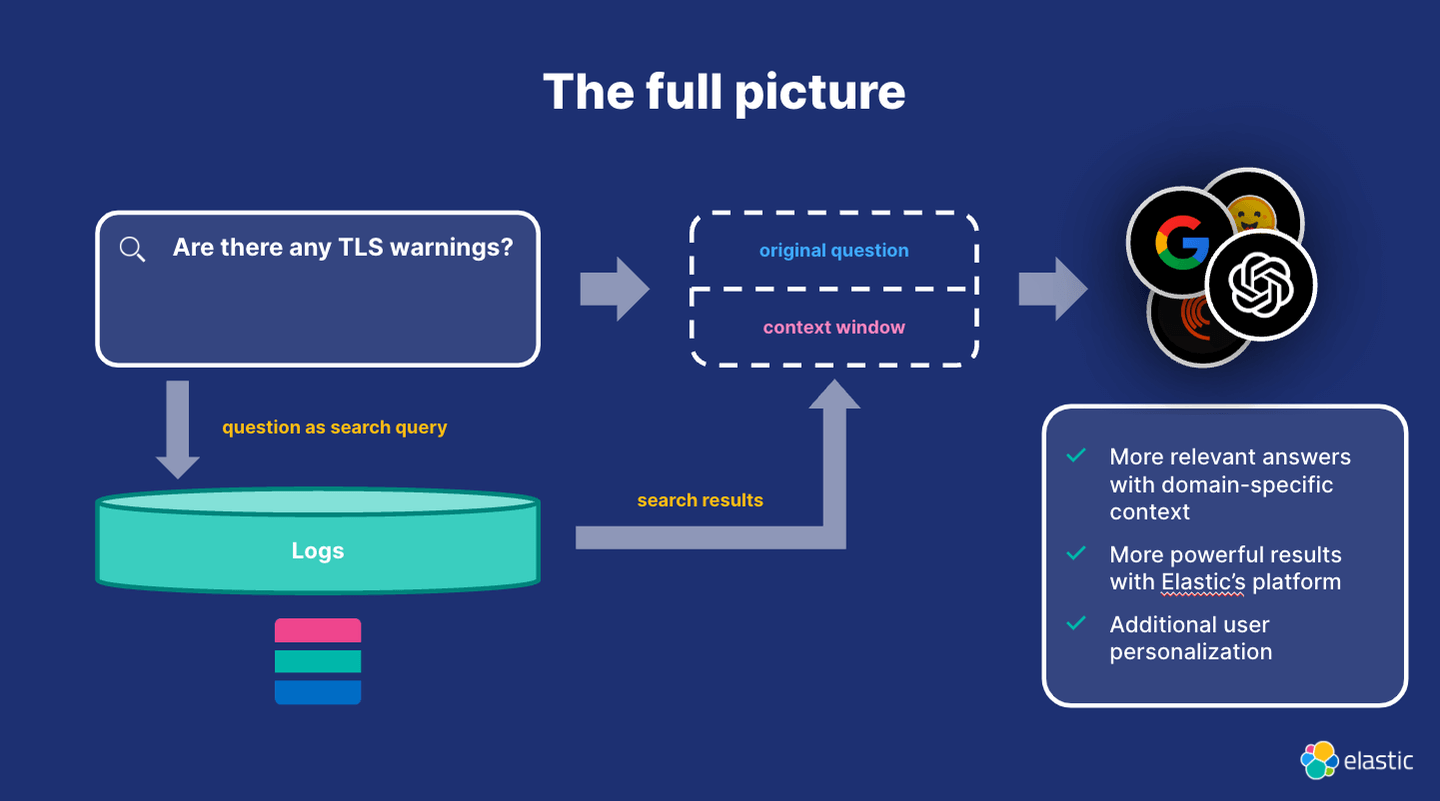

So with everything wired up, the architecture of our solution ends up like this:
