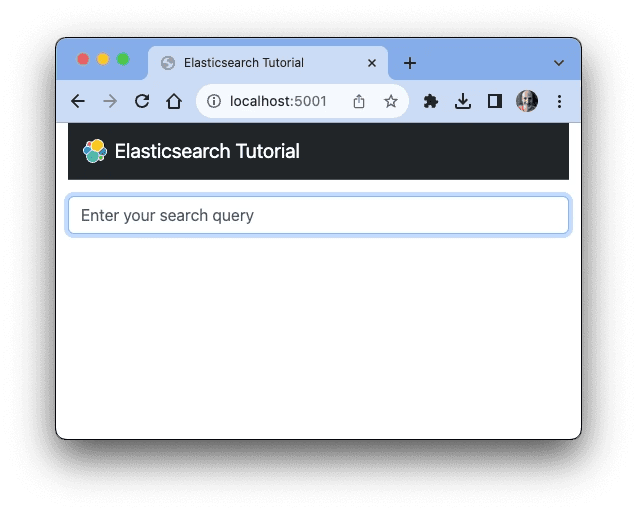

At this point you should be able to start the application with the following command:
flask run
To confirm that the application is running, open your browser and navigate to http://localhost:5001.
NOTE: The application in this early stage is just an empty shell. You can type something in the search box and request a search if you like, but the response is always going to be that there are no results. In the following sections you will learn how to load some content in an Elasticsearch index and perform searches.
The Flask application is configured to run in development mode. When it detects that a source file has been changed, it will restart itself automatically to incorporate the changes. You can leave this terminal session with the application running while you continue with the tutorial, and as you make changes the application will restart to update.
