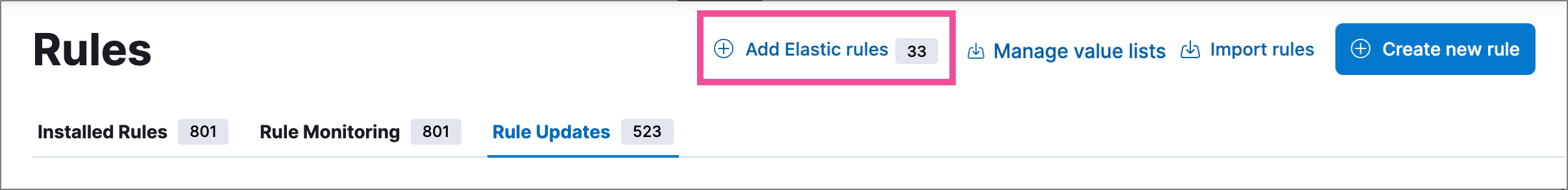

  1. Find Detection rules (SIEM) in the navigation menu or by using the global search field, then go to the Rules table.
    The badge next to Add Elastic rules shows the number of prebuilt rules available for installation.
    The Add Elastic Rules page
  2. Click Add Elastic rules.

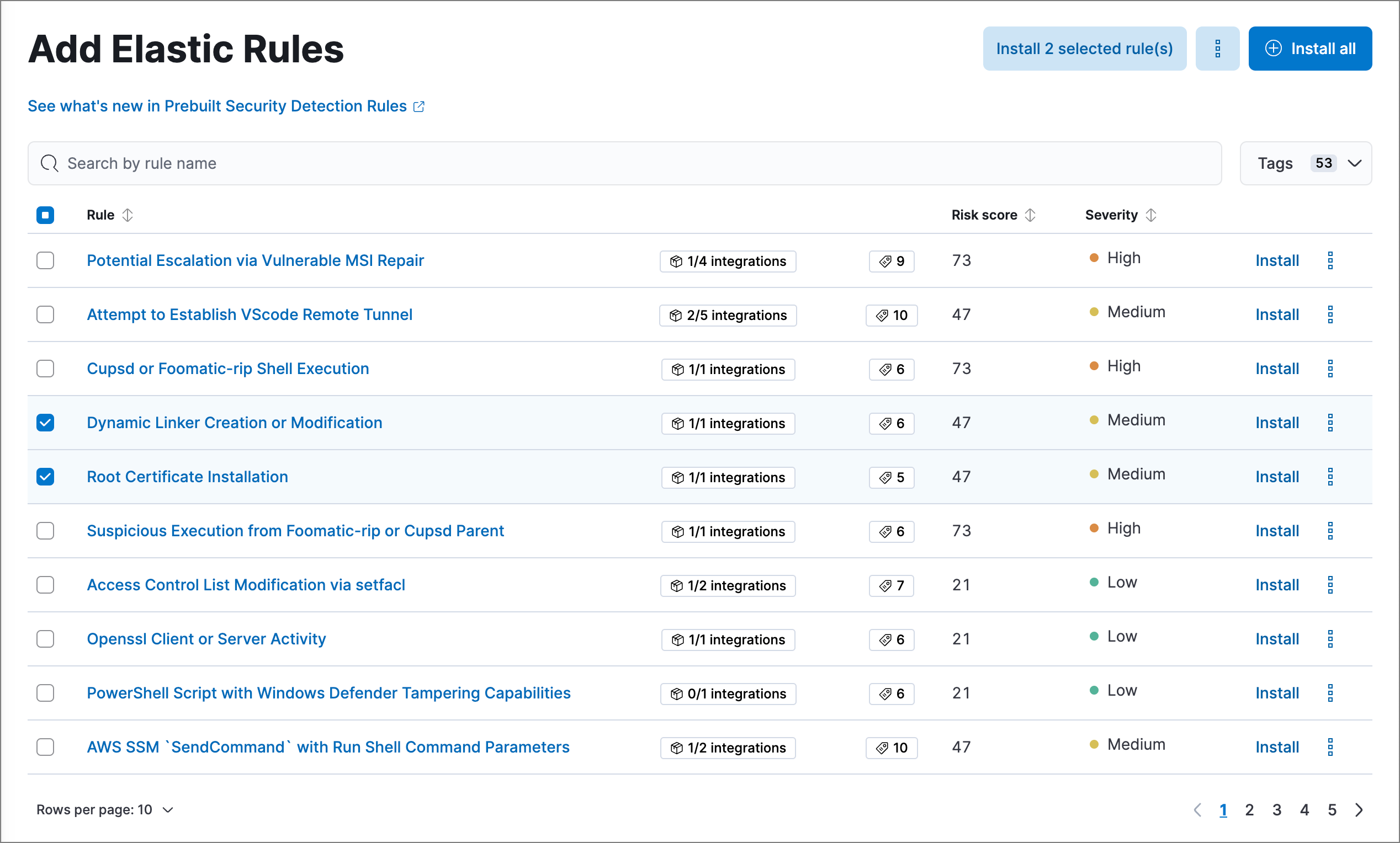

    To examine the details of a rule before you install it, select the rule name. This opens the rule details flyout.
  3. Do one of the following:
    • Install all available rules: Click Install all at the top of the page. (This doesn’t enable the rules; you still need to do that manually.)
    • Install a single rule: In the rules table, either click Install to install a rule without enabling it, or click Vertical boxes buttonInstall and enable to start running the rule once it’s installed.
    • Install multiple rules: Select the rules, and then at the top of the page either click Install x selected rule(s) to install without enabling the rules, or click Vertical boxes buttonInstall and enable to install and start running the rules.
    Tip
    Use the search bar and Tags filter to find the rules you want to install. For example, filter by OS: Windows if your environment only includes Windows endpoints. For more on tag categories, refer to Prebuilt rule tags.

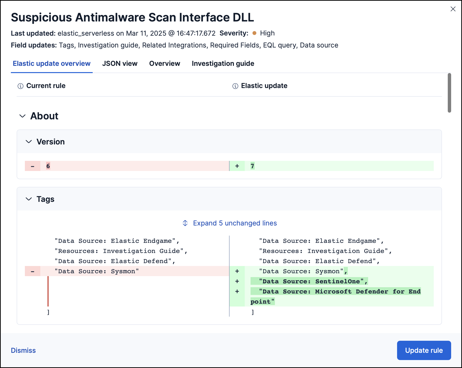

  3. (Optional) To examine the details of a rule’s latest version before you update it, select the rule name. This opens the rule details flyout.
    Select the Elastic update overview tab to view rule changes field by field, or the JSON view tab to view changes for the entire rule in JSON format. Both tabs display side-by-side comparisons of the Current rule (what you currently have installed) and the Elastic update version (what you can choose to install). Deleted characters are highlighted in red; added characters are highlighted in green.
    To accept the changes and install the updated version, select Update rule.

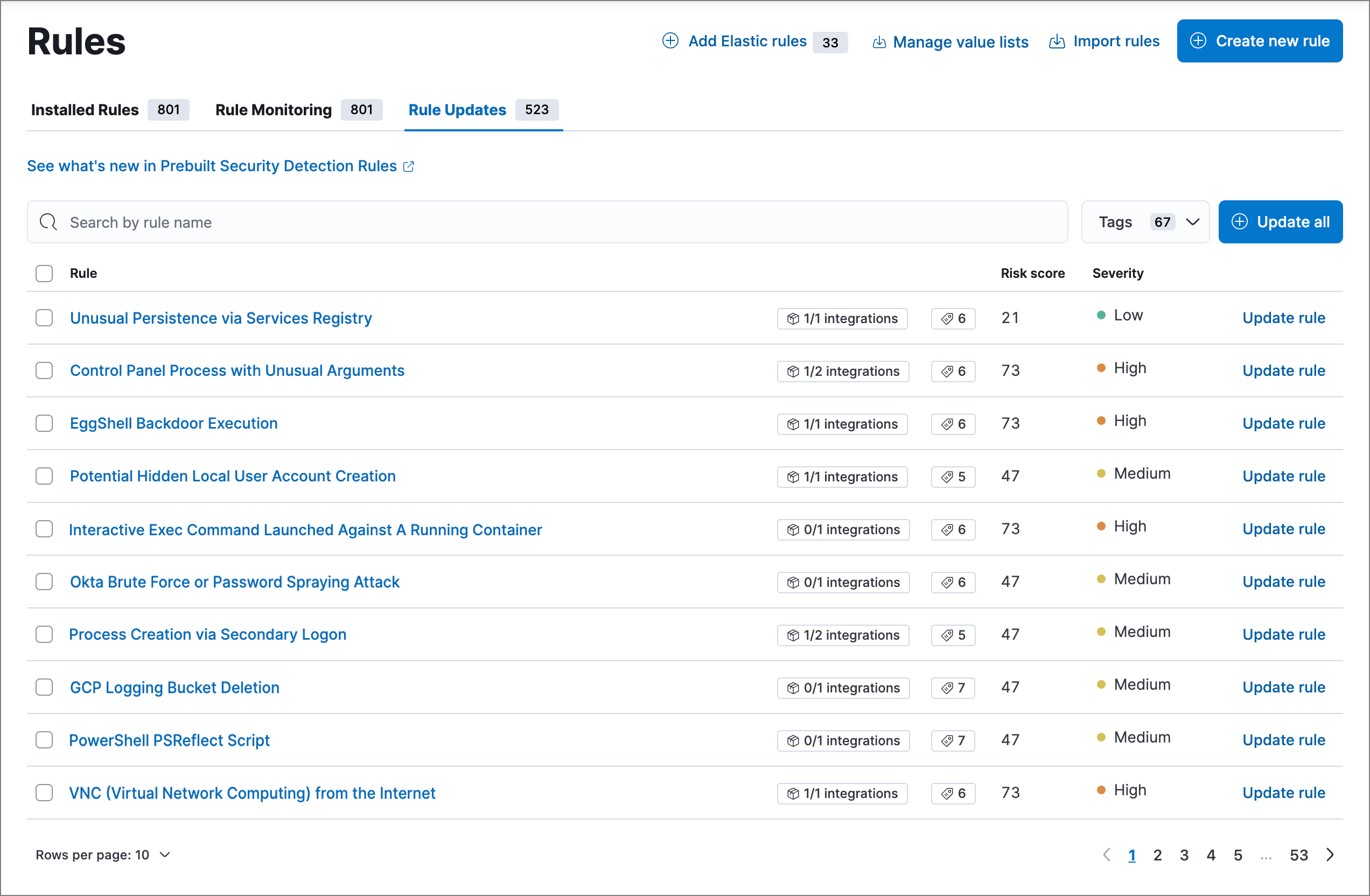

  4. Do one of the following to update prebuilt rules on the Rules page:
    • Update all available rules: Click Update all.
    • Update a single rule: Click Update rule for that rule.
    • Update multiple rules: Select the rules and click Update x selected rule(s).
      Tip
      Use the search bar and Tags filter to find the rules you want to update. For example, filter by OS: Windows if your environment only includes Windows endpoints. For more on tag categories, refer to Prebuilt rule tags.
