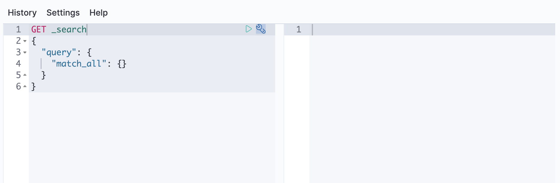

Open your deployment’s side navigation menu (placed under the Elastic logo in the upper left corner) and go to Dev Tools > Console.
To view the affected indices using the cat indices API.
GET _cat/indices?v&health=red&h=index,status,health
