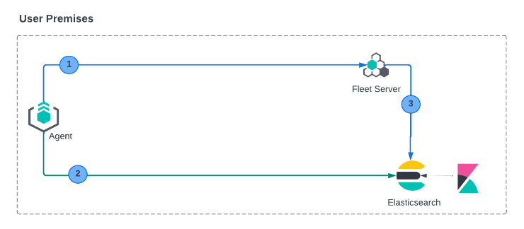

Fleet-managed Elastic Agent has two main connections to ensure correct operations:
- Connectivity to Fleet Server (the control plane, to check in, download policies, and similar).
- Connectivity to an Output (the data plane, such as Elasticsearch or Logstash).
In order to bootstrap, Elastic Agent initially must establish a secure connection to the Fleet Server, which can reside on-premises or in Elastic Cloud. This connectivity verification process ensures the agent’s authenticity. Once verified, the agent receives the policy configuration. This policy download equips the agent with the knowledge of the other components it needs to engage with. For instance, it gains insights into the output destinations it should write data to.
When mTLS is required, the secure setup between Elastic Agent, Fleet, and Fleet Server is configured through the following steps:
- mTLS is enabled.
The initial mTLS connection between Elastic Agent and Fleet Server is configured when Elastic Agent is enrolled, using the parameters passed through the
elastic-agent install
orelastic-agent enroll
command. -
Once enrollment has completed, Elastic Agent downloads the initial Elastic Agent policy from Fleet Server.
- If the Elastic Agent policy contains mTLS configuration settings, those settings will take precedence over those used during enrollment: This includes both the mTLS settings used for connectivity between Elastic Agent and Fleet Server (and the Fleet application in Kibana, for Fleet-managed Elastic Agent), and the settings used between Elastic Agent and it’s specified output.
- If the Elastic Agent policy does not contain any TLS, mTLS, or proxy configuration settings, these settings will remain as they were specified when Elastic Agent enrolled. Note that the initial TLS, mTLS, or proxy configuration settings can not be removed through the Elastic Agent policy; they can only be updated.
When you run Elastic Agent with the Elastic Defend integration, the TLS certificates used to connect to Fleet Server and Elasticsearch need to be generated using RSA. For a full list of available algorithms to use when configuring TLS or mTLS, see Configure SSL/TLS for standalone Elastic Agents. These settings are available for both standalone and Fleet-managed Elastic Agent.

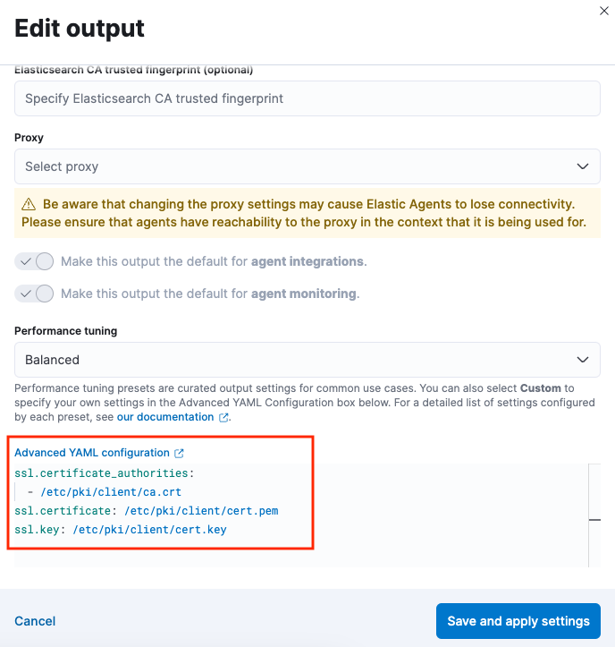

Fleet settings:
editIn Kibana, navigate to Fleet, open the Settings tab, and choose the Output that you’d like to configure. In the Advanced YAML configuration, add the following settings:
List of CA certificates that are trusted when Fleet Server connects to Elastic Agent |
This certificate will be passed down to all the agents that have this output configured in their policy. This certificate is used by the agent when establishing mTLS to the output. You may either apply the full certificate, in which case all the agents get the same certificate OR alternatively point to a local directory on the agent where the certificate resides, if the certificates are to be unique per agent. |
This certificate key will be passed down to all the agents that have this output configured in their policy. The certificate key is used to decrypt the SSL certificate. |
Note the following when you specify these SSL settings:
- The certificate authority, certificate, and certificate key need to be specified as a path to a local file. You cannot specify a directory.
- You can define multiple CAs or paths to CAs.
- Only one certificate and certificate key can be defined.
In the Advanced YAML configuration these settings should be added in the following format:
ssl.certificate_authorities: - /path/to/ca ssl.certificate: /path/to/cert ssl.key: /path/to/cert_key
OR

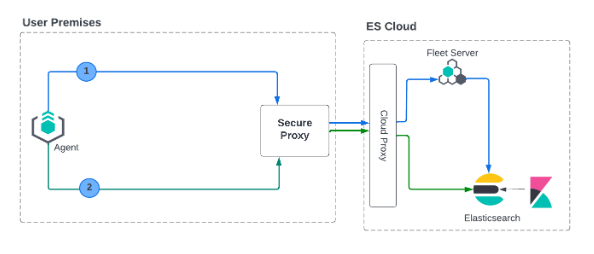

Fleet Server on Elastic Cloud using a proxy
editIn this scenario, where you have access to the proxy, you can configure mTLS between the agent and your proxy.
Elastic Agent settings
editDuring Elastic Agent installation on premise use the following options:
List of CA certificates that are trusted when Elastic Agent connects to Fleet Server or to the proxy between Elastic Agent and Fleet Server |
Elastic Agent certificate to present during authentication to Fleet Server or to the proxy between Elastic Agent and Fleet Server |
Elastic Agent’s private certificate key used to decrypt the certificate |
The path to the file that contains the passphrase for the mutual TLS private key that Elastic Agent will use to connect to Fleet Server |

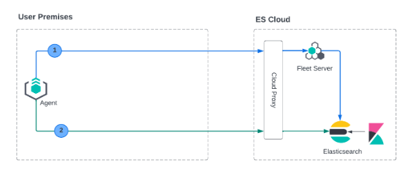

Fleet Server on-premise and Hosted Elasticsearch Service
editIn some scenarios you may want to deploy Fleet Server on your own premises. In this case, you’re able to provide your own certificates and certificate authority to enable mTLS between Fleet Server and Elastic Agent.
However, as with the Fleet Server on Elastic Cloud use case, the data plane TLS connections terminate at the Elastic Cloud boundary. Elastic Cloud is not a multi-tenanted service and therefore can’t provide per-user certificates.
Similar to the Fleet Server on Elastic Cloud use case, a secure proxy can be placed in such an environment to terminate the TLS connections and satisfy the mTLS requirements.
editDuring Elastic Agent installation on premise use the following options, similar to Elastic Agent deployment on premises:
List of CA certificates that are trusted for when Elastic Agent connects to Fleet Server |
Elastic Agent certificate to present to Fleet Server during authentication |
Fleet Server settings
editDuring Fleet Server installation on-premise use the following options so that Fleet Server can authenticate itself to the agent and then also to the secure proxy server:
CA to use for the Elasticsearch connection, via secure proxy. This CA is used to authenticate the TLS connection from a secure proxy |
List of CA certificates that are trusted when Elastic Agent connects to Fleet Server |
Fleet Server certificate to present to Elastic Agents during authentication |
Fleet Server’s private certificate key used to decrypt the certificate |
