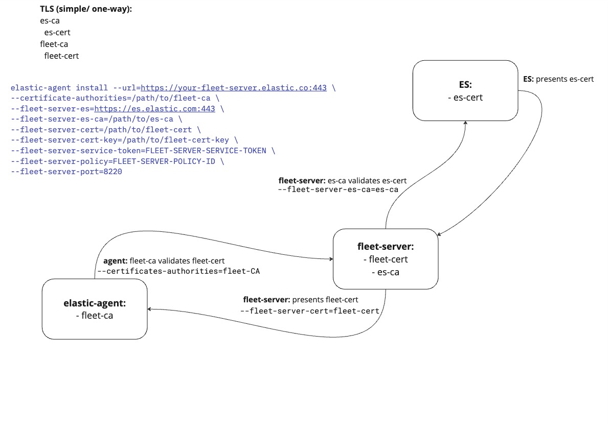

editThe following elastic-agent install
command configures a Fleet Server with the required certificates and certificate authorities to enable one-way TLS connections between the components involved:
elastic-agent install --url=https://your-fleet-server.elastic.co:443 \ --certificate-authorities=/path/to/fleet-ca \ --fleet-server-es=https://es.elastic.com:443 \ --fleet-server-es-ca=/path/to/es-ca \ --fleet-server-cert=/path/to/fleet-cert \ --fleet-server-cert-key=/path/to/fleet-cert-key \ --fleet-server-service-token=FLEET-SERVER-SERVICE-TOKEN \ --fleet-server-policy=FLEET-SERVER-POLICY-ID \ --fleet-server-port=8220

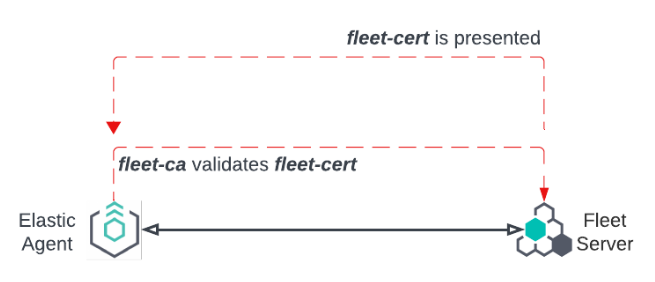

Elastic Agent is configured with fleet-ca
as the certificate authority that it needs to validate certificates from Fleet Server.
During the TLS connection setup, Fleet Server presents its certificate fleet-cert
to the agent and the agent (as a client) uses fleet-ca
to validate the presented certificate.

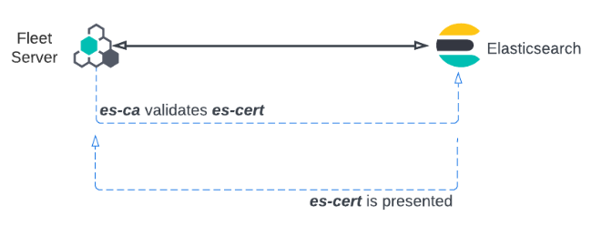

Fleet Server also establishes a secure connection to an Elasticsearch cluster. In this case, Fleet Server is configured with the certificate authority from the Elasticsearch es-ca
. Elasticsearch presents its certificate, es-cert
, and Fleet Server validates the presented certificate using the certificate authority es-ca

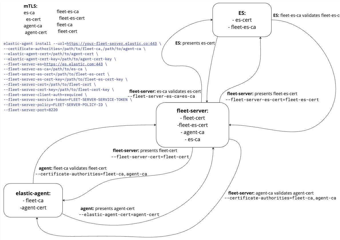

command configures a Fleet Server with the required certificates and certificate authorities to enable mutual TLS connections between the components involved:
elastic-agent install --url=https://your-fleet-server.elastic.co:443 \ --certificate-authorities=/path/to/fleet-ca,/path/to/agent-ca \ --elastic-agent-cert=/path/to/agent-cert \ --elastic-agent-cert-key=/path/to/agent-cert-key \ --elastic-agent-cert-key=/path/to/agent-cert-key-passphrase \ --fleet-server-es=https://es.elastic.com:443 \ --fleet-server-es-ca=/path/to/es-ca \ --fleet-server-es-cert=/path/to/fleet-es-cert \ --fleet-server-es-cert-key=/path/to/fleet-es-cert-key \ --fleet-server-cert=/path/to/fleet-cert \ --fleet-server-cert-key=/path/to/fleet-cert-key \ --fleet-server-client-auth=required \ --fleet-server-service-token=FLEET-SERVER-SERVICE-TOKEN \ --fleet-server-policy=FLEET-SERVER-POLICY-ID \ --fleet-server-port=8220

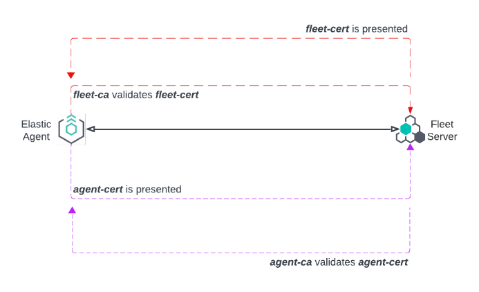

As with the one-way TLS example, Elastic Agent is configured with fleet-ca
as the certificate authority that it needs to validate certificates from the Fleet Server. Fleet Server presents its certificate fleet-cert
To establish a mutual TLS connection, the agent presents its certificate, agent-cert
, and Fleet Server validates this certificate using the agent-ca
that it has stored in memory.

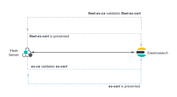

Fleet Server can also establish a mutual TLS connection to the Elasticsearch cluster. In this case, Fleet Server is configured with the certificate authority from the Elasticsearch es-ca
and uses this to validate the certificate es-cert
presented to it by Elasticsearch.
