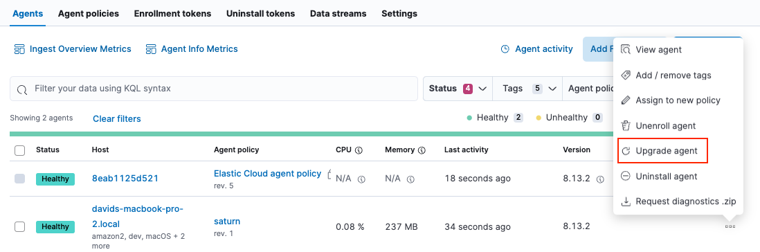

Upgrade a single Elastic Agent
edit-
On the Agents tab, agents that can be upgraded are identified with an Upgrade available indicator.
You can also click the Upgrade available button to filter the list agents to only those that currently can be upgraded.

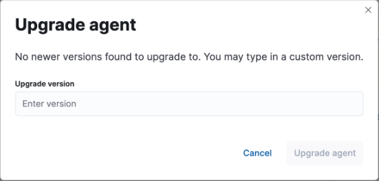

From the Actions menu next to the agent, choose Upgrade agent.
In the Upgrade agent window, select or specify an upgrade version and click Upgrade agent.
In certain cases the latest available Elastic Agent version may not be recognized by Kibana. For instance, this occurs when the Kibana version is lower than the Elastic Agent version. You can specify a custom version for Elastic Agent to upgrade to by entering the version into the Upgrade version text field.

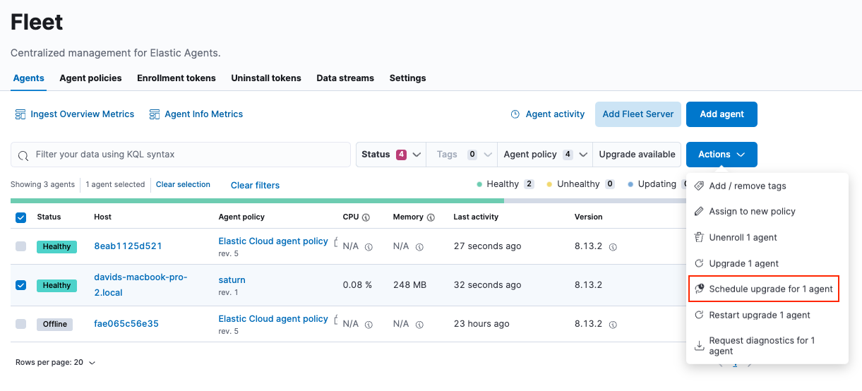

Schedule an upgrade
edit- On the Agents tab, select one or more agents, and click Actions.
From the Actions menu, choose to schedule an upgrade.
If the schedule option is grayed out, it may not be available at your subscription level. For more information, refer to Elastic Stack subscriptions.
- In the Upgrade window, select an upgrade version.
- Select a maintenance window. For more information, refer to Do a rolling upgrade of multiple Elastic Agents.
- Set the date and time when you want the upgrade to begin.
- Click Schedule.

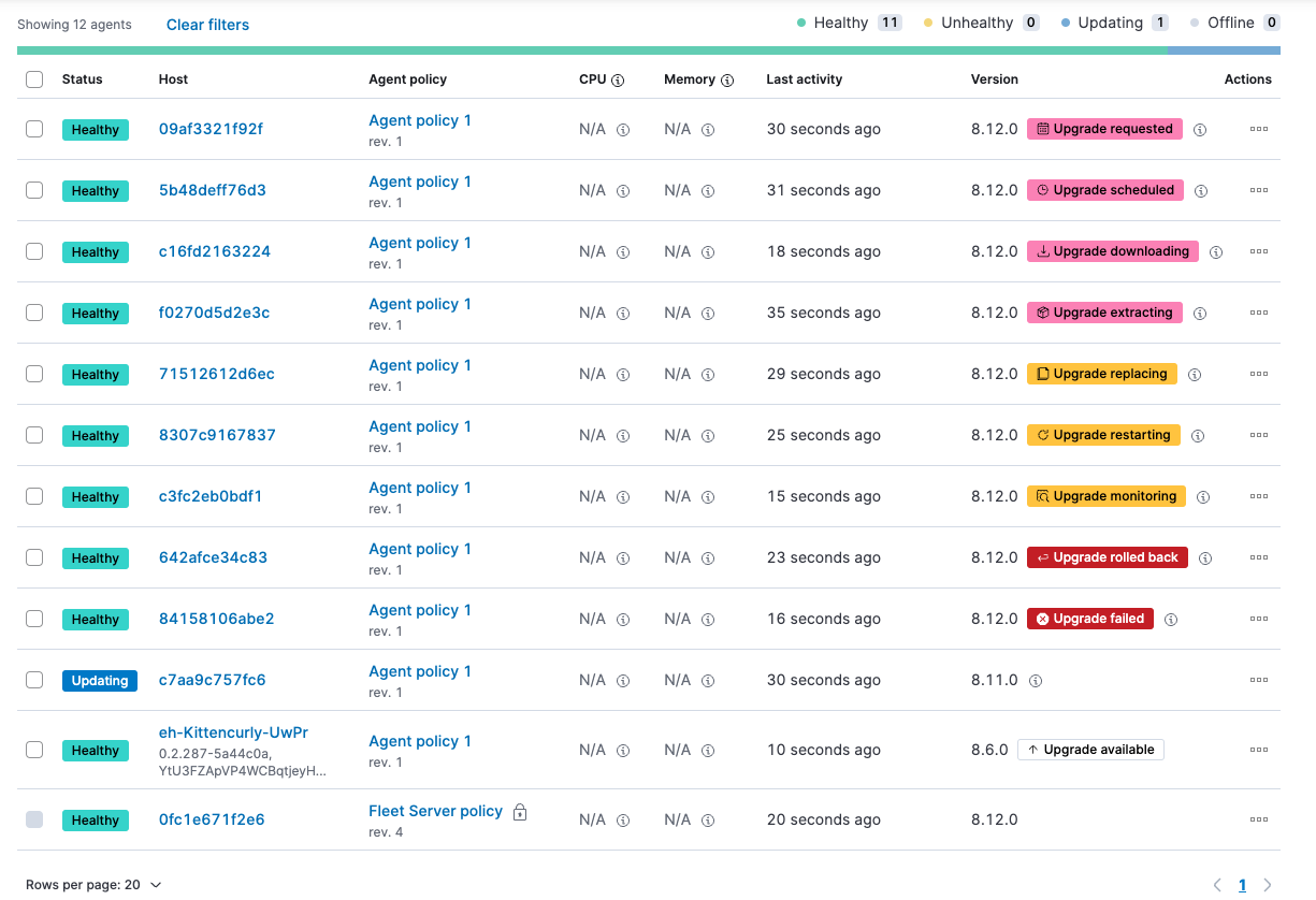

View upgrade status
editOn the Agents tab, when you trigger an upgrade, agents that are upgrading have the status Updating
until the upgrade is complete, and then the status changes back to Healthy

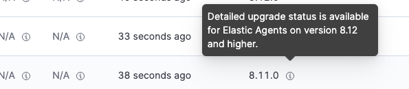

Agents on version 8.12 and higher that are currently upgrading additionally show a detailed upgrade status indicator.
The following table explains the upgrade states in the order that they can occur.
Table 6. Elastic Agent upgrade states
State | Description |

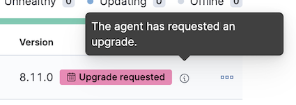

Upgrade requested |
Elastic Agent has received the upgrade notice from Fleet. |
Upgrade scheduled |
Elastic Agent has received the upgrade notice from Fleet and the upgrade will start at the indicated time. |
Upgrade downloading |
Elastic Agent is downloading the archive containing the new version artifact. |
Upgrade extracting |
Elastic Agent is extracting the new version artifact from the downloaded archive. |
Upgrade replacing |
Elastic Agent is currently replacing the former, pre-upgrade agent artifact with the new one. |

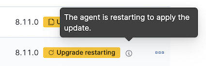

Upgrade restarting |
Elastic Agent has been replaced with a new version and is now restarting in order to apply the update. |
Upgrade monitoring |
The newly upgraded Elastic Agent has started and is being monitored for errors. |
Upgrade rolled back |
The upgrade was unsuccessful. Elastic Agent is being rolled back to the former, pre-upgrade version. |
Upgrade failed |
An error has been detected in the newly upgraded Elastic Agent and the attempt to roll the upgrade back to the previous version has failed. |
Under routine circumstances, an Elastic Agent upgrade happens quickly. You typically will not see the agent transition through each of the upgrade states. The detailed upgrade status can be a very useful tool especially if you need to diagnose the state of an agent that may have become stuck, or just appears to have become stuck, during the upgrade process.
Beside the upgrade status indicator, you can hover your cursor over the information icon to get more detail about the upgrade.
Note that when you upgrade agents from versions below 8.12, the upgrade details are not provided.

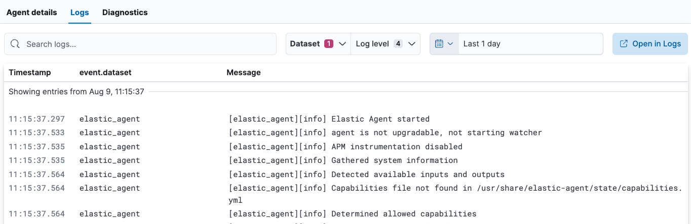

If an upgrade fails, you can view the agent logs to find the reason:
- In Fleet, in the Host column, click the agent’s name.
- Open the Logs tab.
Search for failures.
