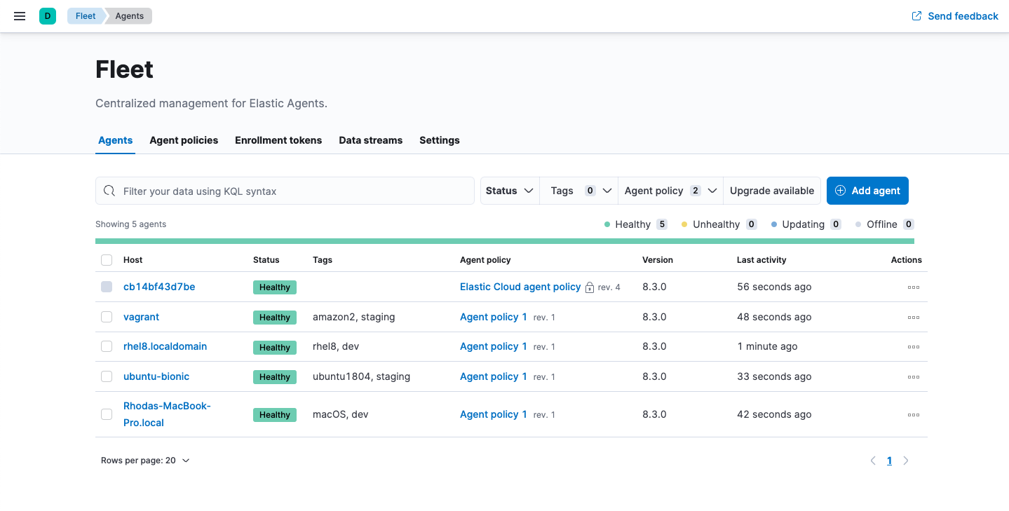

  1. On the Agents tab in Fleet, confirm that the Elastic Agent status is Healthy.
    Screen showing that agent status is Healthy

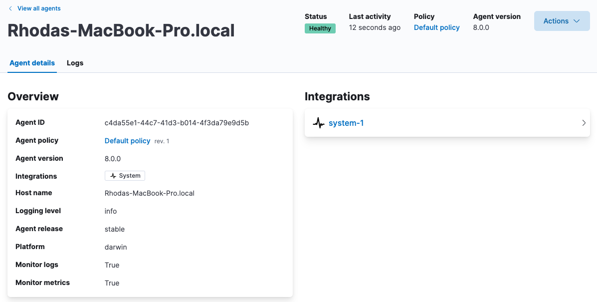

  2. Click the host name to examine the Elastic Agent details. This page shows the integrations that are currently installed, the policy the agent is enrolled in, and information about the host machine:

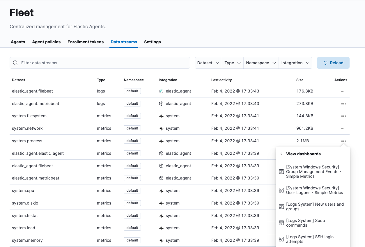

  3. Go back to the main Fleet page and click the Data streams tab. You should be able to see the data streams for various logs and metrics from the host. This is out-of-the-box without any extra configuration or dashboard creation:
    Screen showing data streams created by the Elastic Agent

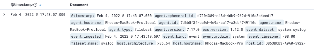

    If Beats are installed on the host machine, the data in Elasticsearch will be duplicated, with one set coming from Beats and another from Elastic Agent for the same data source.
    For example, filter on filebeat-* to see the data ingested by Filebeat.
    Screen showing event from Filebeat

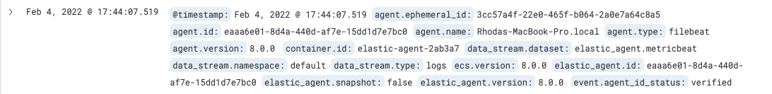

    Next, filter on logs-*. Notice that the document contains data_stream.* fields that come from logs ingested by the Elastic Agent.
    Screen showing event from Elastic Agent

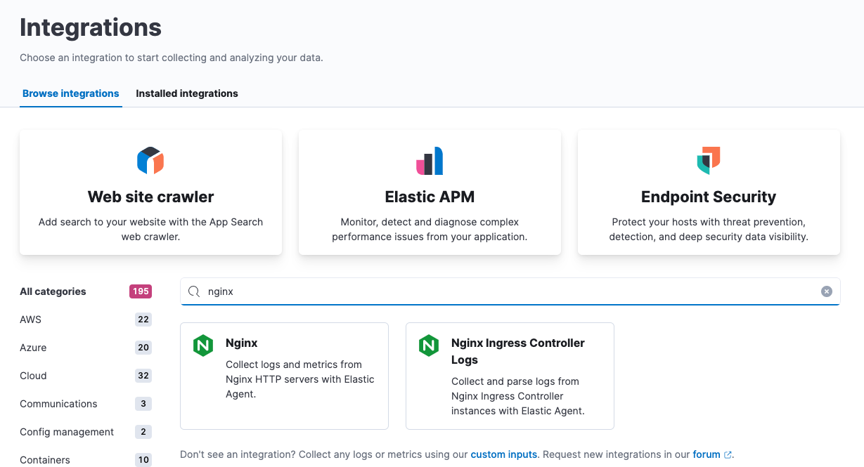

  1. From the main menu in Kibana, click Add integrations and add the Nginx integration.
    Screen showing the Nginx integration

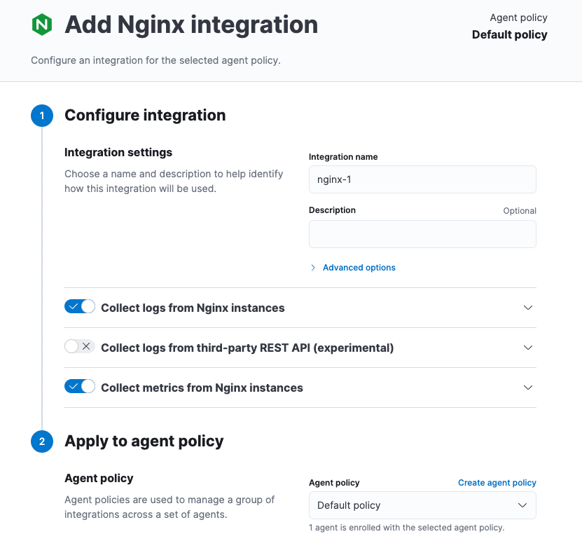

  2. Configure the integration, then apply it to the agent policy you used earlier. Make sure you expand collapsed sections to see all the settings like log paths.
    Screen showing Nginx configuration
    When you save and deploy your changes, the agent policy is updated to include a new integration policy for Nginx. All Elastic Agents enrolled in the agent policy get the updated policy, and the Elastic Agent running on your host will begin collecting Nginx data.
    Integration policy names must be globally unique across all agent policies.

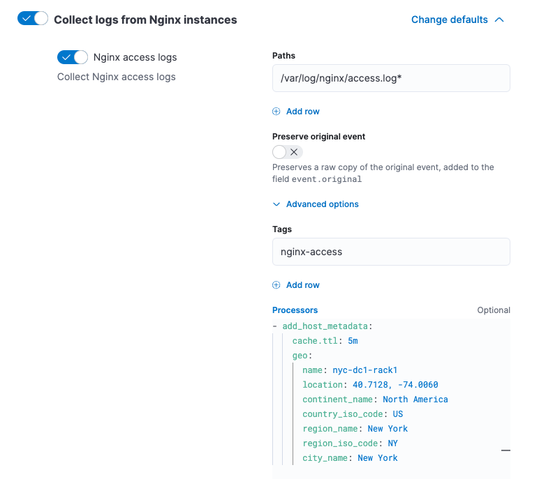

  3. Click the down arrow next to enabled streams, and under Advanced options, add the processor definition. The processor will be applied to the data set where it’s defined.
    Screen showing how to add a processor to an integration policy
    For example, the following processor adds geographically specific metadata to host events:
    - add_host_metadata:
        cache.ttl: 5m
        geo:
          location: 40.7128, -74.0060
          continent_name: North America
          country_iso_code: US
          region_name: New York
          region_iso_code: NY
          city_name: New York
In Kibana, look at the data again to confirm it contains the fields you expect.

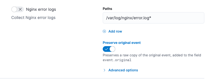

Preserve raw events
In some cases, Beats modules preserve the original, raw event, which consumes more storage space, but may be a requirement for compliance or forensic use cases.
In Elastic Agent, this behavior is optional and disabled by default.
If you must preserve the raw event, edit the integration policy, and for each enabled data stream, click the Preserve original event toggle.
Do this for every data stream with a raw event you want to preserve.

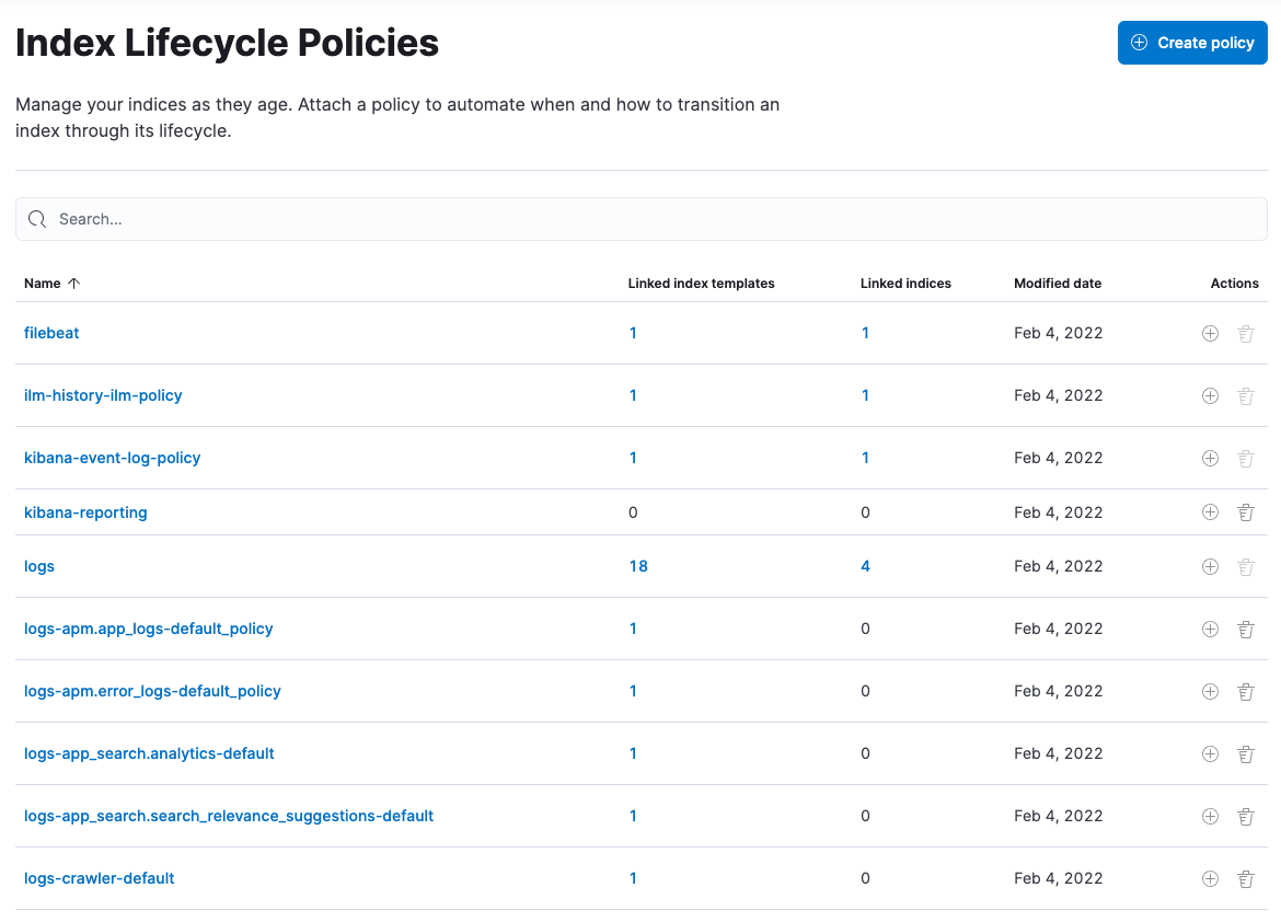

Migrate index lifecycle policies
Index lifecycle management (index lifecycle management) policies in Elasticsearch enable you to manage indices according to your performance, resiliency, and retention requirements. To learn more about index lifecycle management, refer to the index lifecycle management documentation.
index lifecycle management is configured by default in Beats (version 7.0 and later) and in Elastic Agent (all versions). To view the index lifecycle policies defined in Elasticsearch, go to Management > Index Lifecycle Policies.
If you used index lifecycle management with Beats, you’ll see index lifecycle policies like filebeat and metricbeat in the list. After migrating to Elastic Agent, you’ll see polices named logs and metrics, which encapsulate the index lifecycle management policies for all logs-* and metrics-* index templates.
When you migrate from Beats to Elastic Agent, you have a couple of options for migrating index policy settings:
  • Modify the newly created index lifecycle policies (recommended). As mentioned earlier, index lifecycle management is enabled by default when the Elastic Agent is installed. Index lifecycle policies are created and added to the index templates for data streams created by integrations.
    If you have existing index lifecycle policies for Beats, it’s highly recommended that you modify the lifecycle policies for Elastic Agent to match your previous policy. To do this:
    1. In Kibana, go to Stack Management > Index Lifecycle Policies and search for a Beats policy, for example, filebeat. Under Linked indices, notice you can view indices linked to the policy. Click the policy name to see the settings.
    2. Click the logs policy and, if necessary, edit the settings to match the old policy.
    3. Under Index Lifecycle Policies, search for another Beats policy, for example, metricbeat.
    4. Click the metrics policy and edit the settings to match the old policy.
    Optionally delete the Beats index lifecycle policies when they are no longer used by an index.
