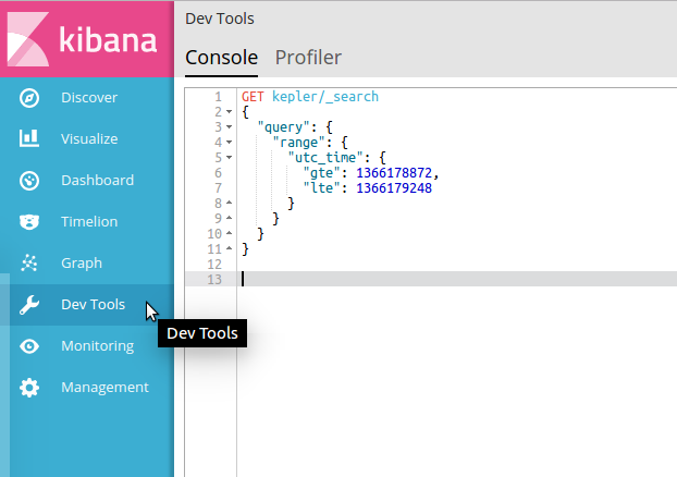

  1. Open Kibana in your web browser and log in. If you are running Kibana locally, go to http://localhost:5601/.
  2. Click DevTools in the side navigation to open the Search Profiler. Console is the default tool to open when first accessing DevTools.
    Opening DevTools

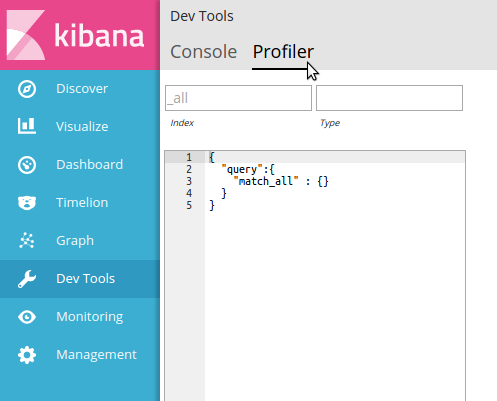

    On the top navigation bar, click the second item: Search Profiler
    Opening the Search Profiler

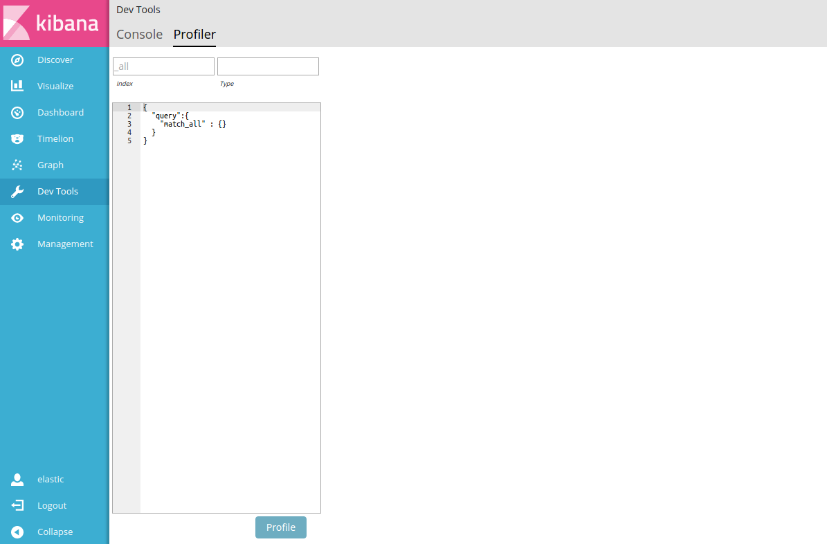

  3. This opens the Search Profiler interface.
    Search Profiler Interface
  4. Replace the default match_all query with the query you want to profile and click Profile.
    Profiling the match_all query

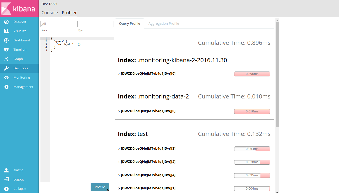

    Search Profiler displays the names of the indices searched, the shards in each index, and how long the query took. The following example shows the results of profiling the match_all query. Three indices were searched: .monitoring-kibana-2-2016.11.30, .monitoring-data-2 and test.

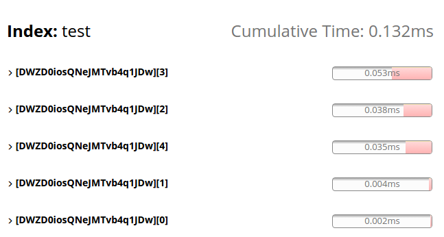

    If we take a closer look at the information for the test index, we can see from the Cumulative Time that the query took 0.132ms to execute. Of the five shards in the index (DWZD0iosQNeJMTvb4q1JDw 0 through 5), shard 3 was the slowest (0.053ms), followed by shard 2 (0.038ms). Shards are sorted by their time in descending order.
    Profile details for the test index
    The Cumulative Time metric is the sum of individual shard times. It is not necessarily the actual time it took for the query to return (wall clock time). Because shards might be processed in parallel on multiple nodes, the wall clock time can be significantly less than the Cumulative Time. However, if shards are colocated on the same node and executed serially, the wall clock time is closer to the Cumulative Time.
    While the Cumulative Time metric is useful for comparing the performance of your indices and shards, it doesn’t necessarily represent the actual physical query times.

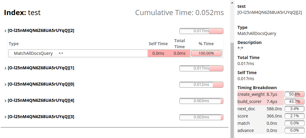

  5. To view more detailed profiling information for a shard, click the Expand button. This displays details about the query component(s) that ran on the shard.
    In this example, there is a single "MatchAllDocsQuery" that ran on the shard. Since it was the only query run, it took 100% of the time. When you mouse over a row, the Search Profiler displays additional information about the query component."
    Profile details for the first shard
    This panel shows the timing breakdown of low-level Lucene methods. For more information, see the reference docs for Timing Breakdown.
