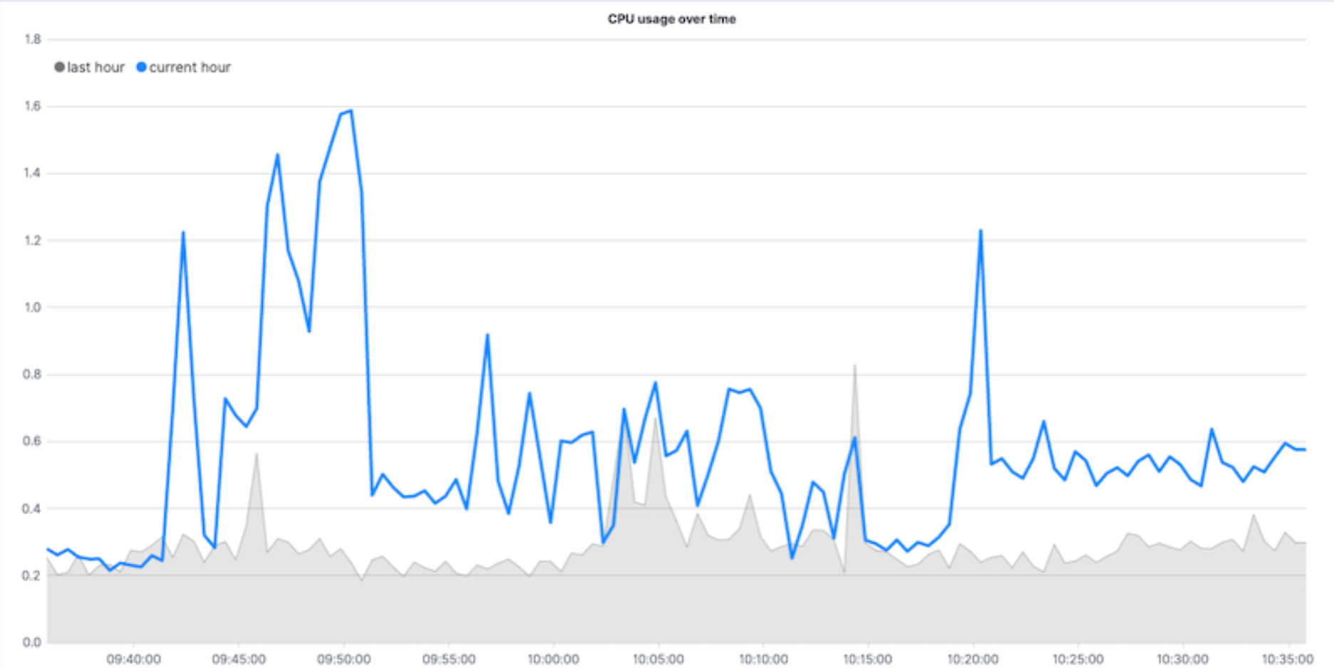

Create a time series visualization
To compare the real-time percentage of CPU time spent in user space to the results offset by one hour, create a time series visualization.
Define the functions
To track the real-time percentage of CPU, enter the following in the Timelion Expression field, then click Update:
.es(index=metricbeat-*,
    timefield='@timestamp',
    metric='avg:system.cpu.user.pct')
Compare the data
To compare two data sets, add another series, and offset the data back by one hour, then click Update:
    metric='avg:system.cpu.user.pct'),
.es(offset=-1h,
    index=metricbeat-*,
Add label names
To easily distinguish between the two data sets, add label names, then click Update:
.es(offset=-1h,index=metricbeat-*,
    metric='avg:system.cpu.user.pct').label('last hour'),
    metric='avg:system.cpu.user.pct').label('current hour')
Add a title
To make is easier for unfamiliar users to understand the purpose of the visualization, add a title, then click Update:
.es(offset=-1h,
    index=metricbeat-*,
  .title('CPU usage over time')
Change the appearance of the chart lines
To differentiate between the current hour and the last hour, change the appearance of the chart lines, then click Update:
.es(offset=-1h,
    index=metricbeat-*,
  .label('last hour')
  .lines(fill=1,width=0.5),
Change the line colors
Timelion supports standard color names, hexadecimal values, or a color schema for grouped data.
To make the first data series stand out, change the line colors, then click Update:
.es(offset=-1h,
    index=metricbeat-*,
  .label('last hour')
  .color(gray),
  .color(#1E90FF)
Adjust the legend
Move the legend to the north west position with two columns, then click Update:
.es(offset=-1h,
    index=metricbeat-*,
  .label('last hour')
  .color(gray),
  .color(#1E90FF)
  .legend(columns=2, position=nw)
Final time series visualization

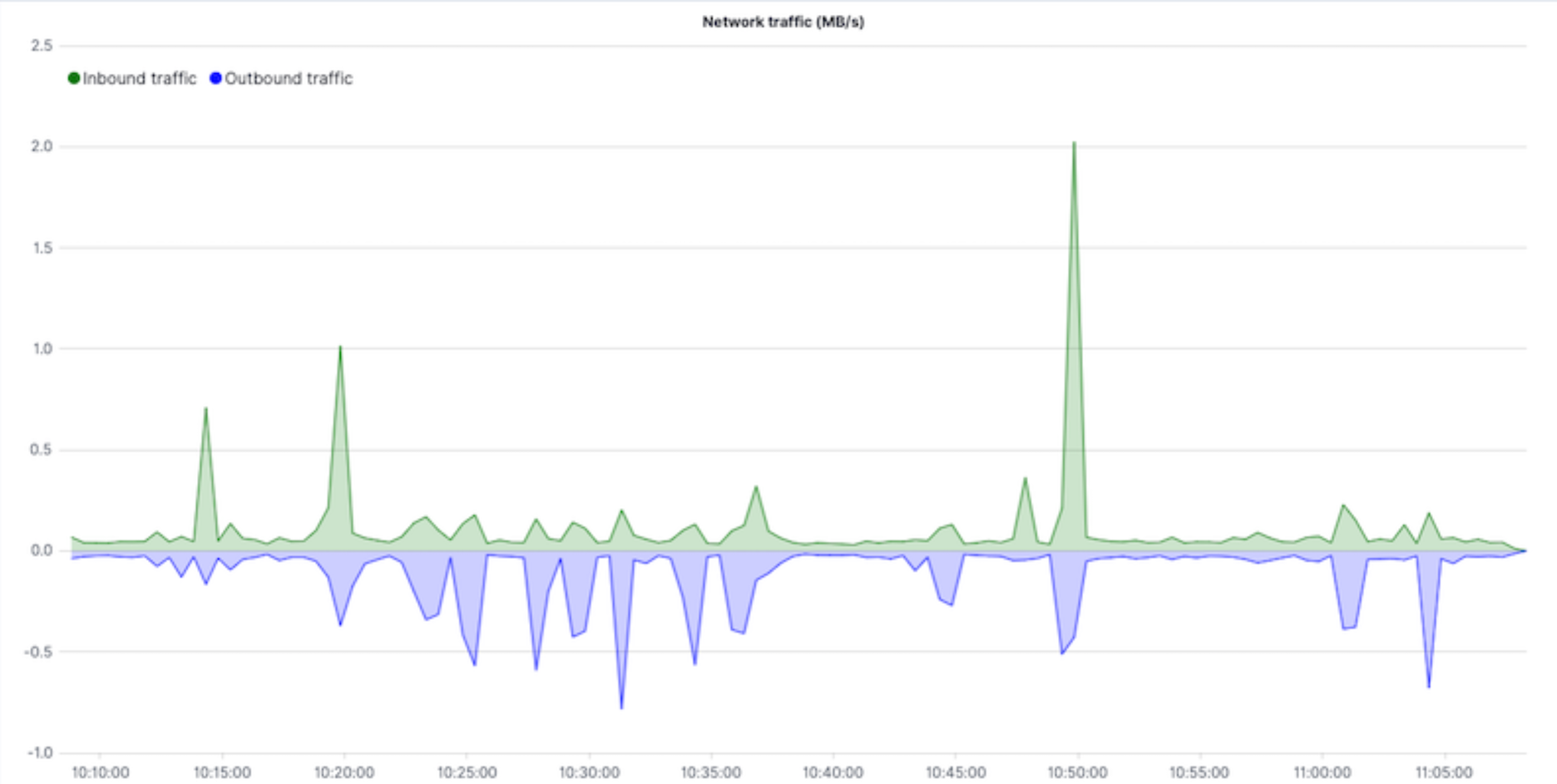

Visualize the inbound and outbound network traffic
To create a visualization for inbound and outbound network traffic, use mathematical functions.
To start tracking the inbound and outbound network traffic, enter the following in the Timelion Expression field, then click Update:
.es(index=metricbeat*,
    timefield=@timestamp,
    metric=max:system.network.in.bytes)
Plot the rate of change
To easily monitor the inbound traffic, plots the change in values over time, then click Update:
  .derivative()
Add a similar calculation for outbound traffic, then click Update:
  .derivative(),
    metric=max:system.network.out.bytes)
  .derivative()
  .multiply(-1)
.multiply(-1) converts the outbound network traffic to a negative value since the outbound network traffic is leaving your machine. .multiply() multiplies the data series by a number, the result of a data series, or a list of data series.
Change the data metric
To make the data easier to analyze, change the data metric from bytes to megabytes, then click Update:
  .derivative()
  .divide(1048576),
  .derivative()
  .multiply(-1)
  .divide(1048576)
.divide() accepts the same input as .multiply(), then divides the data series by the defined divisor.
Customize and format the visualization
Customize and format the visualization using the following functions, then click Update:
  .derivative()
  .divide(1048576)
  .lines(fill=2, width=1)
  .color(green)
  .label("Inbound traffic")
  .title("Network traffic (MB/s)"),
  .derivative()
  .multiply(-1)
  .divide(1048576)
  .color(blue)
  .label("Outbound traffic")
Final visualization that displays inbound and outbound network traffic

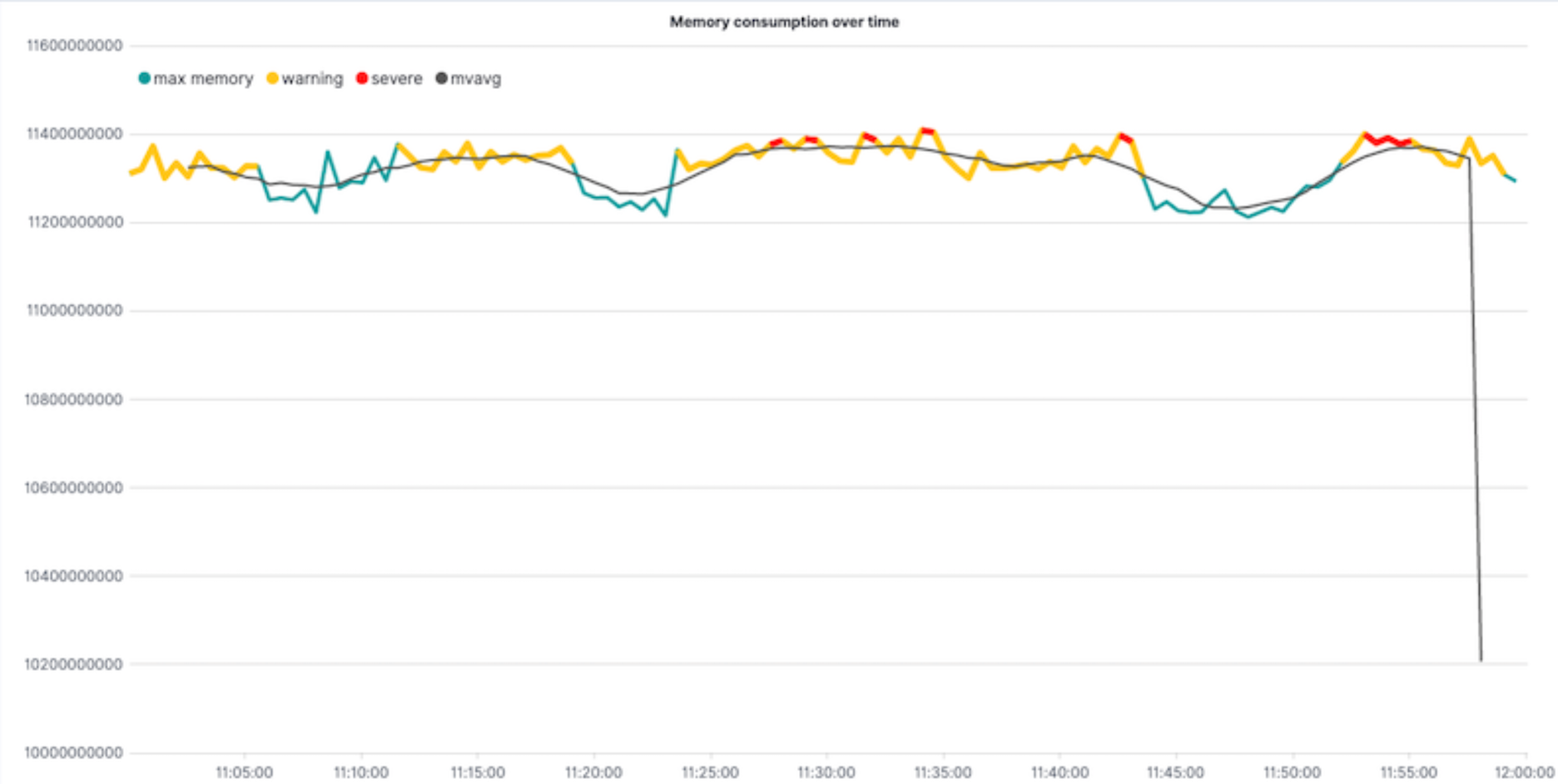

To chart the maximum value of system.memory.actual.used.bytes, enter the following in the Timelion Expression field, then click Update:
    metric='max:system.memory.actual.used.bytes')
Track used memory
To track the amount of memory used, create two thresholds, then click Update:
    metric='max:system.memory.actual.used.bytes'),
  .if(gt,
      11300000000,
      null)
    .label('warning')
    .color('#FFCC11'),
  .if(gt,
      11375000000,
      null)
  .label('severe')
  .color('red')
if() compares each point to a number. When the condition is true, adjust the styling. When the condition is false, use the default styling.
Timelion conditional logic for the greater than operator. In this example, the warning threshold is 11.3GB (11300000000), and the severe threshold is 11.375GB (11375000000). If the threshold values are too high or low for your machine, adjust the values.

To determine the trend, create a new data series, then click Update:
  .if(gt,11300000000,
      null)
      .label('warning')
      .color('#FFCC11'),
  .if(gt,11375000000,
      null).
      label('severe')
      .color('red'),
  .mvavg(10)
mvavg() calculates the moving average over a specified period of time. In this example, .mvavg(10) creates a moving average with a window of 10 data points.
  .label('max memory')
  .title('Memory consumption over time'),
  .if(gt,
      11300000000,
      null)
    .label('warning')
    .color('#FFCC11')
    .lines(width=5),
  .if(gt,
      11375000000,
      null)
    .label('severe')
    .color('red')
    .lines(width=5),
  .mvavg(10)
  .label('mvavg')
  .lines(width=2)
  .color(#5E5E5E)
  .legend(columns=4, position=nw)
Final visualization that displays outliers and patterns over time
