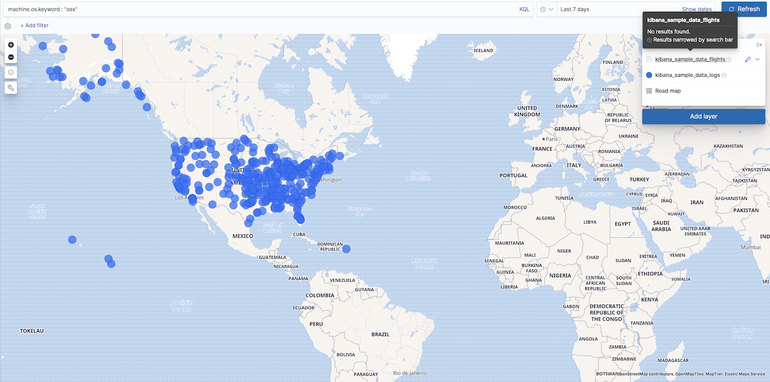

If you query for
machine.os.keyword : "osx"
the kibana_sample_data_flights
layer is empty because the index
does not contain the field machine.os.keyword
and no documents match the query.

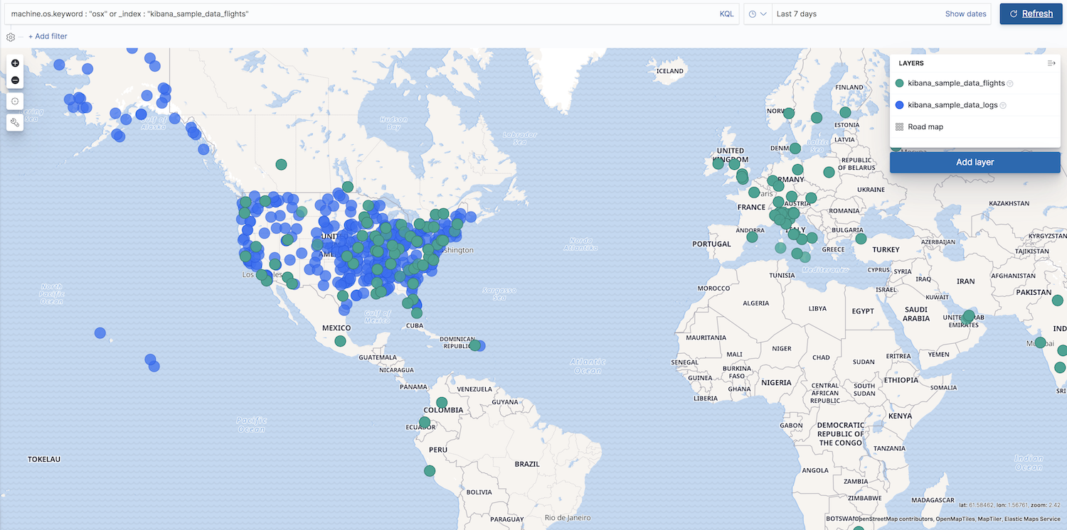

If you instead query for
machine.os.keyword : "osx" or _index : "kibana_sample_data_flights"
layer includes data.
